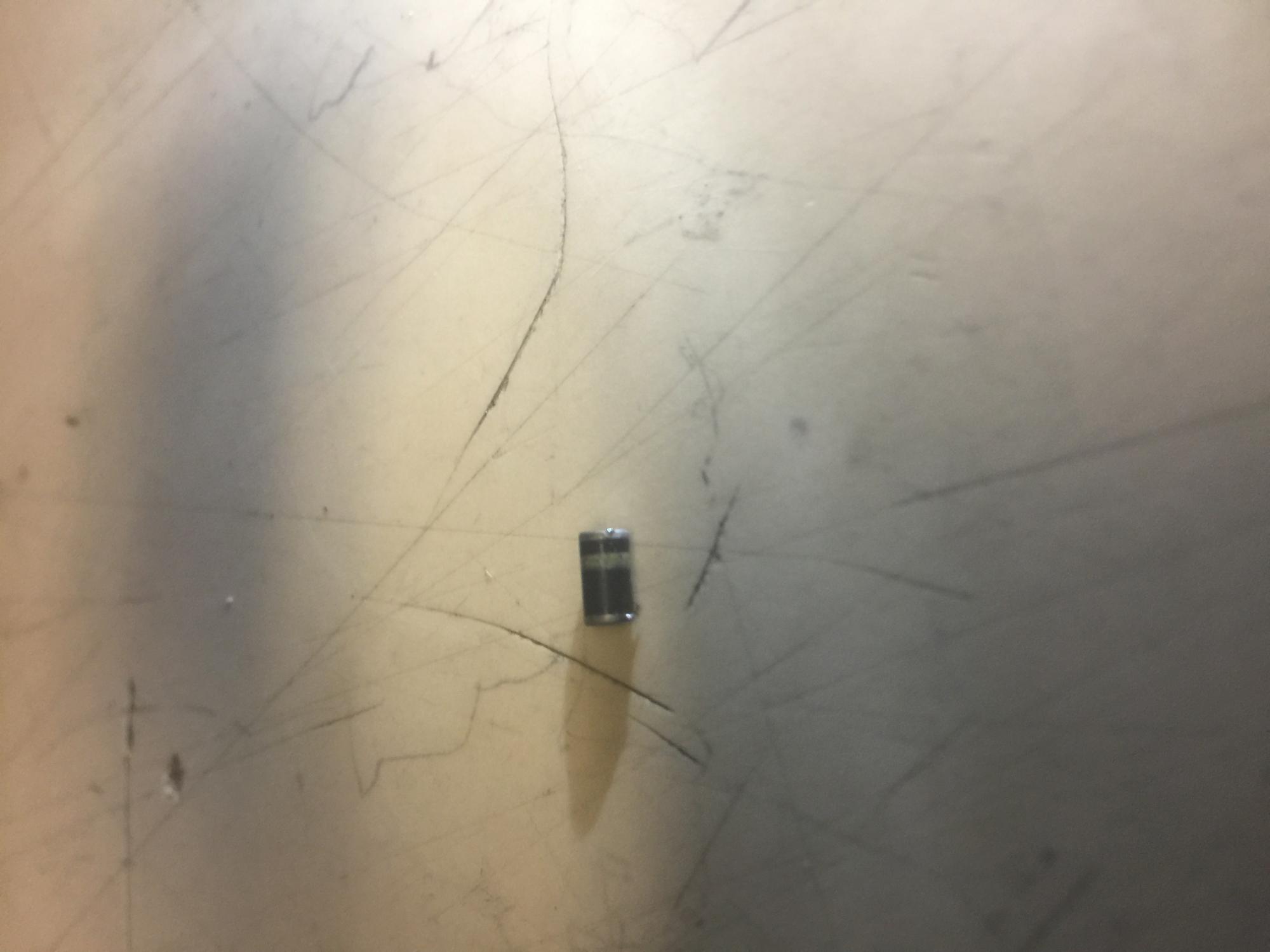

    Does anyone have a schematic for a Mini Max CT250 Spa Control/Power Board? I found three blown diodes and no markings on them.

      First pic of a diode. My camera isn't very good.

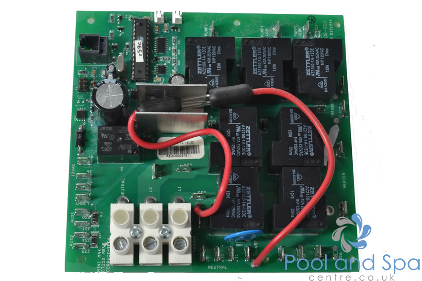

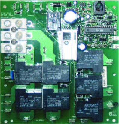

        Here's the board. All the caps are the same from what I can tell. They are all apart of the relays circuit.

          That is a MELF diode, where is it in the circuit and what is wrong with it? is it shorted?
          It might be a GL41M 1A 1000V Fast Recovery, or a schottkey or it could also be a zener diode, does it only have one color band and is it green?
            It might be a GL41M 1A 1000V Fast Recovery, or it could also be a zener diode, does it only have one color band and can you make out what the color is?
            It's like a greyish band. There is three of them shorted but the others are reading out of circuit .5 one way and ol the other way.

              Do you have a picture of the circut where they are located, They might be 8.2v zener diodes or they may just be ordanary diodes
              • dcapper
                • Dec 2013
                • 496
                Re: Mini Max CT250 Spa Control/Power Board

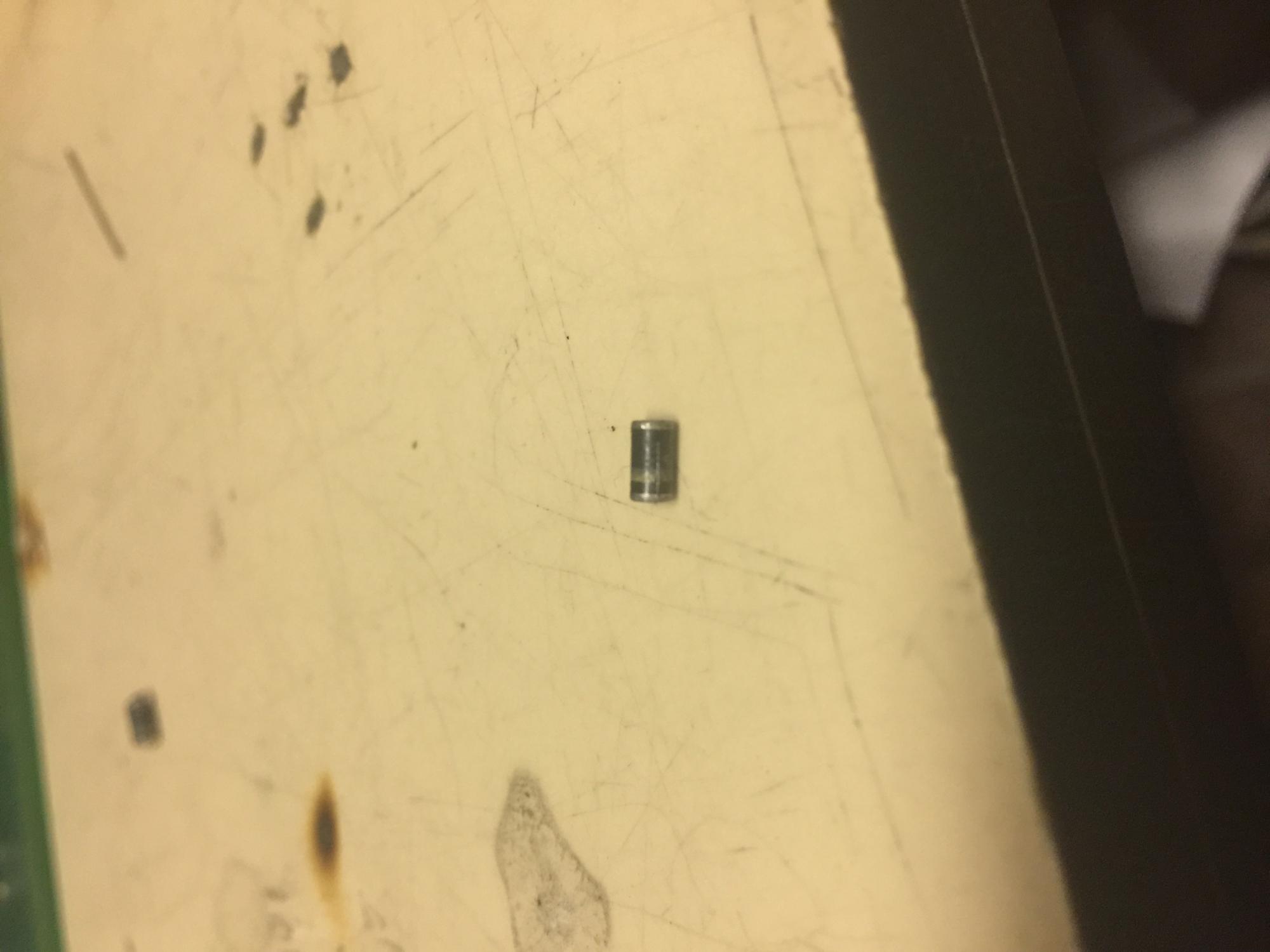

                The pic above. Look at the two middle relays. One diode above the top relay. One in the middle of the two relays. And one near the top heat sink. Then there's a few by the right three relays. The blown ones are by the middle relays. I tried to take a better pic of the diode that I attached.
                • R_J
                  • Jun 2012
                  • 9551
                  If the diode is across the relay coil it will just be an ordinary 1amp diode, if the diode is across a control line to ground it could be a zener diode for protection on that line.
