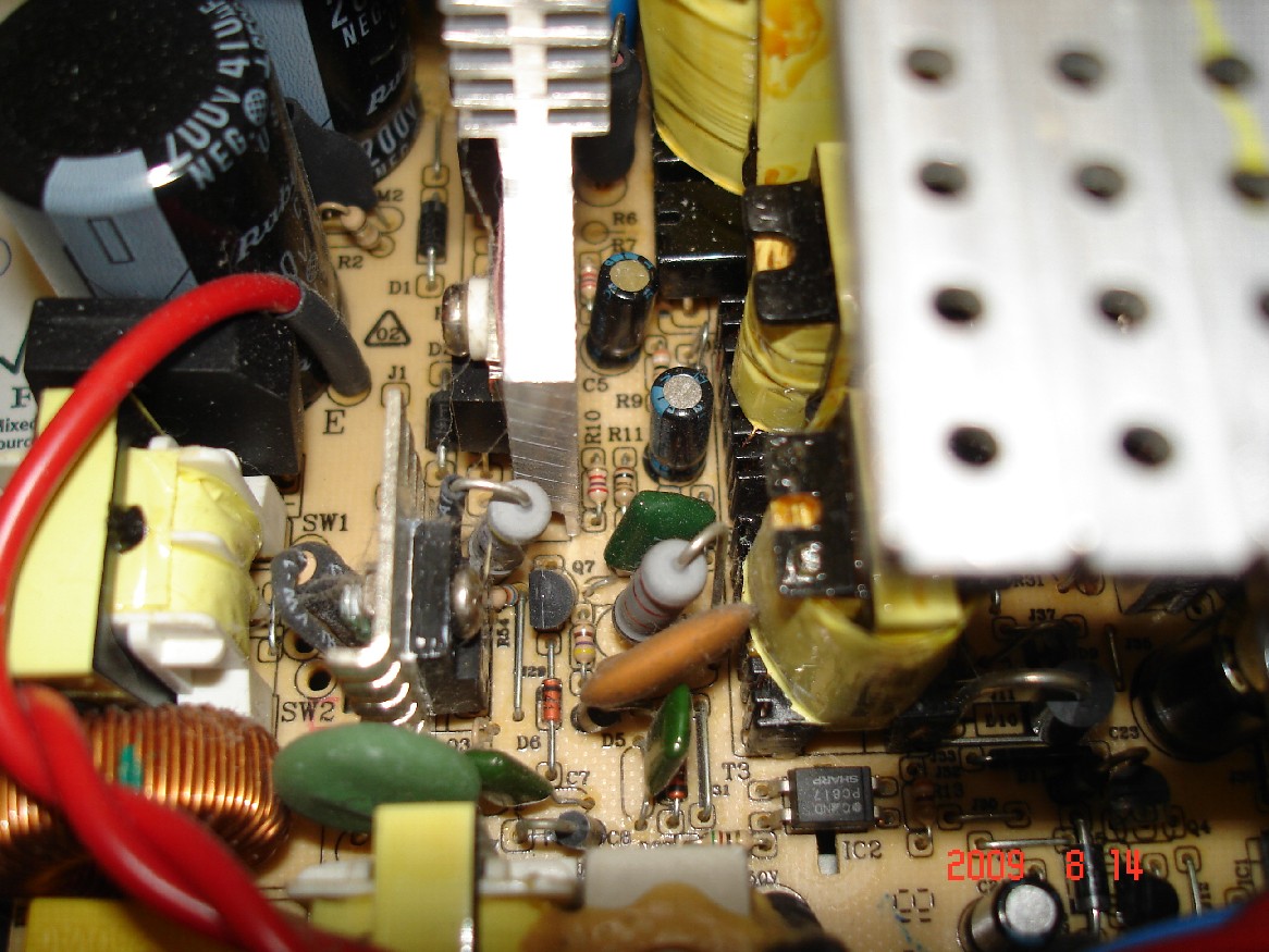

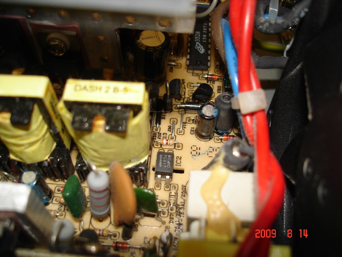

      some pics would help. maybe a PI coil's core is coming loose and needs a dab of hot glue.

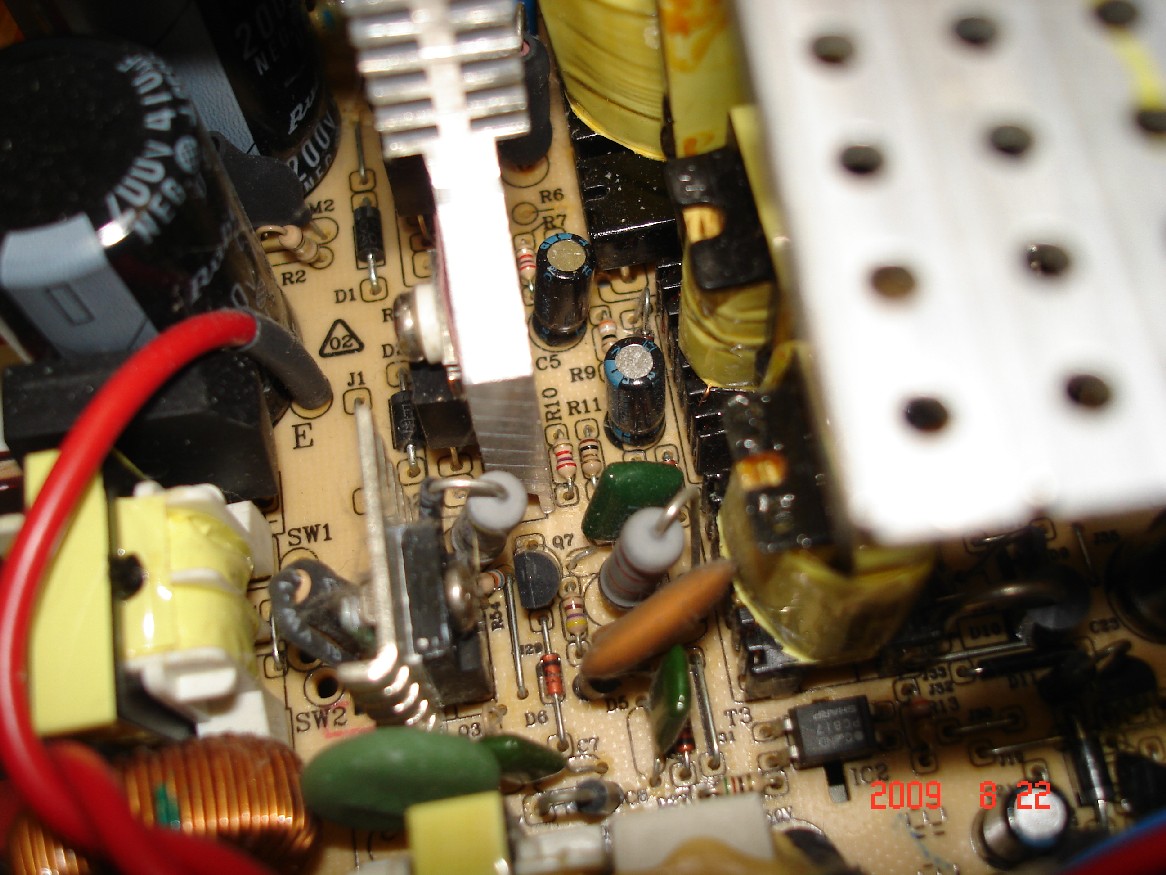

        Here are some pics....
        So which one of the Jamicon/Teapo cap(s) are for 5vsb?
        I can't read their values but they all seem to be 1uF/50V size...

          What is the model number? Looks like an older Sparkle power supply.
          Old proverb say.........If you shoot at nothing, you will hit nothing (George Henry 10-14-11)
          • lucky13
            • Aug 2007
            • 412
            Re: Sparkle 250W noise....
            Model is FSP250-60ATV.
            Yes it is an older model.

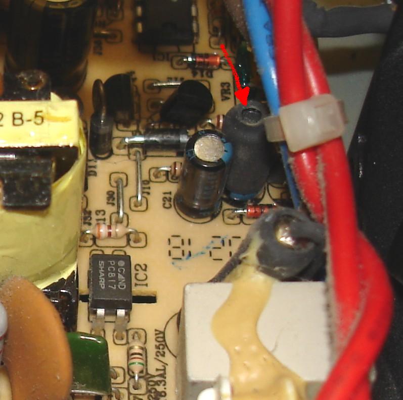

              did you check that PI coil in pic 4?
              sigpic
              (Insert witty quote here)
              • lucky13
                • Aug 2007
                • 412
                Hmm, what about that coil? It is standing up....

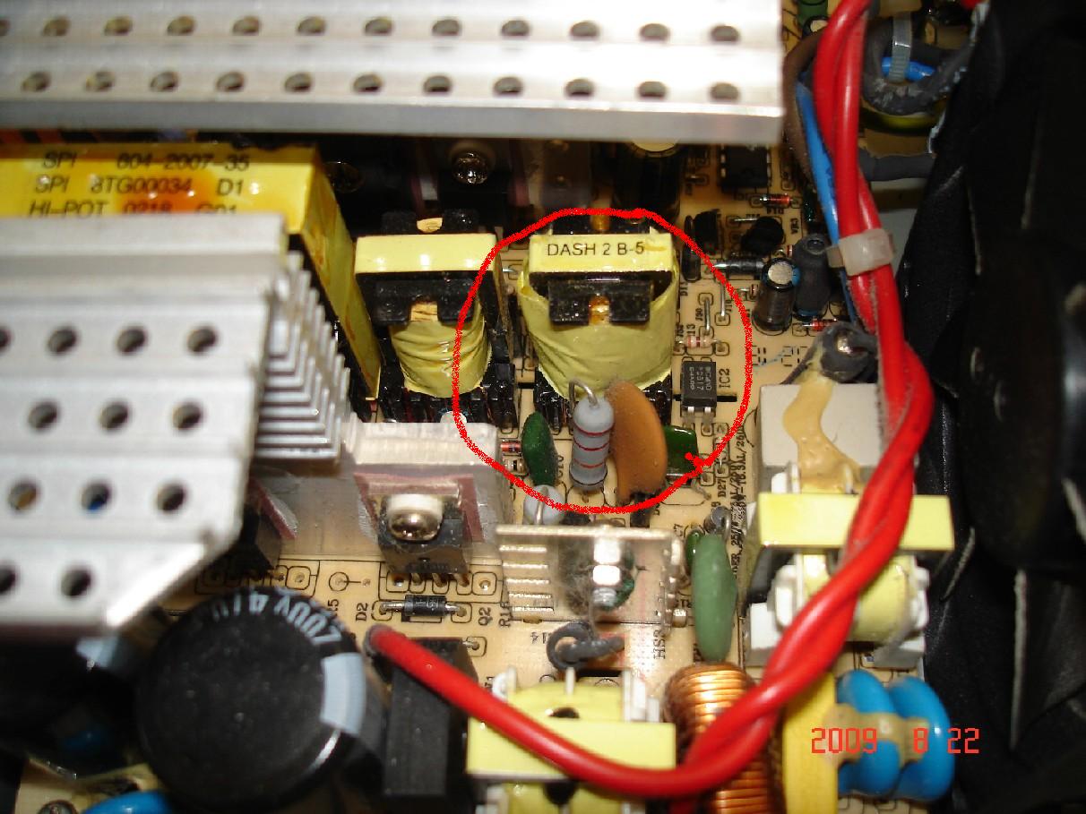

                        That's on wrong side. (this is hot primary side), The assumed resistor would be on secondary side DC side.
                        The squeak is from transformer. Make sure the cap and resistor are NOT touchy-feely each other (this makes noise too if touching can happen!).
                        The fix for squeak is change capacitors for that 5Vsb as others had advised and I want to add one more, if you know of one with high vacuum chamber, put the transformer in small cup of varnish and pull a vacuum to pull gases/air out of transformer's internal construction. Then let it dry by baking in the junk oven on *very low temp*. Check often. This will give you best job of this transformer NOT to squeal due to loose bit vibrating internally.

                          momaka/linuxguru
                          I don't have any power resistor at the moment to load the 5vsb line as you both suggest.
                          OTOH, when this p/s was connected to a p4 motherboard and power the ac only, the noise was there. So, I would think the mobo provides enough loading on th4 5vsb line right? Or no?

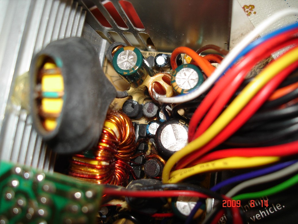

                          As best as I can see these small lytic caps, I think most are 1uF variety, except one sleeved in heat shrink tubing. C21 is 1uF/50V. Could this one sleeved be the "evil" cap I need to replace?
                            Cheers, Wizard
                            I move the resistor, ceramic disc cap & diode ever so slightly to make sure they are all free standing. But the noise is still there :-(
                            Your suggestion makes sense to me but I don't have access to vacuum chamber or varnish to try your idea. That's out of my league.
                              Possibly, but I can't tell for sure with the sleeve on there. Also, looking at the center of this picture, it could be one of those 3 small caps as well.
                                Really? Oh shoot... The two on the north side are "F" caps.... I guess I will recap them. Just that since the Antec went Boom on me, I try not to disturb too much of the components on the PCB.

                                  IMO, that could be an electrolytic cap cooking internally. Looks fine from outside, but has dried out and is breaking down internally. The sound you're hearing is arcing inside the can. Watch that 5vsb carefully.
                                  Until you positively locate & identify the component causing the noise, I would not hook this into your system.
                                  With an insulated stick or probe, while it's making the noise, try pushing on different components to see if the noise pitch or intensity changes.
                                  Try using a paper towel tube to listen.

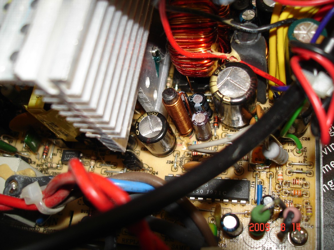

                                    I've now replaced ALL the other lytic caps on this p/s with Panasonic FC/FM caps:
                                    C12 (sleeved one seen in the pix). It was a 4.7uF/50V Jamicon TK. I put in a 4.7uF/50V FC
                                    C20 22uF/50V Teapo > FM 22uF/50V
                                    C24, C22, C34 10uF/50V "F" TNR > 10uF/50V FM
                                    C5, C6, C17, C21 1uF/50V Jamicon TK > 1uF/50V FM
                                    I spotted 2 other small lytic caps in the output cluster of caps. They are both Jamicon 220uF/16V.
                                    And the darn noise is still there!!!!
