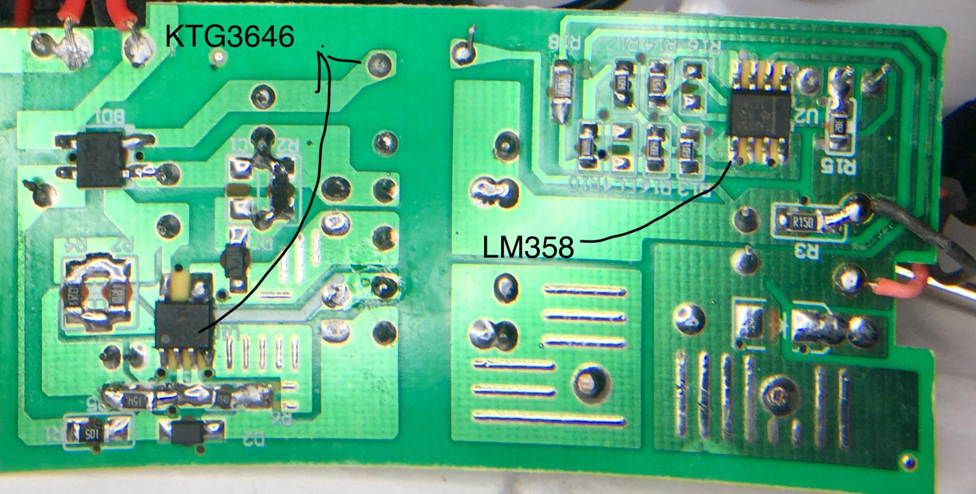

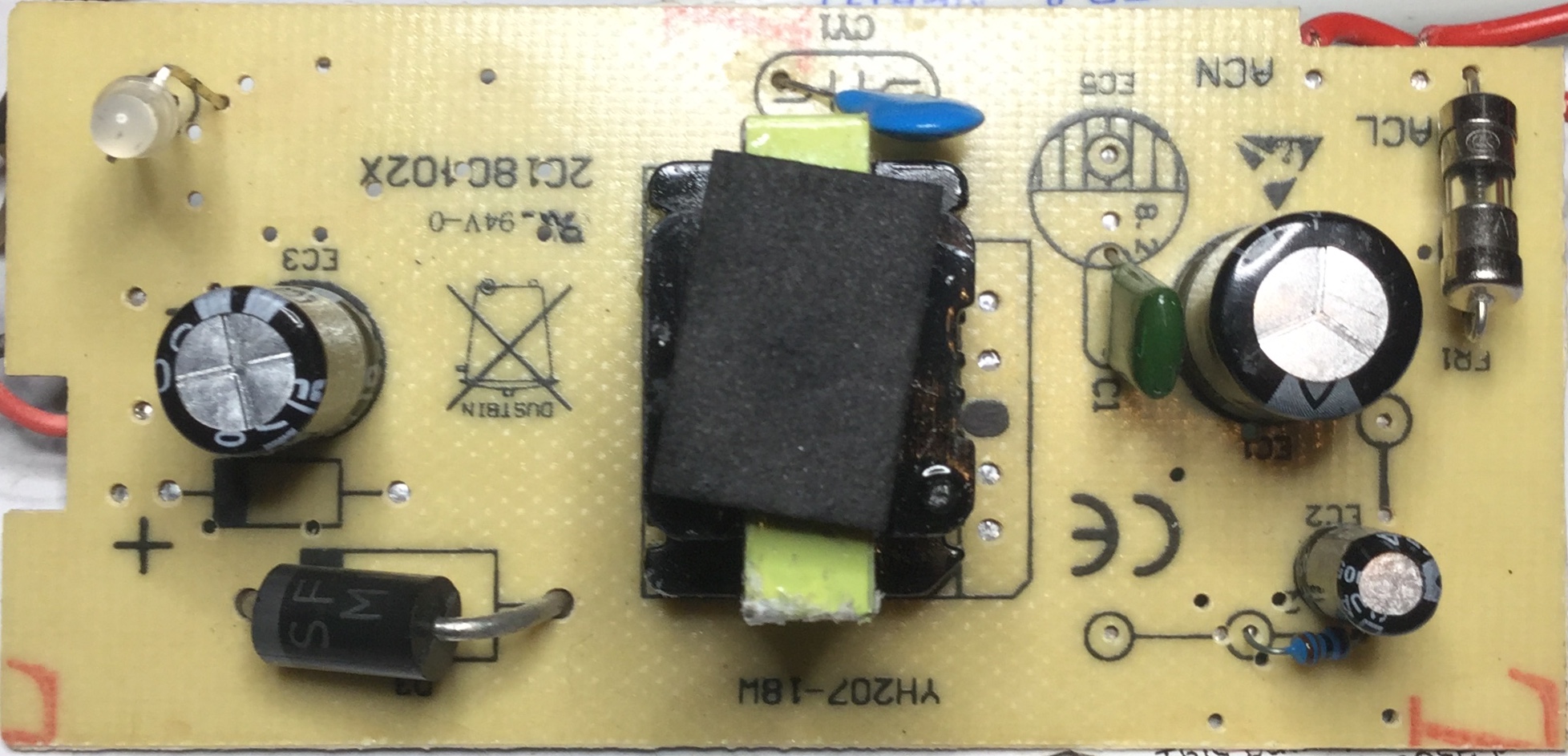

    I bought these chargers to charge 24 volt li-ion battery packs I could not find one that would be at 25 volts and the close I could come up with is this
    What resistors would I have to change to make it work at 25 volts not 29 volts
    The ic chip that is KTG3646 has a logo of ( IG ) I can not find a data sheet for it

    Re: Smart Charger 29 volts @ 1 amp how do I change it 25 volts
    It's very cheap power supply - there is no opto-coupler+voltage reference (i.e. TL431) to provide feedback to the SMPS IC and control the DC output voltage.
    It might just regulate from the aux winding, not the output. That leaves only R5, R6 and the top resistor by EC2 to tinker with.
    In other words, it is regulating the voltage on EC2 which is proportional to Vout, on the mains side.
    The LM358 and all those parts are just for the LED. You'd have rto find the IC datasheet and sketch the schematic a little, but I would not use it for lithium ion battery charging because it will always have poor regulation and it's not really a 29W power supply. The parts would overheat.
      Use a step down buck converter. That is the safest thing.
        The ic maker is Kintago, This may or may not help
          Thank you for finding the data sheet for me it very hard to read the part number on the ic chip
          This is helps a lot at
          I now understand how this switching power supply is suppose to work
          From what I read it might not make a difference but I will have try it and see how it works
          Now what I could limit the current more than it is set to now this is just a thought at this point
              If you could not read the numbers clearly, It could also be a KTG3546
                    You have the right part number the second digit was the one that I could not really make out for sure what it is
                      I did run a test on this battery charger controller
                      On a scale of ONE board does not work at all TEN board works perfectly
                      I give it a 2.5 and this might be too high of a rating
                      Here is why
                      One note the battery voltage was at 3.3 volts per cell
                      Yes it will charge the batteries however after about five minutes the temperature of the case goes to a temperature of 128*F at this point I stopped the charging of the batteries
                      You were right about it would over heat but I want to test it myself and see just how bad it could get
                        • Jul 2011
                        • 6039
                        Now I have found a way to use the secondary side of this power supply based on this reply
                        I did have to add more resistance to LED lights circuit so the LED lights would not burn up
                        It only takes 10 milliamperes to active the current sensing circuit LED light and 0 milliamperes
                        for the other LED to be lighting
                        ( the circuit works at voltage of about 13 volts and higher to about 30 volts I think I read in the data sheet)
                        I cut the circuit board and separate the primary from the secondary and use that part of this circuit to let know when the battery pack is fully charged
                        The primary side of the circuit is going to used for a low level LED module but I have to work on this circuit when I have some time for this project
