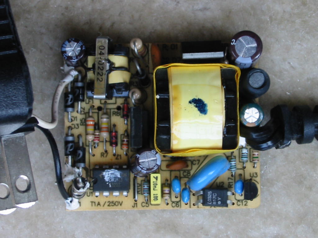

            Does anyone know the value of the to-220 resistor (R 01) in the smp t1178 power supply?
            • PeteS in CA
              • Aug 2005
              • 3583
              • USA, Unsure of Planet
              Re: D-Link router - faulty power brick?
              Got a picture?

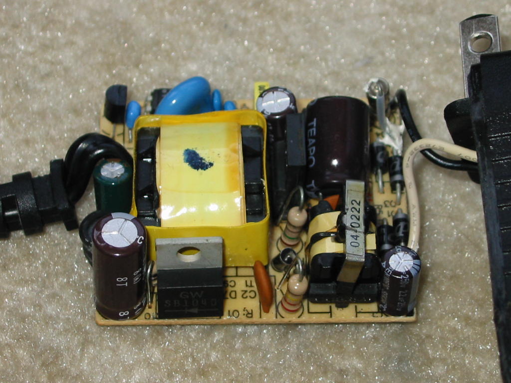

                TO-220 resistor?
                From what I remember, and the pictures I've attached previously, there are only two TO-220 devices: a MOSFET on the primary side in an isolated TO-220 case and a schottky rectifier (10A, 45V IIRC) in a regular TO-220 case.
                The MOSFET would correspond to the TO-220FP devices on the left of the below image. And the regular TO-220 device above the yellow transformer is the schottky rectifier.

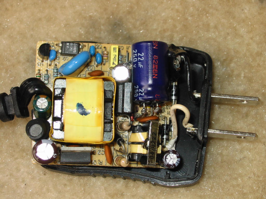

                Well, since my DI-614+ router (and its adapter) wasn't stuck too far into my closet, I dug it out to take a look inside the adapter (since I never really glued it back and only used a wire tie to hold it together - how convenient ).
                So here is what I found:
                The "R: 01" text on the PCB corresponds to the PCB version. The actual PCB designator for the TO-220 schottky rectifier is D7, and it is a SB1040 (10 Amp, 40V rectifier - my memory wasn't too far off this time, even after 10 years since the repair! )
                I'll also grab the MOSFET p/n in a few moments to get better pictures too, since I have it out already... And you will see why. Stay tuned!.

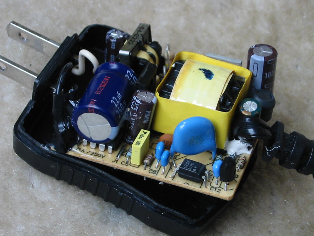

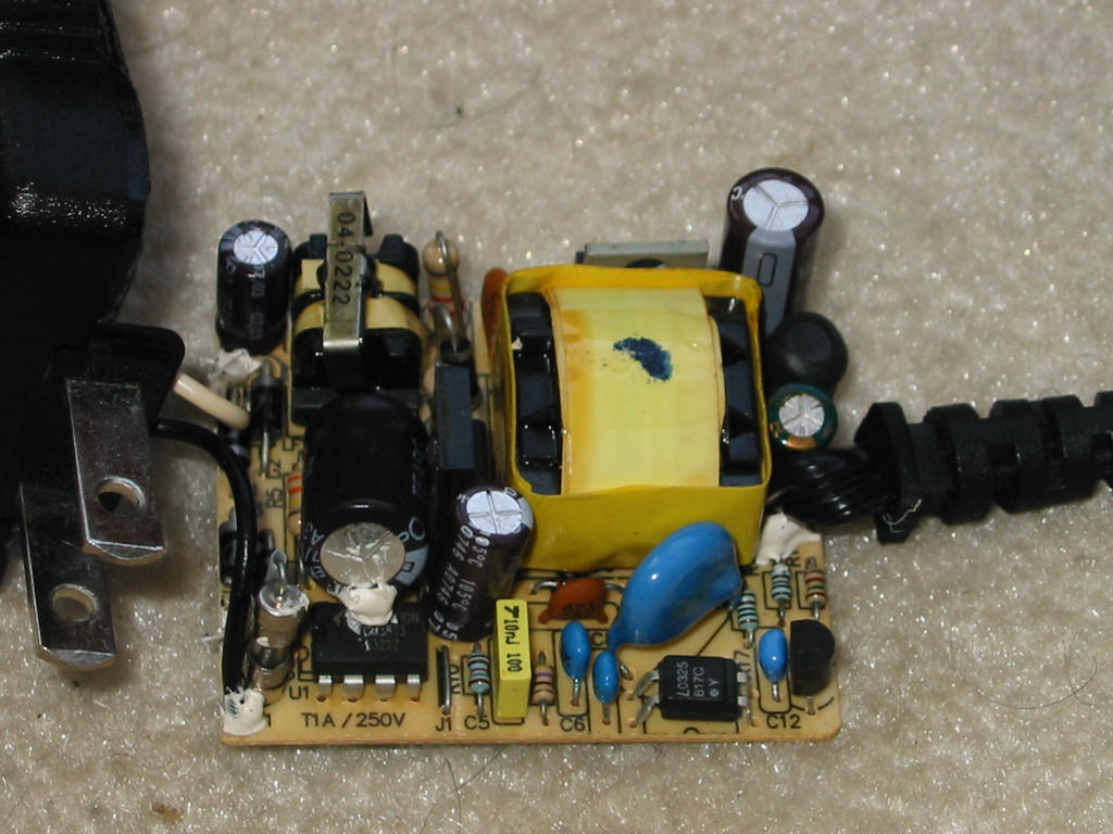

                  Alright, here are the pictures:
                  MOSFET Q1 is a 2SK2624, in case anyone ever needs to know.
                  PWM IC, U1, is a UC3843.
                  Main input filter cap is a Teapo SEK, 200V, 22 uF.

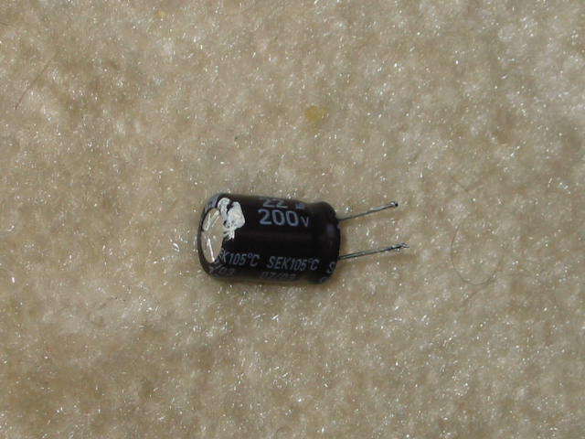

                  On that note, I'm really glad this thread got revived and I went to look inside the power adapter.
                  Why?

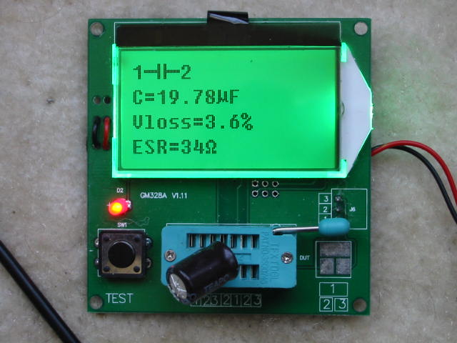

                  - Cheapo Teapo strikes again, that's why. In this case, it was the main input filter 200V, 22 uF cap:
                  It was bulged, so clearly it's failed. Don't believe me? Here:
                  Capacitance is almost OK, but look at that ESR. 34 Ohms!
                  I suppose the verdict is to replace ALL caps in this power adapter, especially if they are Teapo.

                    #29
                    That's a flyback design, so the output caps are definitely being stressed.

                        #31
                        Yup, that's why I left the 10V, 1000 uF Chemicon KZE in there. I also had 6.3V, 1000 uF KY available at the time, and even these have better specs than the Teapo SC caps original to the SMPS. Not only that, but the KY were shorter than the KZE and would have fit inside the case without having to drill a hole. However, I figured the KZE is just better for a flyback design.
                        The original issue was the small startup cap, though.
                        Unfortunately, now after all of these years, it's the primary cap that's gone bad.
                        So yeah, if it's Teapo, do a full recap regardless of the design/topology. They just don't last. I suppose the only exception is for larger snap-in caps, like in ATX PSUs - at least I haven't seen Teapo fail much there, so long as the PSU doesn't have APFC, of course.

                                #35
                                D-Link SMP-T1178 power adapter recapped
                                Well, good news: I found a 250V, 22 uF Panasonic SUW cap in my junk bin. I think it came from a scrap CRT TV board (I used to bike around and collect parts from busted TVs I saw on the side of the road when the copper scrapers would break them for the deflection coils.) It's only an 85C -rated cap and also considerably larger than the 200V, 22 uF Teapo SEK... but I managed to make it fit.
                                Before soldering it in, I checked it on my cap meter. Capacitance was in spec: around 23 uF. ESR wasn't great but not bad for a cap of that size either - about 0.75 mOhms. Honestly, I've seen CapXon and other crappy cap brands read much worse in LCD monitors - and those were caps that were much bigger too. So I think this one is going to be fine.
                                Also, for those of you worried that the fuse could arc over: I put 2 layers of electrical tape and a bit of hot glue between the fuse, main cap, and the PWM IC. I guess heatshrink tubing would have been better, but I would have had to desolder the fuse to put the heatshrink on it, and I was too lazy to do that. So hopefully the electrical tape and hot glue can calm your fears.
