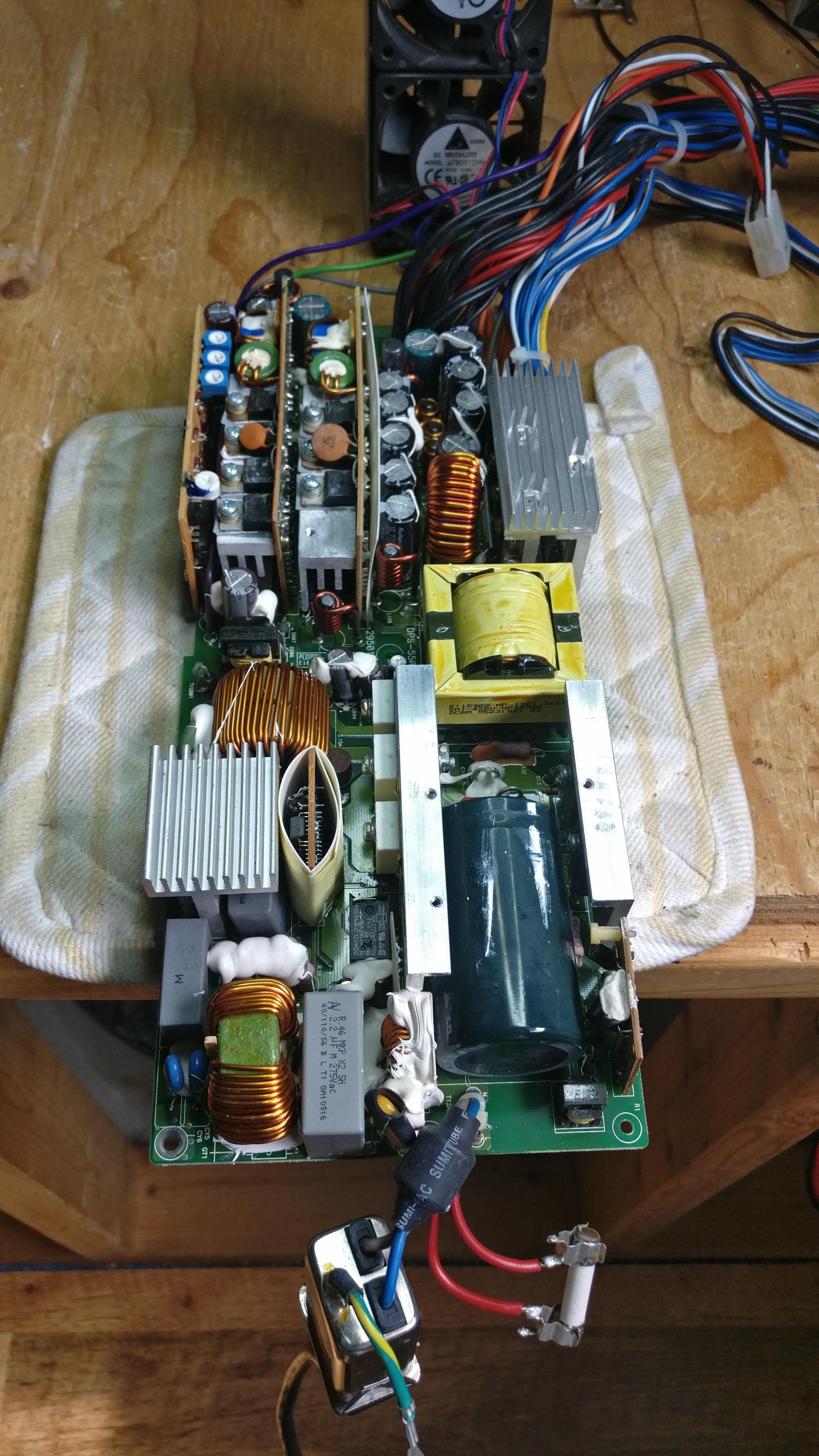

Dell D550p Not Starting
  • mmartell
    • Oct 2013
    • 3189
    This is from a Precision 470 and is my back up supply.
    This was dead and had blown the fuse. Found a shorted 24N60C3 in what I think is the PFC circuit and replaced it and its companion for good measure.
    The supply starts fine into standby with a good standby voltage present. When asked to power up the secondaries it ticks several times a second until the power is pulled.
    I am using a dim bulb tester with a 100w bulb when trying to start it. The lamp lights in unison with the ticking.
    Is this indeed the PFC section and should I be looking at the driver ic that is probably on the riser card beside the heatsink ? Can I test the drive signal without pulling that card ?

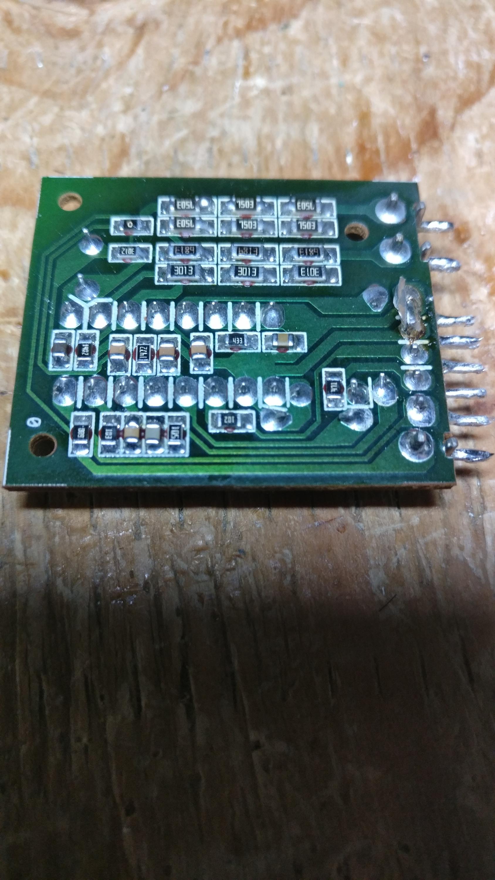

    Re: Dell D550p Not Starting
    Pics....
        Ticking can be due to a short.
        Have you checked all secondary rails to make sure they are not shorted?
        Ticking can also be due to bad startup caps, check the small caps on the primary side, or just replace them.
        That the light comes on briefly is normal, that is the main capacitor charging up.
                    Well, at least you can buy that chip at UTSource if it's blown.
                    Can you post some more photos? Which heatsink has which devices? What are those 3 white things on middle heatsink? I'm guessing sense resistors? Where's the PFC FET and diode?
                          Well if the two MOSFET are on that heatsink, maybe the third device is the diode? I can't see anywhere else it might go, then.
                          I'm guessing the PSU switching transistors are on the far right heatsink next to the filter capacitor and transformer.
                          Which means the smallest heatsink on the left next to PFC coil must be for the bridge rectifier, since I can't see it anywhere else.
                          As for lightbulb, I'm not sure, sorry.
                          I do notice that the little relay next to the PFC controller board looks broken on one end? It's not got contacts jammed or something?
                            Yes, the bridge rectifier is on the left and I would guess you're right about the switching transistor being on the far right heatsink. The diode next to the 24N60C3's on the middle heatsink does not test shorted.
                            Nice catch on the relay. Ya I was a little rough and busted part of the lid. Shouldn't cause a problem like I'm seeing should it ?
