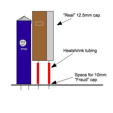

    The big issue is where to obtain suitable replacement capacitors. Radio Shack does NOT have any suitable "Low-ESR" caps that would be used in a power supply.
    Additionally, Antecs usually have odd-sized caps from a disreputable vendor named "Fuhijju". (typically a 10mm diameter can where reputable makers use a 12.5mm∅)
    When you obtain suitable caps (some are available right here at BadCaps.net) the actual capacitor replacement is not especially difficult. The older Antec PSUs used easy-to-solder single sided circuit boards.
