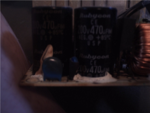

    i was cleaning out my closet when i found this old agi 235w power supply:
    it came from an old proteva with amd k6-2 350mhz, noname mobo, and lots of other shitty parts. obviously came from a chain smoker:
    see all the nicotine?
    also, notice the second plug in foreground. this was made when at and atx were both in production.

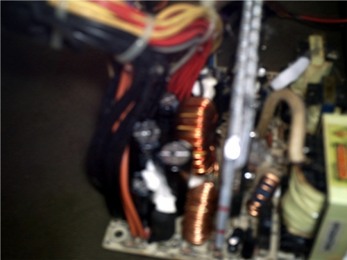

    wimpy heatsinks:
    rubycon primary caps:
    decent amount of secondary caps (sorry this is the last pic- my camera batteries died and im out of aaa's):
    more secondaries on board (total of 10 ones with vents , one of those is tiny (dia 4mm))
    secondary caps su'scon
    no thin wiring
    what should i do with it?

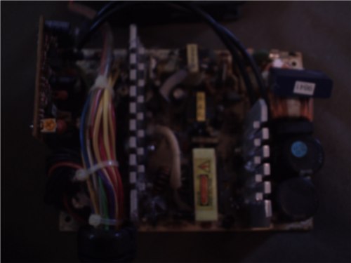

    ps- what is the potentiometer for? (3rd pic center, left, orange) i have a few with those near the fan. do they control fan speed? if so, which way make the fan go faster?

      Those are decent sized heatsinks for only a 235W. Not much you could use it with though, so I don't know.
      FYI these old AGI's are bestecs.
      That pot is probably for adjusting the fan or some rail or something...sometimes psu's will have the pots for adjusting the fan's high and low points on a controller board like that.

                                  Hi Ratdude
                                  Maybe.
                                  Only an Oscilloscope can tell for sure, and for that you'd want it under load as well.
                                  If you want to recap, Oklahoma Wolf noted an odd thing. (I did too) Sometimes those "Lousy awful cheap Chinese Crapacitors" do OK.
                                  Sometimes better than a nice Japanese Low-ESR replacement.
                                  I noticed this when replacing OST with Nichicon PW and Rubycon MBZ..... The OST looked better on the scope! O.W. thinks that sometimes the circuit design might be optimized for the particular caps the PSU came with.
                                  BTW, what's the Date Code on those caps? The BadCaps plague started around 1998 or so didn't it? Earlier than that might be OK. Of course they could be deteriorated from age.

                                      update: i checked voltages:
                                      3.3- 3.36
                                      5- 5.16
                                      -5 = -4.96
                                      12- 10.66 no fluctuations
                                      is this ok or bad?
                                      sigpic
                                      (Insert witty quote here)
                                        Re: 235w agi advice
