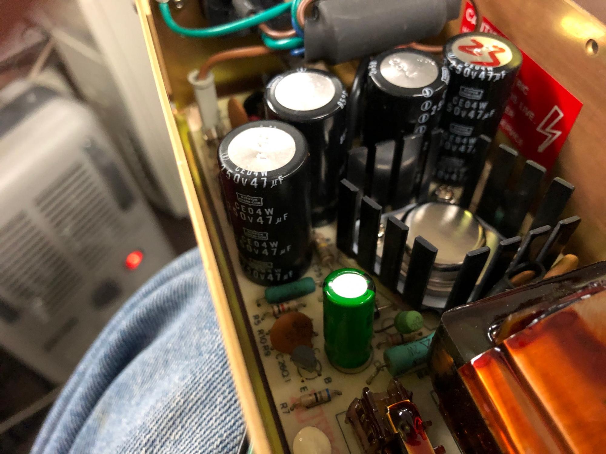

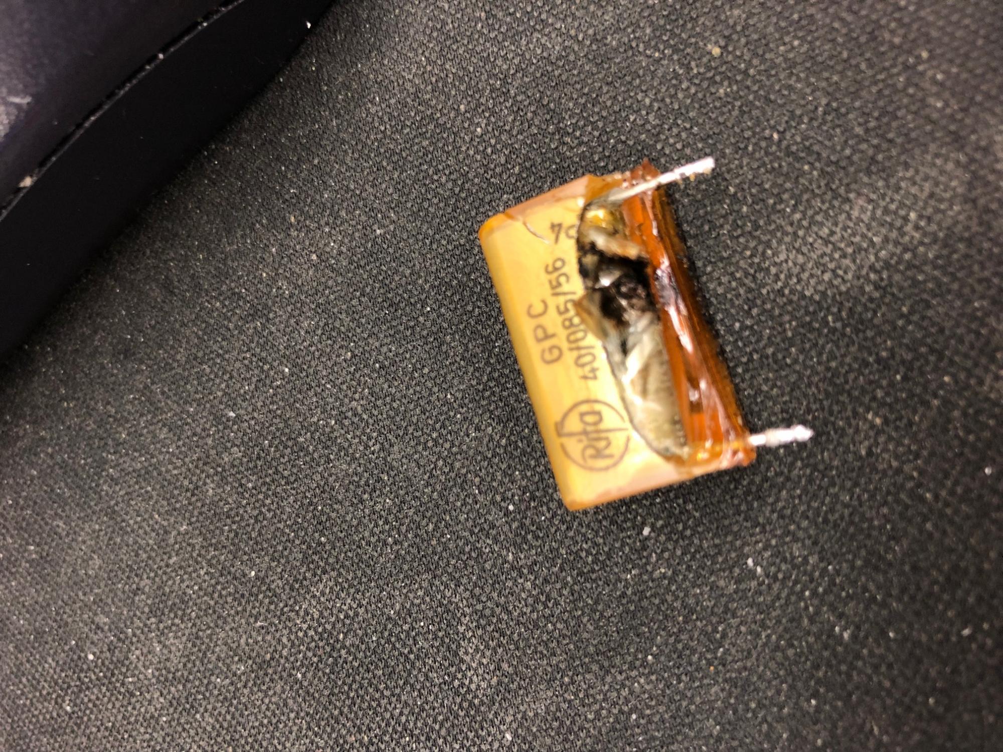

    bought a used apple ][ plus for a reasonably amount, I had it on a total of 3-4 min, while i was on i started to hear a soft sizzle noise and turned it off immediately, good news was it was still displaying digdug on the TV while I was turning it off.
    I haven't taken it apart yet but i suspect bad RIFA caps and I was wondering how to select replacments. I would imagine its the same as other mobo caps where you can go higher but not lower. anyways I'll take some pics after I get it apart, I had it powered on at my place of work and it really stunk up the place

    Apple II power supply Astec AA11040 or AA11040-B schematic etc. https://cdn.badcaps-static.com/pdfs/...e740ec8475.pdf
    Have to look inside to see what part is failing.
      • 31214
      Re: Apple ][+ Astec power supply
      panasonic sell suitable PolyPropylene caps that are cheap.

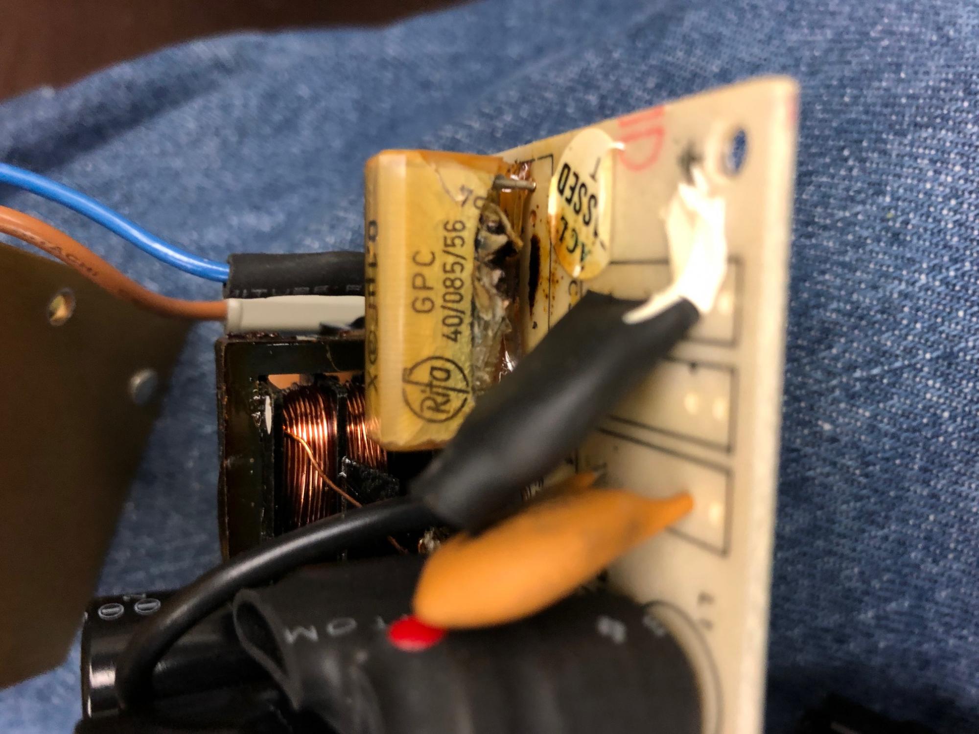

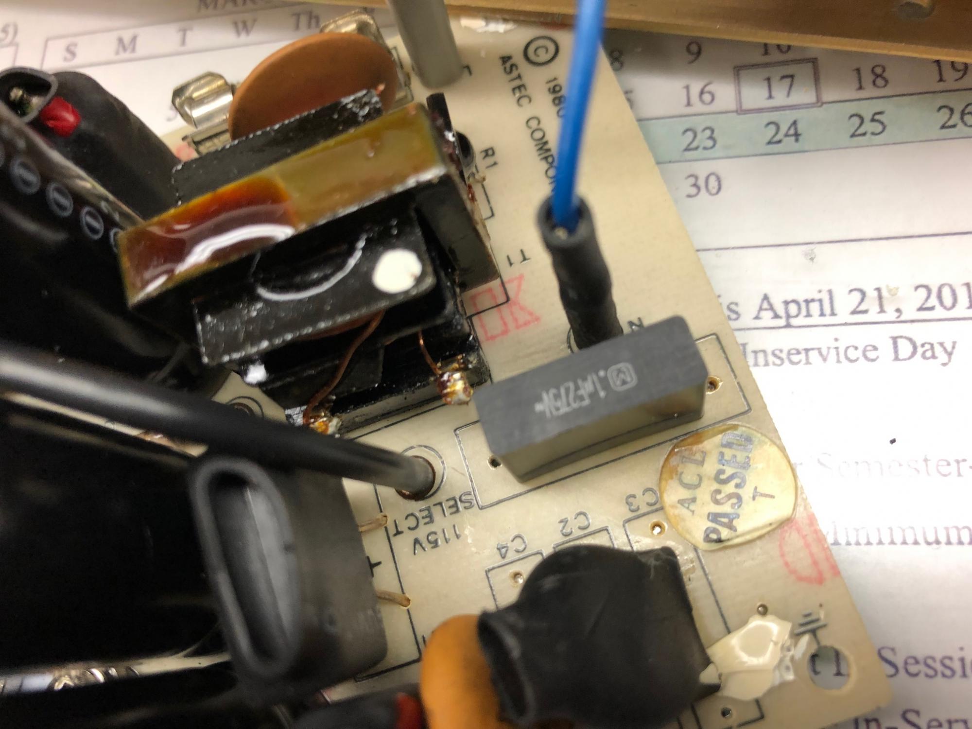

        allrighty got it open indeed the rifa blew but doesn't look like it made to big a mess its a 0.1uf cap 250v i think. I found this site https://www.reactivemicro.com/produc...-power-supply/
        thought that would be a good replacement. any thoughts?
          I found these would they be suitable? https://www.ebay.com/itm/5pcs-1uF-0-...d/122034179568
          My Computer: AMD Ryzen 9 3900X, Asrock X370 Killer SLI/AC, 32GB G.SKILL TRIDENT Z RGB DDR4 3200, 500GB WD Black NVME and 2TB Toshiba HD,Geforce RTX 3080 FOUNDERS Edition, In-Win 303 White, EVGA SuperNova 750 G3, Windows 10 Pro
            • 31214
            that's good, but way overpriced.
            you should be paying around 25c each!!
            https://uk.rs-online.com/web/p/polye...itors/8697466/

                                allrighty shes up and running again, the panasonic part fit perfect and flush since the board had a second set of closer spaced holes for the smaller part.
                                I probably gamed on it an hour loading games through the cassette in jack using the appleiionlinegameserever.

                                  That is one french-fried X Cap! Dual mounting holes was not uncommon, allowing the use of vendors with different lead spacing and package size.

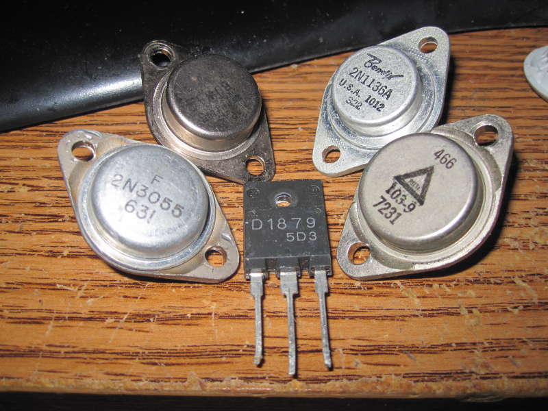

                                    Anyone got pictures of a french fried or bloated X/Y cap (certified by UL or whatever safety agency in your locale) that's not a Rifa?
                                    I have yet to see one, and still feel convinced the old Rifas are Replace On Sight... which I'm failing to do because I know I have Rifas in my old Tek scopes, and probably other stuff...
                                    And a picture of a bunch of ???
                                    2N3055 Si-NPN "TO-3"
                                    BUW44 Si-NPN "TO-204"
                                    D1879 Si-NPN TO-247 isolated
                                    2N1136A Ge-PNP "TO-204"
                                    466 103-9 Ge-PNP "??"

                                      Yes! Those round ones are what I were thinking about! The one on the upper right 2012? (Or is that just another way of saying that it's the third year of a previous decade, such as 1992 or 1982?)
                                      (And if in the international-year-of-manufacturing-format, it would mean 2010 or the first year of a previous decade, such as 1990 or 1980, for example, I would think.)

                                        Hah... None of these TO-3/TO-204s were made this century!
                                        As far as I know of the pictured transistors:
                                        BUW44: made in 1980
                                        2N3055: made in 1976
                                        2N1136A: made in 1973 (as far as I can guess)
                                        466 103-9: made in 1972 (same deal)
                                        2SD1879: no clue, not looking it up, but likely 1990s.
