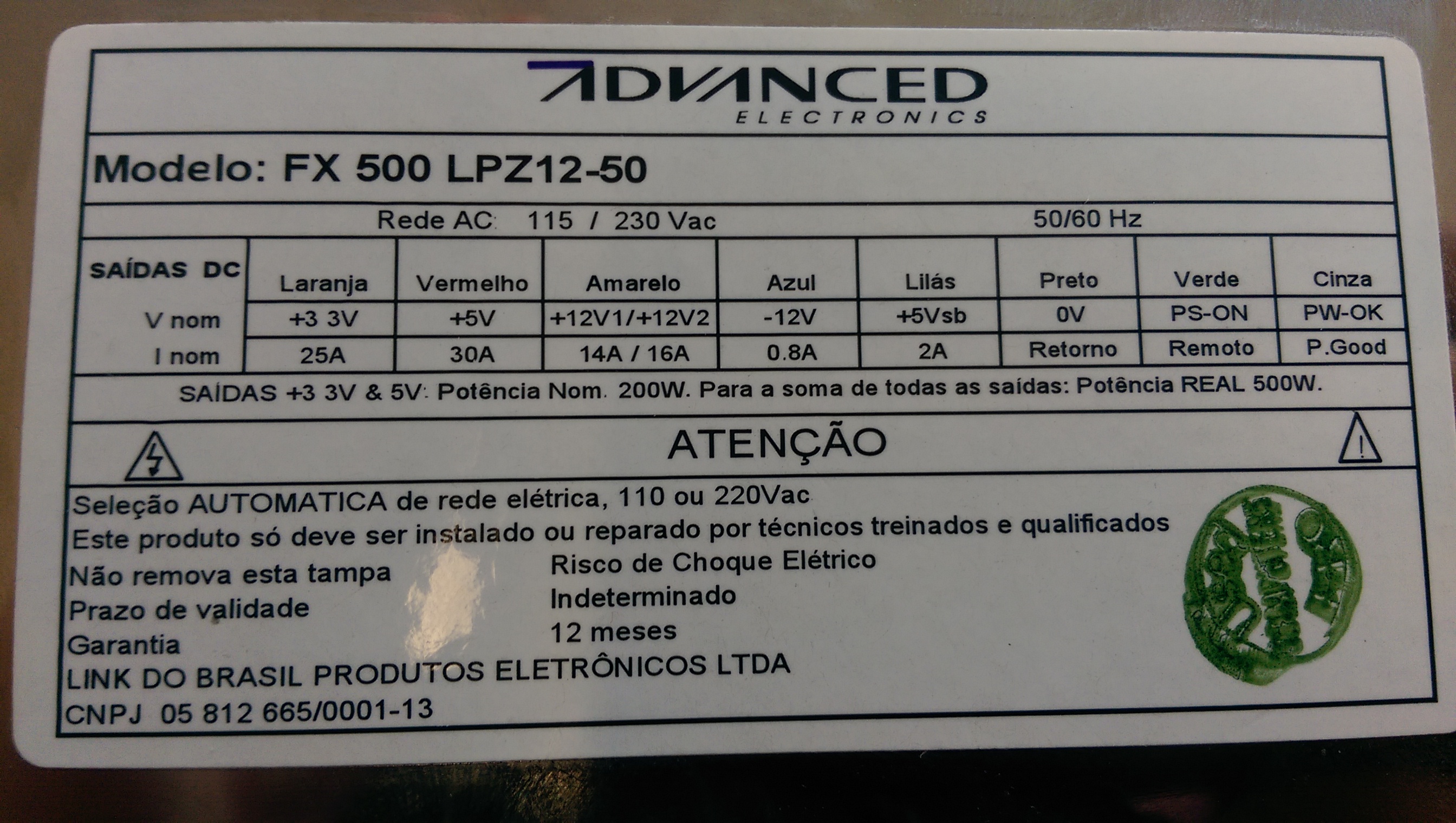

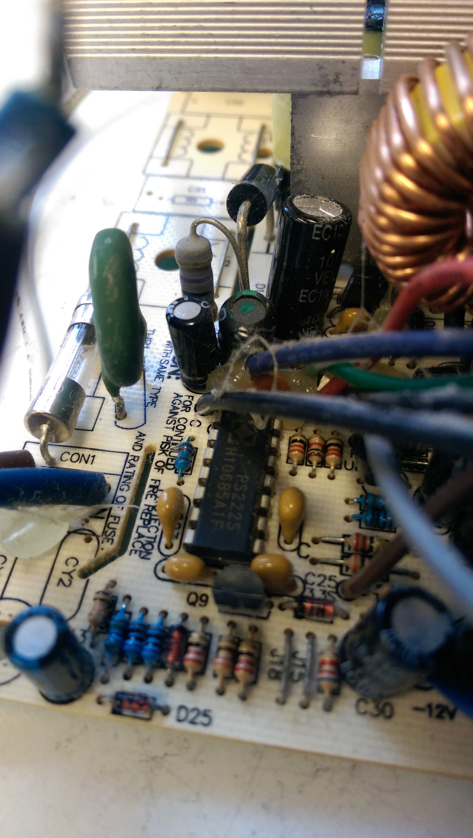

        Advanced electronics fx 500 lpz12-50

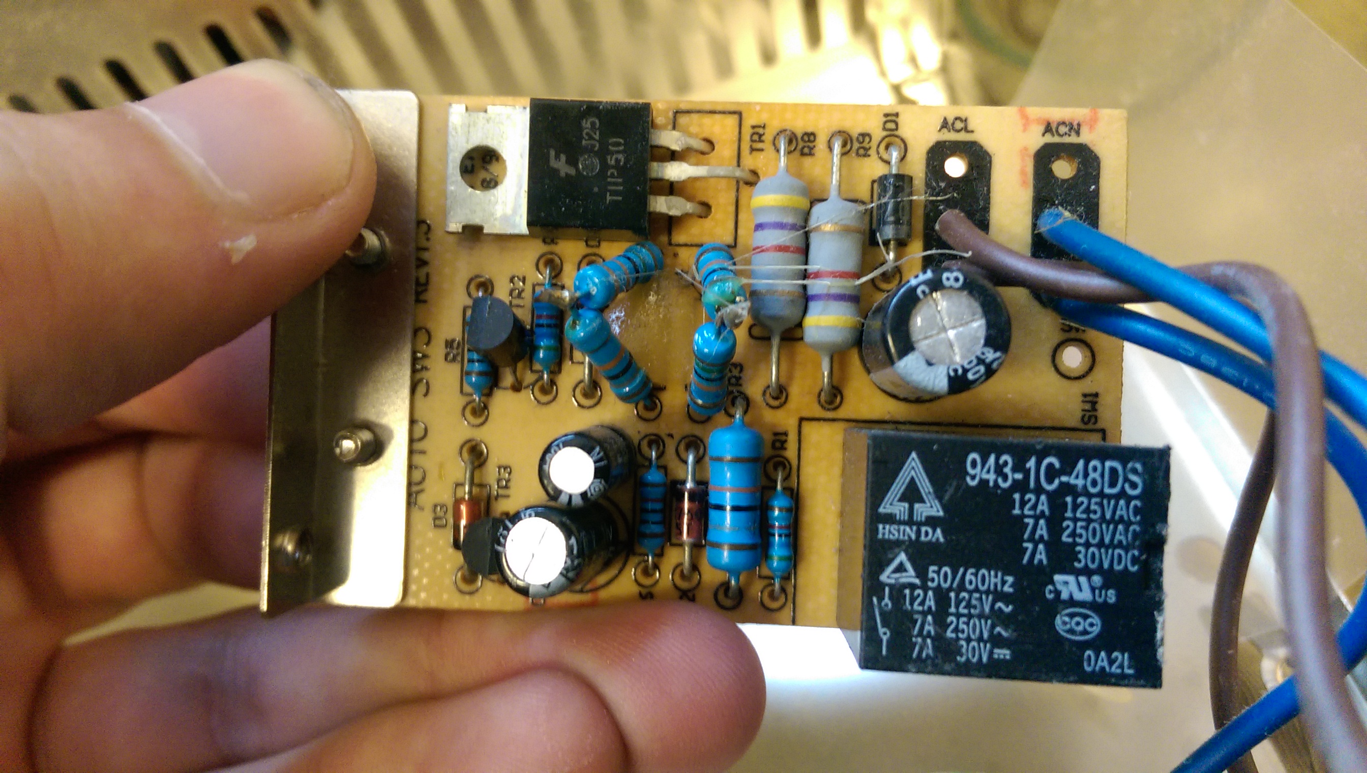

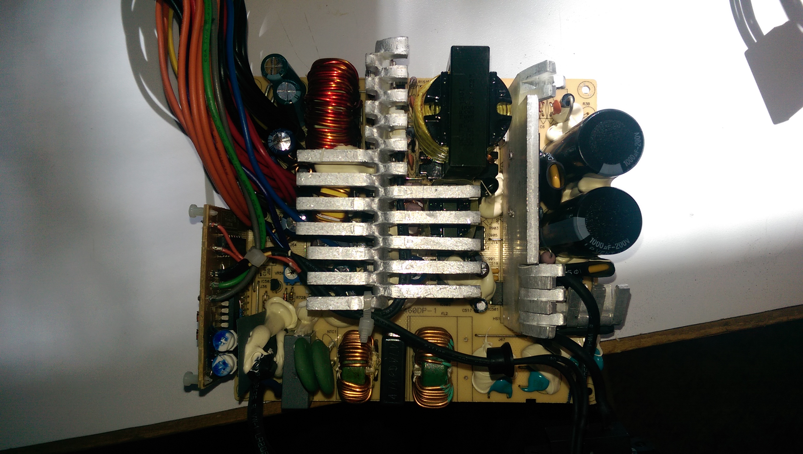

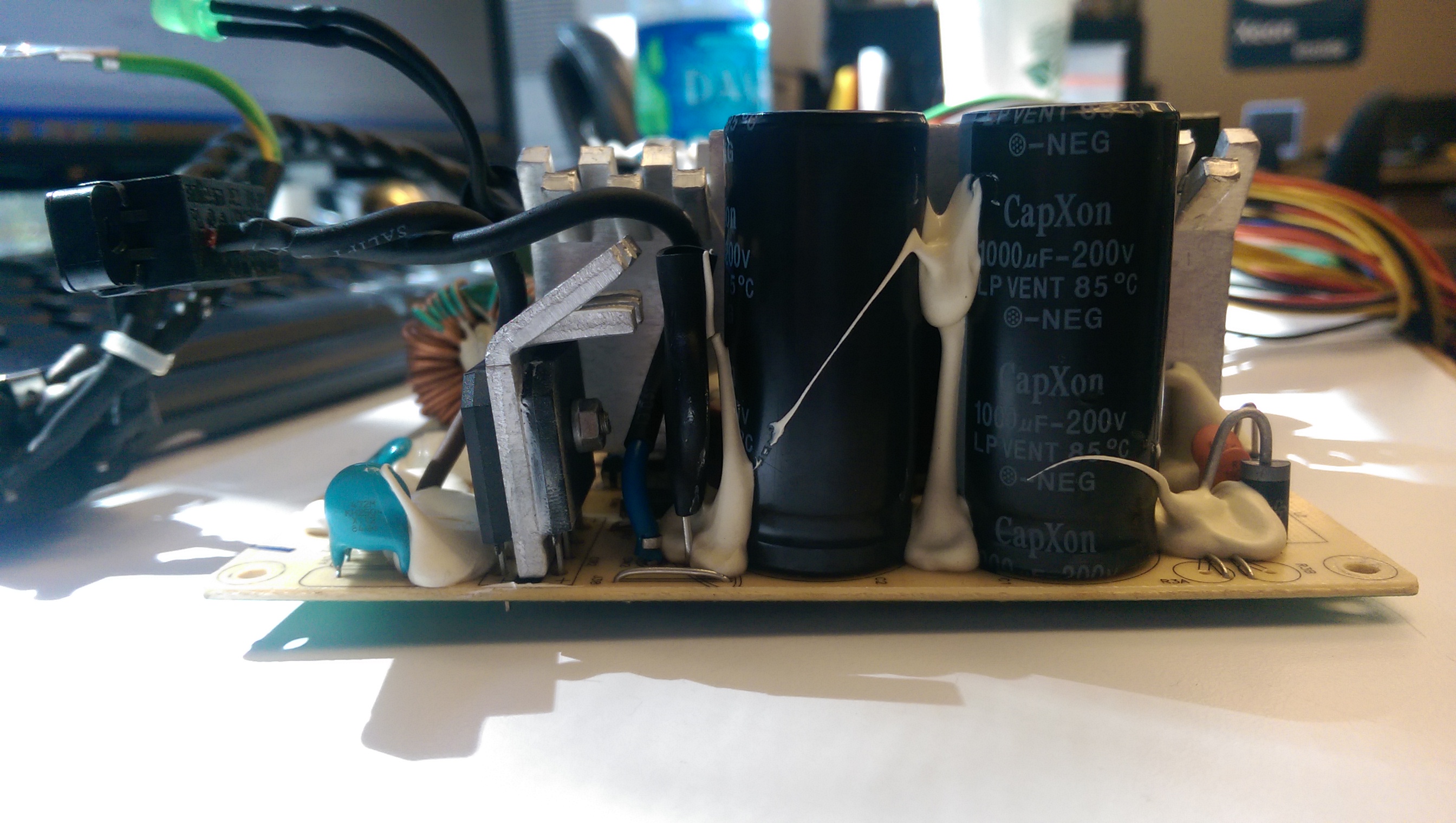

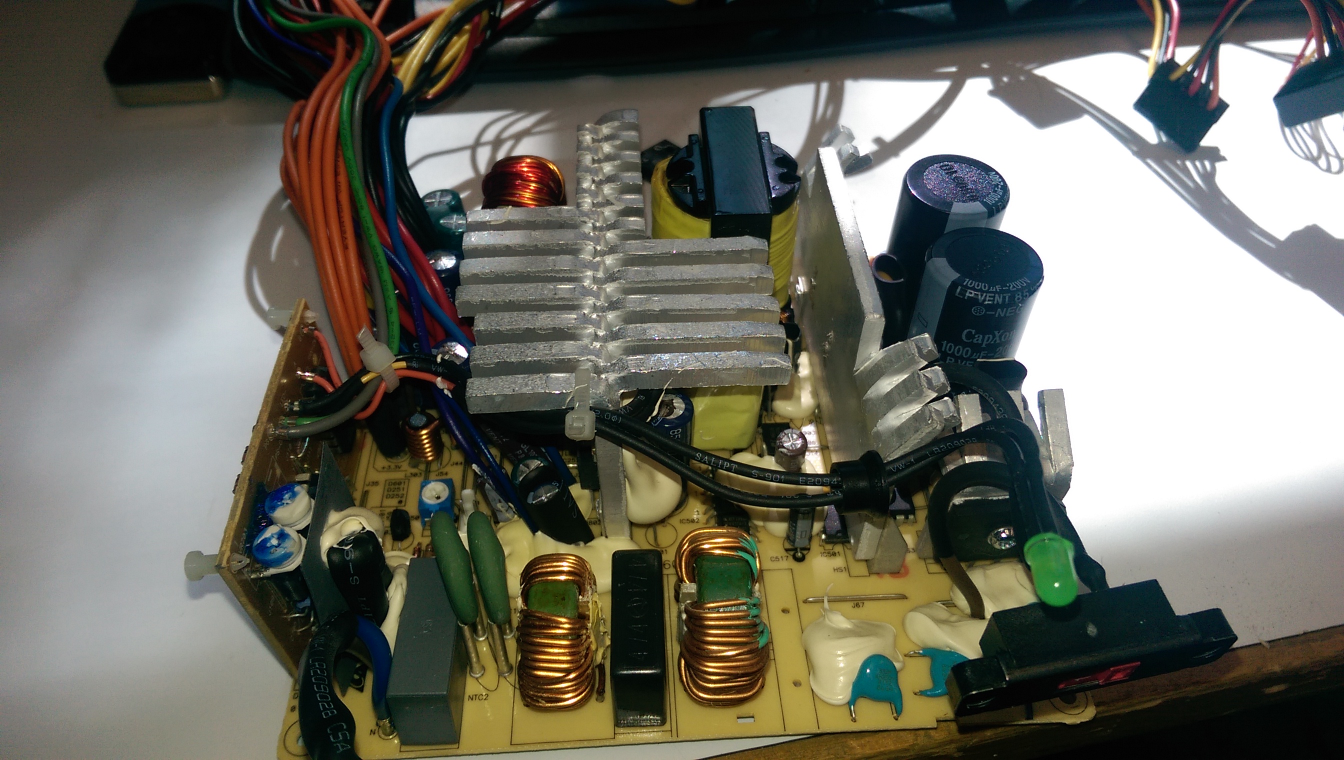

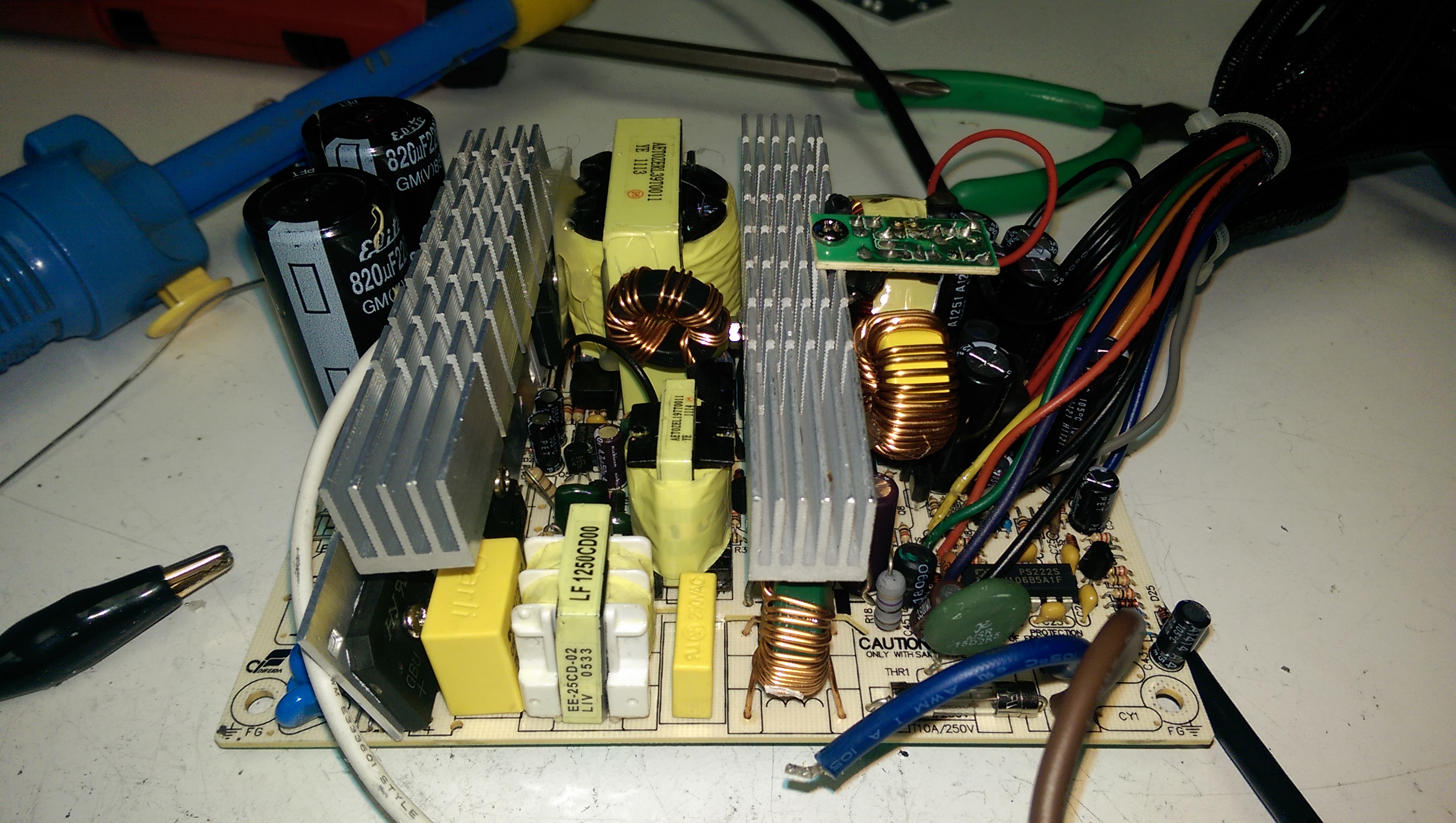

        Came across an interesting PSU so I decided to post it. I think it's made by XHY Power? http://www.xhy-power.com.cn/ But it looks so similar to a KME I have. It uses PFC (kinda) for full range, I recapped that part first. That bigger caps' value is 4.7uF 400V originally Canicon, replaced with nichicon VC. No input filtering was installed except for those lousy "Y" caps that look damaged from the factory. I assume normal input filtering won't mess with that PFC circuit?
        As you can see, it was designed for a normal PFC circuit
        10A bridge, the two FET's on the primary are HFA9N90 rated for 9A each @ 25C and 5.7A @ 100C, combined with a TL3843P. The input caps are 1000uF 200V Fuhjyyu, they read 904uF and 909uF. 5VSB transistor is a Toshiba C5353 rated at 3A
        The secondary looks pretty decent, with a huge heatsink, 30A (MOSPEC) schottky for 3.3V, two 40A (ST) schottky in parallel for 5V, and 30A (MOSPEC) schottky for 12V (All TO-247) Each rail has CLC, and the toroids look big. There are actually two 12V rails with OCP shunts, only the 12V CPU connector is on the first rail, and towards the end of the 4 pin plug, one of the wires is split into two wires going into the same pin. Controller is a PS222S https://cdn.badcaps-static.com/pdfs/...ec01b02f46.pdf
        Soldering looks pretty good except for some big blobs.
        Definitely going to fix this!
        Let me know what you guys think.
        EDIT: Cap brands used: Canicon, Fuhjyyu, Jun Fu, Forever, JUNZL, Asia'X, and EU CAP

          Wow! Definitely a keeper!
          Soldering looks nice. Toroid coils are good.
          The add on board could be automatic voltage selector pcb. If it were APFC it would have a toroid coil, a mosfet and a diode.

            It's definitely unique Yeah I didn't know what to refer to it as since it's not even like some of the piggyback PFC circuits you've posted here.
            I looked at the soldering more carefully and even the -12V rail has a CLC filter. But here's the strange thing...see that little cap I circled? That's being used to filter the 5VSB!!!! It's branded Forever (no series) and only 100uF 16V. It read 108uF and 0.46Ω ESR. Seems perfectly in spec to me.

              Nice. Looks like it even has multi-rail OCP on the 12V side. I would use a larger 5vsb output cap than that if you can get one to fit, though.
                Awesome. I was thinking about adding another rectifier on the 12V but it looks like it'd be a tight squeeze between the transformer. Plus, what I'm probably going to use this for I doubt I'll need more than 30A on the 12V.
                Yeah I'm going to try and fit a 1000uF 8mm Panny FR in there. I try to use lower ESR for the 5VSB

                  I ended up replacing that 100uF 16V Forever cap with a 470uF 6.3V Chemi-con KZH. It's the best specced cap I could get to fit in that small space. I also did a full recap, fixed blobby/weak joints, and added a useful input filter consisting of two coils, 0.1uF & 0.47uF X caps, and two Y caps. I also made use of a crappy Leadman heatsink by cutting it and using it as a heatsink for the bridge rectifier I like how the BR is positioned because it allows for a decent sized heatsink. The thing seems to be efficient, testing with a 100W load it's kicking out room temperature air, and the fan is spinning very slow. I'm sure double forward and the huge heasinks have something to do with that.
                  I first tested this thing using a paperclip and since there are no minimum load resistors except on the 5VSB, every main rail was out of spec except the 3.3V (Which read 3.36V). The 5V read 5.73V, 12V read 13.33V

                    You can feel airflow from it when it's spinning that slowly? Looking at the HFA9N90 datasheet, they ("SemiHow" .... "Know-How for Semiconductor" ... ) seemed to have lifted the specifications straight from FQA9N90C's datasheet excepting the power dissipation limit (110W vs. 280W @ 25*C). Rather impressed that the bulk Fuhjyyu capacitors are in spec.
                      That's the most beautiful thing I've seen!
                      Why has it not been a standard component in powersupplies for the last 50 years untill APFC was invented!?
                      I did not know that a relay like that even existed, never seen it before!
                      In 230v land the most fun thing for students in school has been to set the voltage doubler switch on "115v" when the machine is running.
                      I can tell you it is spectacular!
                      Pretty easy to see why: √2 * 230VAC = 325VDC
                      Now put that through the voltage doubler circuit by flipping the switch and you are feeding the main filter caps 650VDC!
                              Wow, only a 100 uF cap to filter the 5VSB rail?! Shame they did this on an otherwise such nice PSU. What is the bigger cap next to it for?
                              Glad you recapped it, it looks like a trustworthy PSU. Although, I should note that those twisted series resistors on the voltage switch board look funny. I wonder why they did it this way. Perhaps to use lower-wattage resistors in place of a bigger one? I only did that once in a CRT monitor when I just couldn't get the right resistance. Other than the looks, I guess it works fine .
                              Probably because it's more expensive.
                              Computers also weren't so user-friendly back in the days, so I guess no one cared.
                              This couldn't happen if you bought cheap L&C, Hyena, and Premier PSUs with a "AC 230V only" sticker, though . Because, you know... a voltage selector switch costs money and ain't nobody got time to put that .
