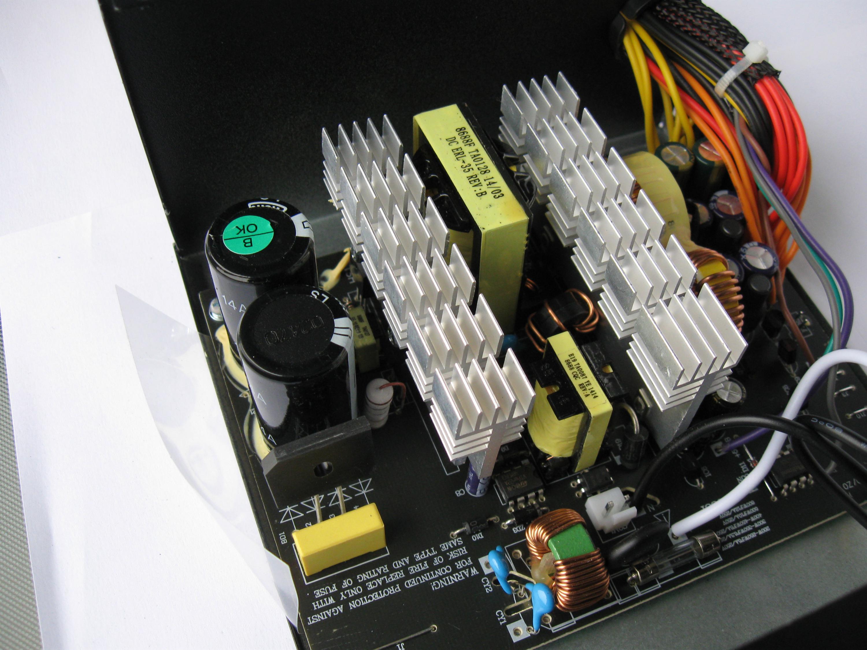

                Hey, I got a Tacens Radix Eco II 600W:
                http://www.tacens.es/fuentes-de-alim...ix-eco-ii-600/
                Does anyone know the OEM of this thing?
                  • 31296
                  #2088
                  lol more like 350w
                    300w maybe.

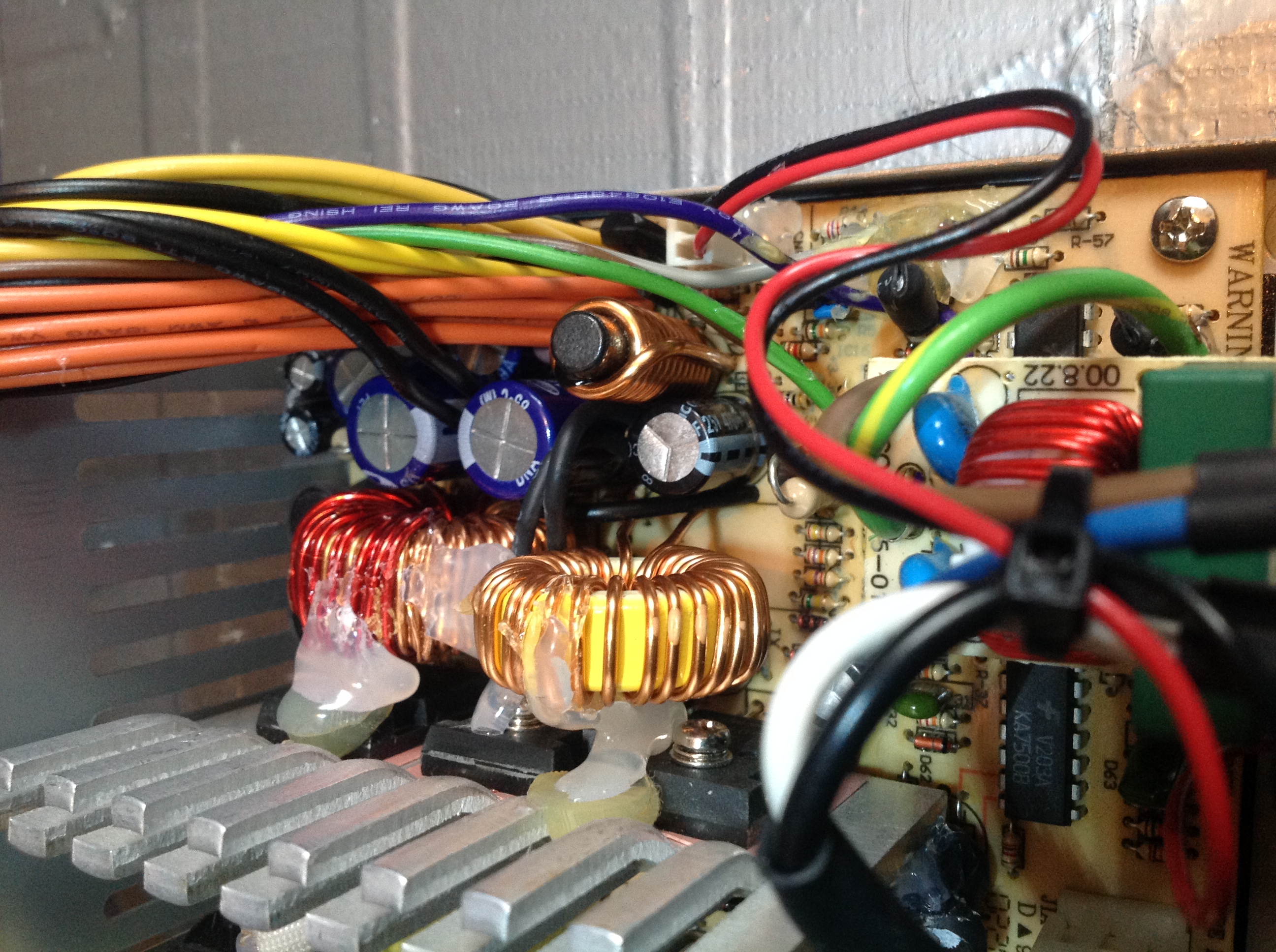

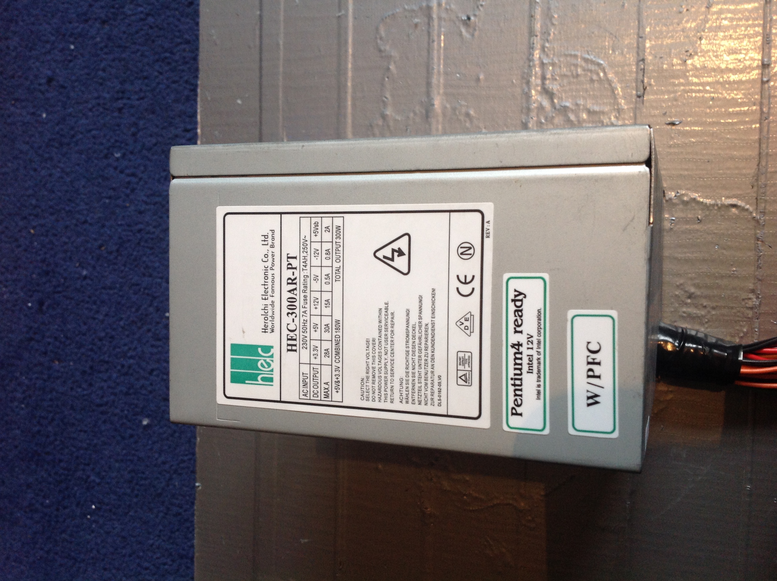

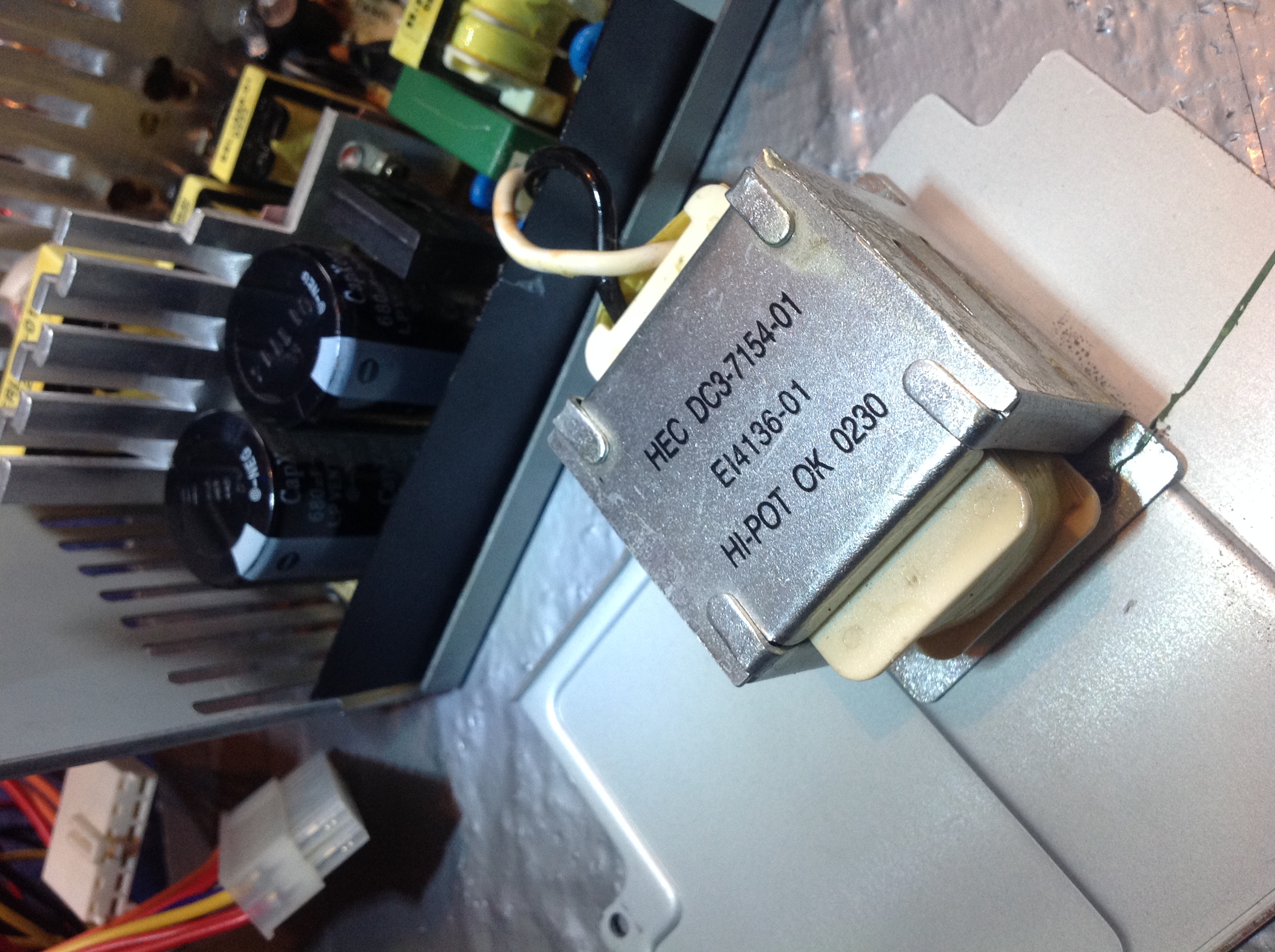

                      Got an Hec 300arpt oldie but a goodie, got off carboot for 99p so a good deal weighs a tonne due to a huge passive pfc coil and thick steel case very well build going to recap and should be a solid unit
                      Specifications listed:
                      Sleeve bearing power logic slim line fan I used this because the old hec fan spun so fast made this psu unusable for a standard desktop due to being so loud also there was a lot of wind turbulence created because if the passive pfc coil covered half the old fan, it was rated at 12v .43 a :O
                      Primary transistors TT2144
                      Passive Pfc
                      Output rectifiers:
                      3.3v Mbr 4045pt
                      5v Mbr 4045pt
                      12v s3040pt
                      Bridge rectifier BgPbu605
                      Output capacitors:
                      3.3v 2* 2200uf 10v samwha will be replaced with 1* 3300uf Panasonic Fc 1*2200 uf 10v Panasonic Fc
                      5v 2* 2200uf 10v samwha will be replaced with 1* 3300uf Panasonic Fc 1*2200 uf 10v Panasonic Fc
                      12v 1* 2200uf 16v samwha 1* 470uf 25v jamicon will be replaced with 1* 3300uf 16v Panasonic fc 1* 2200uf 16v Panasonic Fc
                      Primary unit 2* 680uf 200v capxon
                      The rest of the capacitors are pce tur
                      Defiantly 300w will be great after a good recap.
                        Tacens uses whole bunch of OEMs - Huntkey, FSP, CWT, Andyson, HEC, Enhance. But this one does not ring any bell…

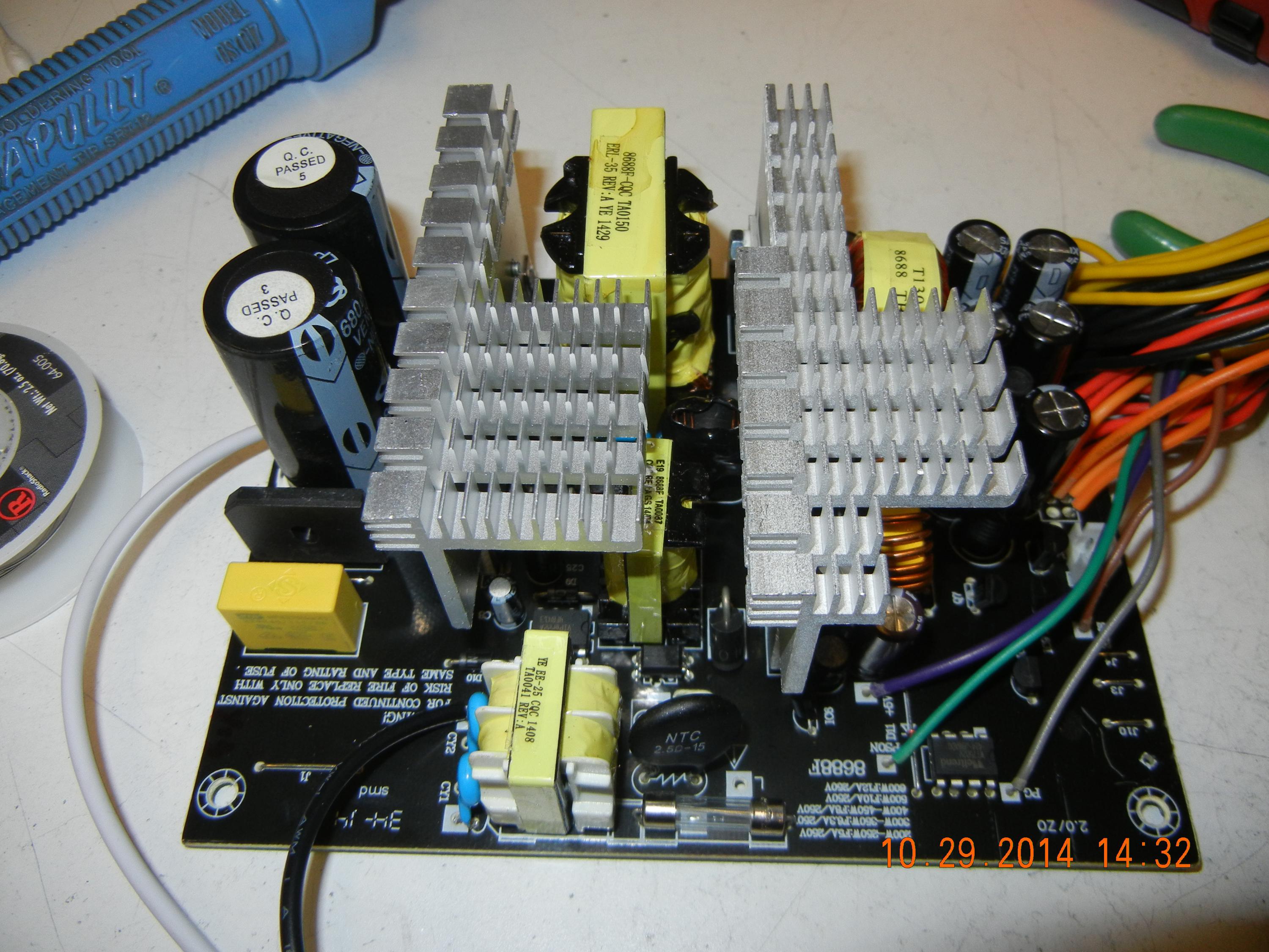

                          Whoever it is, it's the same as the new EVGA PSU I just recapped. I think it's good for at least 400W. Uses double forward with two 16A FETs on the primary, two 20A schottky for 12V with single rail, and 30A for 5V and 3.3V

                                    #2097
                                    8688F doesn't turn up anything, and UL on mine only goes back to EVGA. Behemot, it kinda looks like the Zalman ZM400-LE that you reviewed
                                    • Behemot
                                      • 4845
                                      • CZ
                                      #2098
                                      It shares some similarities but all these generic chinese PSUs are the same. Two-transistor forward with PWM IC stand-by, magamp for +3,3 V.

                                        #2099
                                        Yeah, but they're double forward. Idk, they look like the same OEM to me http://translate.google.com/translat...20%26bih%3D933
                                        And they both have abnormally barren on top side of the PCB, as in not many resistors, zener diodes, etc.
                                        • Behemot
                                          • 4845
                                          • CZ
                                          #2100
                                          Oh yeah, mistaken them, I do it all the time 2 transistor OFC.
