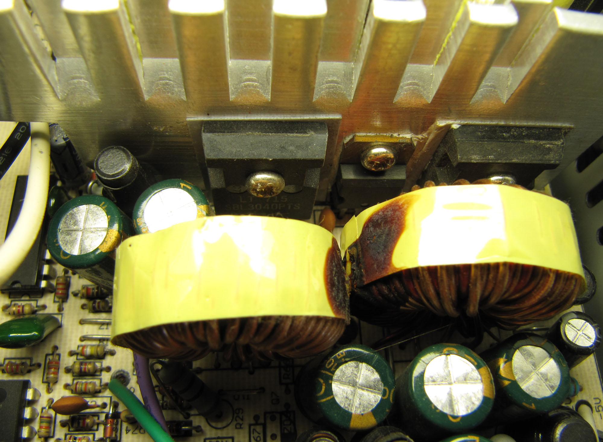

            ATX-500W
            As the "LY-320B" on the PCB implies, this is a 320W max psu.
            The fuse is blown and the main switching transistors (2x 2SC2625) are shorted.
            One of the primary capacitors bulged from top and the bottom and desoldered itself from PCB trying to launch!
            I checked the bleeder resistors and I was pretty sure that one of them would be open. But they were found ok! Considering this unit also lacks any active PFC, that cap should not have failed. "H.Q." caps should be called "T.Q." as Terrible Quality capacitors.
            -4x IN5408 3A diodes instead of a bridge rectifier
            -13005 4A 5vsb transistor
            -2x 2SC2625 shorted NPN switching transistors
            -SBL3040PT @ 3.3V
            -MBR3045PT @ 5V
            -STPR1620CT @ 12V
            All the output voltages have filter coils and the positive voltages have 2x 1000uF "H.Q." caps.
            The main transformer and toroid coils are good for 300W.
            Does anyone know who is the OEM? The PCB layout is very similar to Macron Power 300/350W.
            The fan is "WAM".
            Not worth repairing.

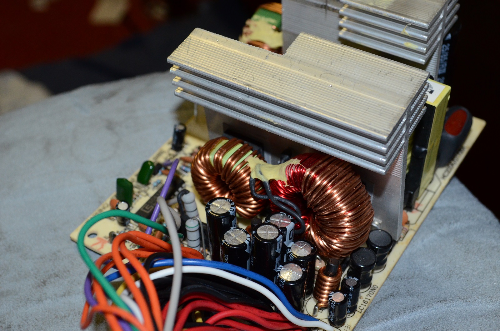

                                Do you know who did this?
                                • pc7fan
                                  • Aug 2013
                                  • 52
                                  #1896
                                  Just by the looks of the heatsinks, it's definately a HIPRO
                                  • Behemot
                                    • 4845
                                    • CZ
                                    #1897
                                    That common mode inductor has pretty poorly separated wiring…
                                    • 370forlife
                                      Large Marge
                                      • Aug 2008
                                      • 3112
                                      #1898
                                      The heatsinks look like HIPRO, but the choice of caps, SG6105D and Hang Sing transformer makes me think otherwise. LC Power?
                                      • Stefan Payne
                                        • 1267
                                        #1899
                                        Originally posted by 370forlife
                                        LC Power?
                                        Yeah, an old LC-Power. How'd you know? ;-)
                                        Solder quality is pretty shitty, I don't have a good pic though...
