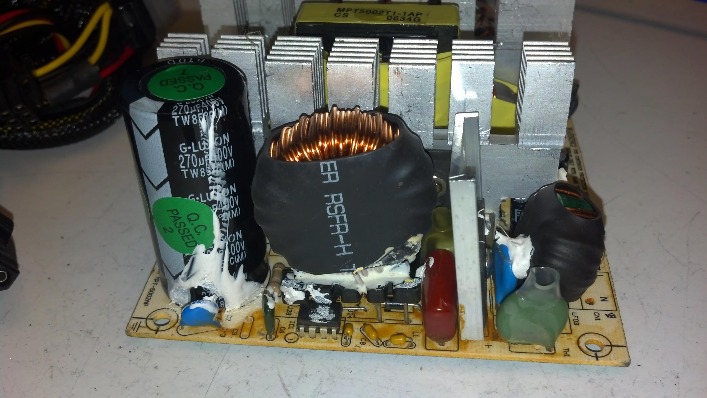

                  Let me tell you, I never get tired of these Macron PSU's. I've been seeing a lot of them lately, probably because all the caps are failing in them. As you can see they didn't quite cut that last zip tie Caps on 5VSB were out of spec and high ESR. Other caps were good on ESR, high on capacitance, except the caps on the 12V, strangely.

                    Was it wet or where did that corrosion/rust come from?

                      #1870
                      It was used in a computer close to the ocean, so that could be it

                        If you're talking about the stuff all over the PCB, I'm pretty sure it's just flux. If the corrosion were really that bad on the bottom of the PCB, then the casing would be falling to pieces.

                          Naa, it looks like corrosion. Flux should look different.
                          And take a look at the cable outlet. It's almost through...
                          How near to the sea does this computer stand?

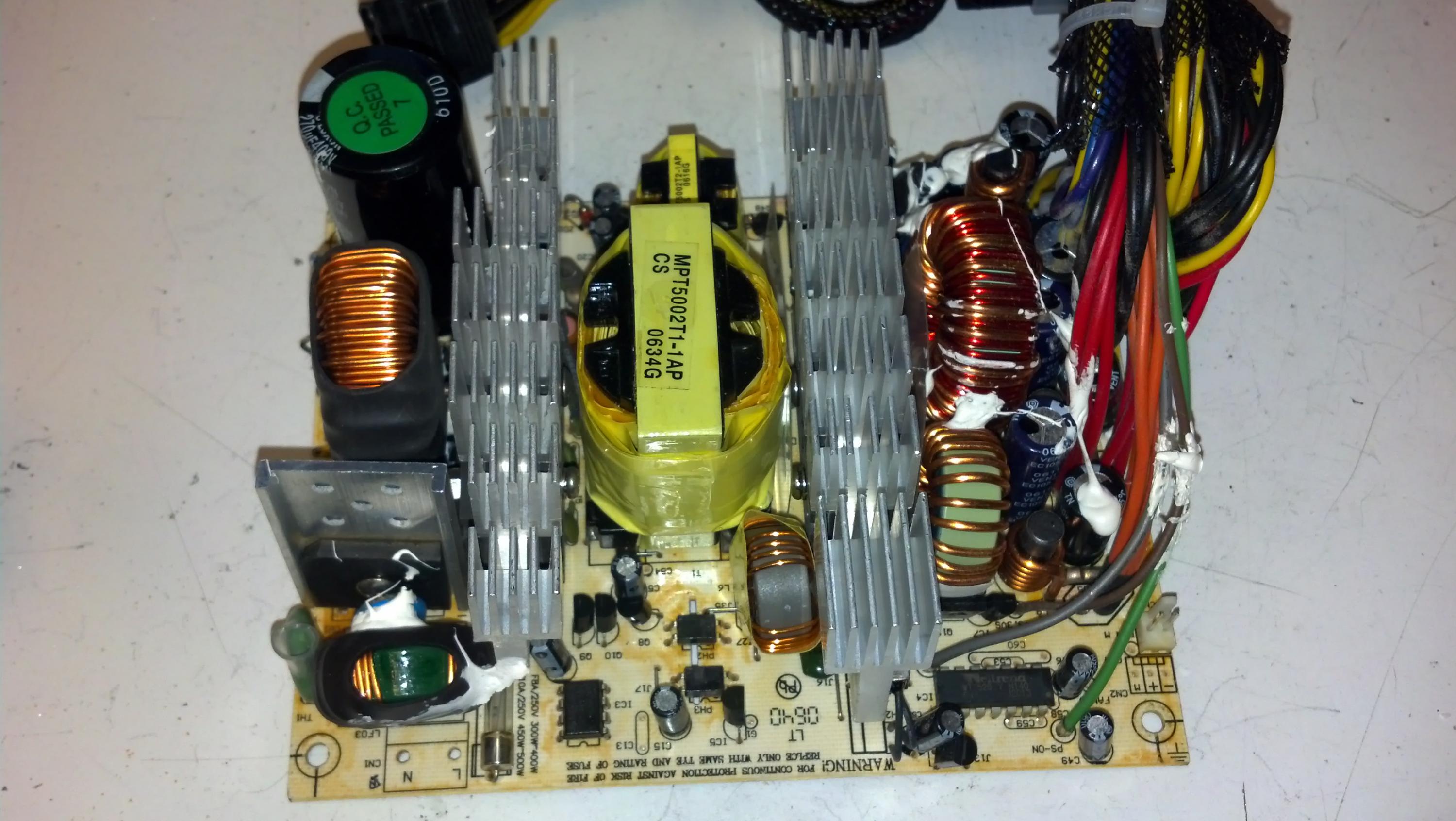

                              P4, that Macron looks like a credible design dragged down by crappy caps (and maybe a cheap fan). Am I missing something? Looks like a nice power line filter, nice heatsinks (including on the I/P bridge rectifier), -52 material O/P inductors, large main transformer, active PFC. It looks like it really could do 400W or very close to it (unlike some 450W-550W P/Ss that would probably put out their rated power for a few seconds before launching).
                                Yeah, it's a great design! Very reliable with some good caps. I've already recapped it with all Japanese caps except I left the big 270uF 400V G-Luxon cap. It read 259uF 0.27Ω ESR so I assumed it was still pretty healthy. The Power Logic fan is definitely high quality. Their sleeve bearing fans have been extremely reliable in my experience, so BB is even better If you look on the transformer it says "MPT500" so it looks like with the right parts, it could do 500W

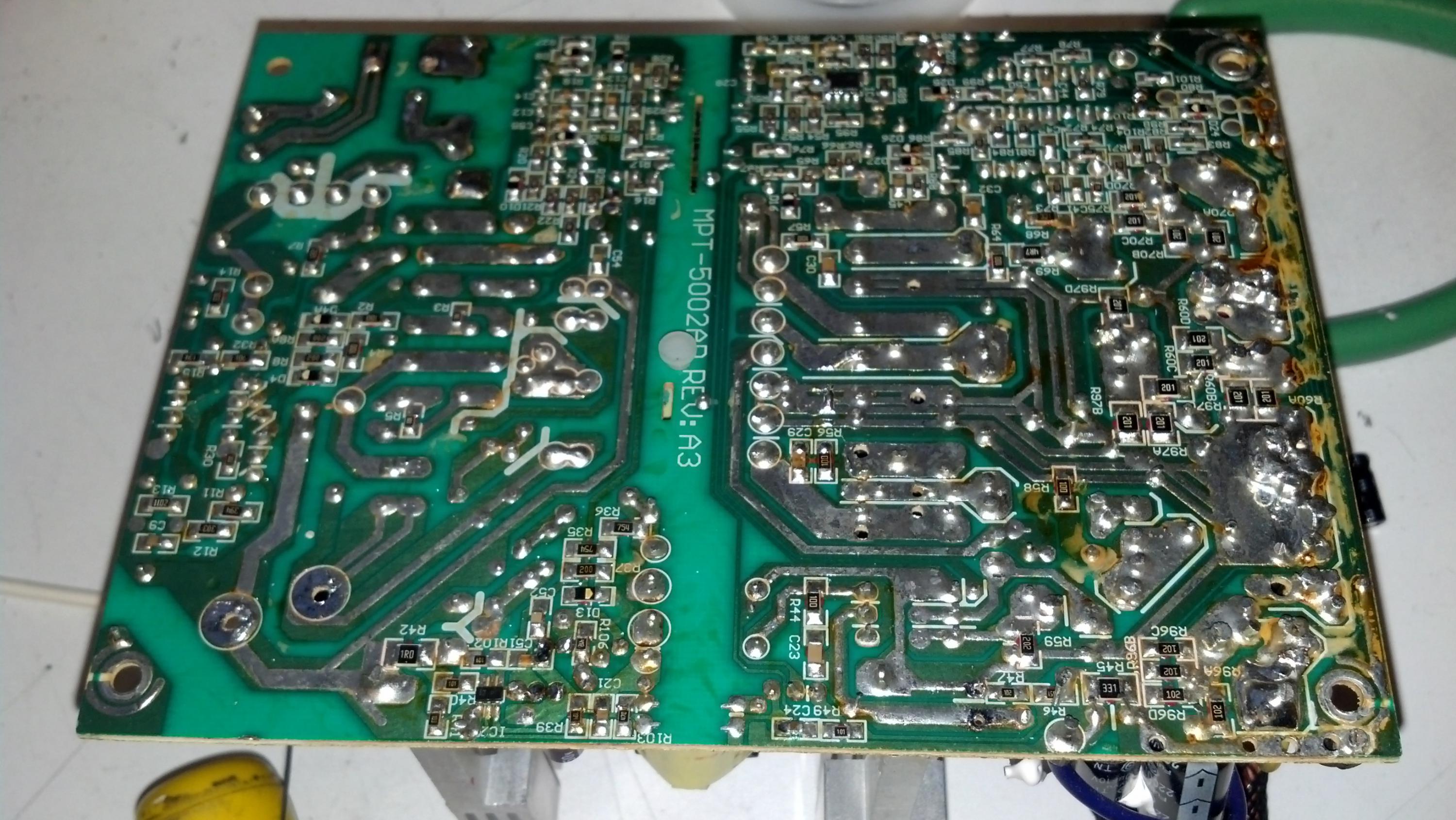

                                  Something to barf about:
                                  Reason: Too little space, to many components...
                                  That Layout should go through another round of layouting...

                                    Double barf with the CapXon and Teapo caps there....!

                                      Interestingly the CapXons are polymers so they should be fine. The Teapo on top of that is what worries me a little...

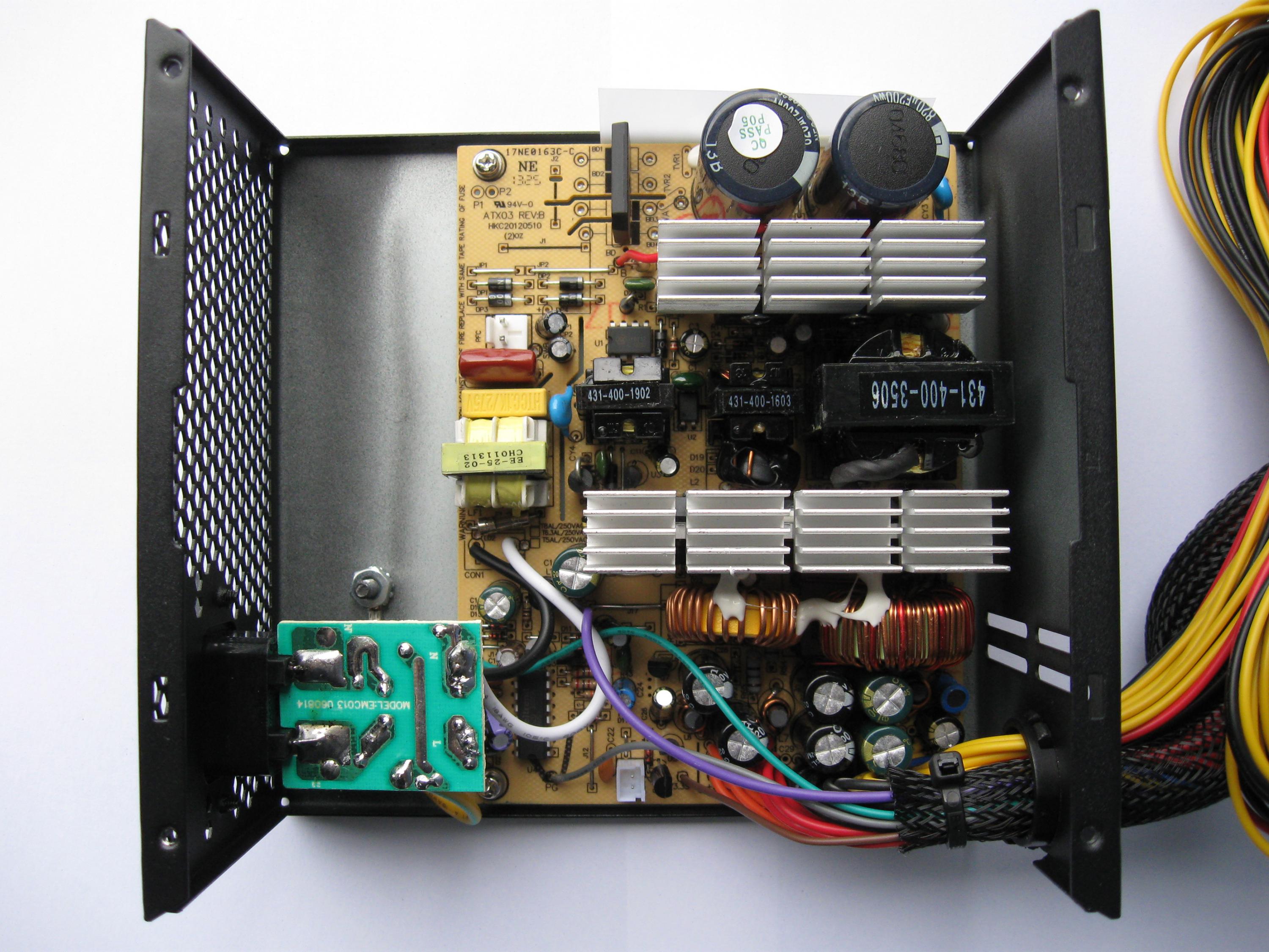

                                          Hey guys, I looked inside this power supply. His name is ATX780HM and it has 780 Watts Oo
                                          Well, i think it has 350 Watts in reality, what do you say?
                                          Some other information of the power supply:
                                          OEM is HKC
                                          Primary caps: two Caps named by the company "Cheng", I´ve never heard of them.
                                          Secondary caps: most of them are from "ChengX", a few of them are from a Company named "FCon" and three caps are from "BH"
                                          Protection-IC: Weltrend WT7520, which has OVP and UVP at 3,3V an 5V. It also has this on 12V, but I dont think that it does work. The paper to the technical datas says that OVP stops the PSU at 5V, wtf? Oo
                                          Oh and it has passive PFC ^^
                                          The company that sells this PSU says, that it has four rails at 12V. In reality, the circuit board says it has only two rails Oo On the bottom, I´ve seen that they soldered all rails to only one. This is a Single-Rail PSU ^^
                                          This is my second post in this forum, I hope the picture works ^^
