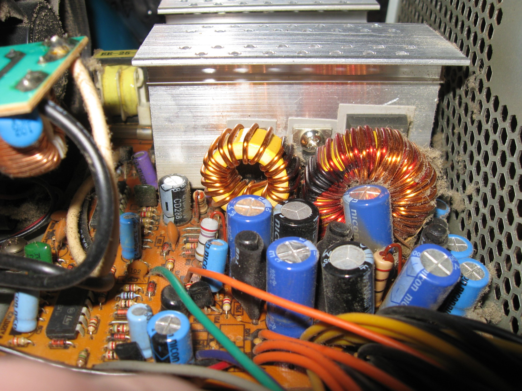

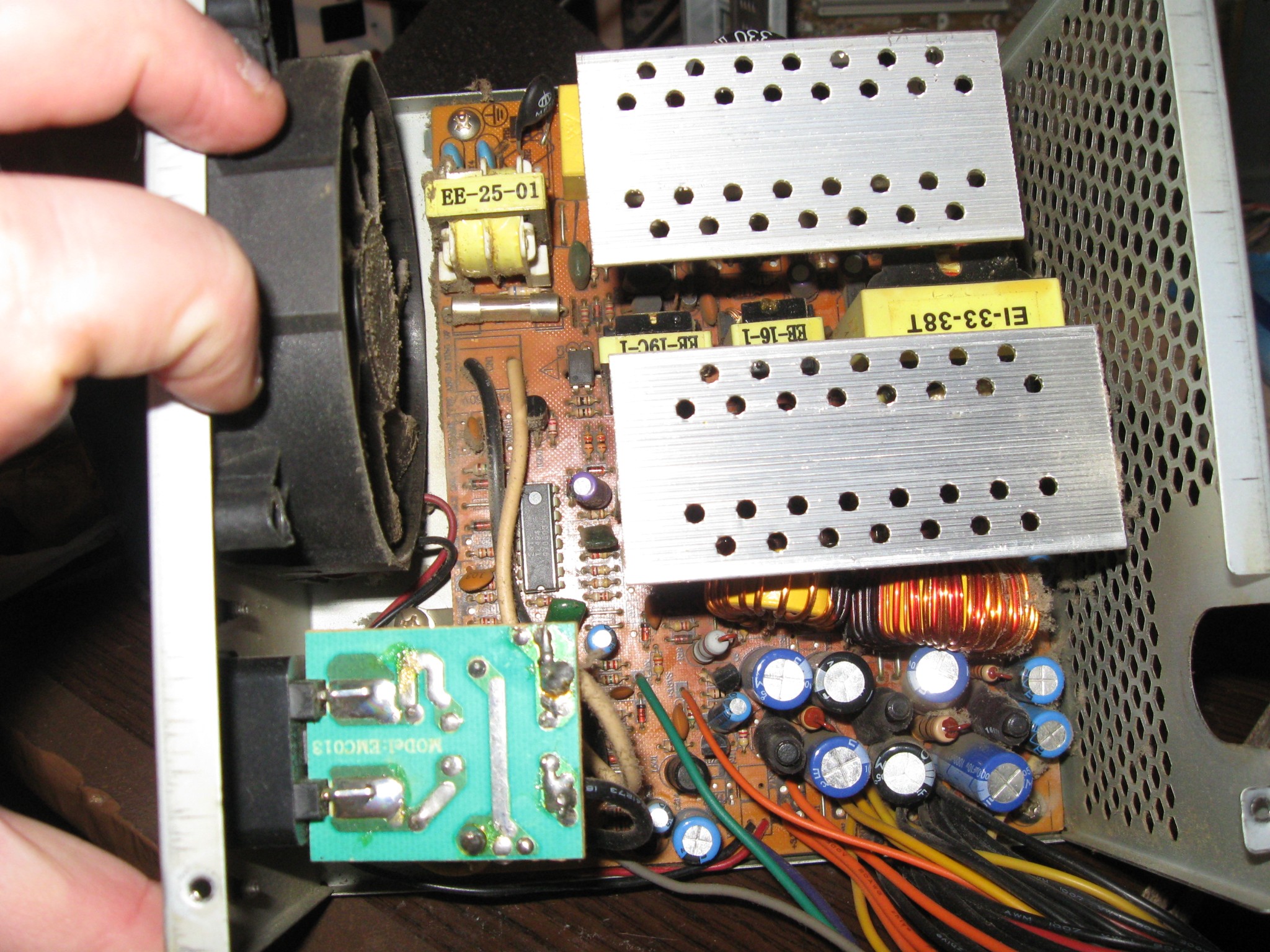

                      Another "Delux" power supply. Must have been a more expensive computer case because it has enough components in it to to save it from the "hall of shame" thread.
                      Fan going out, vibrating the whole case. Replaced it.
                      1000uF 10v capacitor on 5v swollen, probably due to heavy 5v load and bad fan.
                      Replaced both with 1500uF 6.3v Nichicon caps, replaced the 12v caps with 1500uf 16v as well as a precaution.

                        Hm those look like fake NCC capacitors on the primary xD

                          Yeah, they probably are. But at least it has proper filtering so it redeems itself a bit.
                            And that large 27 Ohm resistor next to it . (It's dissipating nearly 1W of power - not good.) Try to change it for something that will dissipate 0.5W or less and the new caps will be very happy .
                            • Behemot
                              • 4845
                              • CZ
                              #1714
                              Or maybe do flying resistor mod.
