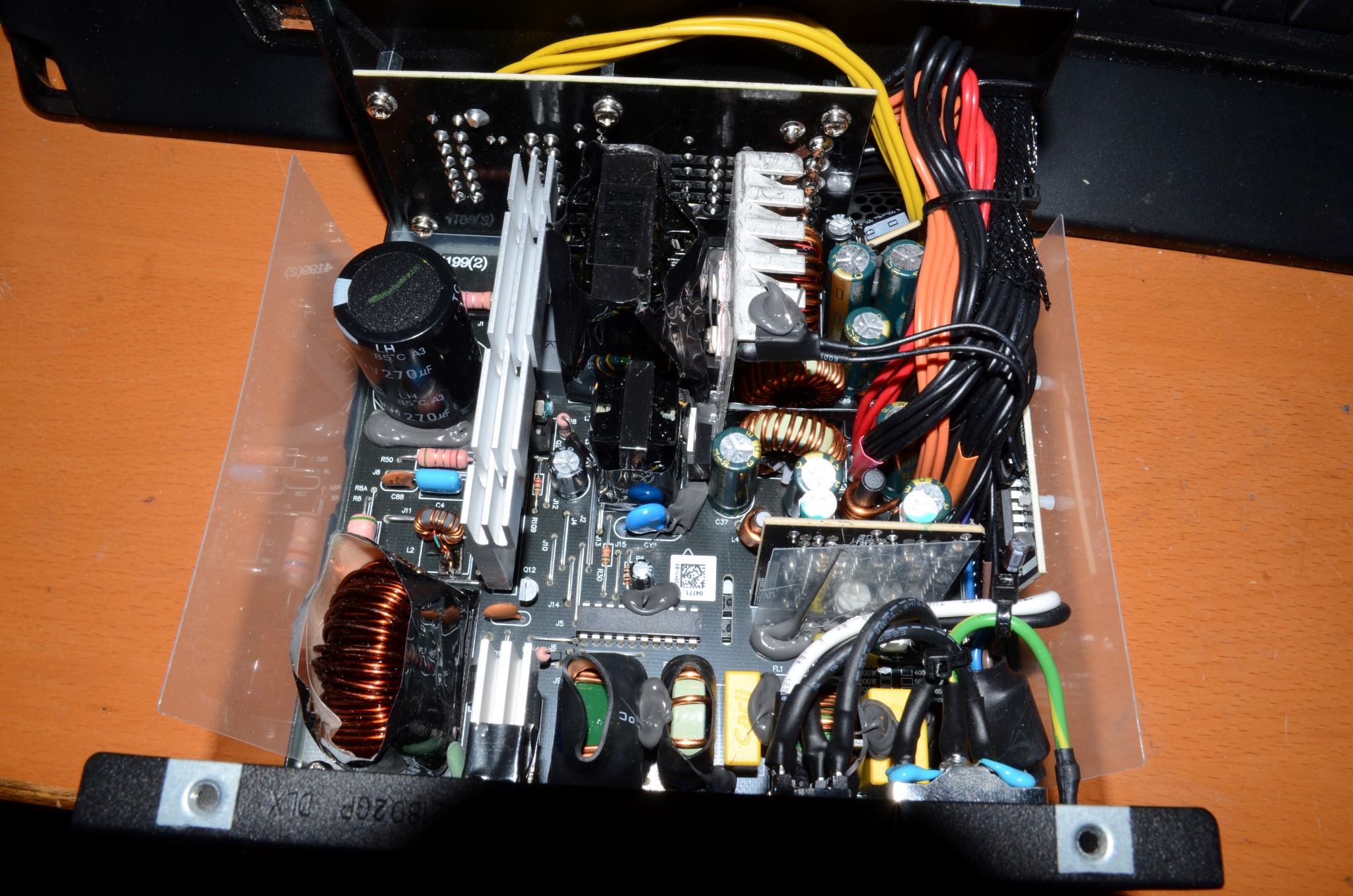

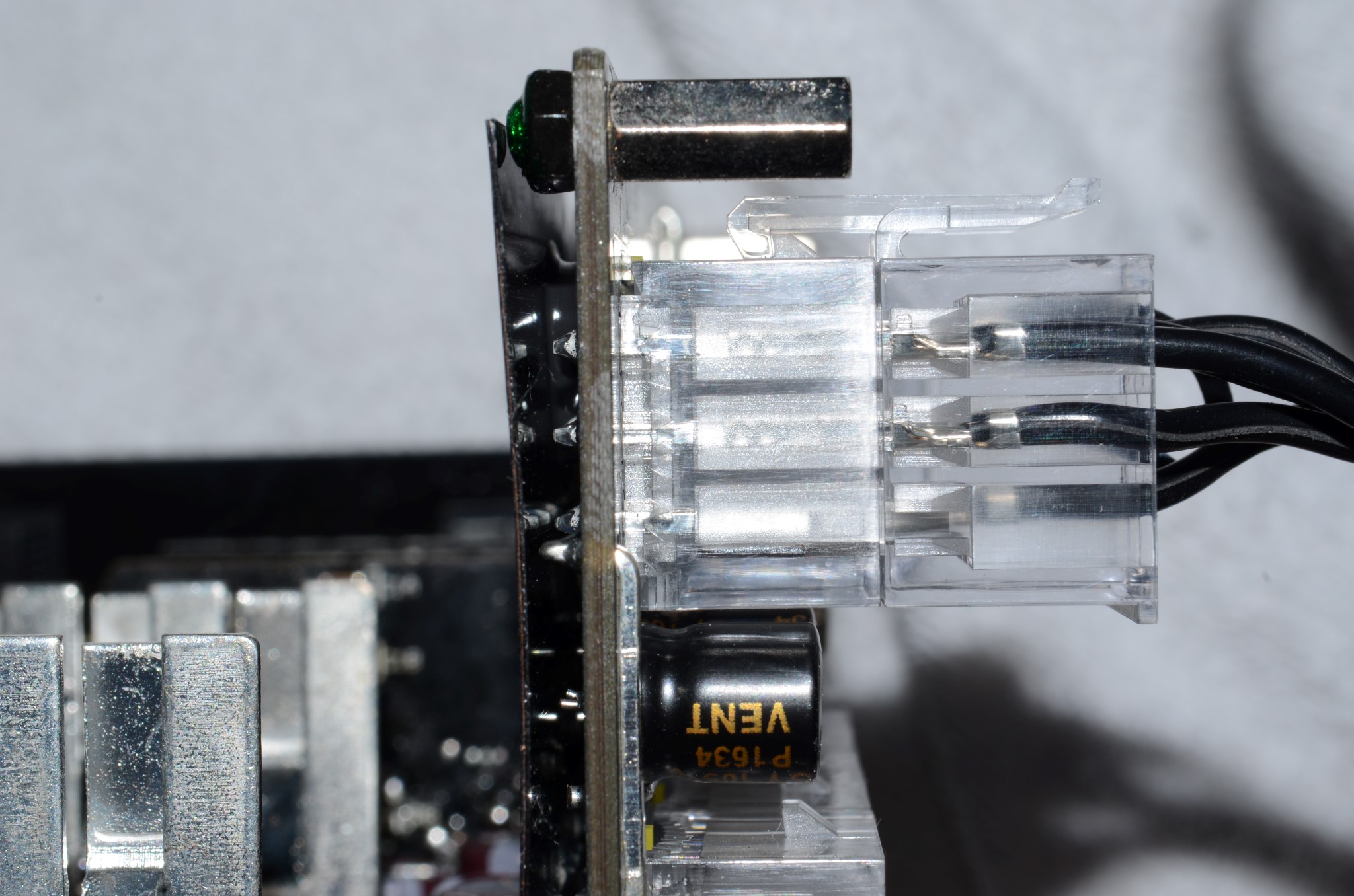

    Something new, pretty good unit, especially those connectors. You just have to put them in at least once in your life. No, really you do

      And doesn't cost more than competitiors, while more efficient and more capacitance on +12V...
