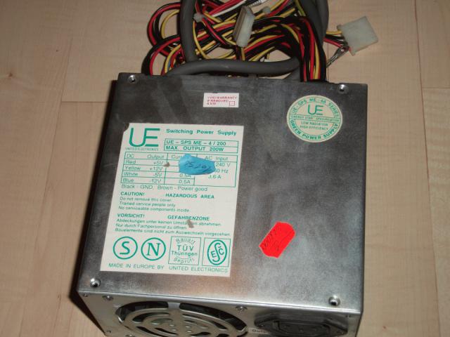

    Here are two old PC AT units I've stashed long ago.
    United Electronics 200
    Looks very noname on the outside but well built, very different from a usual PC psu. It has parts and circuitry that you rather find in a tv .
    I had to replace the original primary caps since ones leg completely broke off for some reason. Those were 220uF 250V Samsung caps. It even had a warning label on them which I put back.

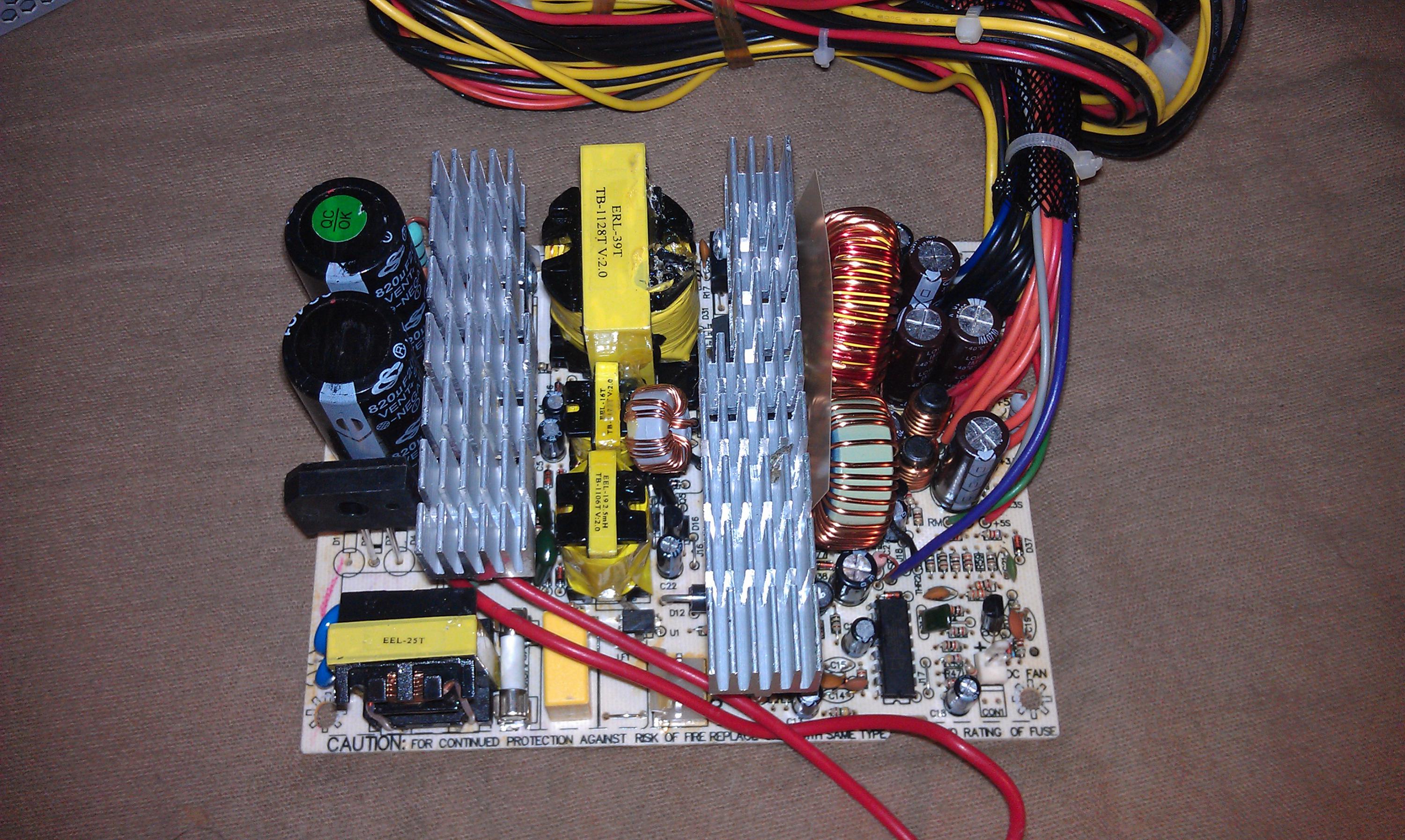

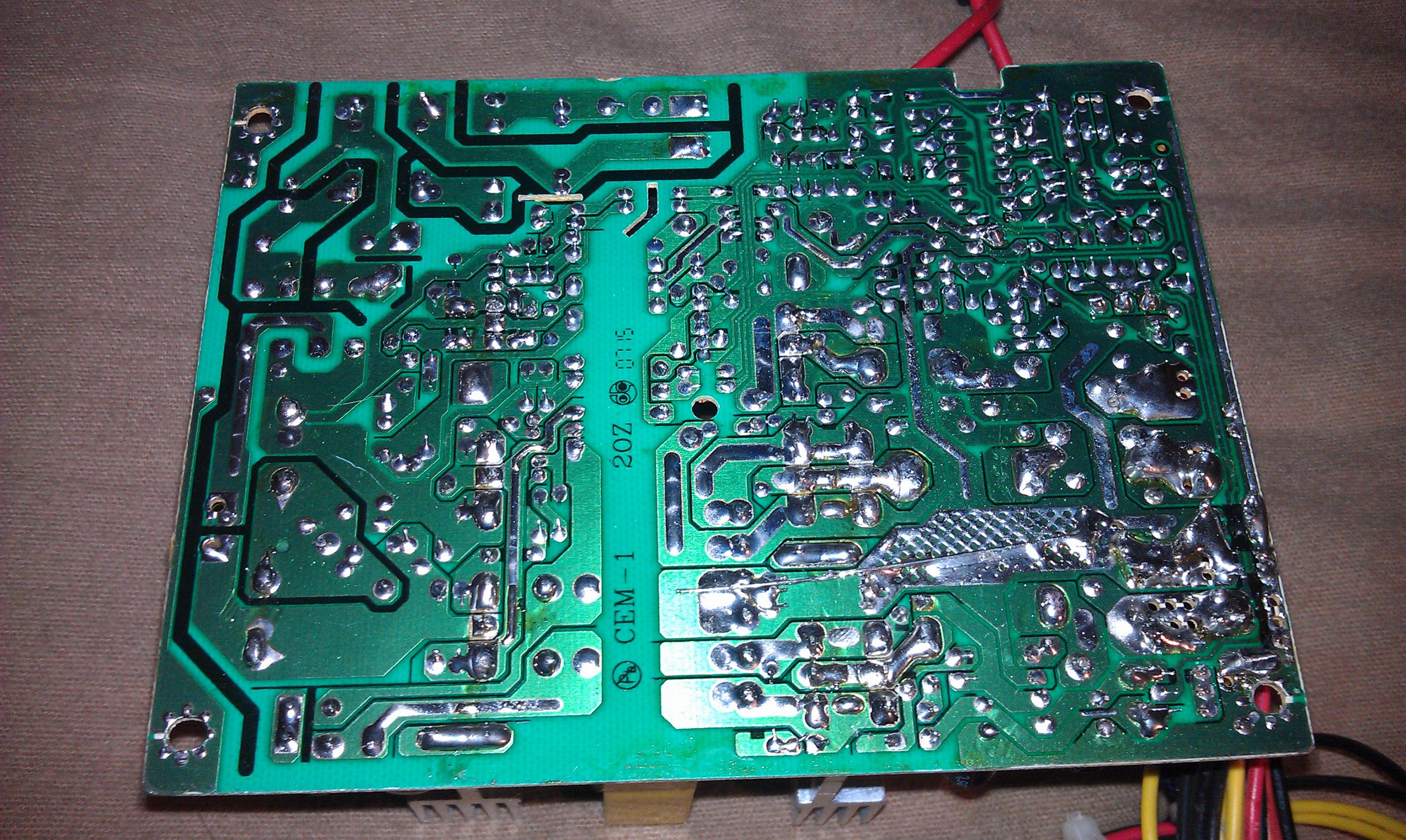

          I haven't been on this forum for a long time.

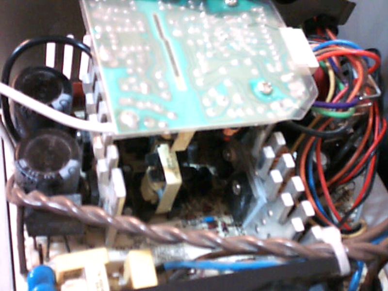

          So, I think I'll contribute this Enlight (High-Power) HPC-250-101. Caps are all United Chemicon. Bridge rectifier and input filter. This is nothing more than an AT stlye power supply with a 5Vsb rail and no connected power switch (thats what the circuit board on top of the heatsinks does.)
          Connectors are a little sparse, 20 pin ATX, 4 big molex, and 2 floppy.

            The pic is pretty blurry. Given the power level and 20-connector, I'd guess it's ca. 2000. If the +5V Stby is 2A or lower, maybe 1998 or 1999. Looks like the big I/P lytics are 85C parts. I think the switch devices are in TO-247 packages (and one O/P rectifier is in a TO-3P package, I think), and I think I see a large DC-blocking film cap behind the switch device heatsink, so it's probably a half-bridge topology using bipolar transistors. If a BJT half bridge, probably implemented with a TL494 type PWM and -26 material O/P inductor core(s) (mostly yellow with one side painted white).

              The date code indicates the 46th week of 1998. I know the picture is blurry because it was taken with a crappy webcam and I didn't have a steady hold on it.

                Really? That Sirtec has all UCC (mind if I ask what series you found in there; LXJ possibly on the output and maybe SMH on the input, and KME or KMA for the tiny capacitors?) The Sirtecs I've seen from later build dates have either Teapo, G-Luxon, or worse on the output but sometimes Rubycons on the input. Also, are the BJTs 2SC2625s (they look like TO-3P parts to me which is why I ask)?

                  The primaries are SMH, secondaries are SXE, LXF. Now that I look further into it, I did notice a few Rubycons hidden behind the wires.

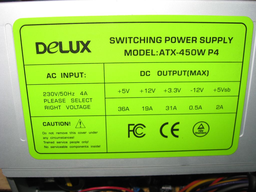

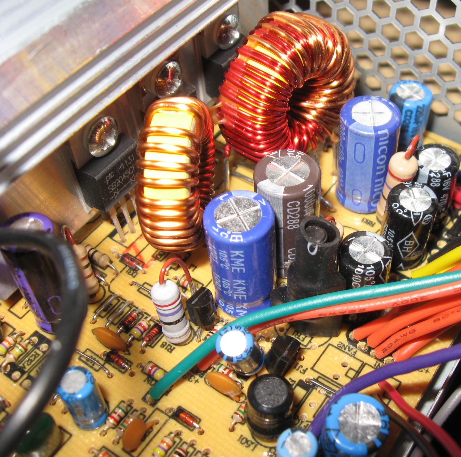

                    This is another power supply that came with a 20-25$ computer case.
                    I only bought this case to build a system that would allow me to diagnose and fix agp video cards and older motherboards, so I didn't care about the power supply quality.
                    BUT, since I have to fix my sister's computers (kzg caps on asus motherboard swollen, see this post if you care: https://www.badcaps.net/forum/showpo...&postcount=490 ) and the power supply in that system has a dying whining fan, I figured I could just transplant this psu in her system.
                    So with this occasion, I opened it up to get some pictures and see the quality.
                    Deluxe 450w
                    In theory as the label says 5v @ 36a , 12v @ 19a , 3.3v @ 31a.
                    In practice, two SB2045CT (20 A, 45v, so probably on 5v and 12v), one 16FO20 which I hope it's on 3.3v (16A , 20v) But it could be 3.3v and 5v heavy (20a) and just 16a on 12v. For the system it's gonna power, it doesn't matter anyway.
                    later edit : looking now at the pictures I made and the color of the cables, it does seem like 12v is in the center, with that 16F020 on 12v, the one at the bottom goes to the 3.3v rails and the one at the top seems to be for 5v.

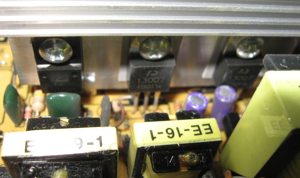

                    Primary has 13007 transistors, weak EI-33 transformer so I guess it could do up to about 200w maybe. Probably 1A rectifier diodes... barely any AC filtering.
                    ZkiCheng 470uF 200v primary capacitors - esr meter shows 320uF 0.11-0.2 ohm.. snapped picture right when display refreshed screen but you can see the value if you squint.
                    Secondary side is Nicon , BH, KME .. 1000uF or less, maybe 1500uF on 5vsb, didn't bother to check the ESR, can't expect much and honestly don't care on such cheap psu.
                    It will work fine on my sister's pc (xp 3000+ 1gb ddr1 some ati agp card, 2 hdds and cdrw).
                    Pictures below:

                      Here's the pictures that were supposed to be attached to the post above:

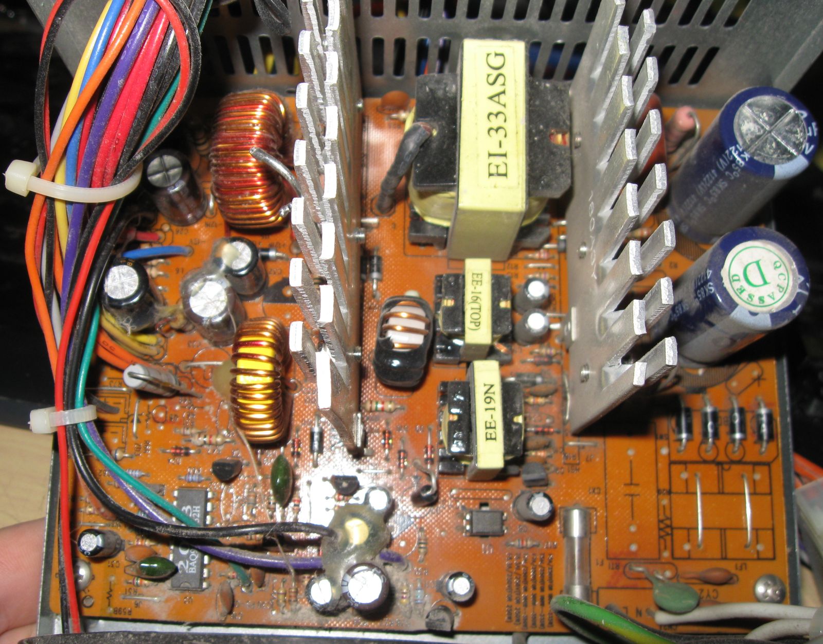

                        And here's the shitty power supply that the power supply above is gonna replace.
                        This one in theory still works but I'm a bit concerned about the 12.5v output. After opening it up, I realize it's actually worse than the above power supply.
                        Just some Y caps that I doubt they're safety rated on the primary side,
                        puny rectifier diodes good for probably 1A each,
                        330uf/200v YC brand capacitors that in reality are 216 uF each (and about 0.15 ohm esr not that it matters here)
                        didn't bother to write down the mosfet/transistors on primary, i though they can be read from pictures... can't be bothered to open it again
                        ei-33 (in theory) transformer
                        SBL1640CT (16a/40v max) schottky on 5v, SBL1040CT (10a, 40v) or 3.3v, two big diode treatment on 12v (who knows, maybe 4-6 amps? )
                        Some YC caps on secondary side, some Su'scon (probably on 5v and 3.3v) , I think maybe a G-Luxon on 12v? 470uf/16 on -5v , 1000uf/16 otherwise as far as i can see
                        no secondary side inductors in sight, just a couple of minimum load resistors (3.3v and -5v?)
                        Weak, really weak...

                          I think that Premier PSU belongs in the gutless PSU thread.
                          It's actually not that bad of a design once you put all of the components and proper parts in it. But then again, that's about half-way from building a low-powered PSU from scratch.

                            At least the Delux has okayish heatsinks, and room to add some PI coils. That would be a fun one to fix up to turn into a good 200W PSU. Zhi Cheng, don't see those very often. Cool!!

                              I'd say the new one is, realistically, 200-225W based on the not-too-heavy metal (as well as the things mariushm pointed out). The old one, maybe 175-200W, due to the kludged ("bodged" in UK slanguage) dual diode on the O/P (+12V?). The new one has what appears to be real Y caps (i.e. safety agency approved). Both look to be TL494-controlled (or clone-) half bridges running at under 50KHz (based on the O/P inductor cores).

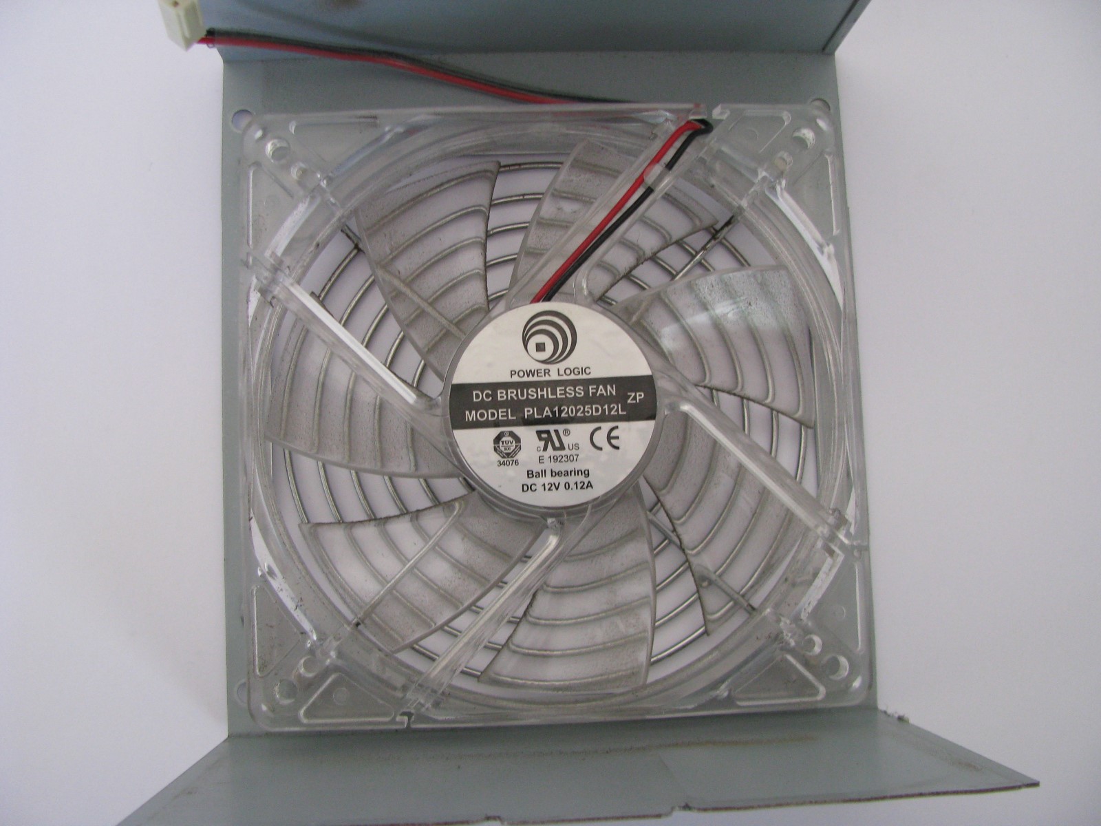

                                The fan is a Power Logic, although it's only a 1B1S bearing, not a 2BB. I gave the bearings some more lubricant, as there wasn't much in there.

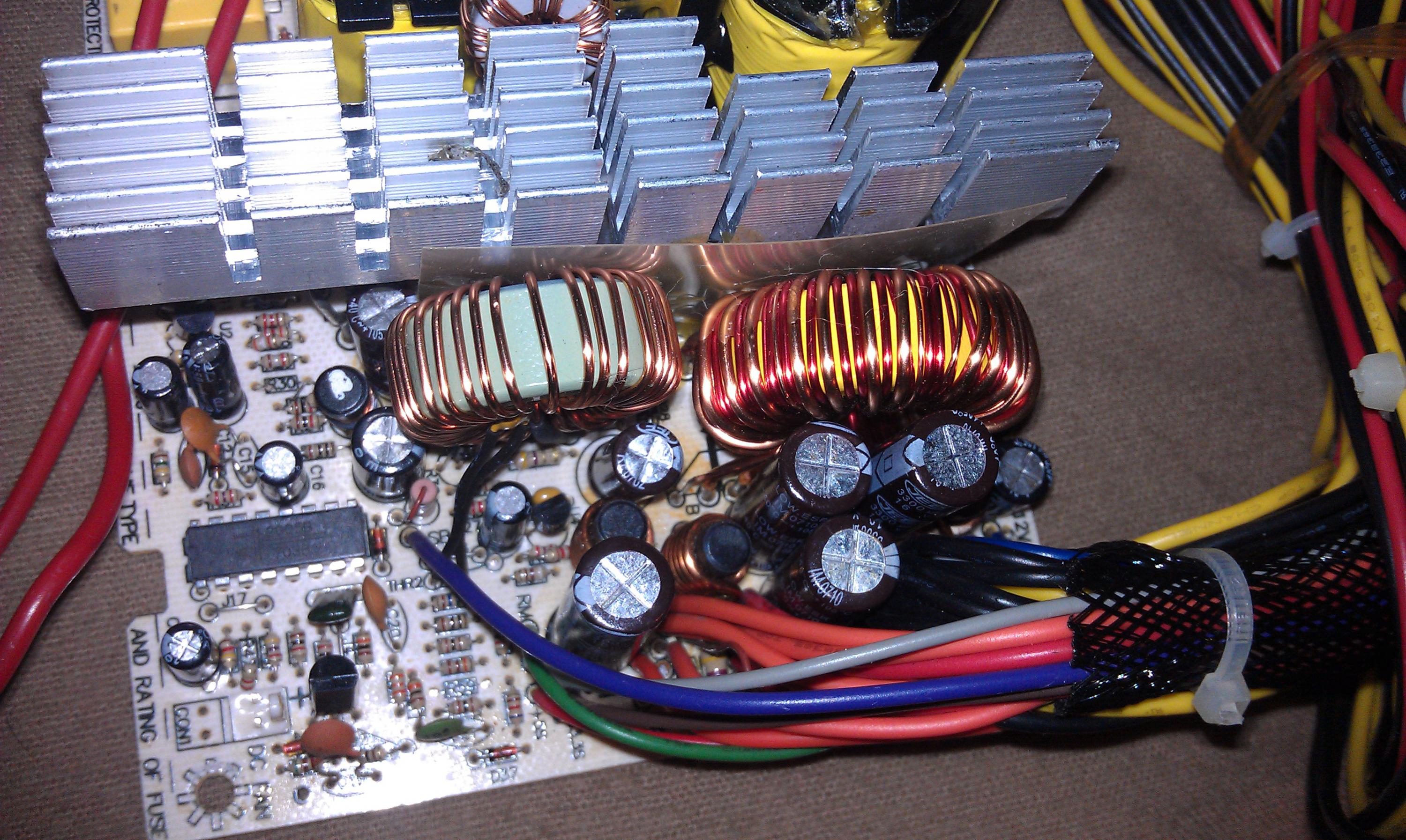

                                  Winsis KY-550ATX
                                  Best Sun Pro PSU I've personally seen. 140mm Te Bao fan that needs oil.
                                  I bet it'd be good for over 400W at least! Pretty good input filter. Spots for MOV's but none there, may add some. 8A bridge, 820uF input caps.
                                  TO-247 Switchers on the primary heatsink are D4515's, rated for 15A!
                                  39 Transformer, 12V = two 20A ultra fasts in parallel, 5V = two 30A schottky's in parallel, 3.3V = single 40A schottky. I just wish the 12V rectifiers were more powerful, I may upgrade them.
                                  To give you an idea of the size of the toroids, that tallest JEE cap is 30mm. It even has a PI filter for the -5V and -12V
                                  No PCI-E connectors but I may add at least one. Besides the CS input caps, the rest are JEE (Plus one lonely GoldLink cap) Soldering is messy but at least they cut the leads pretty short.
                                  What do you guys think?

                                        Originally posted by c_hegge
                                        Not bad at all for a Sun Pro. 400W shouldn't be much of a problem. I'd recap it though. JEE caps are absolutely awful
                                        Oh, absolutely. JEE caps are garbage, I think they're worse than Fuhjyyu and on the same level as Rulycon
                                          Wait, am I awake? Is that really a Sun Pro worth keeping!?
                                          Indeed it does seem like the best Sun Pro I've ever seen too. The cap selection may be horrible, but the rest of the PSU looks clean and well-built. And look at that - the PCB is connected to the AC line with a proper connector! You also have a proper ceramic fuse. For $6, it's quite a worthy PSU.
                                          Now I don't know if it will really do it's rated 450W rating. With those heat sinks, I'm more inclined to think around 350W continuous is where it will top out. Possibly peak at 400W for a little bit. I just don't quite trust Sun Pro designs. But at least the individual current ratings for each rail seem quite fairly rated.
                                          Another thing I'm going to pick on is the trace spacing on the primary side of the PCB - it really is too small. Seems like many Sun Pro PSU are like this. Also, I only see 1 cap spot for 12V rail. I would have expected 2 (keep in mind that I am spoiled, though, by HiPro PSUs with multi-12.5 mm cap spots ).
