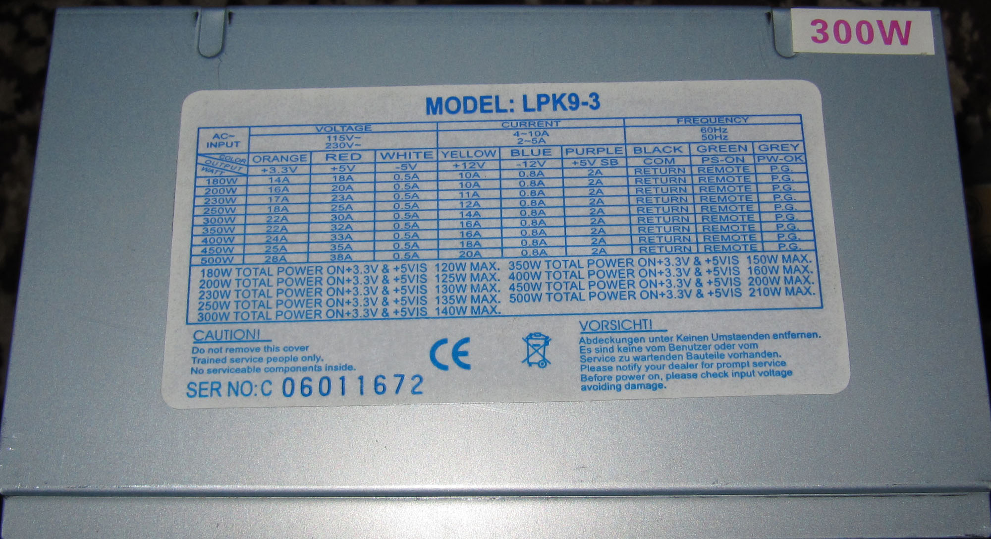

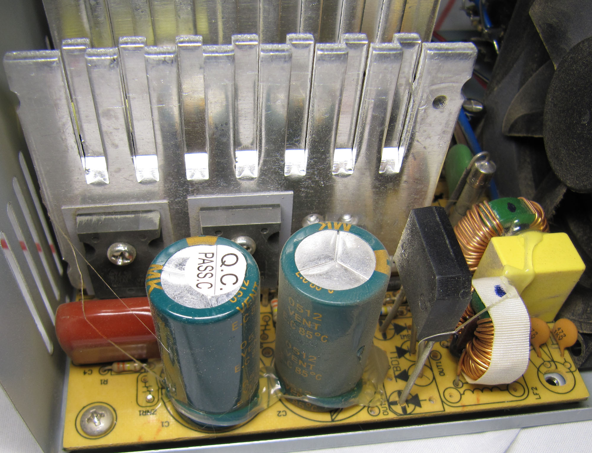

                                  Linkworld LPK9-3 300W
                                  I was surprised to see a full input filter on that psu. Of course MOV protection is missing and the Y caps are ordinary ceramic caps.
                                  Another thing that surprised me is the switching transistors, being ST W13009!
                                  The primary caps are fake, their real capacitance is 300uF!!
                                  The main transformer is capable of 250W, the 5vsb transformer is too small for 2A output...
                                  Secondary rectifiers:
                                  20A for 3.3V
                                  20A for 12V
                                  30A for 5V
                                  Output filter caps:
                                  5V: 1x2200uF Canicon 10V & 1x2200uF 10V Fuhjyyu TN bulging
                                  3.3V: 1x2200uF Canicon 10V & 1x2200uF 10V Fuhjyyu TN bulging
                                  12V: 1x2200uF 16V SEK Teapo
                                  5vsb: 1x1000uF 10V Canicon & 1x470uF 16V Fuhjyyu TN
                                  What do you think?

                                    That kind of thing goes in the hall of shame.
                                      All the caps are fake, as far as I'm concerned!

                                      Use it at ~250W or less, after a recap. If you even want to bother.

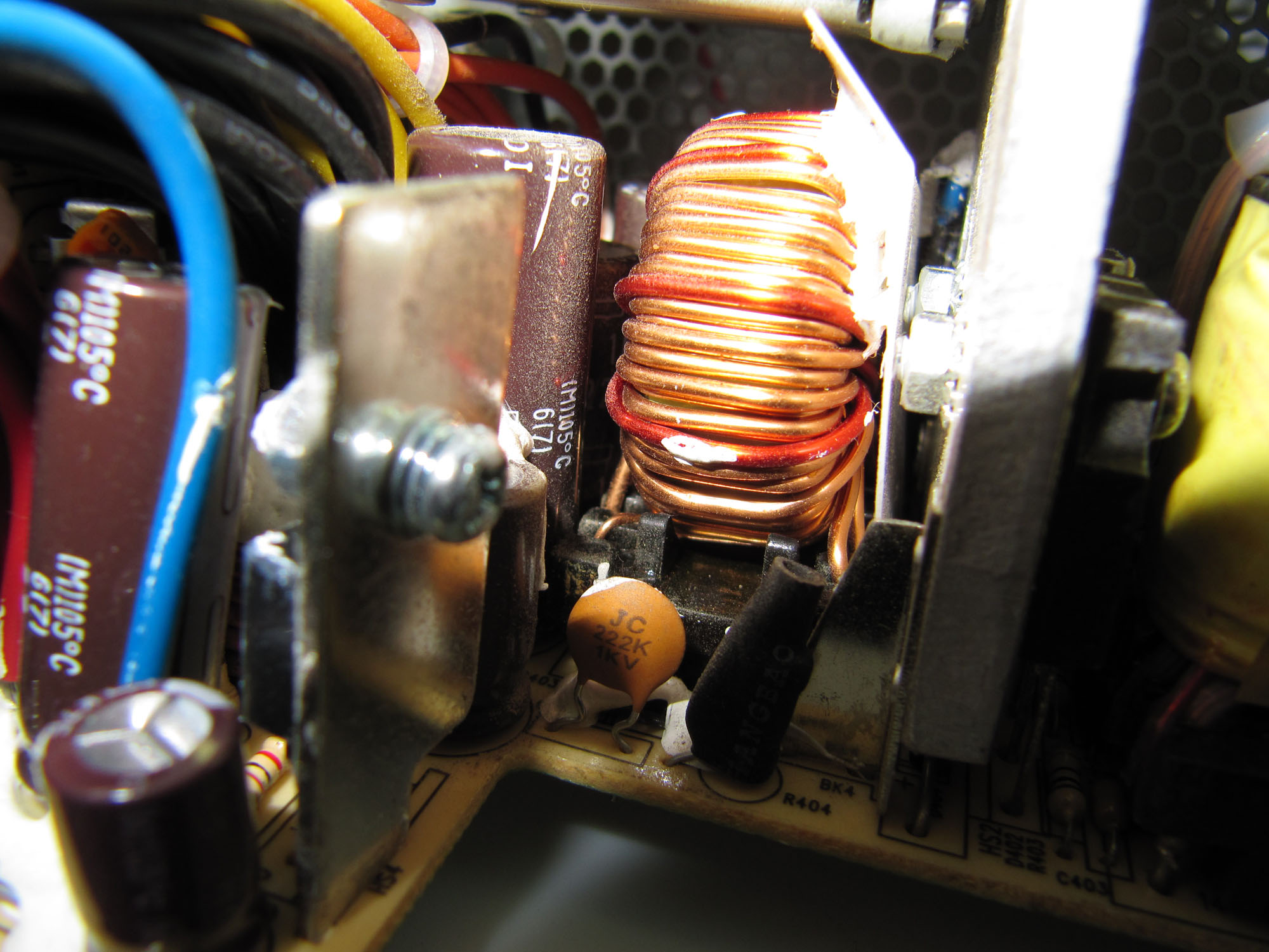

                                        It's not bad. I like that it has plenty of space on the secondary side for the caps to breathe (but I guess that still wasn't good enough for those Fuhjyyus). The heat sinks aren't too bad either. Just spread out the fins further apart, and the heat sink will actually become decent.
                                        On the negative side - 2-transistor 5VSB circuit. I don't see any critical caps in that design, though, so it may be one of the "better" 2-transistor designs.
                                        And yeah the MK input caps are trash.

                                          Linkworld definitely used to be better. It has TO-247 13009's, an okay-ish transformer, and good size PI coils, bridge rectifier and good heatsinks considering that fan will probably always be running full boar. Good looking secondary silicon, on 230V it may be able to do 300W
