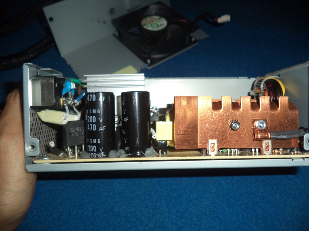

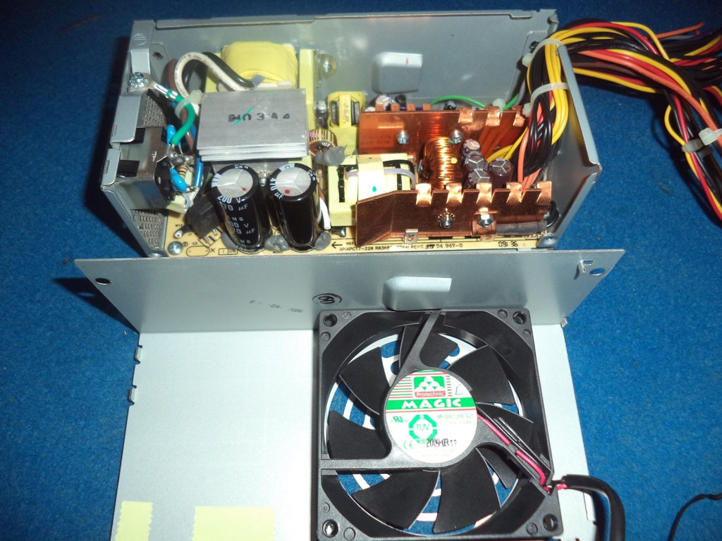

    found this psu in old NEC MY28V/R-G case .. its ACBEL API4PC17 non-PFC rated @250w 110v (TFX based psu)
    this been converted to 220v , use this psu to powering my ubuntu proxy machine
    main caps : nippon chemi-con SMG
    other caps are nippon chemi-con KY, rubcon YXA,YXH
    fan made by protechnic MGA8012HB-A25
    i get this case with psu included for about 5$ here and the local shop have plenty stock

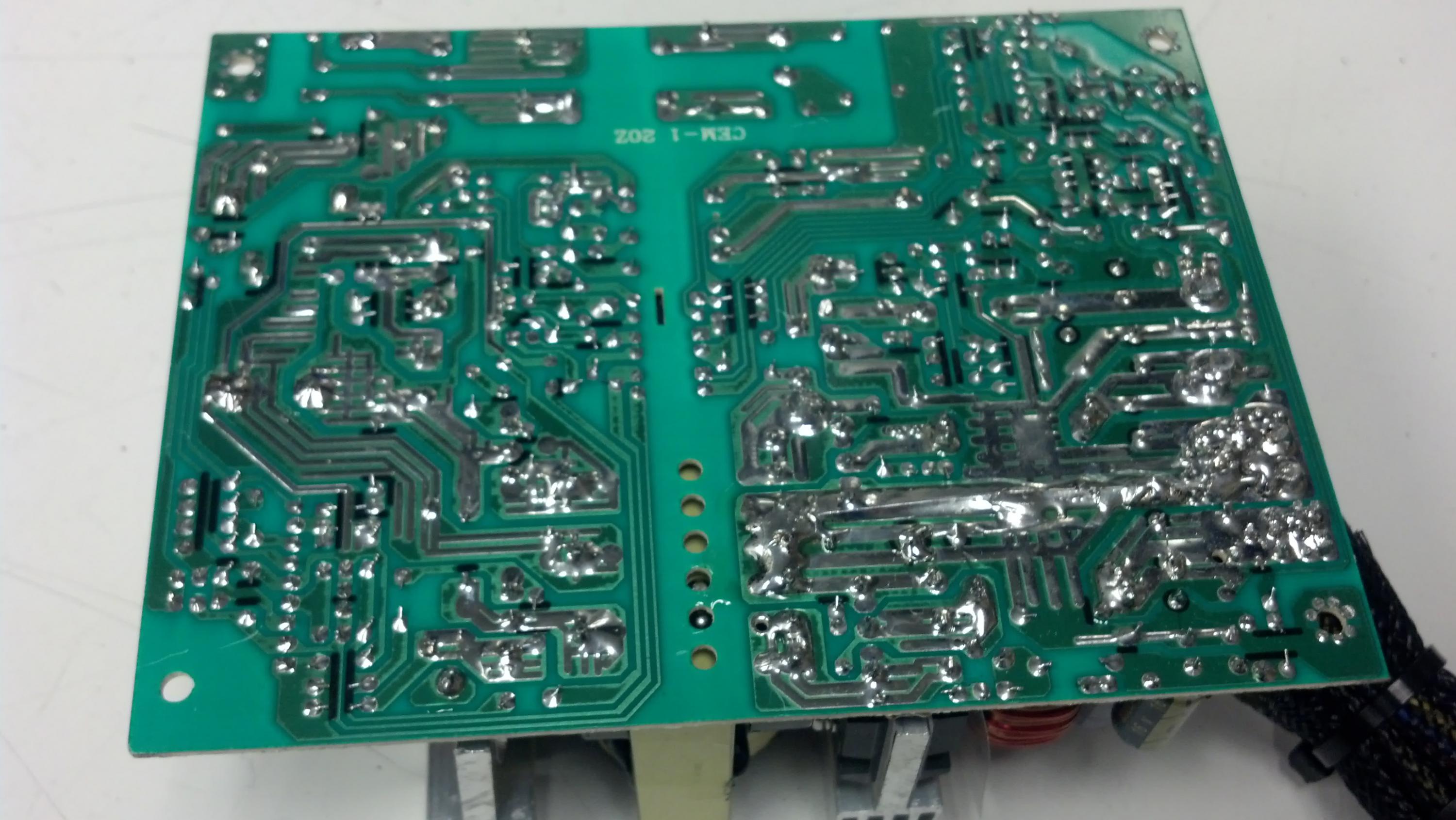

      Logisys AT750BK
      ^ Looks good! Love those copper heatsinks
      So right here might just be the only reliable Logisys PSU on planet earth? I was surprised to see this in a customers computer. I got to keep it and recapped it
      It was 80 Plus certified, but I have doubts it can actually do 750W. I could be wrong though. Those heatsinks just don't look good enough unless that fan was really moving air. I think most of the parts seem capable though.
      It's got good input filtering. 5 Y caps, 3 0.22uF X caps, 2 coils, but no MOV
      PFC cap is Panasonic CE 390uF 400V
      Bridge rectifier is on the heatsink and rated for 15A
      PFC FET is Infineon 24N60C3 (TO-247) rated for 24.3A @ 25C and 15.4A @ 100C
      PFC Diode is MOSPEC U15A60 (15A)
      Switching FETs are Infineon 20N60C3's rated for 20.7A @ 25C and 13.1A @ 100C
      Primary IC is a Fairchild BH0170
      Secondary silicon:
      3.3V = STPS40L45CW
      5V = STPS40L45CW
      12V = Two S40D45CS's in parallel
      Secondary IC is a Weltrend WT7502V

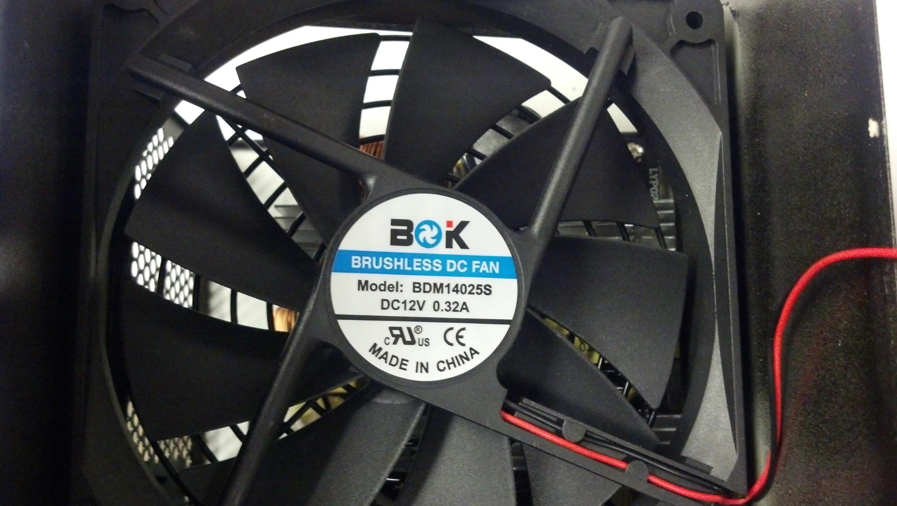

      Fan spins well and has plenty of oil, looks like a differently styled BaoDiKai fan that are often found in Logisys PSU's. This kinda looks like a YueLin to me, but I'm not quite sure...Is it maybe Keerda like most Logisys?
      Original caps were BH and GL. Really glad I recapped it, on the primary there was a 22uF GL cap physically touching a resistor AND the primary heatsink! Can't imagine it would have lasted a long time.
      Does this look capable of 750W?

        Can't say for sure.
        62A * 12V = 744W for 12V. I don't think it can output those watts, just look at the main toroid coil. It depends on the fan control circuit. Is it one of those completely "silent fan" designs? Then, I am quite sure the coil will cook itself if someone asks those watts from it. I always mod that circuit when needed.
        But, I think it can output 40A or more on 12V and that is great anyway. I would keep it.

          Yeah, the main toroid isn't small, but doesn't look good for 750W. Just to give you an idea cause it's hard to tell from the pics, the coil is 40mm tall, 15mm wide, 40mm length. At idle, the fan spins very slow. I loaded it up to 275W and the fan revved up a noticeable amount after about 30 seconds.

              Those switchers would be capable of 750W. The Dell H750P-00 uses the same switches on an even smaller primary heat sink, and managed 900W on the load tester. But yeah, the secondary side could be a problem. Logisys have also been known to use fake 80plus badges on their PSUs.

                  If it is truly certified, than it has to provide the power - they load it up to 100 %. Well, at least the units they obtain for certification

                    It may be a real an 80 Plus Bronze rated 750W PSU, but there are only two crappy caps on each rail for filtering. I don't see any pi filter inductors. I don't think the ripple will be very low.

                              AcBel makes some pretty legit PSU's... And unlike some, this one has good caps. Great score.
