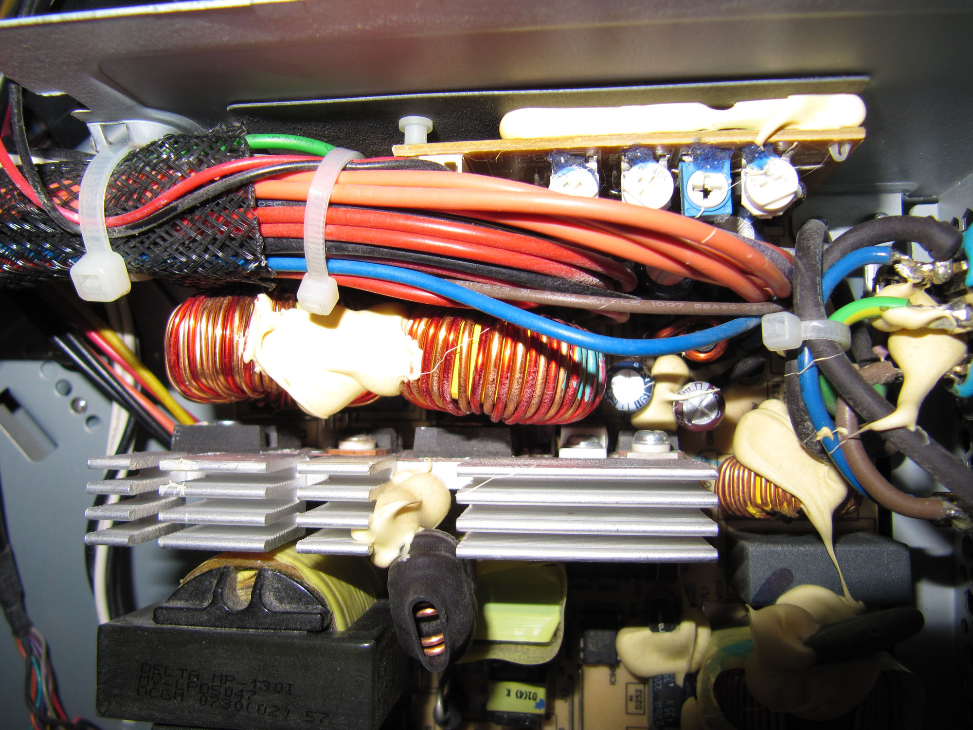

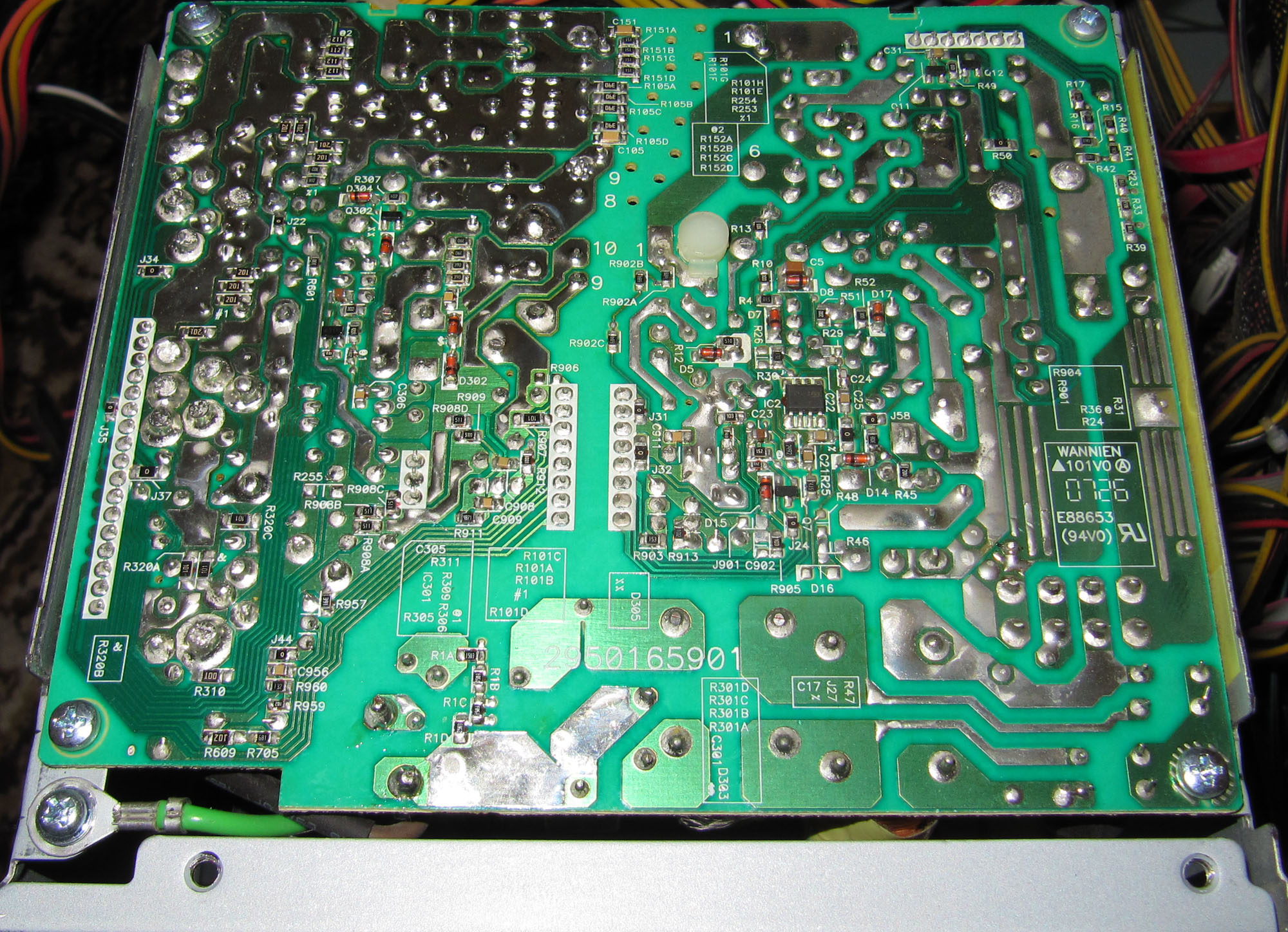

      Chieftec GPS-500AB A

        Do I see a capxon on the 5vsb there?

          The caps are a mix of Samxon, Chemicon KY and Ltec.

            I did similar, 400W model couple days before. Besides the Samxon on primary it was full of crap, Capxon on +5 V SB was bulged. It was basically Delta PSU, they used the same model number and just placed Chieftec there

              That's a nice power supply. How many 12V rails does it actually have?

                Mine actually had two and due to all those potentiometers and overall big daughterboard on secondary here (possibly full of monitoring ICs) I'd say it has all three.

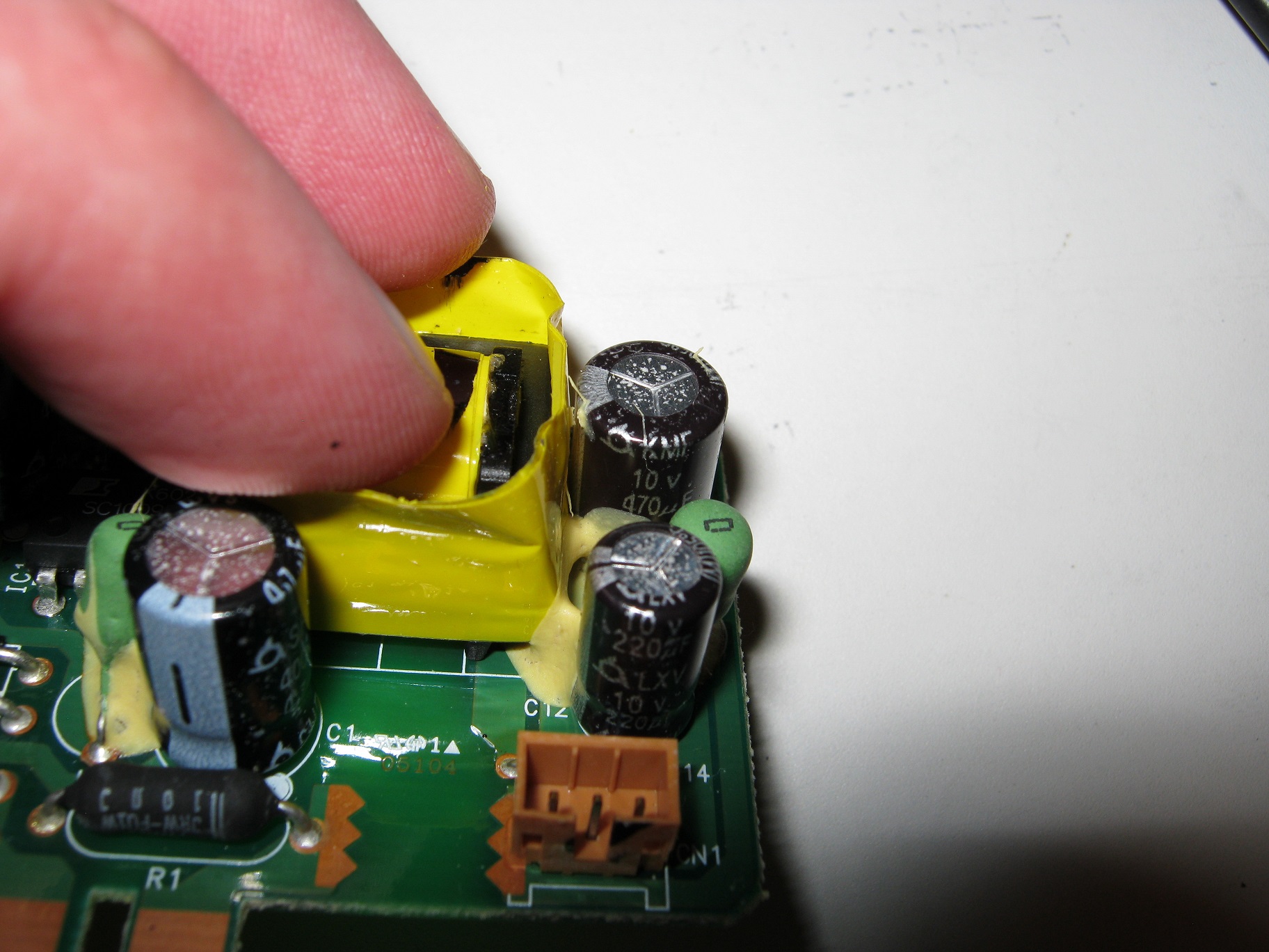

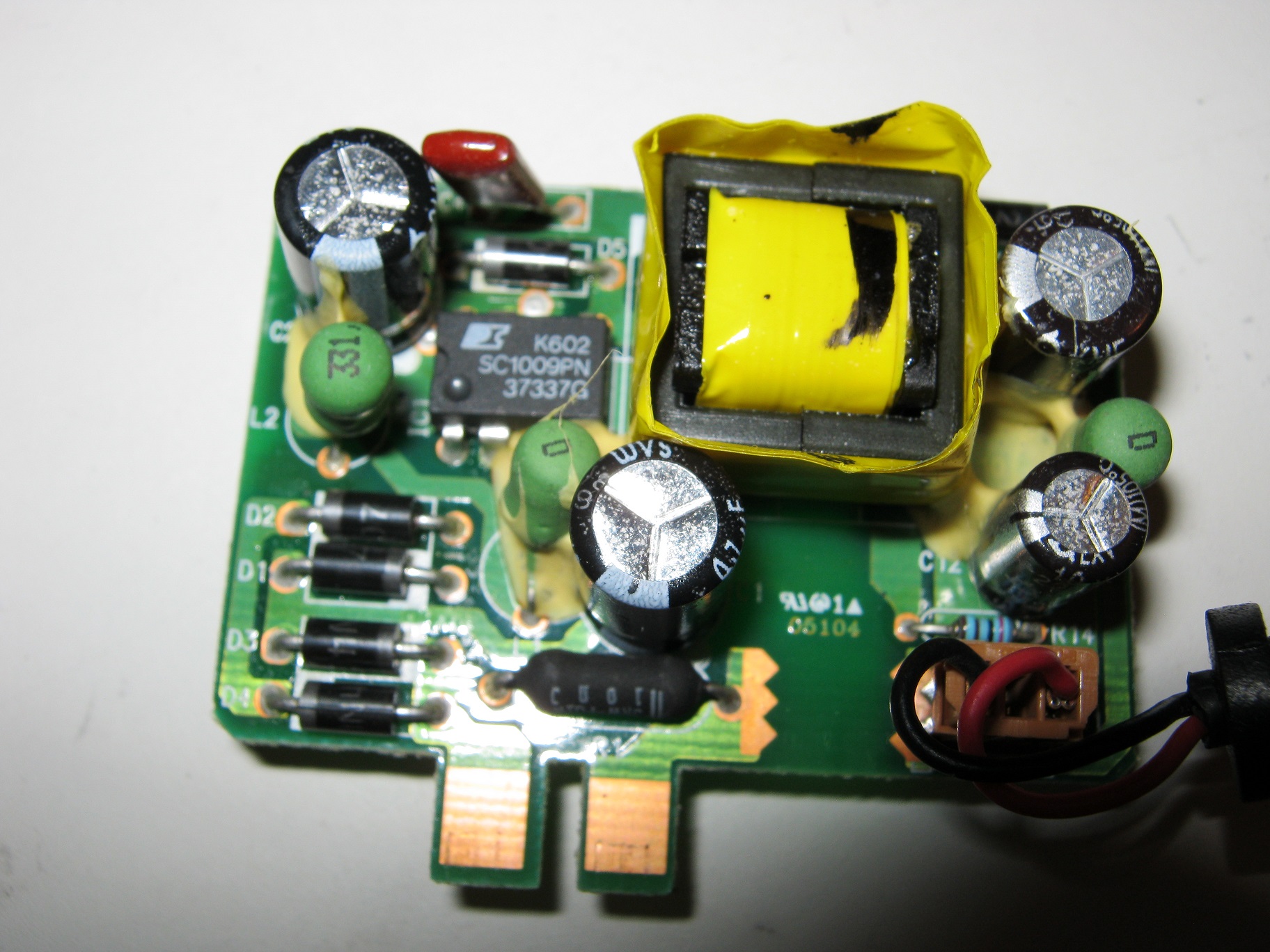

                                  Samsung TAD037JBE cell phone charger
                                  Output: 5VDC 0.7A
                                  The caps are all Sam Young. The primary caps are SHD series 4.7uF 400V, and the output filter caps are KMF series 470uF (pi filter input) and LXV series 220uF 10V (pi filter output).
                                  The switching IC is an SC1009PN, which I can't find any information about.
                                  The output cable plugs into a connector on the board, and the fingers on the edge of the board contact the prongs of the plug.

                                    Using PWM, that's quite nice…for occasional use, why not. But running daily, the caps will die.

                                      Cellphone chargers have been SMPS type for quite a while now.

                                        Yeah but many are some awful single/two transistor forward designs.

                                          The logo on that chip looks to me very much like http://www.powerint.com/
                                          Must be some older discontinued chip. I've seen the TNY276/277 used in several ATX 5Vsb's though (particularly some Dell / Celetronix 305W units)
