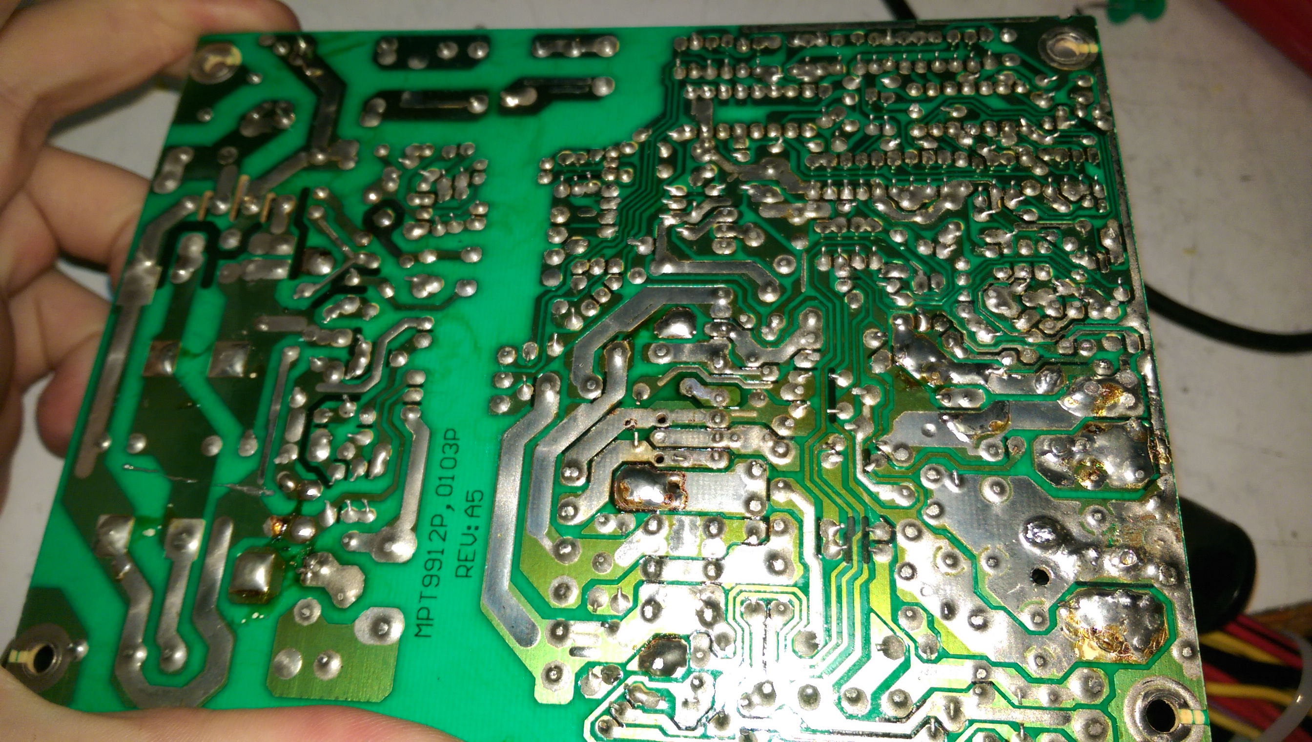

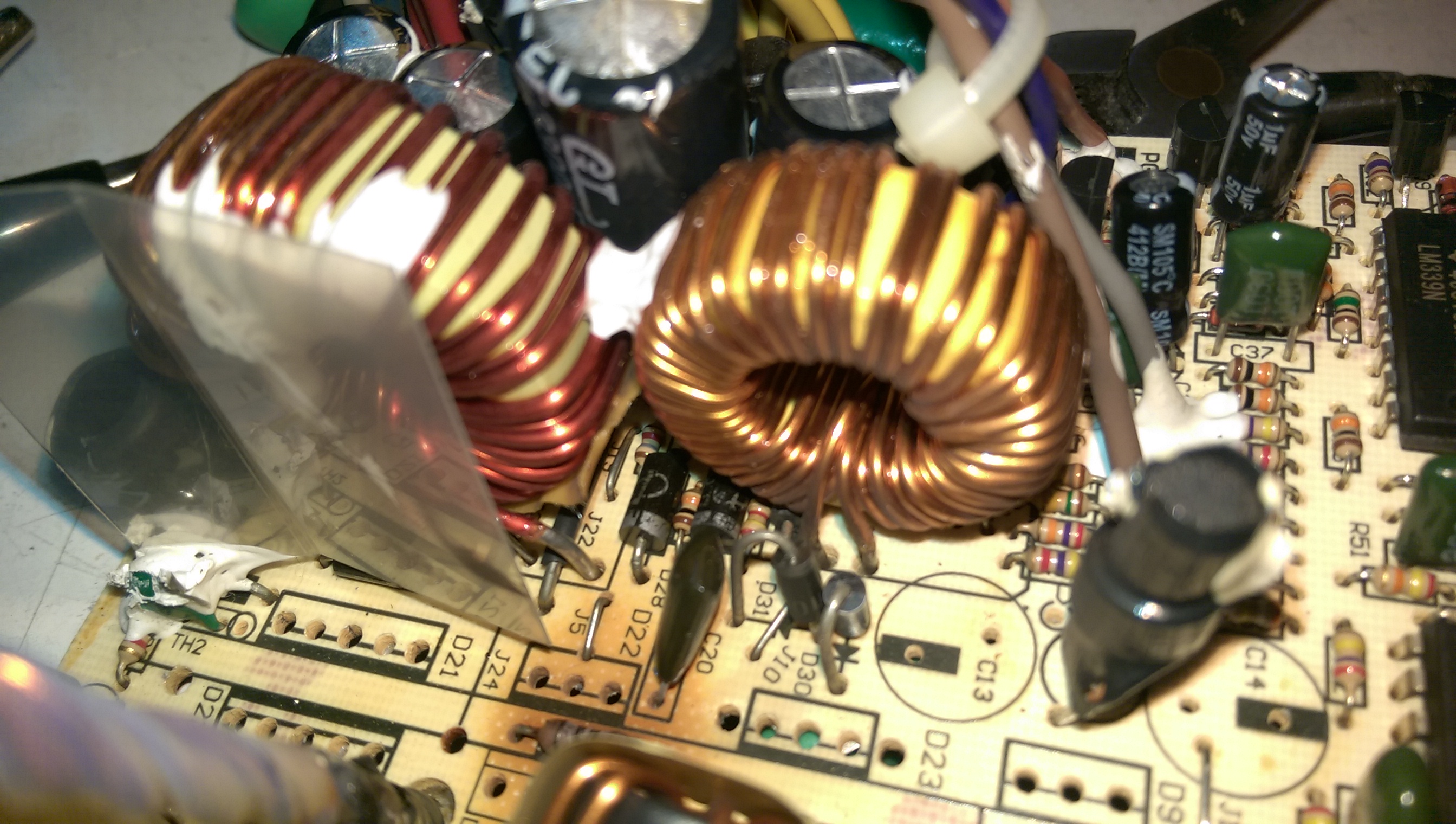

    Saved proprietary Macron MPT-350D

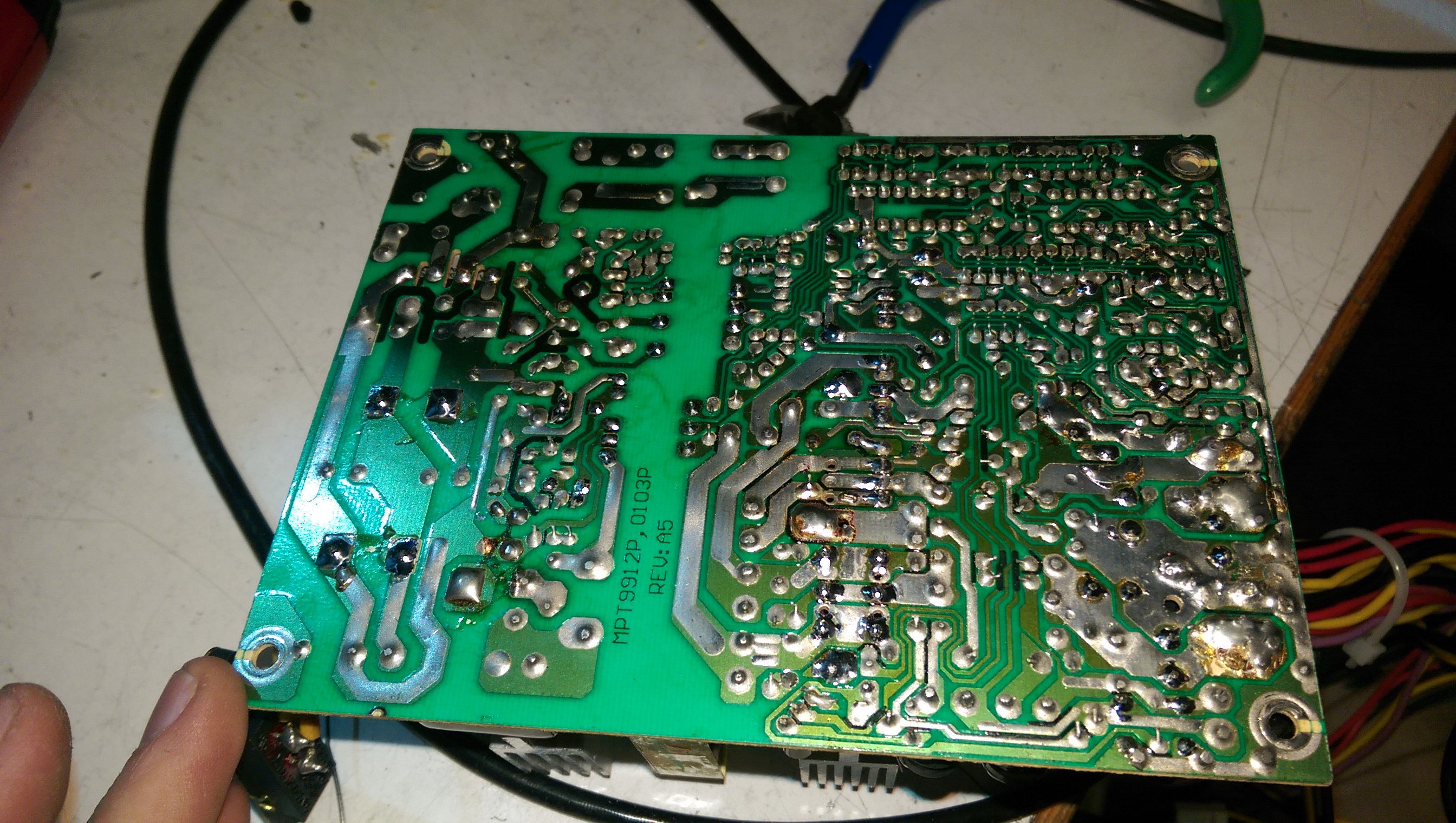

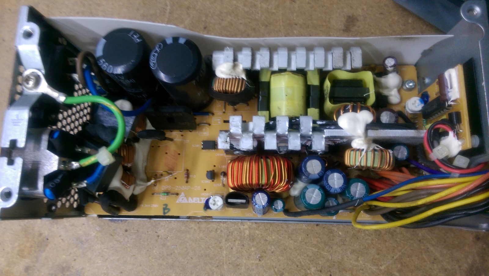

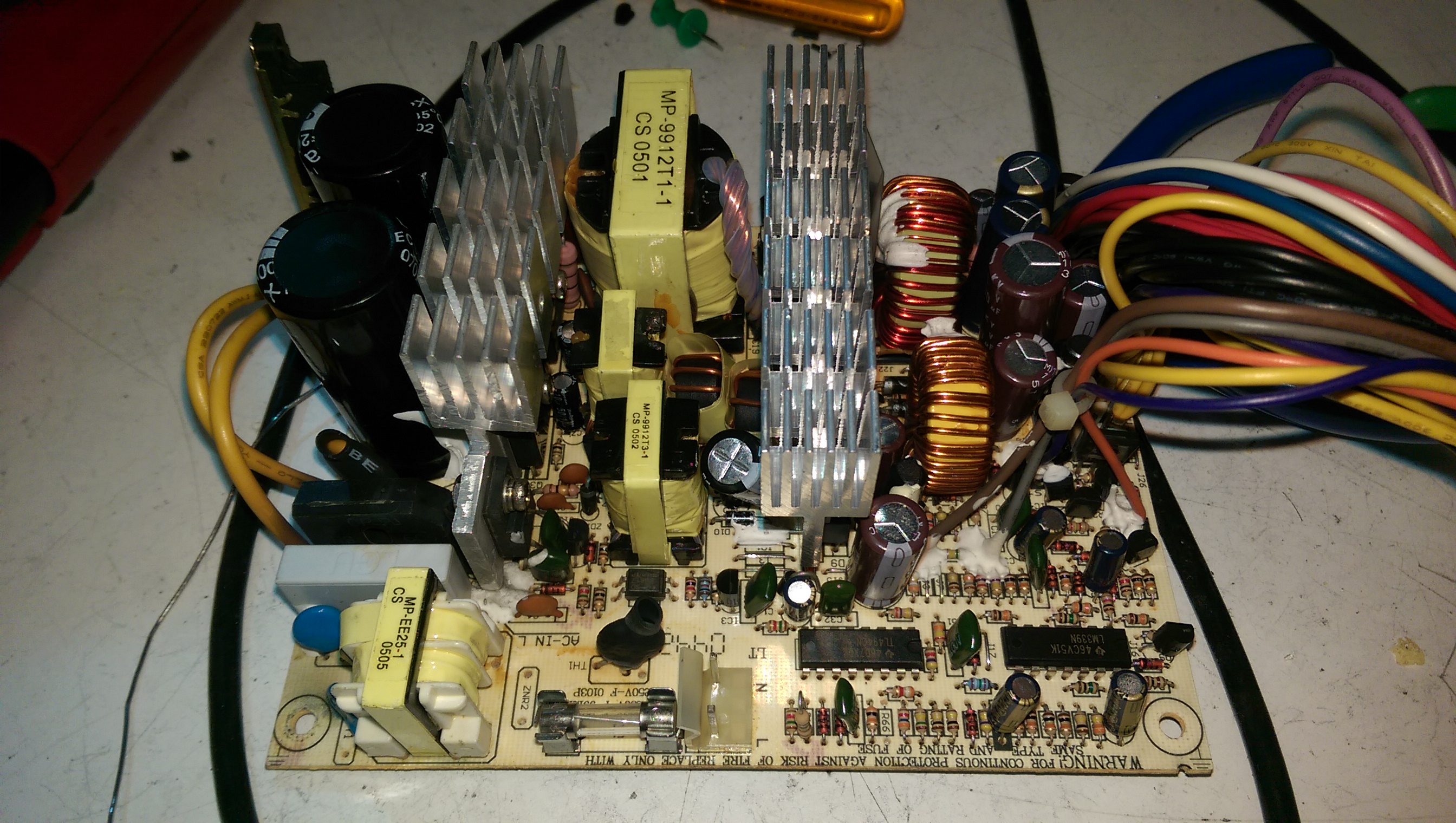

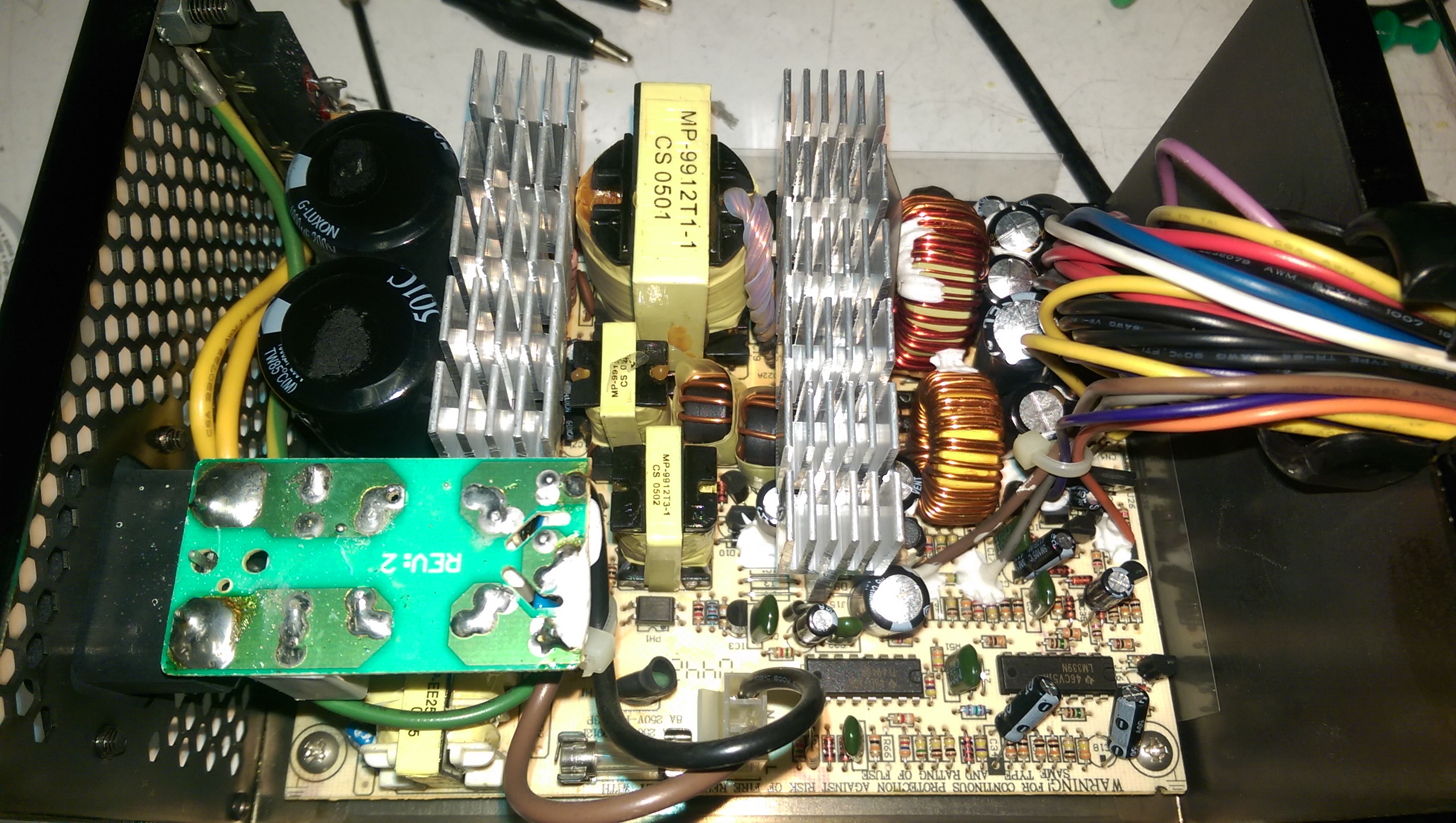

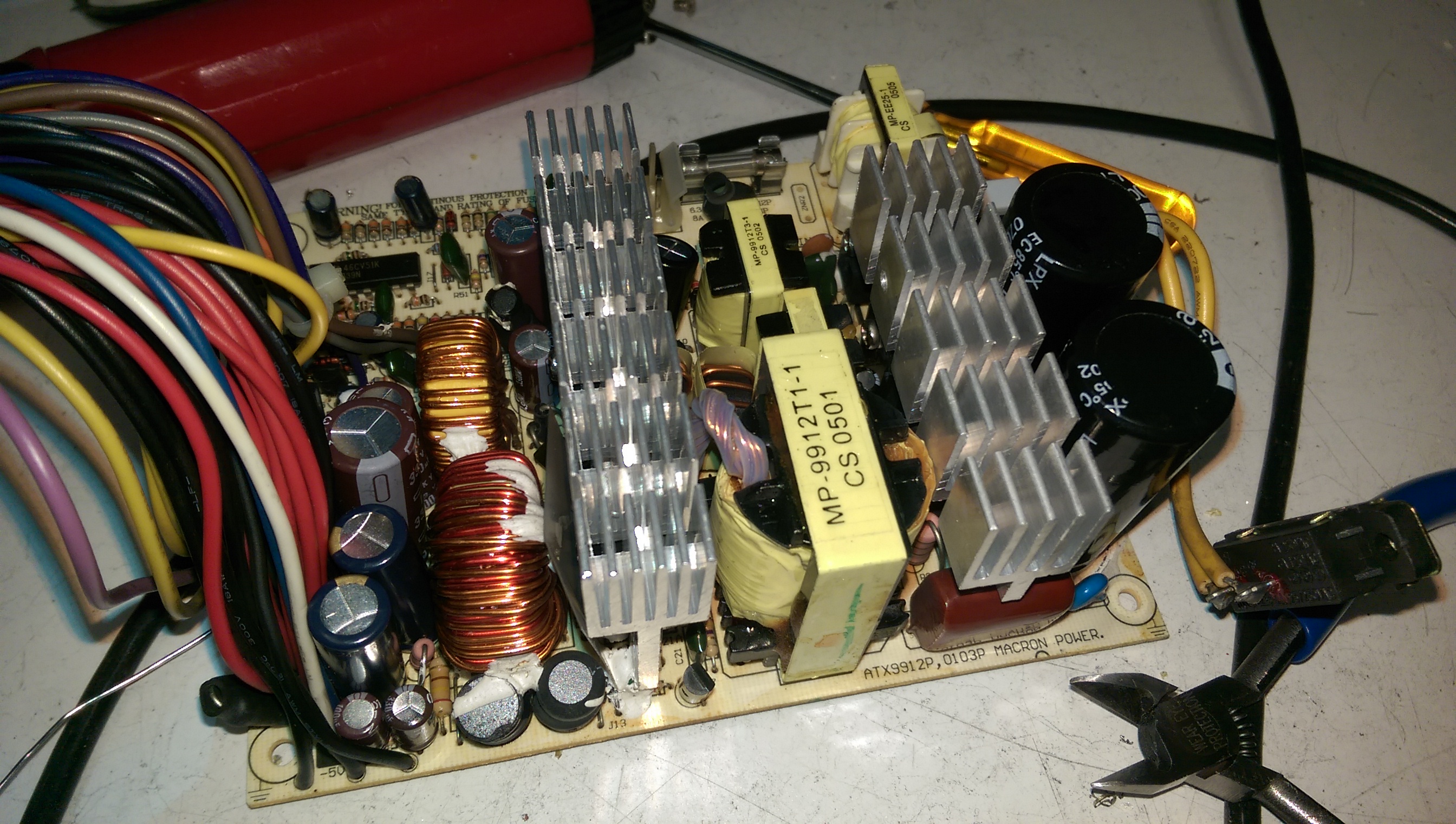

    Okay, so this is another one of the last projects I did at my last company. Thing got about 39,000 running hours on it. The customer brought this computer in and wanted general diagnostics run, even though everything was "fine." I was immediately interested by the chassis ( http://www.newegg.com/Product/Produc...82E16811119071 ) and once I looked at the back of the power supply I yelled "MACRON" I noticed that it was indeed a Macron once I looked at the label, and that it wasn't quite an ATX PSU....I immediately knew that the PSU had bad caps (I even bet my coworker $1000 on it, he did not accept. DAMN! ) but the computer already had a memtest running on it. I opened the top case, and WOW, the thing was fucking hot! Just the side chassis of the PSU was 42C! I guessed that it was powering a Prescott P4 because just by glancing at the board I knew it didn't support Core 2, and the early 2005 sticker on it suggested it wasn't a Pentium D. Once the memtest was done I powered it down and took the PSU out. The thing had been off for about a total of 6 minutes, and the secondary heatsink still measured 75C! The primary was about 50C. I let it cool down and took the heatsink off the CPU. It was indeed a Prescott 3.2GHz P4, 640 model. The thermal paste was so dry and got so hot that it actually started turning brown. The unit was also powering a single 7200RPM hard drive, one DVD drive, a Radeon X1650, 4 1GB DDR modules, two TV tuner cards, a wireless G PCI card, a PCI sound card, and two 0.30A exhaust fans running at full speed. After looking at the inside of the PSU only having a 16A ultra fast, I'm utterly amazed that the thing didn't blow up! And look how cooked that resistor got. I couldn't see the value so I decided not to replace it.

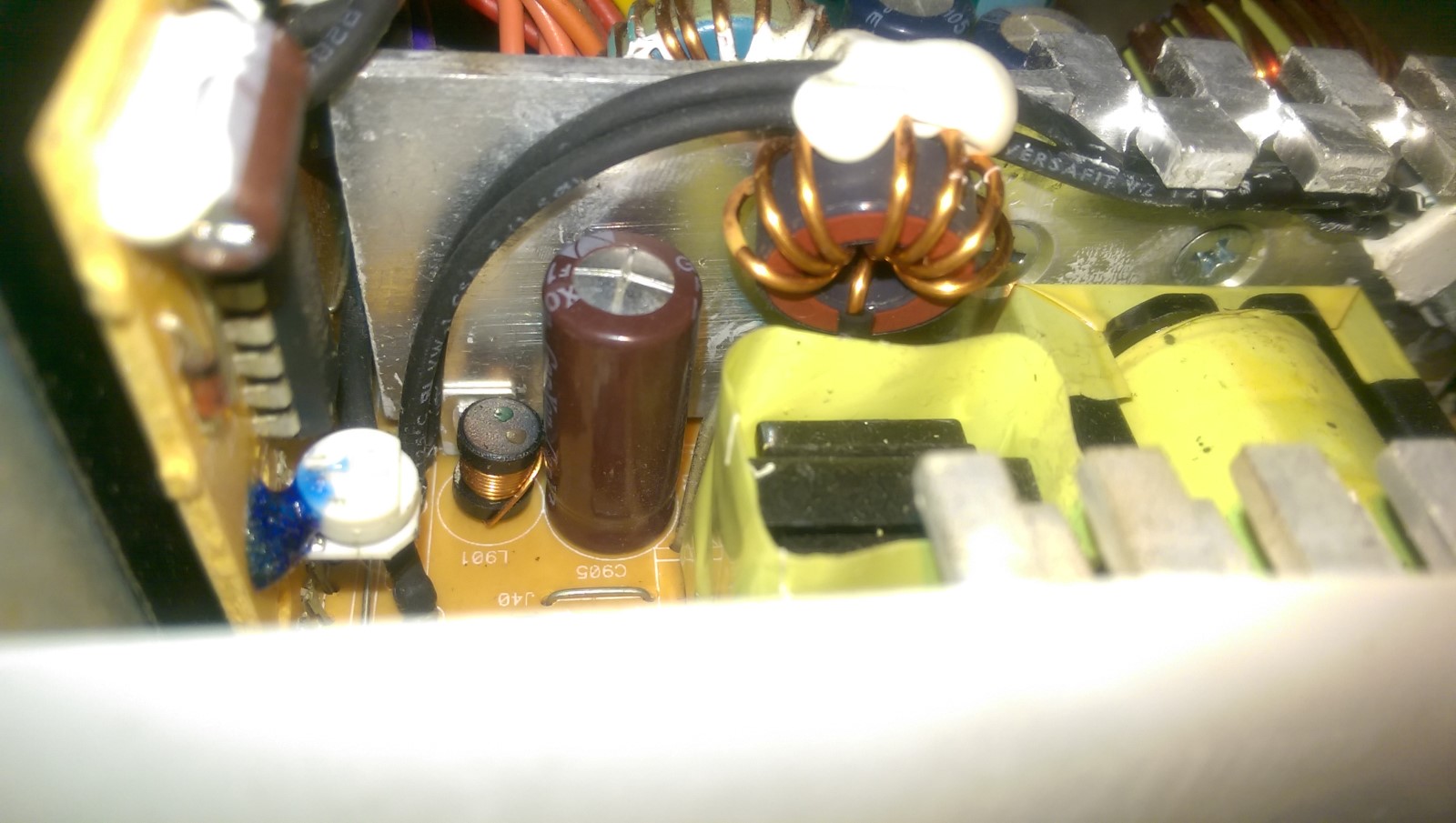

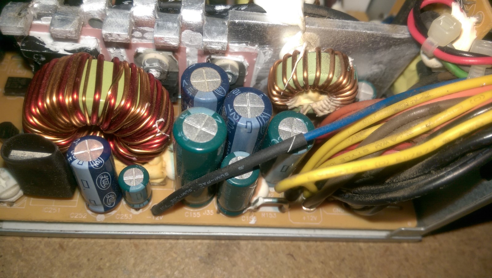

    When pulling the secondary heatsink to replace the 16A ultra fast with a 30A schottky, the 16A rectifier partially split down the middle in the space where the three leads go in to the silicon, and you can see how the heat discolored it. The thing is a true champ Most of the rectifier screws were becoming loose so I tightened them.
    Almost all of the caps tested bad. The only caps that didn't test bad were both 2200uF 6.3V G-Luxon LZ caps on the 3.3V rail (I don't know how this is possible) and the 1uF 50V caps on the secondary. The 10uF 50V GoldLink caps on the BJT circuit read ~2.5uF and over 40Ω ESR I replaced all of the caps with Japanese parts, and because of the high heat and running hours, I replaced the 1000uF G-Luxon caps on the input with barely used 820uF Asia'X. I also redid a lot of the soldering joints that looked like they got weak from the heat they endured.

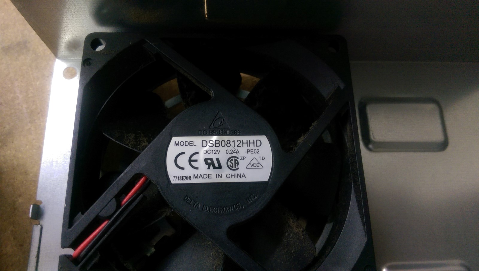

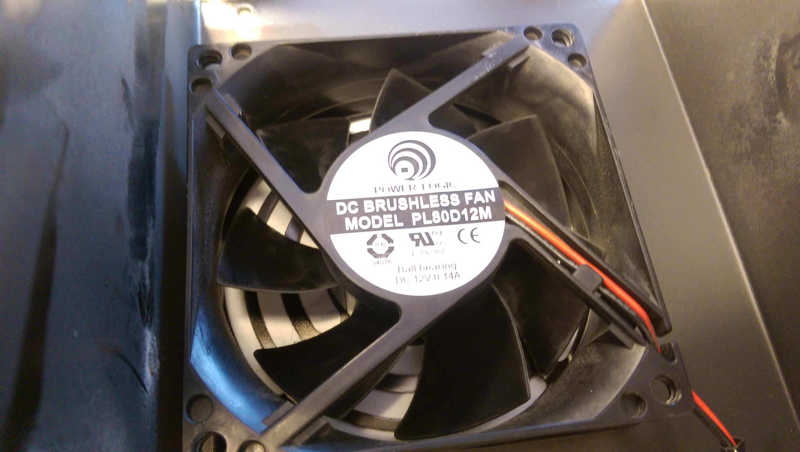

    The Superred fan span okay, but they covered the bearing so that I couldn't get to it. Because of this, I didn't take the risk and just replaced it with a Power Logic ball bearing fan Because of the ripple that the hard drive endured, I talked the customer into cloning their drive to a brand new 500GB one. Everything went successful. I only had an hour to work on this thing, so those are the things I did to it. But afterwards, the thing ran so much cooler! The side chassis of the PSU was barely lukewarm, and the air coming out of the back of the PSU was just warm instead of hot. Just another example of how tough these old Macron PSUs are. I don't think the customer realized what had to happen for their precious computer to maintain proper operation, but I sure felt good after the project was done.

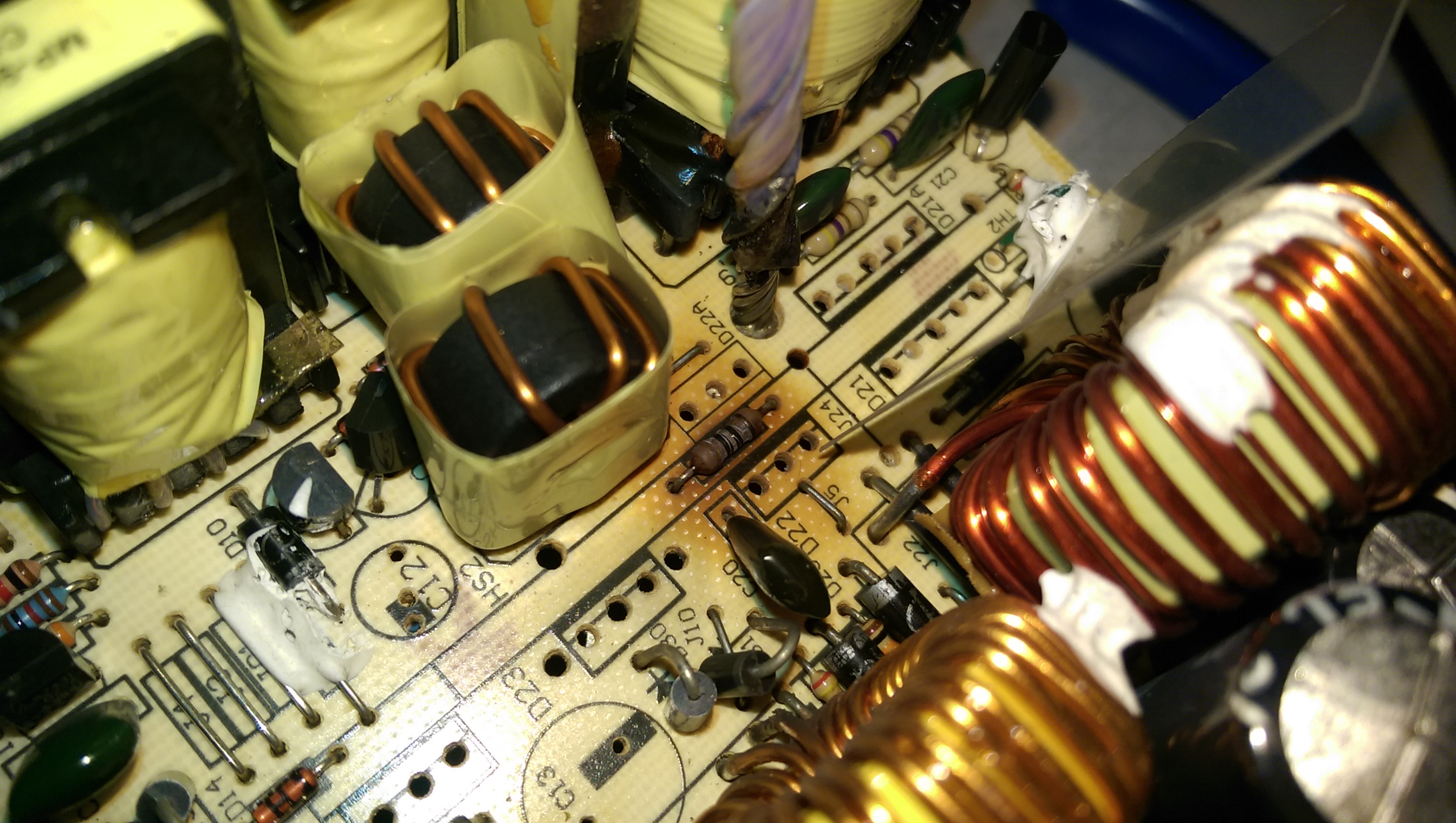

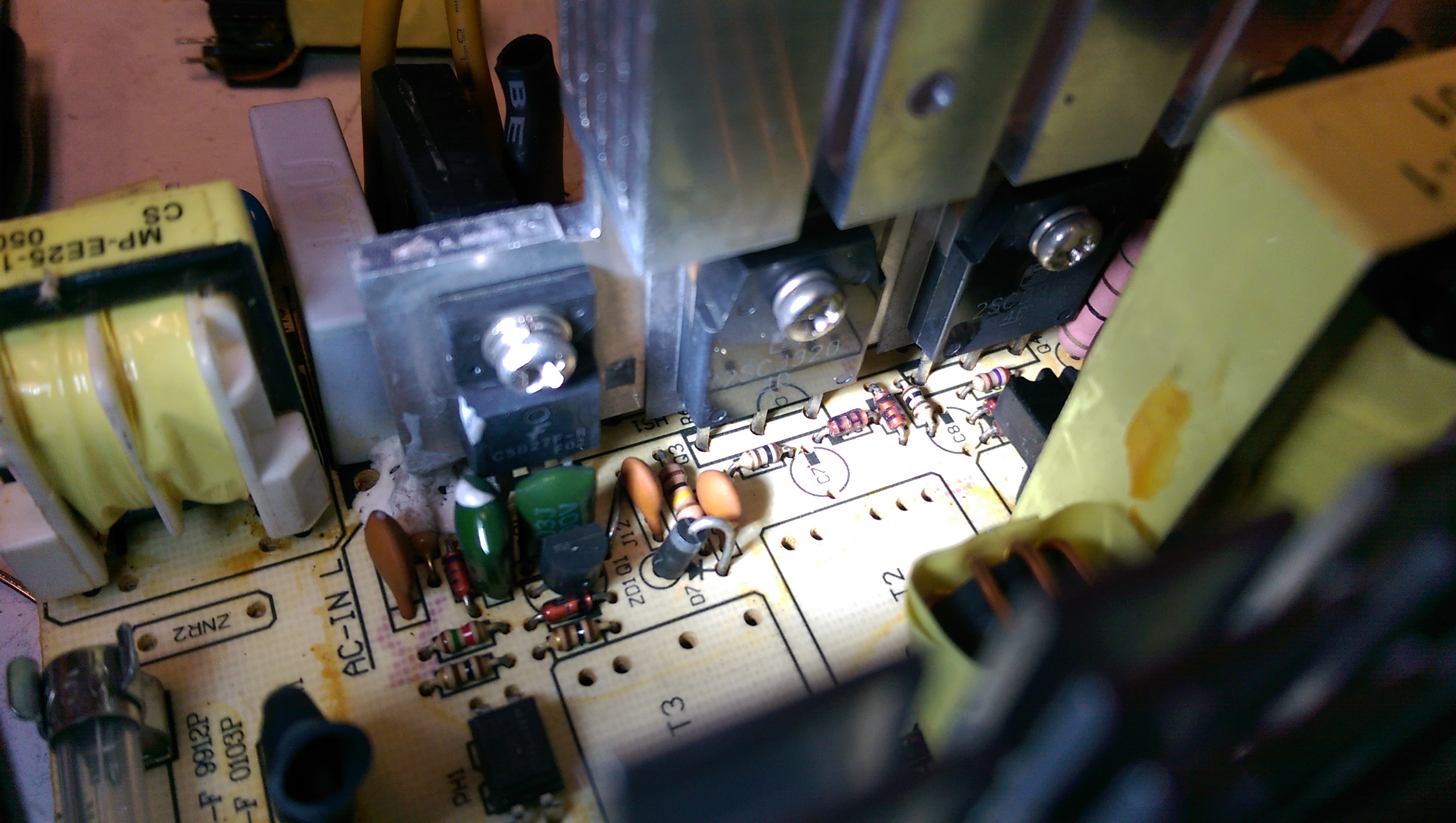

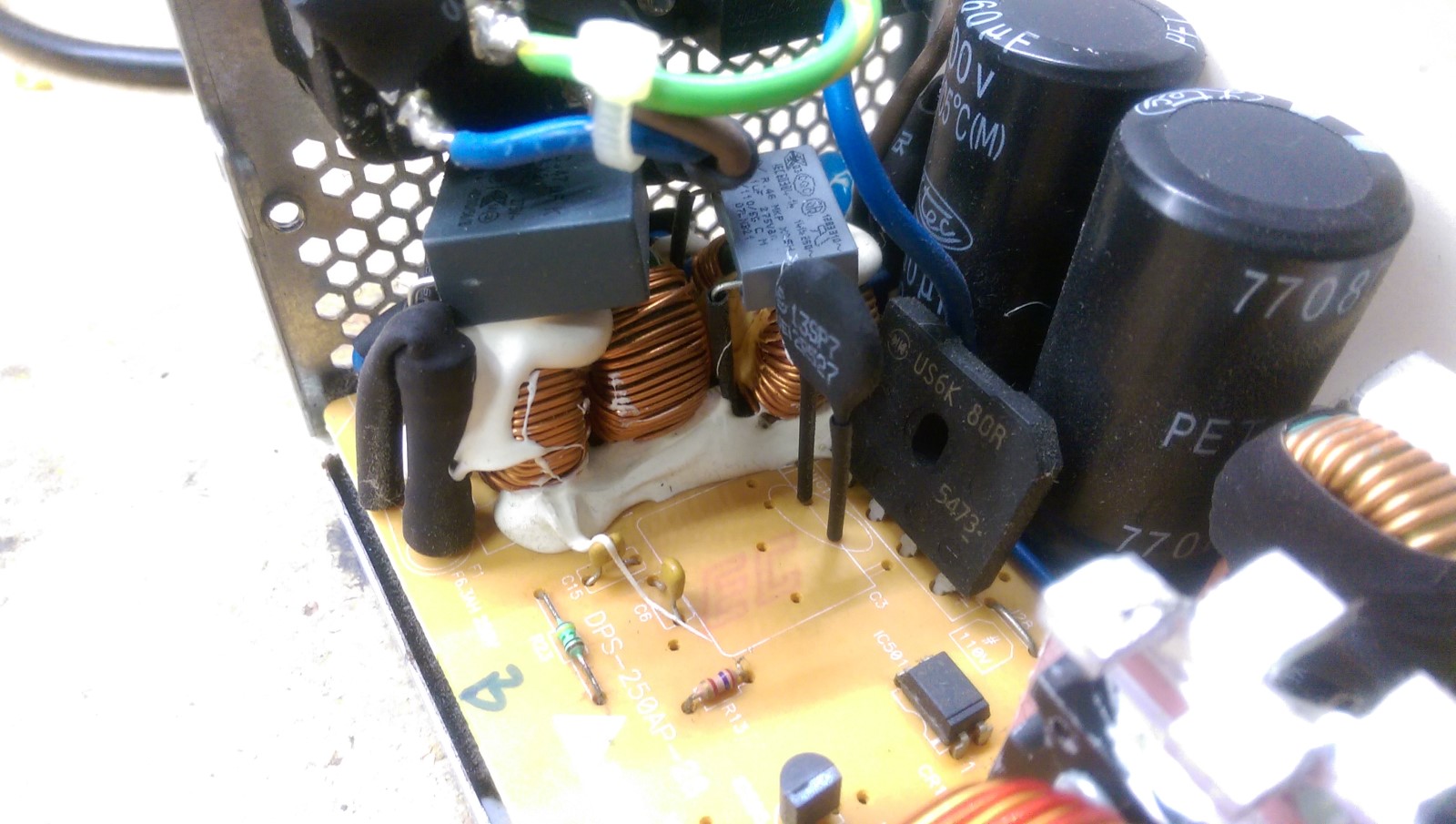

      ^ Replace the 10 ohm resistor, it looks cooked! It might be for the snubber on that rectifier, so that might be why the rectifier started to get really hot.
      Edit: and replace the green film cap near it. It has turned dark green/brown, so yeah it's not had a happy life.
        Well, good thing it wasn't a Pentium D. That would have made it run even hotter.
        Dang. And those heatsinks actually looks pretty decent too. My MPT-301 has the really skinny ones. I can't imagine what would have happened if this Macron had those.
        Yeah, that 16A ultrafast can take quite a beating before letting go. On my MPT-301, the Supperred fan had completely seized. Yet, whoever had it still wrote on it "Fan does not run. Power out OK"
        It's not visible from the photos I posted, but I had the same exact resistor and capacitor really darkened. I think ben7 is correct, it is a 10 Ohm resistor. As long as it's still in spec, it doesn't need to be replaced. Same goes for the green cap. Macron usually uses 103j (i.e. 0.01 uF 5%) polypropylene rather than ceramic - a nice touch IMO.
        I've seen the same happen in an Allied PSU with those snubber resistors. This is usually caused by the output caps failing.

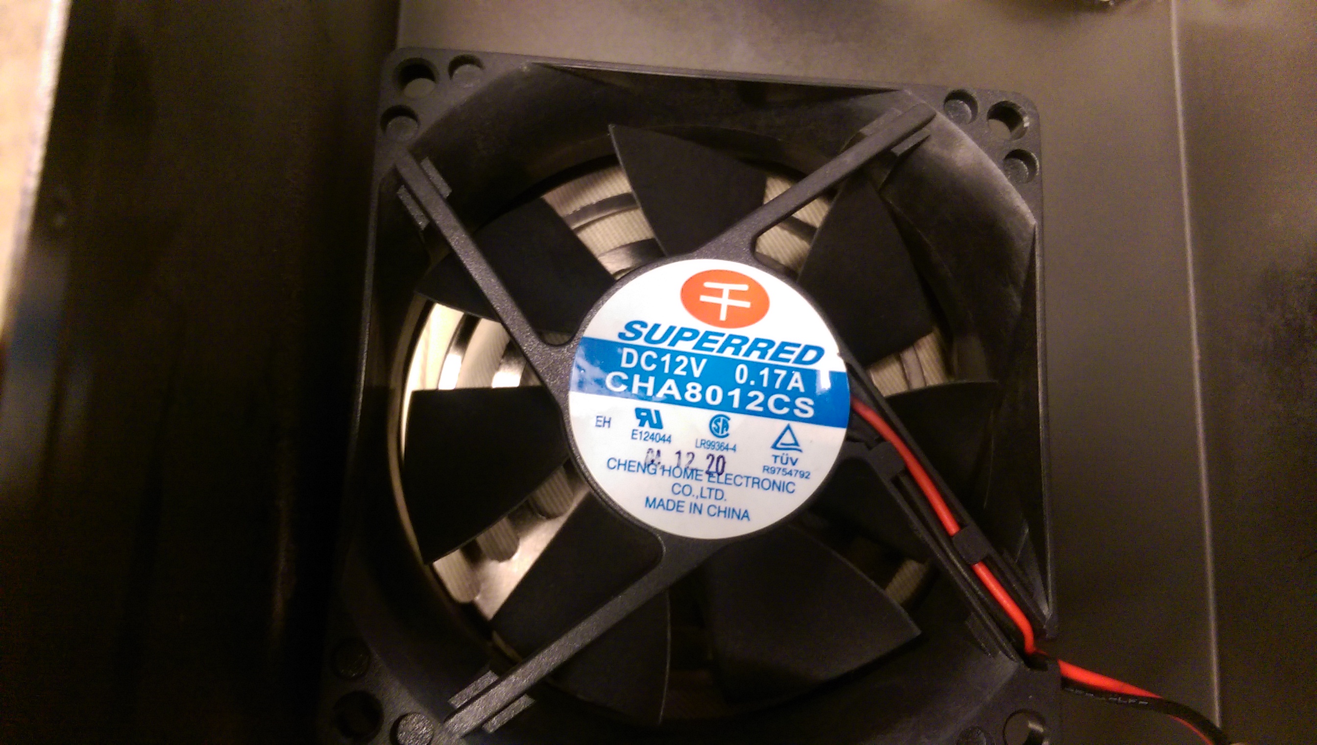

        I hope you saved that Superred fan. The one in my MPT-301 was sealed like that as well and it was completely seized - couldn't even turn it by hand. Had to drill the plastic on the back to get it taken apart. I did, and in the process, I destroyed the plastic c-washer that keeps the fan rotor blade assembly from pulling out. But it ran fine without it, so I left it as is. That was some 5 years ago or so. It still is running to this day. Not rattling or anything either. So Superred fans are good, IMO.
            Ah, 10Ω. Well it's too late now, that unit has got a solid 1,150 more running hours on it by now. I'm no longer at that company I did the work for, but I specifically asked my coworker if this exact unit came back in, and he said no

            Very true. But what I'm thinking is that the PSU was getting abnormally hot for a number of reasons:
            1.) That 16A rectifier had to be overloaded or close to it its entire life. (Reducing efficiency in the process?)
            2.) The rectifiers were becoming loose on the heatsink
            3.) The poor cooling on the Pentium 4 right below the fan intake of the PSU was pulling extra heat inside the PSU.
            4.) Pretty sure the failing caps would create more heat?
            Because afterwards, the PSU ran about as cool as your MPT-301 powering a P4 system with no video card. So either it was extra heat from the CPU, or the efficiency was becoming abysmal to create so much heat! Seriously, the before and after heat difference was amazing.
            I figured as much. I know that resistors can handle an incredible amount of heat. Something like 160C for metal film? I also figured that all this damage was caused by the overloaded rectifier and failed output caps, and that the new, almost double rated schottky + new caps would be good enough to keep it going. I've also seen this is an Allied and a Deer PSU before. So yep, failed output caps sounds accurate haha
            Yes, I normally save Superred fans if they have a seal. I already have so many spare fans, I didn't want to spend the time on this one, so I threw it away. Sorry! At least I put another Power Logic back in the field, does that make up for it?
              Heh no probs. It's just in my inner soul to try and save anything and everything that is salvageable.
                  Probably because G-Luxon was and is (before and after their acquisition with Teapo) inconsistent as with other Taiwanese and Chinese brands. Sometimes they fail and bulge just by sitting there for many years, other times they last several years of heat and torture as in your case (at least two of them). It may also have to do with the fact that the failed G-Luxon LZs are on the +5V rail and are literally touching the +5V/+12V toroid... and that toroid probably became quite a bit hotter than the +3.3V toroid during operation (this was a +12V heavy system from what I can surmise). Loose rectifiers can definitely impede the thermal transfer to the heatsink.

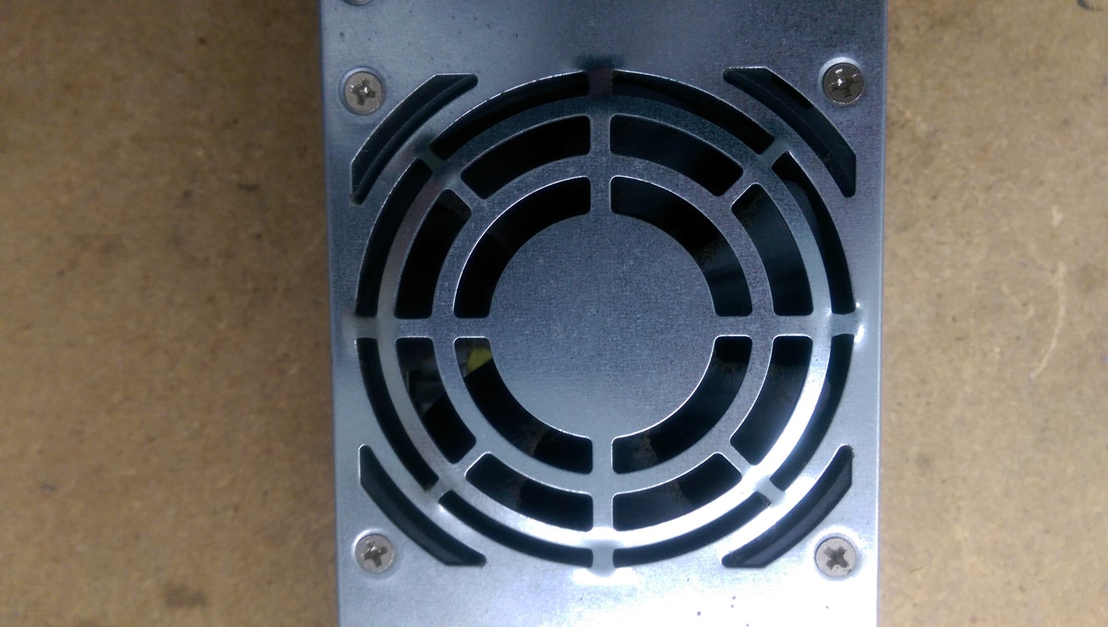

                              Delta DPS-250AB.
                              https://www.badcaps.net/forum/attach...1&d=1432204397
                              Looks like a pretty typical TFX Form Factor unit. It came from a Dell Inspiron 530S.
                              Another shot of the Fan grille. Delta, you're doing it wrong! Wire grilles only, please!
                              The Label. It looks like we have 17A of 12V capacity. Not much, but enough for a PC with onboard graphics, I suppose.
                              Naturally, a Delta PSU uses a Delta fan. Hopefully I shouldn't have to replace it any time soon.
                              The Input filtering consists of three coils and two of everything else
                              The Internals. Not too bad, except for...
                              CapXon GL? On the 5vsb? On a cramped TFX unit? Are you serious, Delta?!
                              The rest of the caps are LTEC and Taicon. At least Delta usually get away with those pretty well. I'm still gonna recap it, though, with the exception of one 16V 1500uF Taicon which I don't have a replacement on hand for.

                                It is cheaper to cut into metal plate than buy wire grill
                                You can use Samxon RS 3300/16, no? There seems to be room enough for taller cap.
                                • c_hegge
                                  • Sep 2009
                                  • 5219
                                  #2336
                                  I could, but I'd prefer not to. I'd much prefer to keep the capacitance the same.
