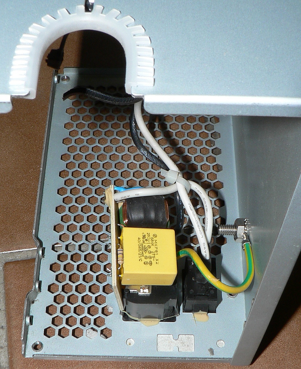

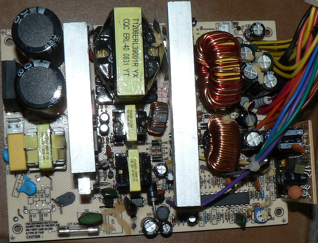

    These Modecoms used to be quite popular for some time arround 5 years ago. I finally got one into my hands after those years and my impression is this PSU shows you can do even the cheap half-bridge combination of SG6105DZ and LM339 decent.
    It lacks only varistors on input. ZHN caps pretending to be 680 uF, can't really measure, no meter. Passive PFC and KBU 606. Fairchild's 13009 switchers with 02N60P for +5 V SB.

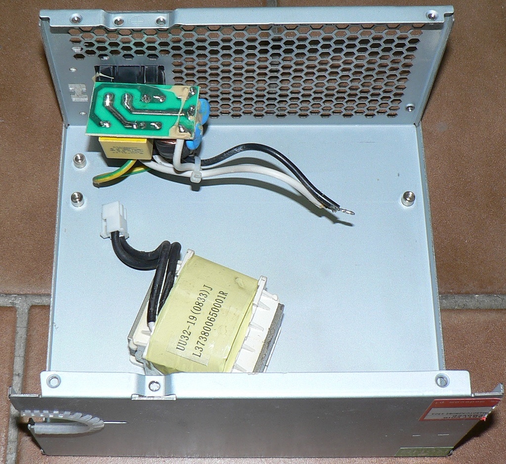

    The transformer is interesting, says ERL-40, but notice the ERL39 in the long string Anway, I think it's beefy enough for 400 W. Huge heatsinks, reminding me the ones in the original FSP BlueStorm; maybe the wind blows from here? I don't really know OEM of this one, no UL or something anywhere… There are two MBR4045PT's for smaller voltages and two MBR20100CT in parallel for +12 V. It says it has two 12V rails, there are indeed two outputs with separate inductors each.

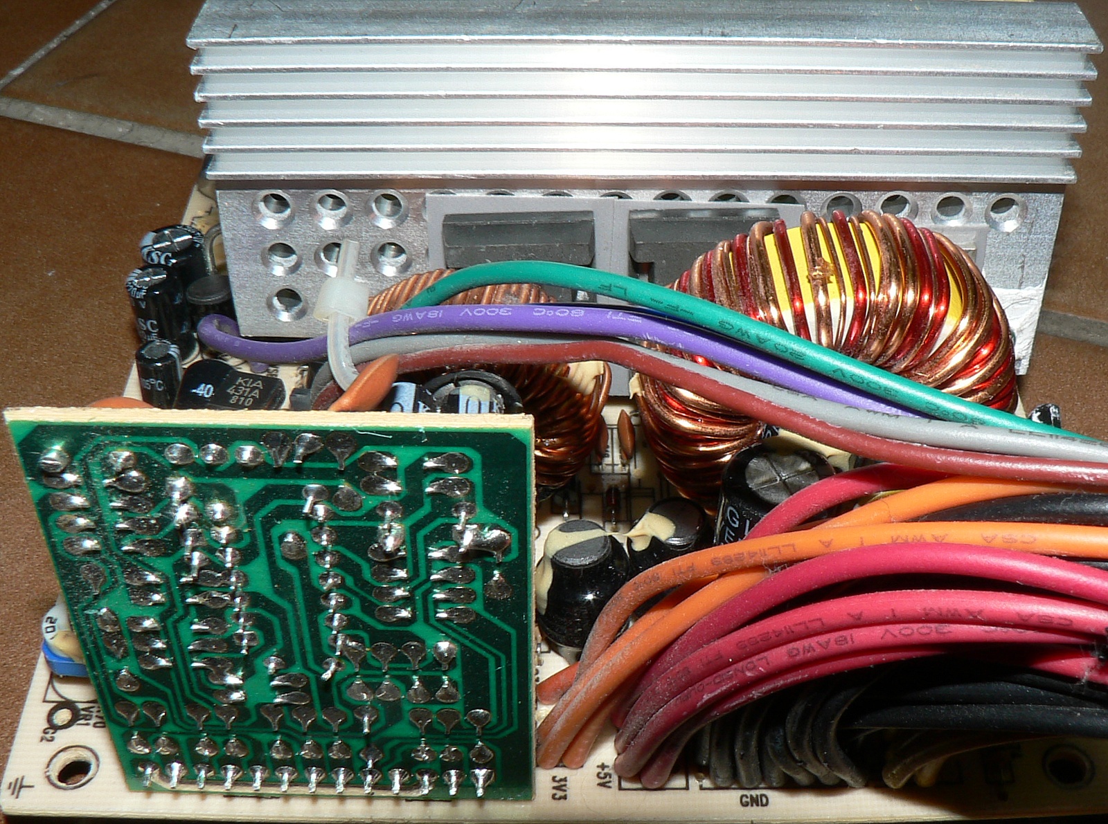

    Feedback to LM339N is going from all three: 12V output from rectifiers and both rails. But I don't think they are actually OPPed as you cannot use inductor as a shunt in my opinion, it's apparent resistances changes with switching frequency, doesn't it. Not mentioning LM339N not having comparators enough to controll everything. I am lazy to track things, but some control of the +12 V it definitelly offers so it's better than most usuall craps of this topology…
    You can see beefy coils on output as well as KSC and Teapo caps; 3300 uF/10 V and 2200 uF/16 V. Can't measure them but visibly OK considering some 5-6 years of use with Venice Athlon 64 3200+ and passive GT 7600. Cables used mostly 20AWG.

      I actually like the looks of that power supply. It could definitely use a recap and some better heatsinks if the fan is no good. That is one big diode on the stand by I like how they didn't even bother to put the combined 12V output on the label and not even the max output for the -12V or 5VSB. i think that thing would probably be good for around 330W? Probably do 400W with some 820uF input caps. I may be missing it but is there not even a spot to put on MOV on the primary side?

        I'll just add it somewhere between phase and neutral at least, you can always find some holes for that;-)
        The heatsinks are very fat, what else would you like? Man, damn, there are hardly better sinks than these are. Not mentioning the thermocontrolled 12cm fan.

            Yes, you're right they are pretty fat. When looking at them they just reminded me too much of the ones in the lower end FSP designs

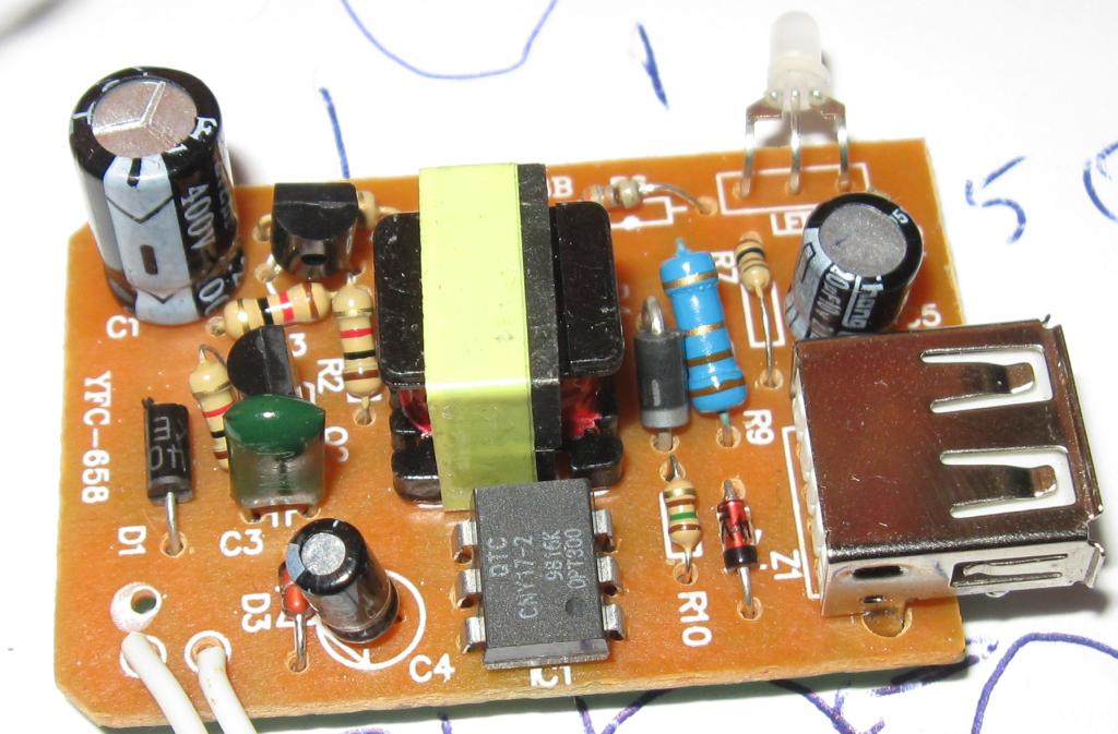

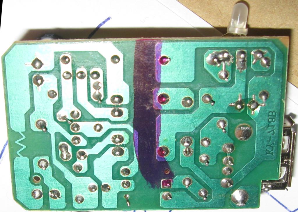

                  Not 100% the place to post it, but I think it's close enough.
                  Got this from DinoDirect.com - wanted to use a xx% off for orders above 75$ and my basket had 74$ worth of stuff, so added this $1.67 usb charger:
                  Short story... it was acceptable up to 280-300mA, but it outputs about 5.6v for the first 200mA.
                  Made a video with it, if you want to see me testing it with a constant current load I made and modding it, click below ... but be gentle with me, it's my first "review" type of video:
                  http://www.youtube.com/watch?v=YLjojTnkJq8
                  As you can see in the video, a 820uF cap on the output instead of the 220uF one and a 4.7uF instead of the 2.2uF primary cap (and a bridge rectifier, though I'm not sure how much it mattered in this case) got this adapter to give relatively stable output up to about 420mA.
                  I think the transformer is simply too small for the job, the transistors should work.. it's a classic 13001.

                    Wow, that is really cool You got a decent improvement out of it too

                      Just don't short the output, it will go BOOM!
                      P.S. Please, put a fuse in there too.

                        No, it will probably go in the trash, unless I recycle a small bridge rectifier from somewhere. I'm also basically out of any high voltage caps of the size that would fit inside such adapter - I'd love to try a 10uF-22uF cap on the input side but I only have 100+ uF capacitors..
                        I've used a GBU405 in the video, it's a huge (for this crap "psu") 4A 600v bridge rectifier.
                        If I do that, I'll probably also get a small inductor and a 330-470uF and do a pi filter on the output, to get the output even cleaner.
                          It has one already. See that squigly PCB trace on the primary side? - that's the fuse

                                  In regard to the adapter itself, yes, that's supposed to be a fuse there, that wiggly trace. I wonder how big of a tolerance such type of fuse has. After all, the pcb would absorb some heat.
                                  The only thing that I'm upset about now is that I used a small time scale on the scope, it was set at 5ms per division.
                                  With a bigger value, the adapter on its default configuration would have shown its true colors (big ripple and oscillations) at even lower loads. As I had it, I was only looking at a small period of time so I think the graphs looked better than the reality.
                                  It would have made the improvements brought by the bigger output capacitor even more noticeable.
