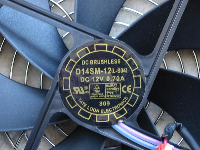

            And for the finish, we have the fan:
            Yate Loon D14SM-12 (L-S04) sleeve bearing fan, rated for 0.7 Amps @ 12V. That’s quite powerful. Unfortunately, the speed controller of the PSU is not very good (haven’t traced it yet, though), as the fan sounds rather loud even when the PSU is not loaded. Something tells me I’ll have to mod that too.

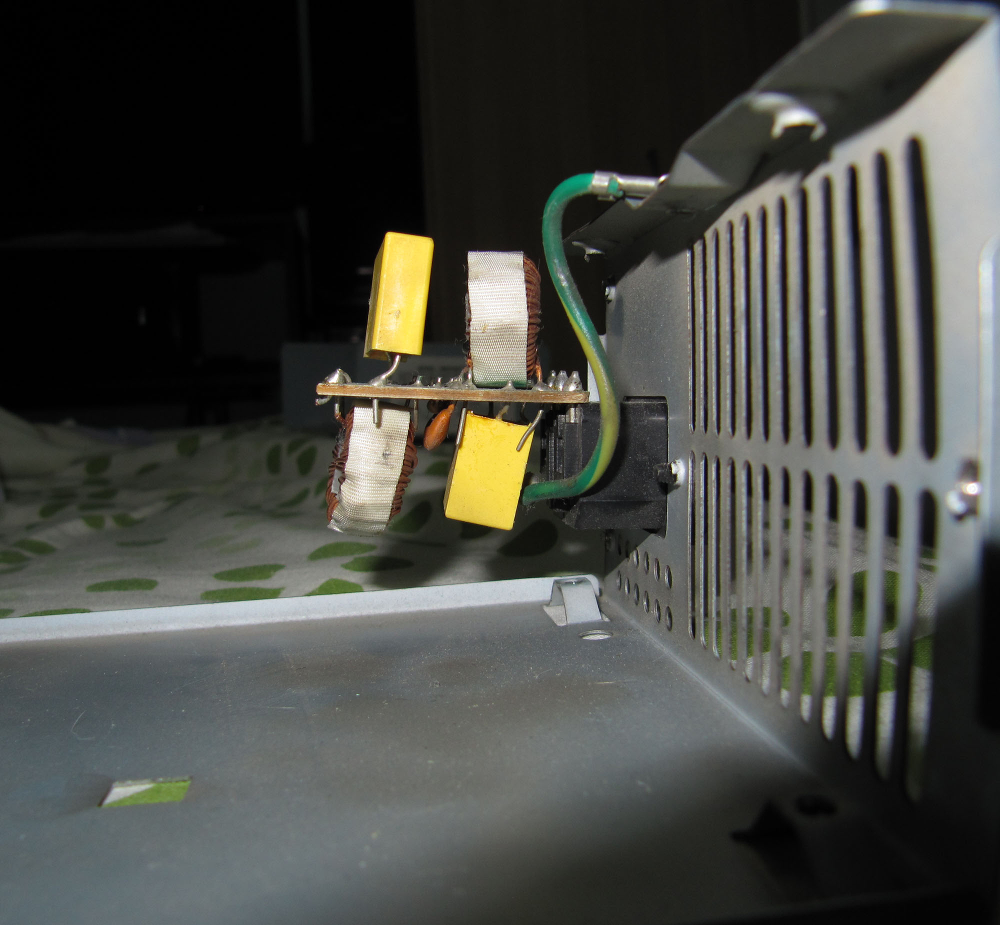

                        Th input filter on the AC plug has some long uncut leads that make me uncomfortable.

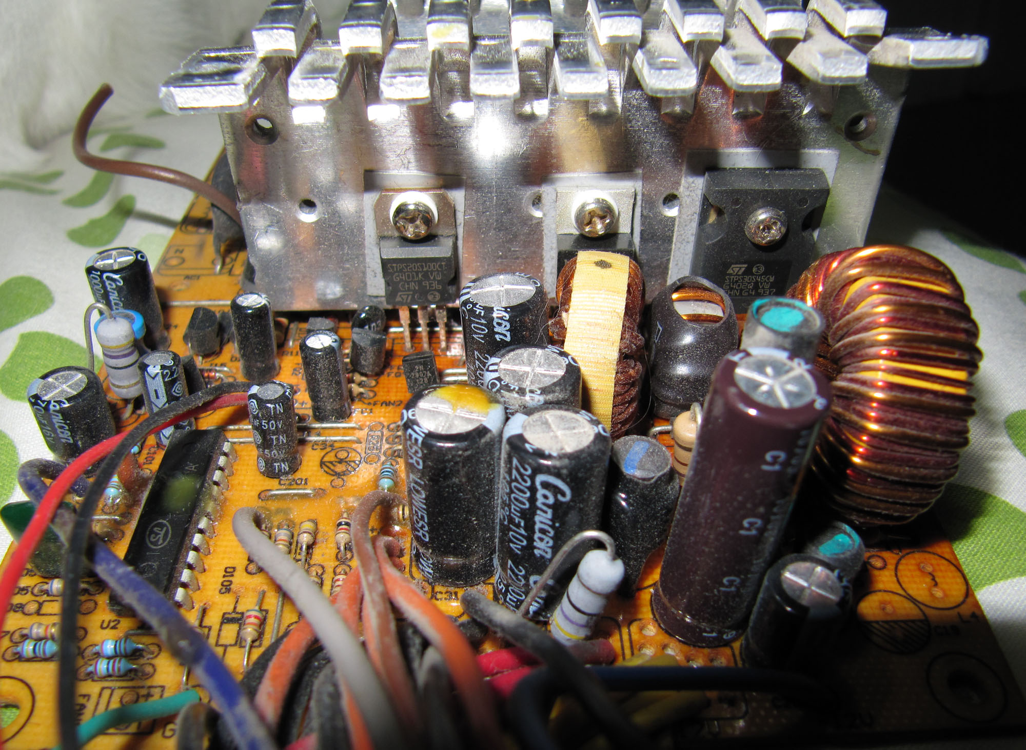

                        There are burn marks all over the PCB, especially on what appears to be the snubber network of 12V rail.
                        The area around the group regulation toroid coil got quite toasty too
                        I was happy to find the psu uses 2x13009 NPN transistors but at the same time, the main transformer is tiny, it's not even an EL33 size. How did this thing manage to power the AMD cpu?
                        The heatsinks are ok for 300W with large surface area and a lot of fins and not ultra thin.
                        The IC is SD6109 PWM/supervisor combo.
                        S20C40C @ 3.3V
                        STPS30S45CW @ 5V
                        STPS20S100CT @ 12V
                        The soldering is very good as always with Linkworld.

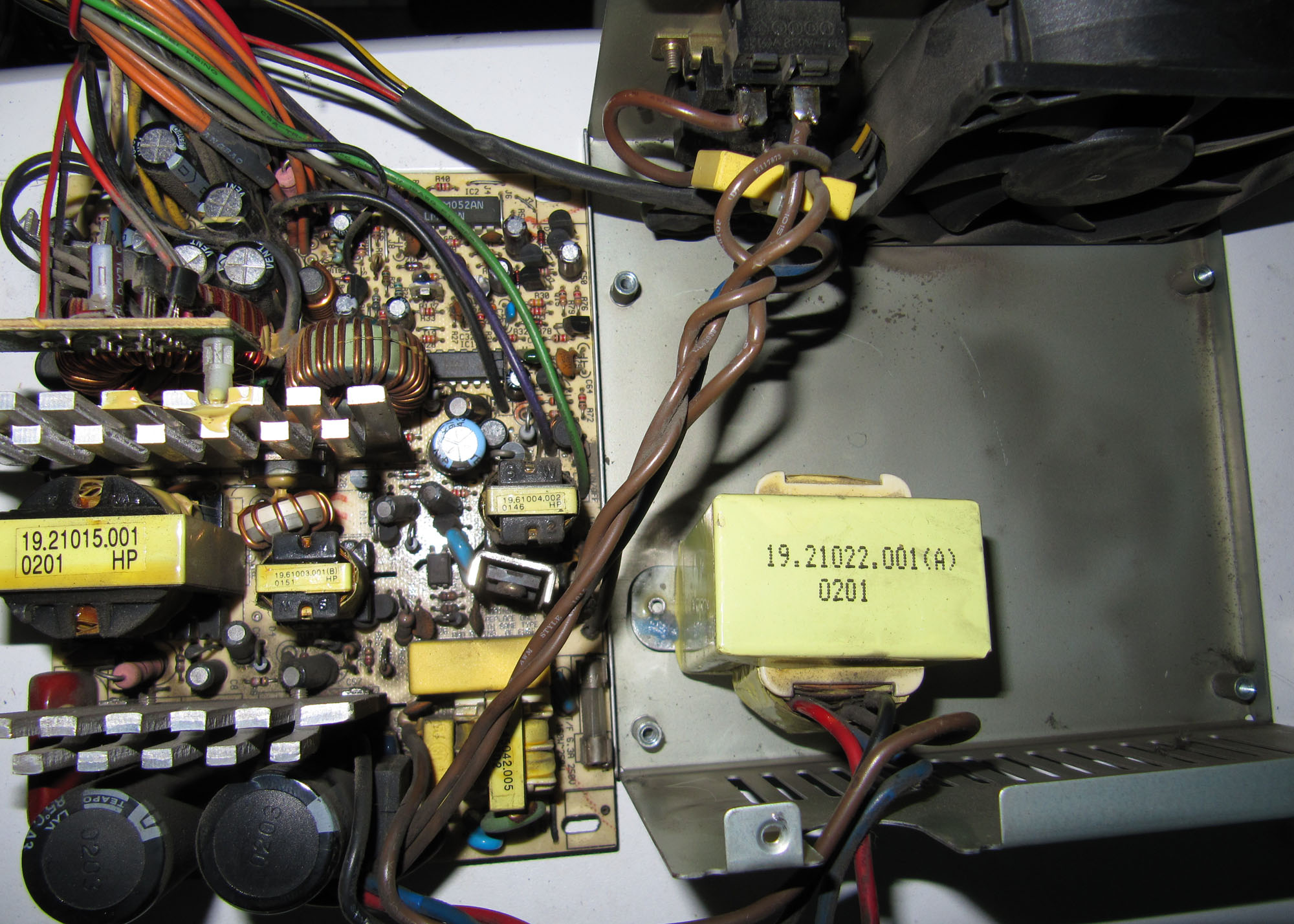

                              Another Enlight 300Watt psu.
                              Very old power supply, this was made back in 2002 and still worked. No bulging caps. Even the terrible Jenpo capacitors seem to be ok.
                              This is the worst design I have come across though, in terms of 12V cpu support. The voltage regulation is terrible and the psu oscillates heavily when it powers a 12V heavy cpu such as Pentium D.
                              I really like the fan with the 3 pin header that can be connected to the mb and get RPM readings. The fan is ball bearing or high quality sleeve bearing as I have never met a seized or noisy one.
                              The passive PFC coil uses 4 cables instead of 2 and it is connected right after the bridge rectifier. Not sure how this works.
                              The soldering is excelent and I found that there is some work from the factory on the back of the PCB, probably to improve the voltage regulation? who knows?
                                Hey, that sounds and looks familiar!
                                I have a TASK TK-930TX that acts similarly with a heavy 12V load (and also not great with a heavy 5V load either.) I posted about it here:
                                https://www.badcaps.net/forum/showpo...postcount=2735
                                I think the OEM is Sirtec, thought not 100% sure anymore. The 3-pin fan, 5VSB circuit arrangement, Teapo and Jenpo output caps, and Teapo LXK input caps I think confirms yours is also made by the same OEM, even though the PSU appears different. Mine also had really good soldering too.
                                Guess it shows that good quality parts used does not always mean good quality PSU... or at least not a well-designed PSU, anyways. I wonder how many hours yours has on the clock. Maybe it worked all these years, despite the oscillating 12V rail... or maybe the PC it was in was unstable, and as such wasn't used much and kept in storage for a long time??
                                Yup, I think Sirtec usually uses good quality fans. The TK-930TX came with a Protechnic Magic. Sure that's no Nidec, Panaflo, or Sanyo Denki... but it's still a very decent fan.

                                Looks like the 5VSB (which is fairly typical for Linkworld PSUs with a 2-transistor design, despite not having a critical cap) and also the output toroid inductor.
                                On that note, I wonder if the position placement of the CM output toroid had anything to do with the overheating (besides running the 125W AMD X4 CPU, lol.) I regularly see Linkworld use these tiny PCBs in all kinds of cases - some with 120 mm overhead fan and some with 80 mm back fan. I wouldn't be surprised if they used this PSU in other cases too. In which case (pun intended ) maybe they top-mounted, downward-blowing 80 mm fan in the mATX PSU case didn't provide enough cooling to the output toroid.

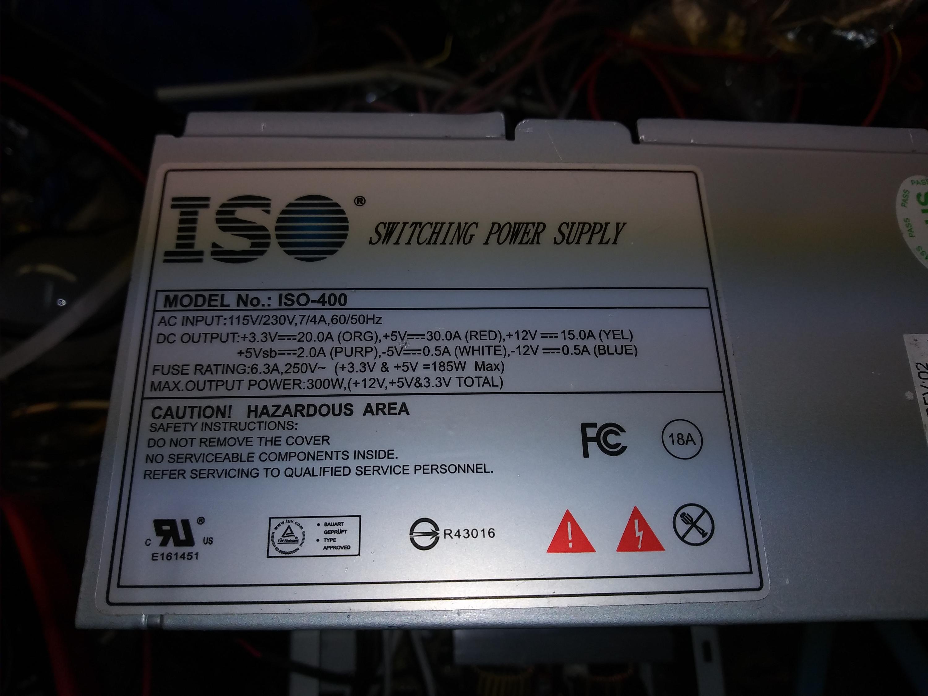

                                  ISO Model: ISO-400 350w PSU
                                  Hello, I've been wanting to show this PSU for a while, but have not due to a mix of laziness and fear that i would once again make a fool of myself. But excuses aside here is a look inside a NOS ISO PSU.
                                  Label:
                                  https://www.badcaps.net/forum/attach...8&d=1593917036
                                  There's not a lot to say here. The UL number points towards Channel Well Technology as the OEM (no surprise there).

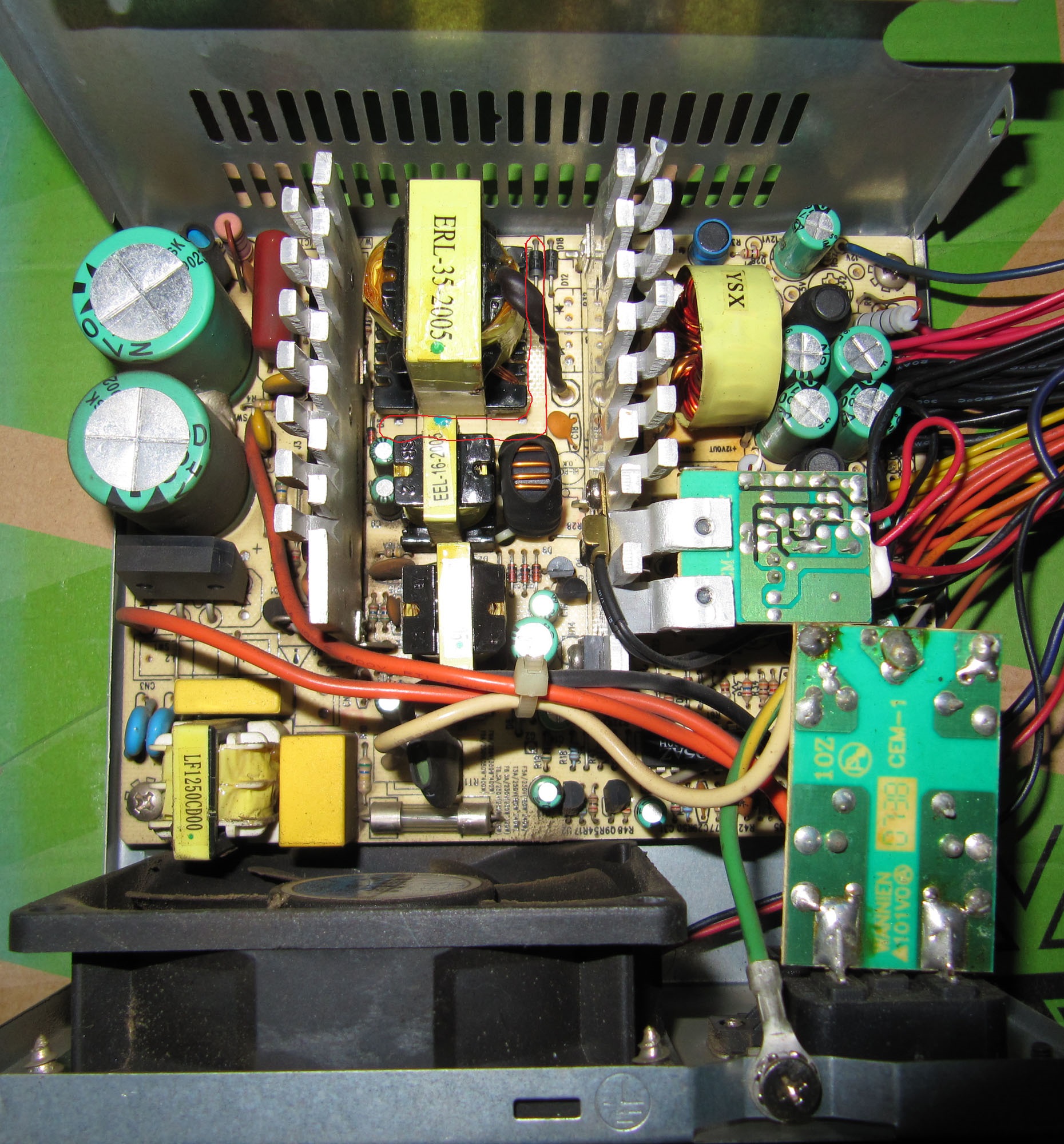

                                  Board Overview:
                                  https://www.badcaps.net/forum/attach...6&d=1593917036
                                  https://www.badcaps.net/forum/attach...3&d=1593917036
                                  The component layout looks pretty typical, the soldering looks sub-par at best as all of the solder joints look dull and it looks like some of the joints on the secondary side had to be reworked from the factory.
                                  Primary side:
                                  https://www.badcaps.net/forum/attach...4&d=1593917036
                                  The input filtering/PFC consists of 3 X2 capacitors (1x 470nf & 2x 100nf), 3 Y2 capacitors (4.7nf), and a single common mode choke.
                                  This power supply has an NTC thermistor but lacks a varistor (so a decent surge can kill this thing).
                                  The bridge rectifier is a PBL405 (Rated 600V, 4A), the primary capacitors are two Gun LG 470uf 200V, rater for 85c temp, and with the date codes 1011.
                                  The 5VSB Mosfet is a C5353 while the main switching transistors are two KSH13009AL's.
                                  The main transformer's size is 36.5mm wide by 45mm tall (i'm guessing this makes it an ERL36).

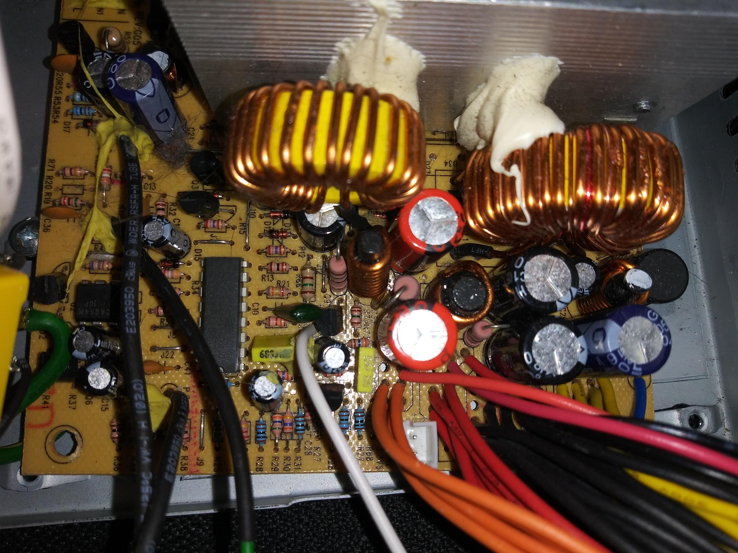

                                  Secondary side:
                                  https://www.badcaps.net/forum/attach...7&d=1593917036
                                  https://www.badcaps.net/forum/attach...9&d=1593917036
                                  The 5VSB rail contains an SB540 diode, a PI coil and two capacitors, one Junfu WG 1000uf 10v before the coil, and one Junfu HK 470uf 10v after the coil.
                                  The 3.3v rail contains an MBR2045CT rectifier, a PI coil, and two Junfu HK 2200uf 6.3v capacitors (one on each side of the coil).
                                  The 5V rail contains an STPS3045CWC rectifier, a fat PI coil, and two Junfu HK 2200uf 10v capacitors in the exact same arrangement as the 3.3v rail (one cap on each side of the coil).
                                  The 12V rail contains a BYQ30D rectifier, a Junfu HK 330uf 16v capacitor, a PI coil, and a Junfu WG 2200uf 16V capacitor.
                                  The -5V rail contains an FR104 diode, a PI coil, and a Junfu HK 220uf 16v capacitor after the PI coil.
                                  The -12V rail contains an FR154(?) (the number isn't fully visible on the diode) a PI coil, and a Junfu HK 220uf 16V capacitor.
                                      don't think CWT has anything to do with this PoS, likely some fake copy if anything
                                      they make CM6800 based PSUs as the cheapest for way more than a decade now

                                        Re the input lytics, your instincts are good, I think. 470uF will probably give decent hold-up time for 250W. The heatsinks might be good to 300W. OTOH, AWG #20 wire seems to me more appropriate for 235W-250W. So I'd consider it 250W, capable of significant duration surges to 300W.
