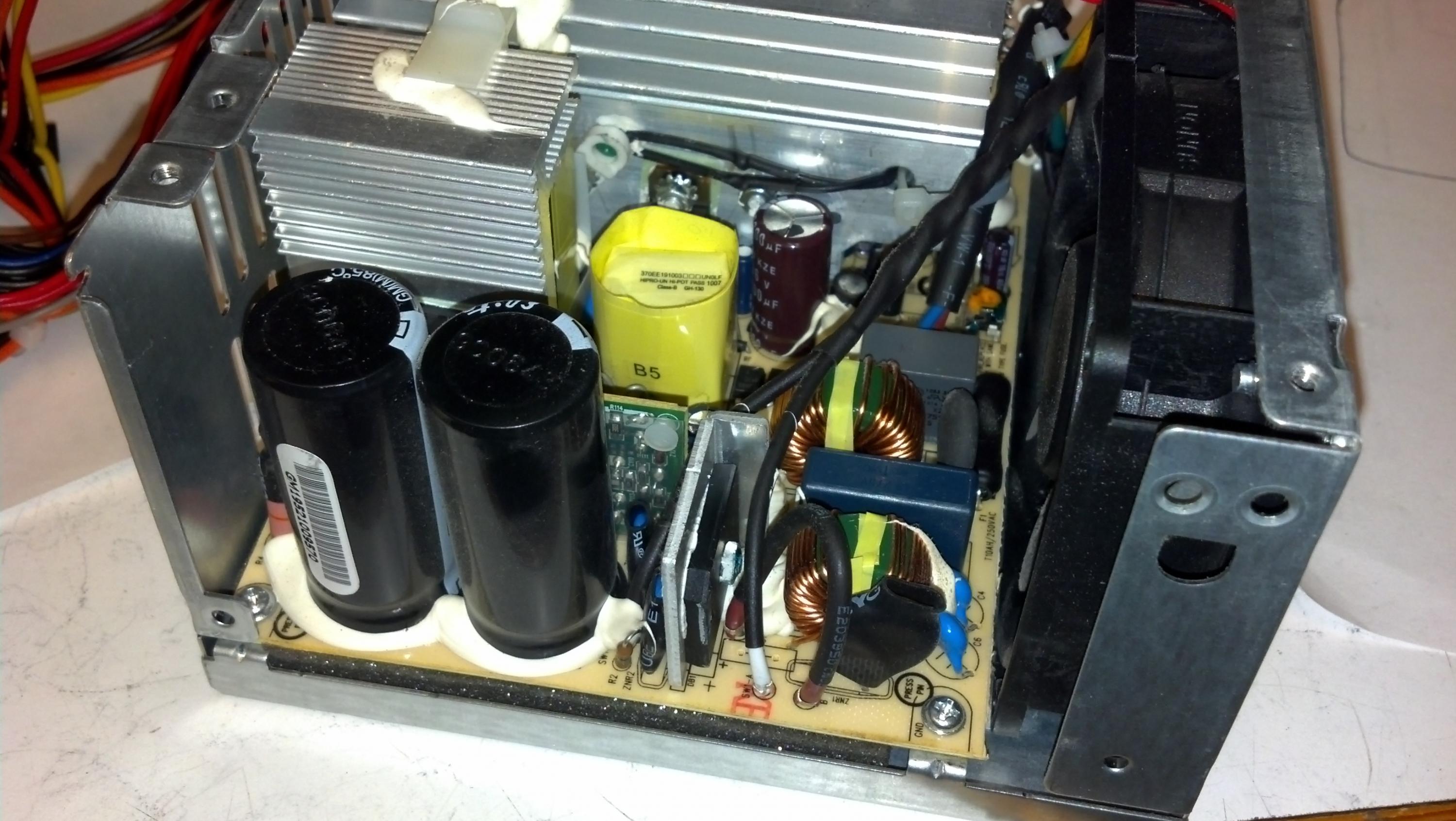

      FSP Group FSP300-60THA
      300W rated. 3.3V @ 20A, 5V @ 26A, 12V1 @ 8A, 12V2 @ 14A, 5Vsb @ 2A
      This unit appears to work perfectly, however, it is full of Teapo and one large CapXon. The primaries are OST. In general, the build quality is quite good. It is cooled using a single 80mm fan and uses passive PFC, like the other FSP PSU.
      No caps are bulging, and it does start, but I've not put it under any load yet. I don't have a sacrificial computer.
      Passive PFC inductor is bolted to the removable half of the case (on the 350W it was bolted to the non-removable half), and looks very similar to the 350W model.
      It also uses a fan speed controller but a newer updated version using an LM393 and lots of SMD. The controller in the 350W model used an LM358 and all through hole. It looks to be doing PWM speed control, a good solution.
      5th photo is supposed to show DM311 controller.
      Primaries are 680uF 200V. In the 350W model they were 820uF 200V. Note that output power in watts = ~1/2 capacitance in uF.
      I'm using this power supply in my main computer, actually it was supposed to be a backup to replace my dead OCZ 500W, but now it's been five months and it's still there ! (Phenom II X4 965, Asus M4A89GTD PRO USB3, HD5770, SSD, Caviar Green and Barracuda). Not bad for an OEM 300W PSU (I think it came from an Acer computer I picked up in the dump, or what was left of it). I'm running games for hours with not a single problem. But I guess it would be more difficult with a high end graphics card. The only thing is that it makes an annoying noise at low loads only, must be some coil inside but I'm not sure which.
      I have another one, which was working fine until I tested a shorted graphics card with it...the fuse is fine so I'm not sure where to look at. It's indeed full of Teapo and Jamicon in there...

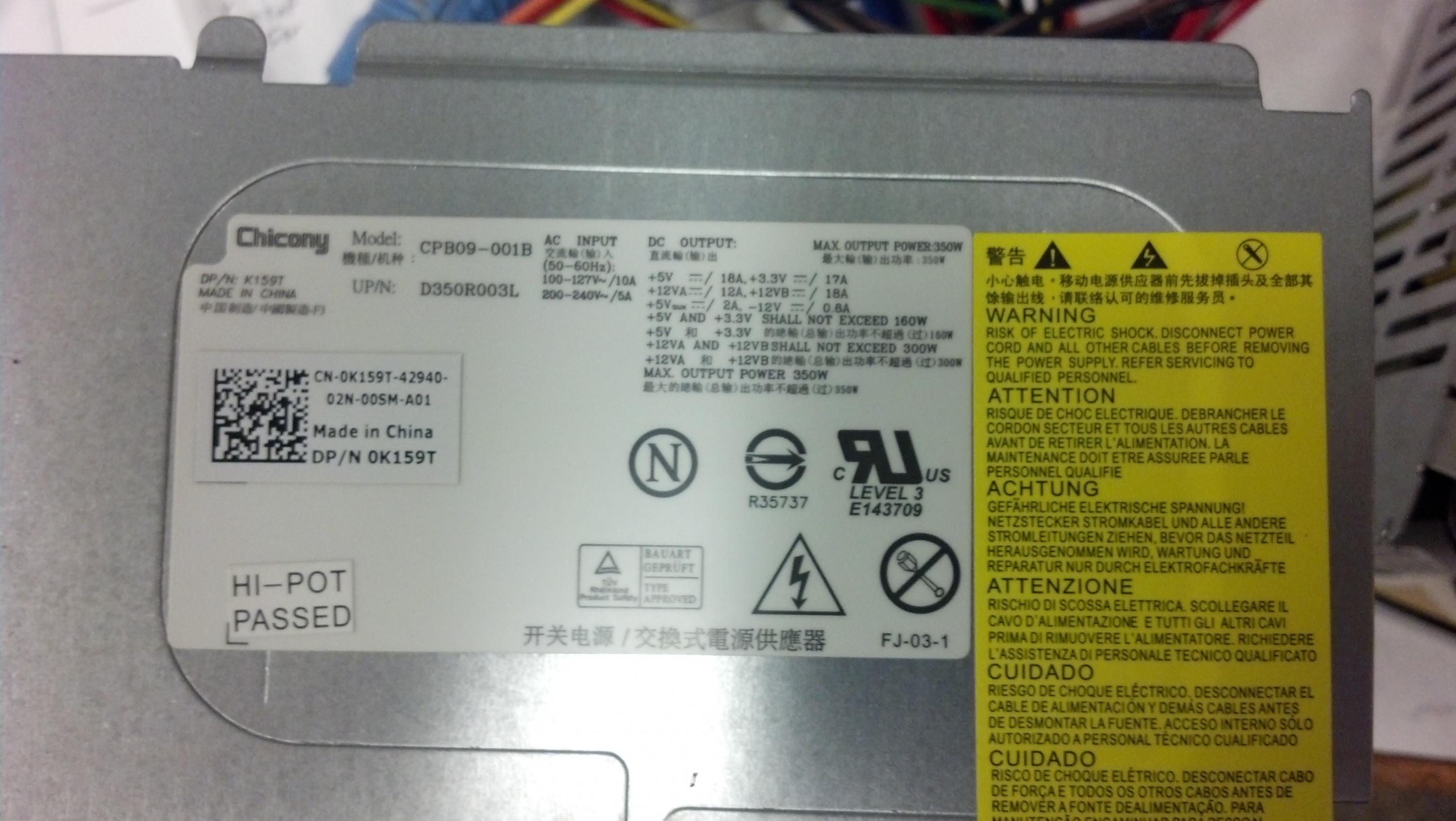

              Originally posted by Behemot
              Hipro's are good, not being build so heavily lately as used to, but still good more or less. Especially the ones for OEM's like Lenovo, HP, Dell. They usually hold even with those crappy brands, design does not put so much stress on them.
              Yeah it's a good PSU. It was only powering a Core 2 Duo and a GT 430, pretty light load...It has a 6 pin PCI-E connector which is another reason I want to recap it.

                Originally posted by Pentium4
                Re branded Hipro, never seen that name before.
                Chicony now owns Hipro, so all new Hipro PSUs are branded Chicony.
                • Pentium4
                  CapXon Be Gone
                  • Sep 2011
                  • 3741
                  #1048
                  Oh okay makes sense. I think this one was manufactured in March, 2010

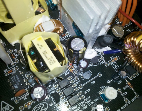

                    #1049

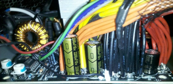

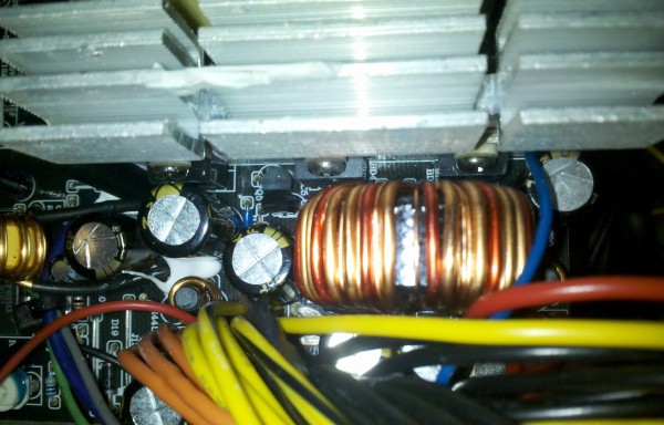

                    Just the other day I did a recap on a nearly new Antec VP450, containing mostly Capxon & Teapo crapacitors. Replaced with Rubycons from here.
                    One thing I may want .... I didn't replace any of the tiny caps I saw(50V 10uf, 25V 22uf, etc...), and from what I've read just a bit ago, it's a better idea to replace even these smaller ones since they are a junk brand and very prone to fail...?
                    This is intended on going in an AMD X6 build... moreso for light server usage, not gaming. Pics are of: craps removed, and 'current finished product'...

                      #1050
                      Well, if they are easily accessible, I would do it, especially arround heatsinks. Otherwise you can leave them. They are usually much less stressed the the bigger ones.
                        Did you use Samxon GC in a PSU re-cap? I'm not sure that's a good idea.

                                  #1056
                                  @mockingbird -- everything I pulled out was replaced with appropriately spec'd Rubycon's from badcaps.net... the particular line of Rubycon's I don't recall, and didn't think to check as I figure anything-Rubycon is better than teapo's or capxon's

                                    #1057
                                    The ones you used were MCZ. Those are too low ESR for PSUs. Badcaps.net don't carry very many caps which are suited to use in PSUs.
                                    They will probably work, but may make the ripple worse.

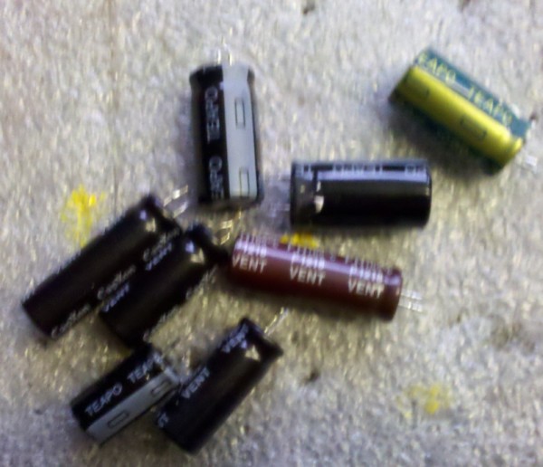

                                      As for Teapo and such, can you tell it ever had 4700 uF, even when coming brand new from factory? I guess not. On the other hand you know good caps have those 3300 uF (with some tolerance)
                                        Yeah the 4700uF 10V Teapo had the exact same dimensions as the 3300uF 10V Teapo

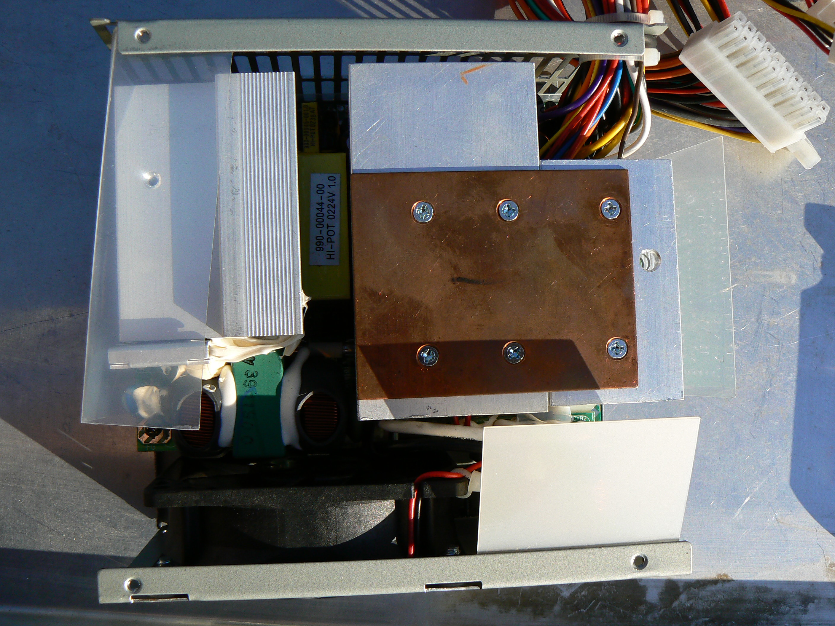

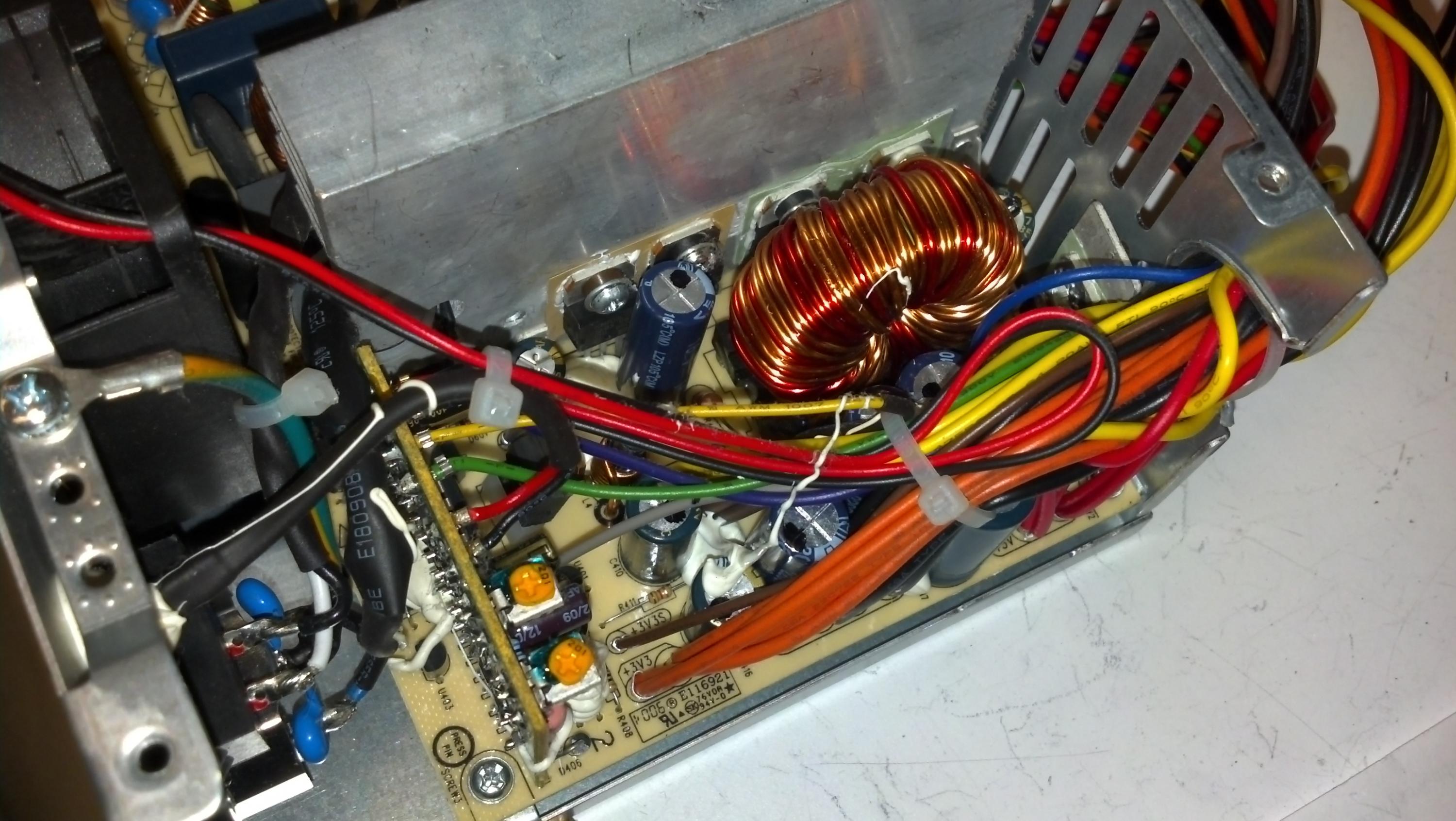

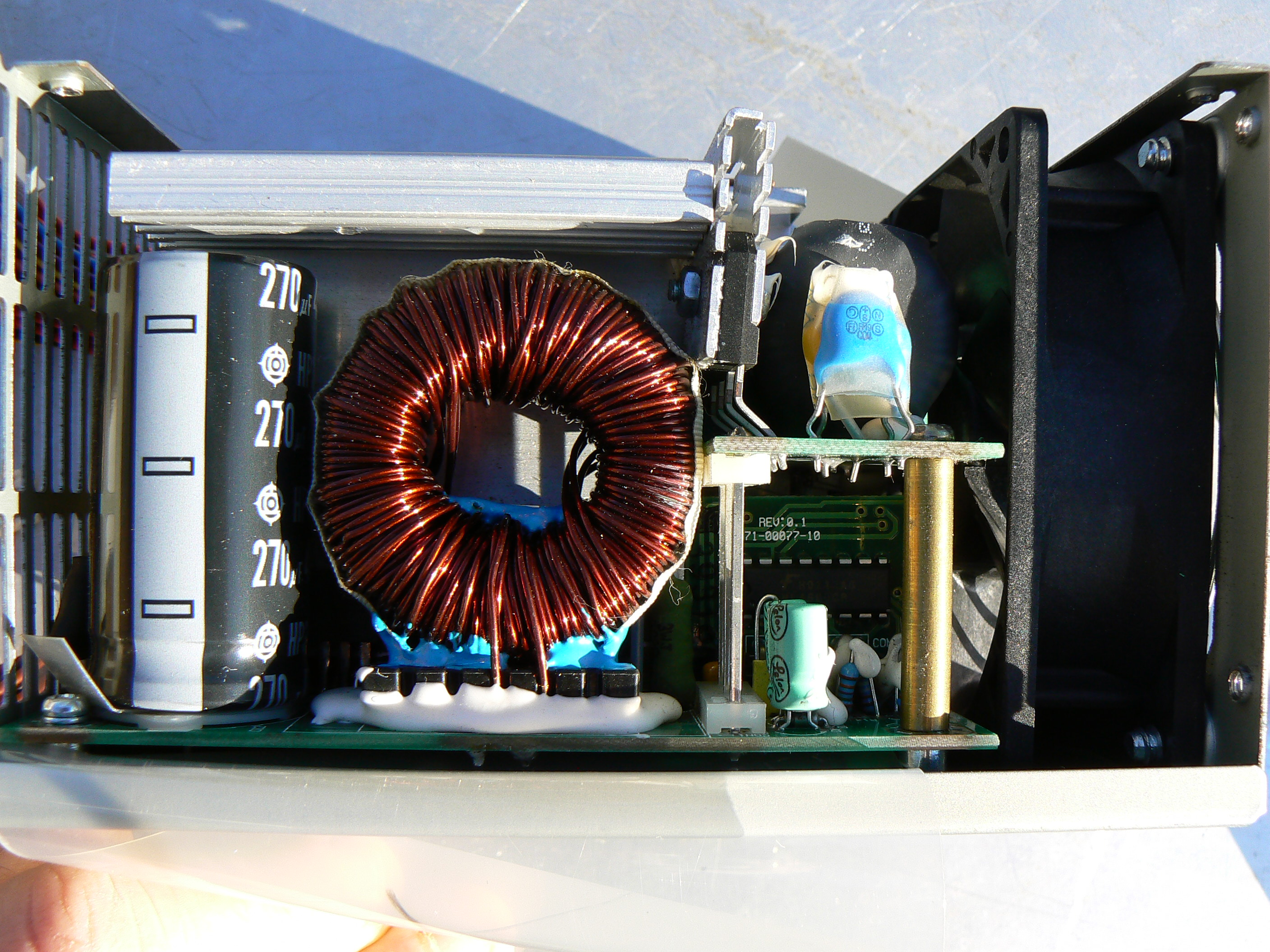

                                          #1060
                                          I wanted to share some pictures of power supply that came out of a PCI expansion box that was given too me. It is one of the heaviest and dense power supplies I have yet encountered. It also has three heatsinks compared to the standard two found in most supplies. It does not have the best brands of capacitors but I did not see any of them bulging and it had been running 24/7 for >7 years if not longer.
