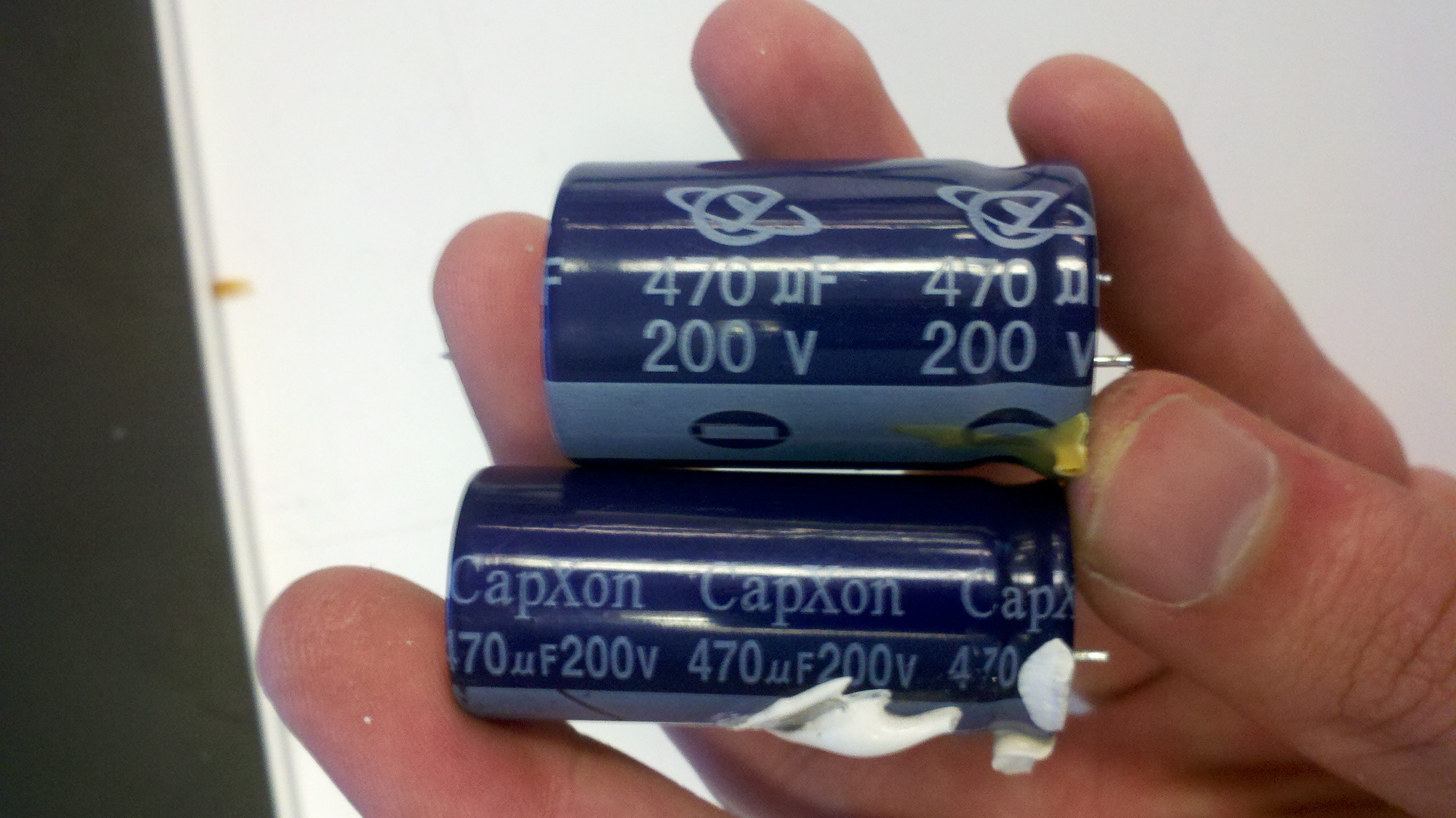

                        Ha, that's hilarious! This one was also a Bestec ATX-250 12Z and the one that just failed was a 1000uf 16V on the 12V rail. KF series

                          I was going to replace the primaries on the Bestec too, so I took off the CapXon intending to replace them with YC's that looked beefier, but the CapXon feels like it ways more than the YC. The YC is a little shorter but a lot wider. Which do you think would be better? It's just for a 250W PSU but I still want to use the better one. Unfortunately I don't have a capacitor meter
                          • Behemot
                            • 4845
                            • CZ
                            #893
                            YC for me
                            • Th3_uN1Qu3
                              Believe in
                              • Jul 2010
                              • 6031
                              • Romania
                              #894
                              YC for me too. They aren't great caps, but so far i've found them to be better than CapXon (any series) or Samxon GF. I'd say they're about on par with Teapo/G-Luxon.

                                      Edit: I found some 560uf 200V OST's, I'll just use those. The leads on the YC's after desoldering were too short anyways
