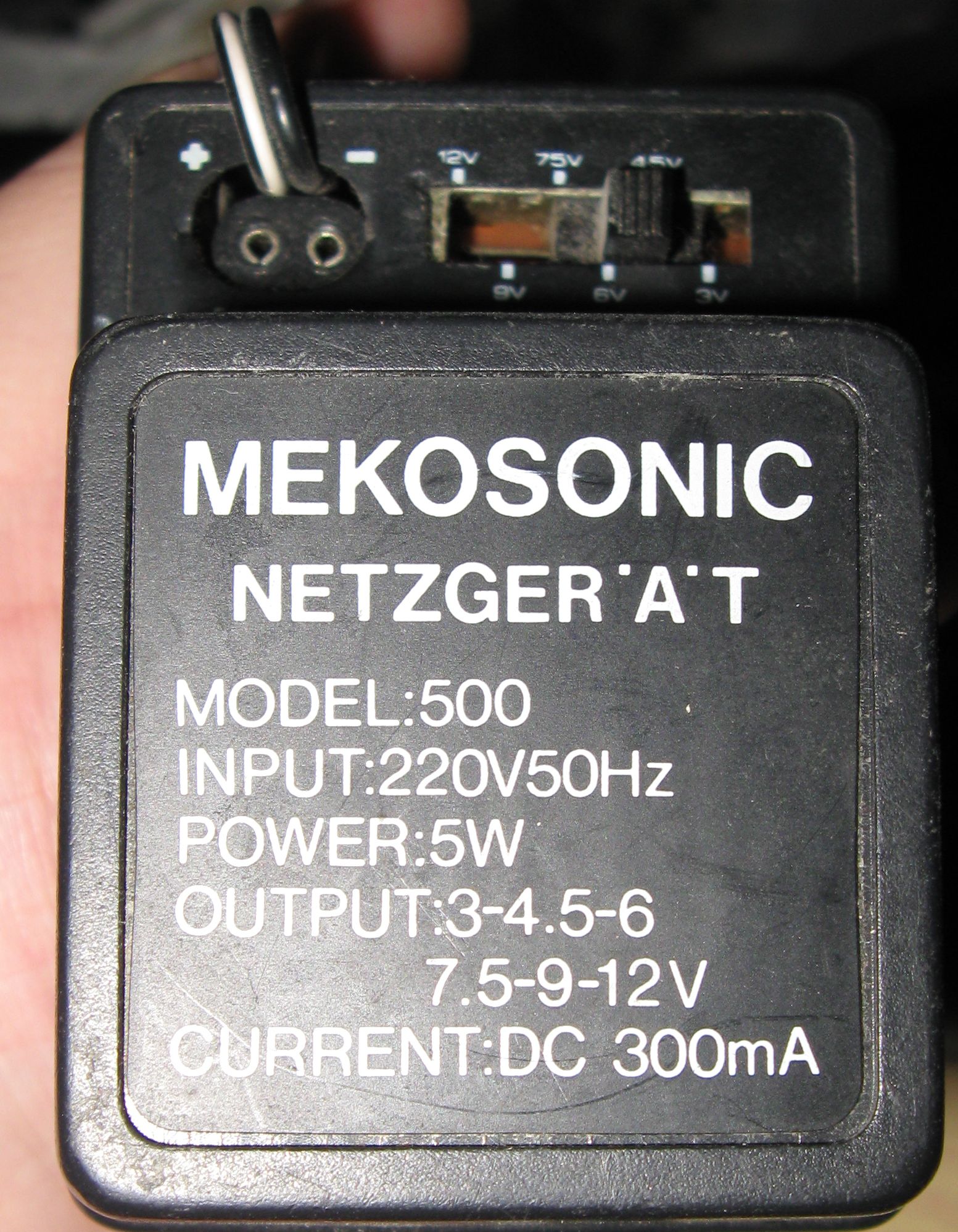

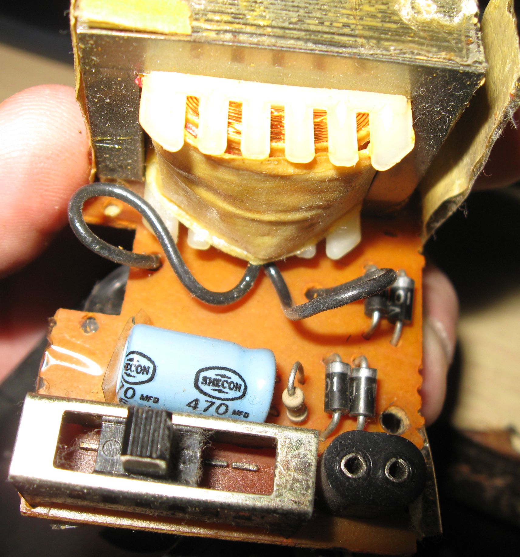

                                      For people that don't follow this thread, this is sort of in continuation of this post: https://www.badcaps.net/forum/showpo...&postcount=374
                                      I was doing some cleanup and found an AC/DC adapter I have fond memories of. This thing was used by my father around 1992-1994 to power an electronic calculator (the hand held kind) which still had the digits formed by pre-lcd elements, sort of like this one:
                                      I remember my father was always upset after finding it in my hands - I used to "borrow" it to power my tetris game because I didn't have money to buy batteries... later I used to borrow a nintendo gameboy from a richer boy at school and used this to power the game (damn, that nintendo gameboy used to eat 4 batteries in 20-30 minutes)
                                      Like any kid, managed to break the plug and cause some damage to the DC plug so you you can see in the pictures my soldering skills at about 13-14 years old, when I just started to learn about electronics and computers and started to get interested in this.
                                      The thing itself is well built for a 20 year old device... the only issue it has is that 6v and 7.5v selections no longer work... which is because the wires from the transformer are loose, no longer soldered to the PCB.
                                      Yeah, that's regular scotch tape that's insulating the 230v wires from the PCB ... i didn't know shit back then...

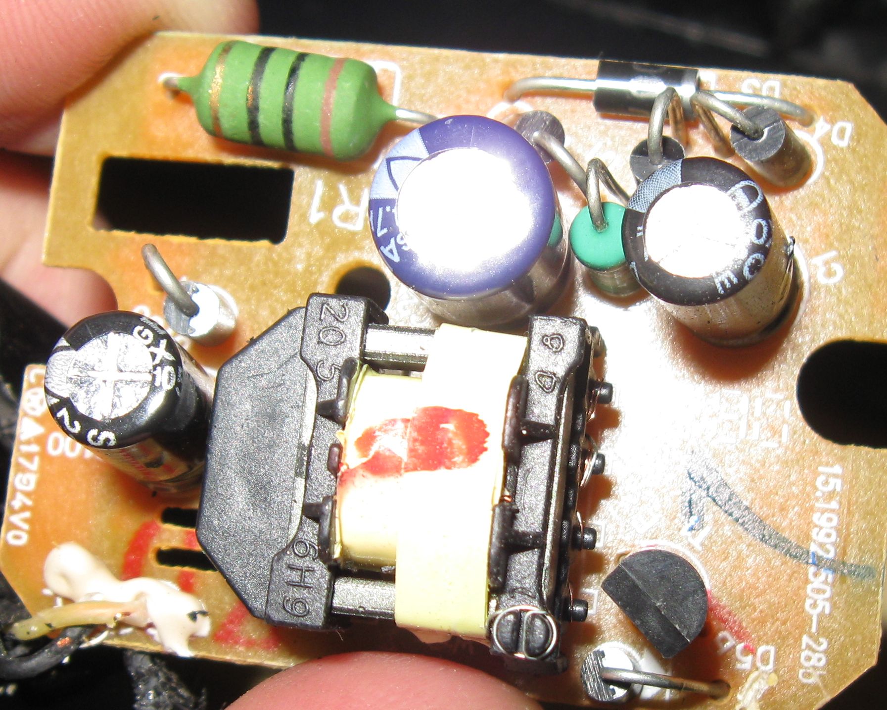

                                      While I'm at it, I figured I'd open a charger my brother left here and no longer uses it...
                                      The PCB is just shoved and there's a couple of blades making contact with the pcb, a resistor is used for a fuse... tsc 13002 npn transistor, some surface mounted resistors , samxon and JH caps..

                                        wow, heh, I think taking things apart is very addicting actually, cause you never know what you will find.
                                        LOL, a 'Shecon' brand cap.
                                        My soldering was bad like that too, but I practiced on old junk circuitboards, and I got very good at it
                                          Is that really a Nokia OEM charger? If so, shame on them.
                                          This single-transistor self oscillating design is crap. It should not be used in any electronic device, except for perhaps a classroom experiment.
