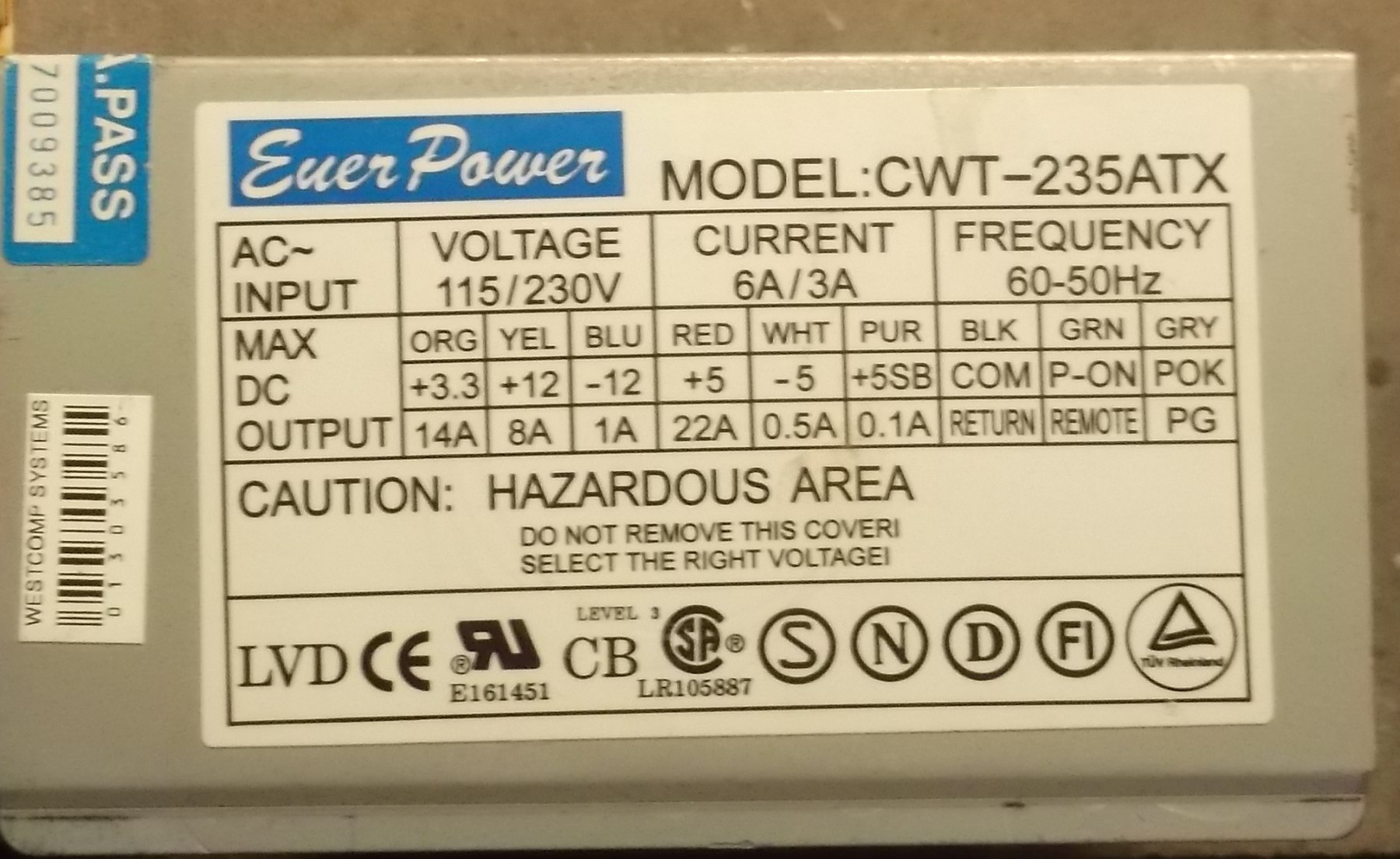

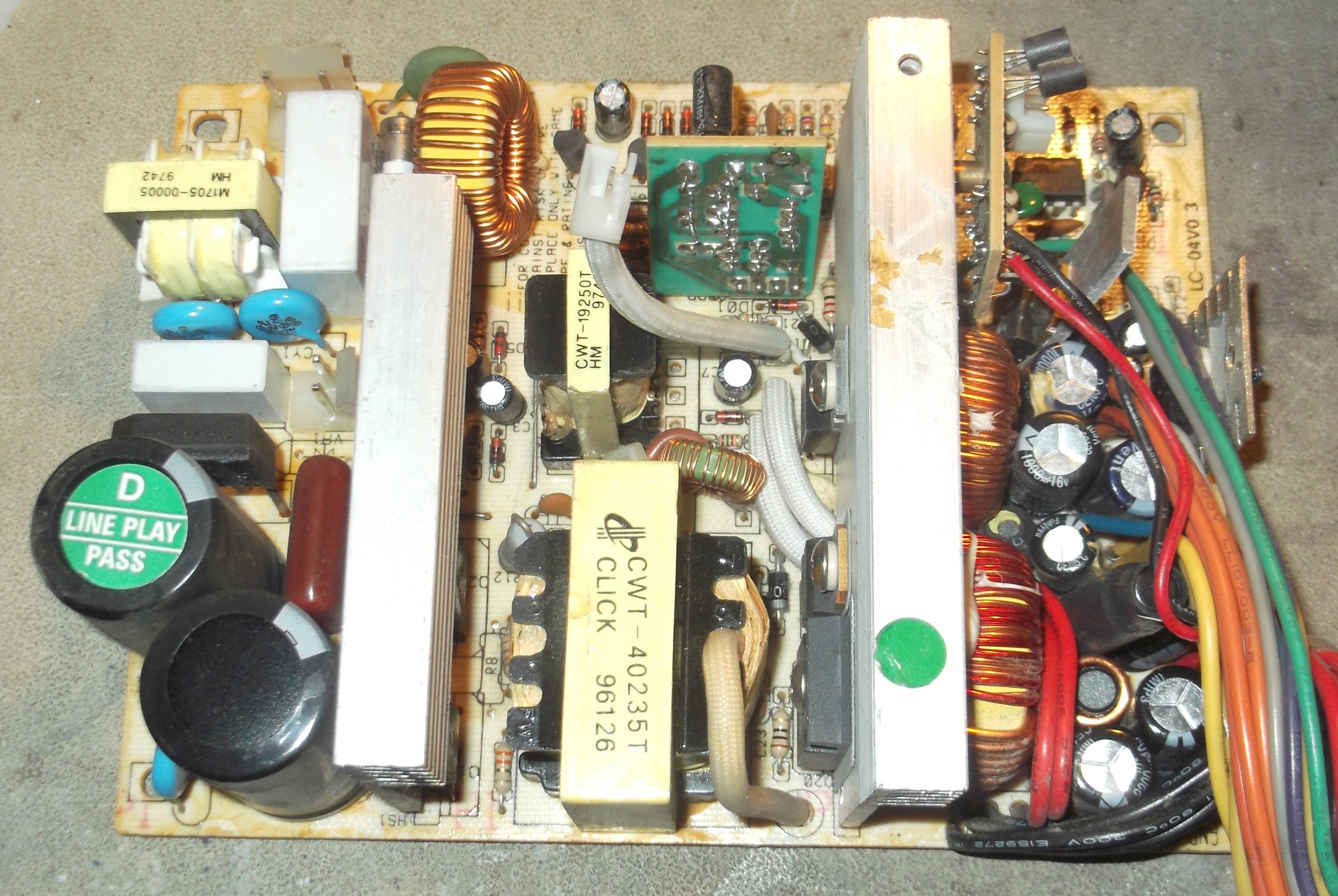

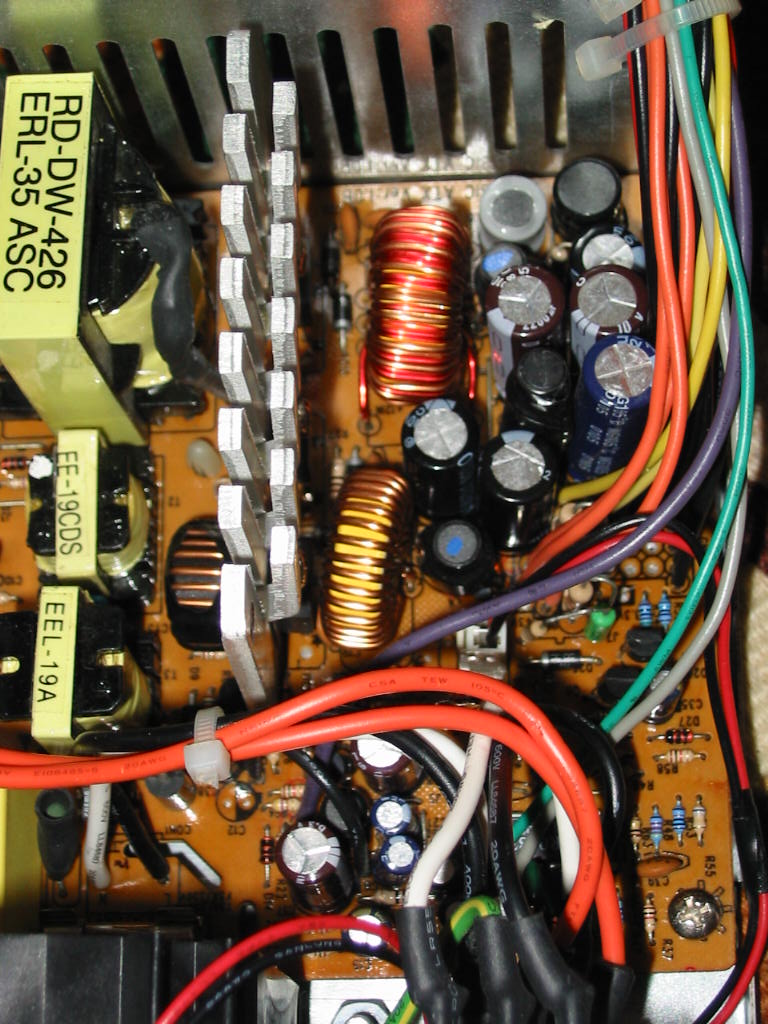

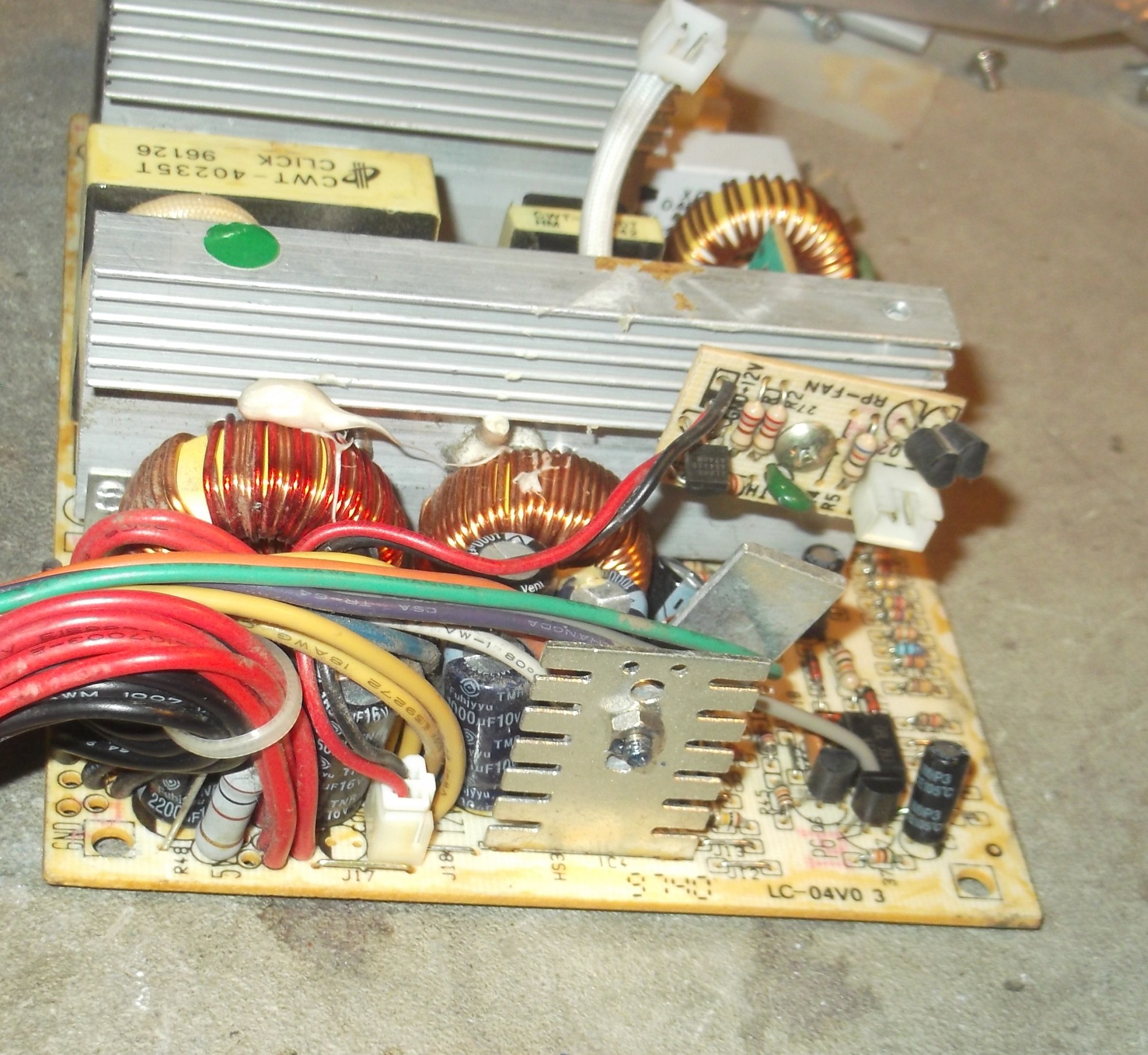

        A saved an old ATX power supply from recycling last week.
        The casing is damaged, has dents, a broken fan but the insides are intact.
        EverPower brand with a 235W Channel Well Tech guts from 1997.
        There is a seperate transformer attached to the casing that looked like passive PFC at first but it isn't. The 5V standby has 100mA current capability and it is generated using this trafo, rectifier and a 7905 regulator. I haven't seen this "cheap" method before.
        The standby trafo has primary winding taped for both 110V and 230V.
        The unit has ok EMI filtering, 4 Amp bridge rectifier, 330uF Matsushita input capacitors.
        It's a half bridge topology with two 13007 BJTs controlled by KA7500 pwm.
        A 339 comparator is used to supervise the output voltages. There is also a seperate fan controller circuit.
        https://www.badcaps.net/forum/attach...5&d=1637581493
        The 3.3V rail is also unusual. No mag amp circuit.
        A UTC34063 is set up in step down configuration to make the 3.3V work.
        Secondary electrolitic capacitors are all Fuhjyuus so that's bad.
        I've cleaned and tested the psu. Turns on, voltages are a bit low-ish and fluctuating, ripple is probaly high also. Kind of unusual early ATX unit.

            #3145
            The current rating for the +5SB is just .1A, some the effect on efficiency is minimal. A 50/60 Hz transformer, recifiers, and 7805 3T regulator might have been cheaper than a flyback switching regulator circuit. .1A was pretty minimal for that era. I would expect 1.0-1.5A.
            A TL494 clone and MJE13007 clone BJTs would easily have been adequate for the ATX spec of that era and the 235W rating; the heatsinks were OK, if not spectacular heavy metal. Looks like the PCB was laid out to allow higher power switch transistors and output transformer. The 330uF input caps might have been marginal for hold-up time. The fluctuating output voltages and high ripple could be due to the 24 year old output caps having increased in impedance. Replacing the F-yus with Nichicon PJ or PW or NCC LXV or LXZ series caps (which were in common use in the late 1990s) might result in better performance.

              #3146
              Earliest ATX 1.0 spec indeed only specced only 100mA so I suspect they may have built to spec though whether or not they exceeded or not is another question. My question is why is it using an overspecced and odd 7905 negative rail regulator when a cheaper 78L05 or 78M05 would do? Incidentally I'd not call this "cheap" but rather "old, inefficient" ... those transformers are not cheap to source or ship in volume...

                #3147
                Sorry, 7905 was a typo. It is a L7805C positive voltage regulator. It is visable on the pictures. The ic has that simple piece of metal screwed on for heatsinking. The pcb silkscreening suggests a TO-92 device instead of TO220 that is crammed in there.

                        #3151
                        WOW!
                        This must have been one of their earliest ATX-compliant designs.
                        I mean, it has a regular transformer for the 5VSB instead of a switching circuit - that just says A LOT about this PSU's age.
                        And yet even this early design seems to have OPP (over-power protection) on the primary side, as is evident by that small toroid between the main transformer and the BJT driver transformer.
                        Interesting.
                        But I only see one MOSFET and no free-wheeling diode(s)... though it is a bit hard to see. So perhaps this is done in a linear fashion. Kind of strange why there would be a separate toroid for the 3.3V rail then. Seems the 3.3V rail is generated by the rectified and filtered 5V rail output (two two red wires going from in front of the main output toroid, under the heatsink, and out in front of the 3.3V rail's MOSFET.)
                        CWT probably figured at some point that the TO-92 regulator would not do too well. If the 5VSB transformer is outputting 9-10V (or possibly even higher when unloaded), then at 100 mA of power draw, the dissipation of the regulator would be P_d = (9 - 5) x 0.1 = 0.4 Watts. For a small TO-92 device, that's probably pushing it really close to the max allowable P_d (at least as far as internal junction temperature of the silicone is concerned.)
                        Cool!
                        Yeah, this is definitely worth saving, even if just as a "museum" piece if nothing else. Though I suspect some new caps (that PeteS suggested) would certainly bring it back to a fully serviceable ATX PSU.
