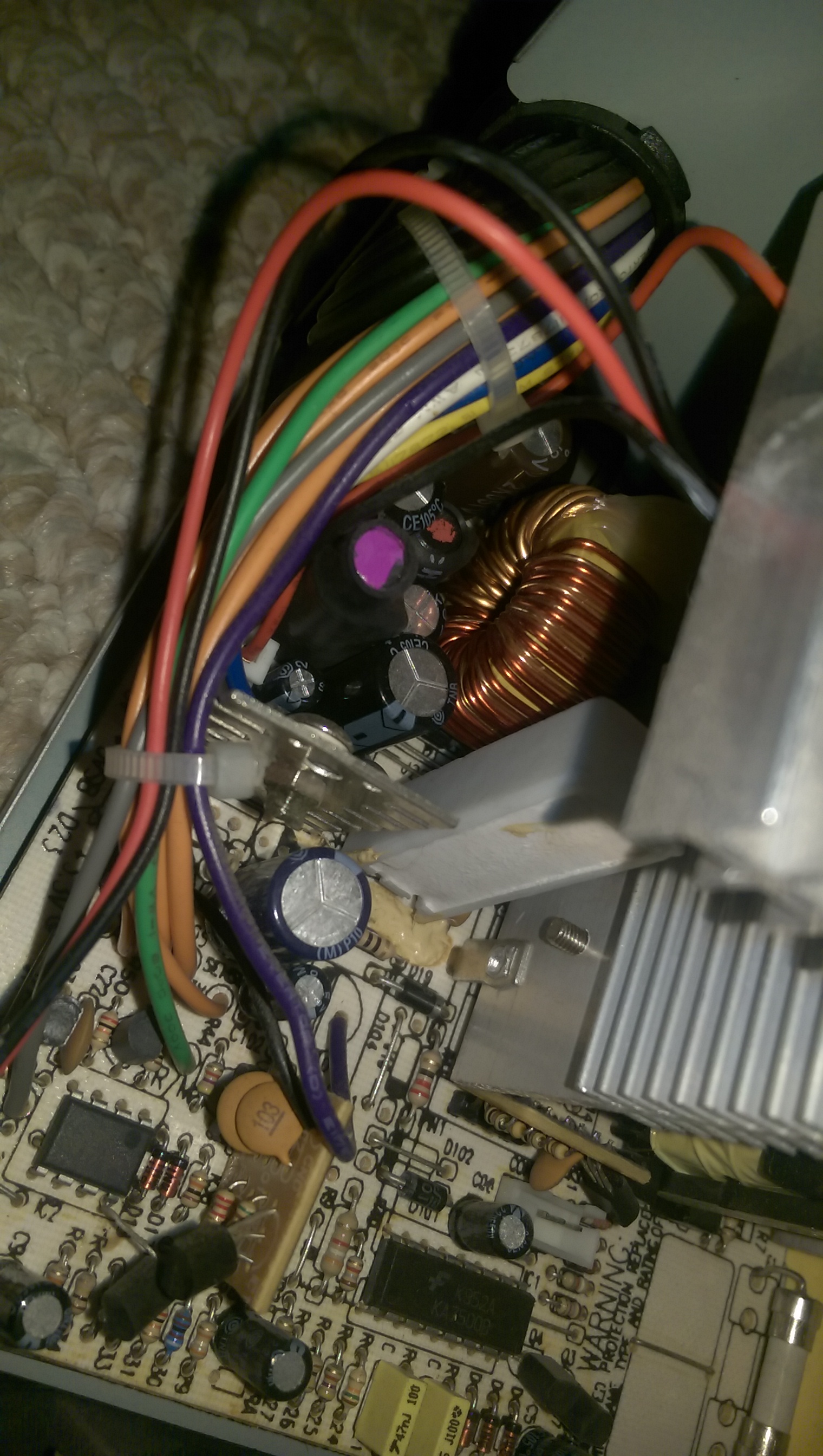

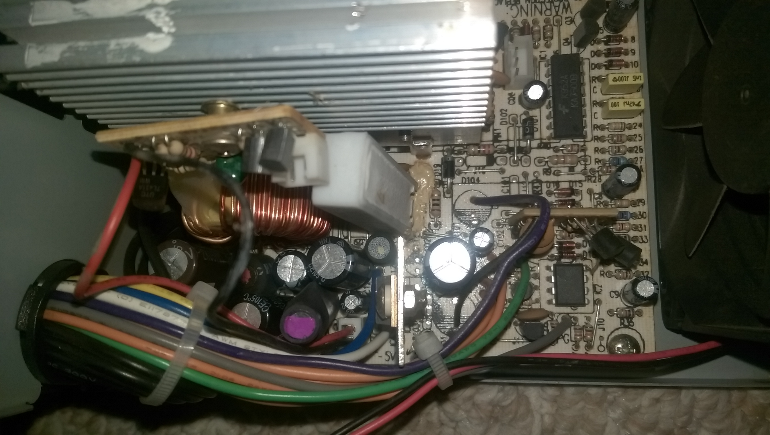

        Nah I probably wont do anything with it.
        IMO the unit feels a bit too cheap, for example on the label it says 115v > 240v input.
        But then on the back is a sticker that says "230v ONLY".
        Which is usually the case when the manufacturer has removed the APFC booster circuit.
        Which oddly does look intact so I dunno what to think.
        But again the feeling "cheap" comes to mind if they don't even know what the unit is capable of...
          Aww, that's a shame. It's still an independent regulation unit. Even if it's 400-500 Watts and not 750, that's still plenty for a modern CPU with an upper middle-end video card. Don't trash it!

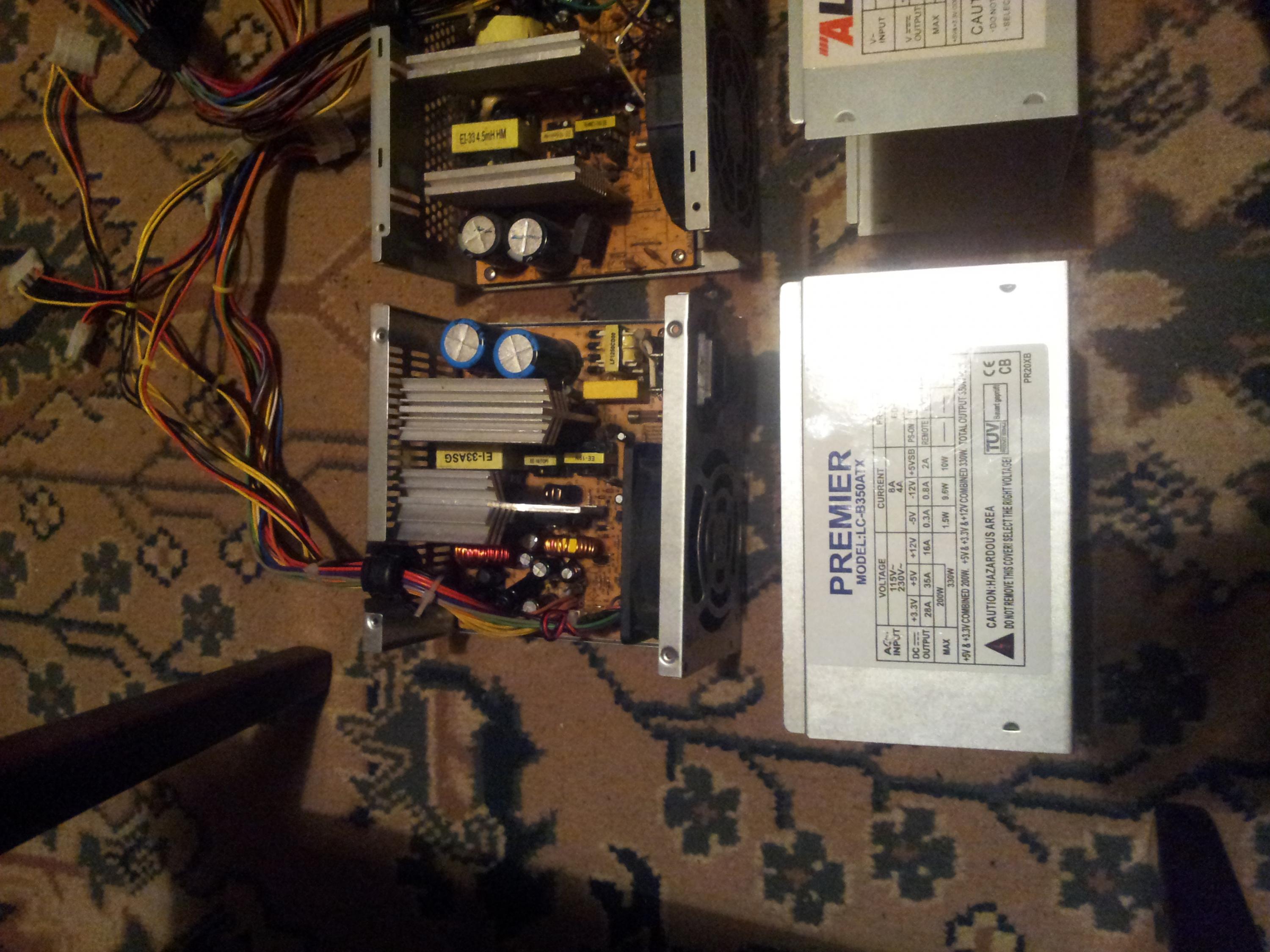

                    Some pictures of a few PSUs I have. I included the covers,though the ALine isn't what it says on the tin. (hint - it's a Yuelin)
                      Wrong thread?
                      Apart from the Premier LC-B350ATX, all the others seems very gutless. Looking at their output filters, even 200 Watts would be pushing it.

                        Originally posted by momaka
                        Wrong thread?
                        All were case pulls I think (not sure about the ALine and the LC-B350ATX,but the other Premier PSUs I pulled myself from three systems I had to work with).
                        The 350W Premier is actually rebuilt by me,though I haven't replaced the primary switching transistors - they're some weird Sanyo part that,upon searching on Google,comes up in TO-251 package,but not TO-220. Apart from that,I completed the input filtering,and rebuilt the secondary side - from adding PI coils and a proper 3.3v toroid to filling up the capacitor spots and replacing all the rectifiers for the secondary. Also I replaced the Globe fan with a Jamicon (which strangely came from another Deer) and added a fan header.

                          Concur with momaka. The first one also has wimpy heatsinks. The second and third (order of pictures) have heatsinks that would probably be OK up to 250W if you upgraded the O/P filtering (and maybe rectifiers).
                          Re the LC-B350ATX, the TO-251 is a through-hole version of the SMT DPAK, which is smaller than the TO-220-equivalent D2PAK. So that Sanyo part probably puts the safe limit for that PSU in the 200W continuous range. If it's a bipolar transistor, an MJE13009 or clone should get you into the 300-350W range.

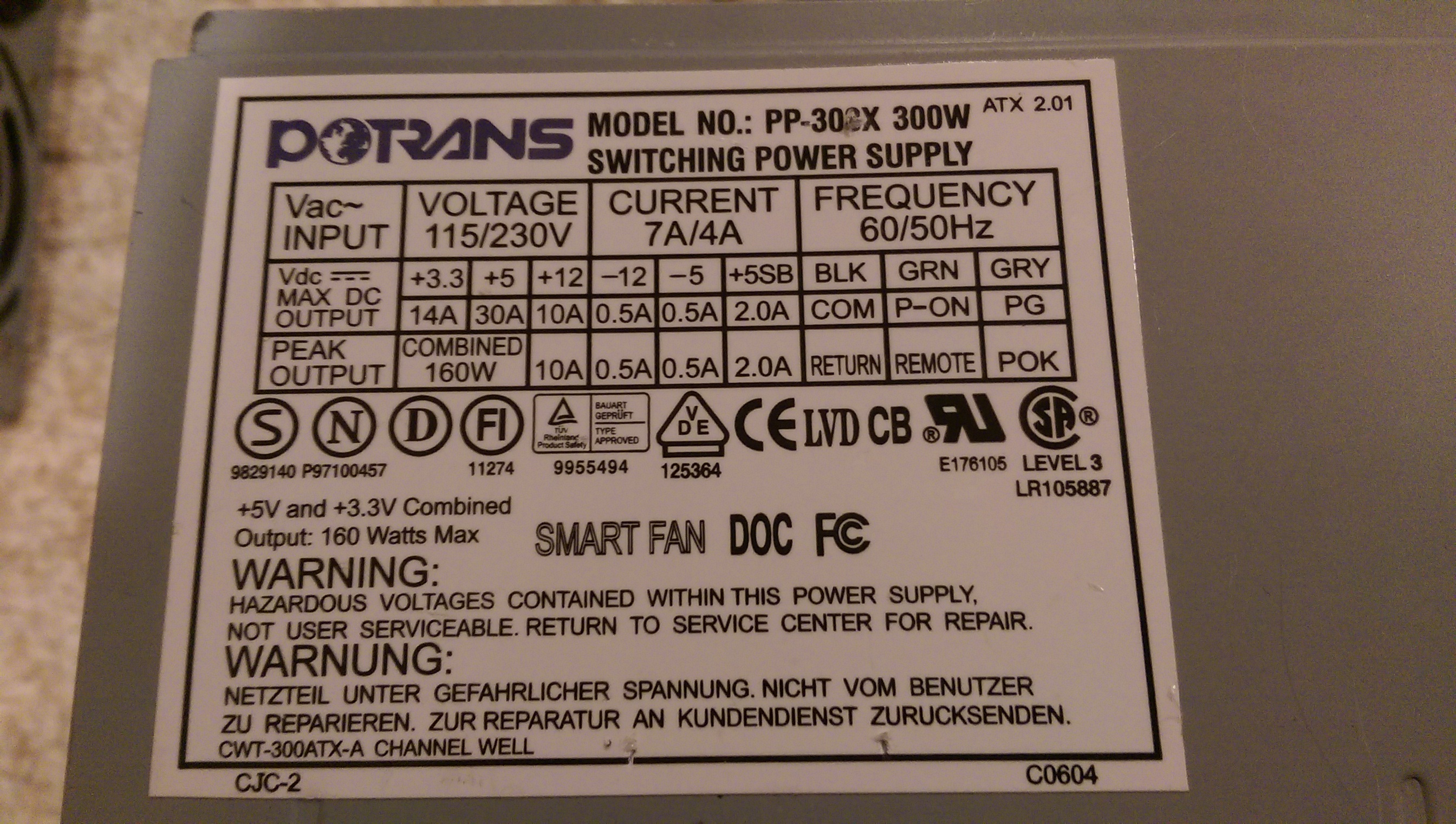

                                          Potrans pp-300x
                                          Posting to add to this mega thread.
                                          PSU thread: https://www.badcaps.net/forum/showthread.php?t=59061
