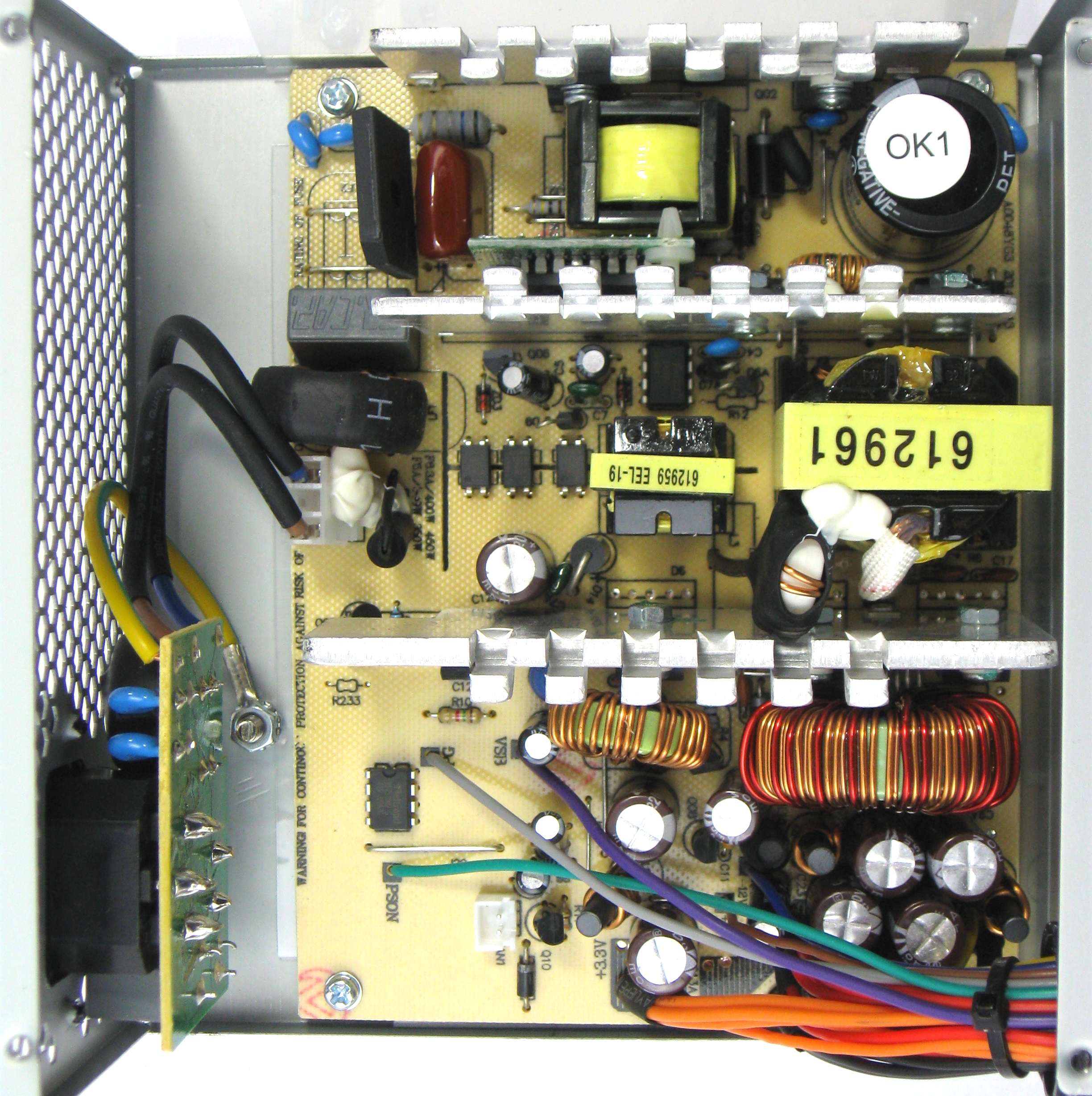

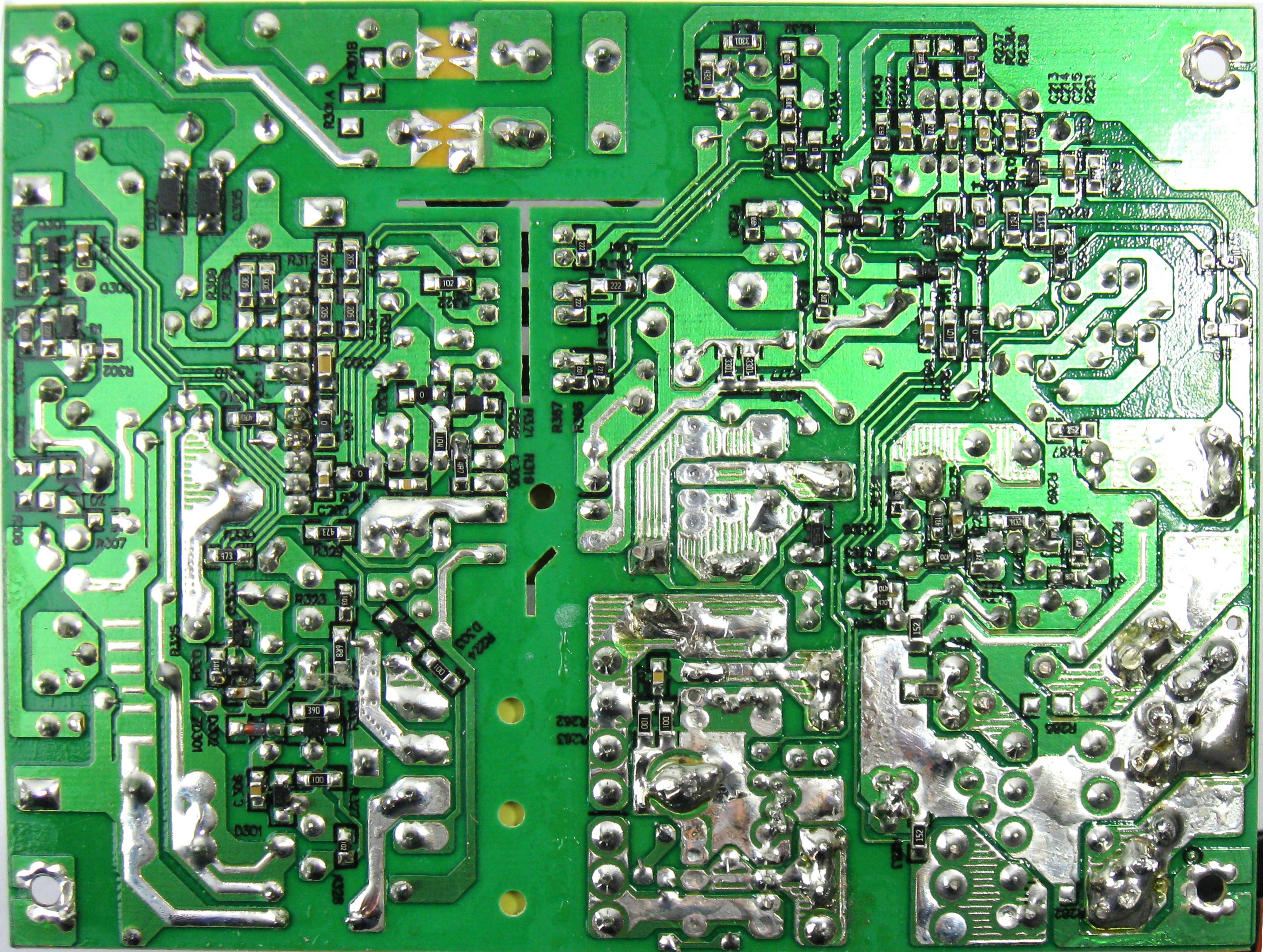

              Okay,here's one I've been having in a PC I built.
              Worth anything? It's powering a Athlon 64 3000+ on a VIA K8M800-based board (Biostar K8VGA-M).
              The pic may not look so good because it's resized - originally had a resolution of 6408x7128.
              TELVM - calculate the total capacitance of the three 220uF Elites you have now,and try finding a combination of Panasonic EEs that would give the same total capacitance.
                      Eh... it's not that terrible of a unit.
                      Heatsinks actually look okay for a 200-250 Watt half-bridge PSU. But the caps on the output look small and I don't see PI coils for any of the main rails. So you're probably looking at 150 Watts max before ripple starts getting nasty. Also, no input filtering just screams "I am cheap". 5 VSB is probably standard 2-transistor oscillator (but on the positive side, I don't see a critical cap).
                      Can't say more than that without any part numbers, though. In particular, what you have for the 12V rail rectifier and the primary BJTs will tell you what this PSU is capable of. It is *probably* okay for the PC you are using it on, as long as the 12V rectifier is rated for at least 10A.
                      Go to a TV repair shop and ask them if they have any junk TV boards they would like to get rid of for free/cheap. In particular, look for ones that have an input filter (i.e. X/Y caps and common mode chokes). As for the PI coils, just find some thick solid copper wire (similar in thickness to what is on the output toroid) and wind about 10-20 turns on a 3-5 mm object. Then remove the object and put the winding in place of the jumpers. Even a cheap air-core inductor is better than nothing at all.
                          I don't think a low end A64 2800+ can eat that much. I also tested it with my Pentium Dual Core machine (GB P35-DS3,3GB RAM and a GT210) and it didn't even warm up.
                          20A 45V for 3.3 and 5v,16A 200V for 12v. Pretty much enough I'd say.
                          Fan side isn't that brilliant - just your average "RDM8025S" but it's built by KissQuiet. In fact,they're actually the OEM behind this PSU - just that Delux requested to print the "DELUX-AY" text.
                          Wouldn't trust it powering a A7V8X-X board I have. I tried that once - the ATX connector was insanely hot!(not to the point of melting tho) Guess my beefy Deer could do that though - 30A on 3.3 and 5V,and 20A 60V for 12v.
                          I have been hesitating to do the PI coil side,but I'll dig through my stuff and see what I have. I still remember having a dead Delta and a dead Linkworld.
                          I know I should deserve a hard smack against a wall for this but I'm not going to do the input filtering. I actually don't have any hardware that emits static while using this. Absolutely nothing at all. Actually,EMI interference over
                          I still don't know what to do about the fuse - it's absolutely tiny.
                          Also,an picture of a KissQuiet unit. I'm still unsure if Sun Pro actually OEMs their PSU or they build themselves,but I'd go for the latter,as Sun Pro wouldn't be that dumb to use such a small fuse. Leadman/Powmax is out of the question for me,as any of their designs are bad (except the 6100 platform maybe),complete with PI coils and stuff or not.

                            Originally posted by Chungalin
                            But the unforgivable missing component is R2, the bleeder resistor for C2, the second filter capacitor (330uF/200V). Just R1 is present (150KΩ, very low wattage). C2 bloats after months of use due to asymmetric voltage distribution.
                            Wow, sounds like a late Friday night shift's job .
                            Yes, both of those systems probably use no more than 100-150 Watts DC max.
                            But just because the PSU doesn't run warm doesn't mean it is doing well. The BJT base drive resistors can blown in cheap half-bridge PSUs without much warning if they weren't sized right (which is quite common). Also, the ripple can be terrible, and again the PSU won't run warm. But your components, on the other hand, won't like it too much.
                            Yes, good enough for a half-bridge PSU powering a basic 12V-based PC.
                            Oxidized pins on the motherboard ATX connector or PSU ATX plug. Or too much ripple on the 5V line. And yes, you don't want to power a 5V-based motherboard with a PSU that has only a 20 Amp rectifier - nothing newer than a Pentium 3, anyways.
                            Why? PI coils are super easy to add and they really do help with ripple.
                            But your neighbors might . Not to mention your PSU really is killing AM radio communications. I hope there are no ham radio operators/enthusiasts near you either.
                            Uhm... it works... so leave it?
                            It's all about cost. If it's cheaper to use a smaller fuse in their crappy low-end PSU, and they think they will get away with it... then they will use it. That goes for any company, really.
                            If you've seen the Sun Pro KY-480ATX guts, you will believe that Sun Pro are capable of doing anything.

                                    @Dan81 the kissquiet power supply that you posted not only is crap but it even has a fake pfc transformer you will find that once you remove the yellow tape from the pfc tranformer i know that because i owned one that eventually blowed up
                                    That's the original KissQuiet unit. Mine doesn't have any PFC.
                                    Also,that one got really anorexic heatsinks. I only know Leadman of having such heatsinks. At least mine would actually do good stuff if recapped and PI coils added. Again,I don't care about the filtering part mostly because there are no radio enthusiasts or old radios for that matter. People in here are just old people who watch TV. The only radio I have in my house doesn't pick up any interference from the computer.
                                        Nope, Sun Pro does too. Here:
                                          Had one like that (at least the primary side looked the same).
                                          Anyhow,those heatsinks are copied from Codegen. I actually had a "350W" Codegen (that was actually decent bar the crap caps) with the same heatsinks except they didn't have the holes in them.
                                          Also,you were lucky to get it with PI coil spaces! My Sumvision KY-450ATX didn't even have the places for PI coils.
