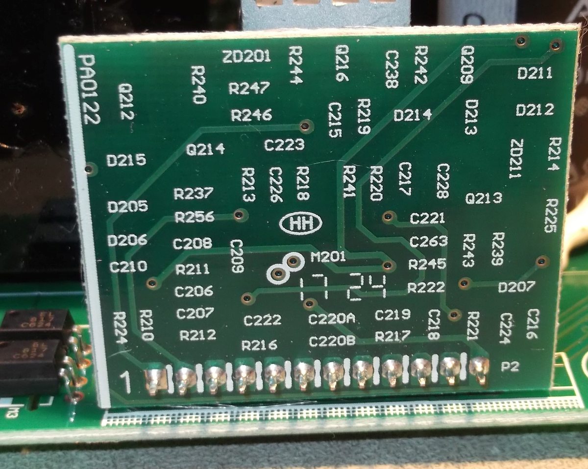

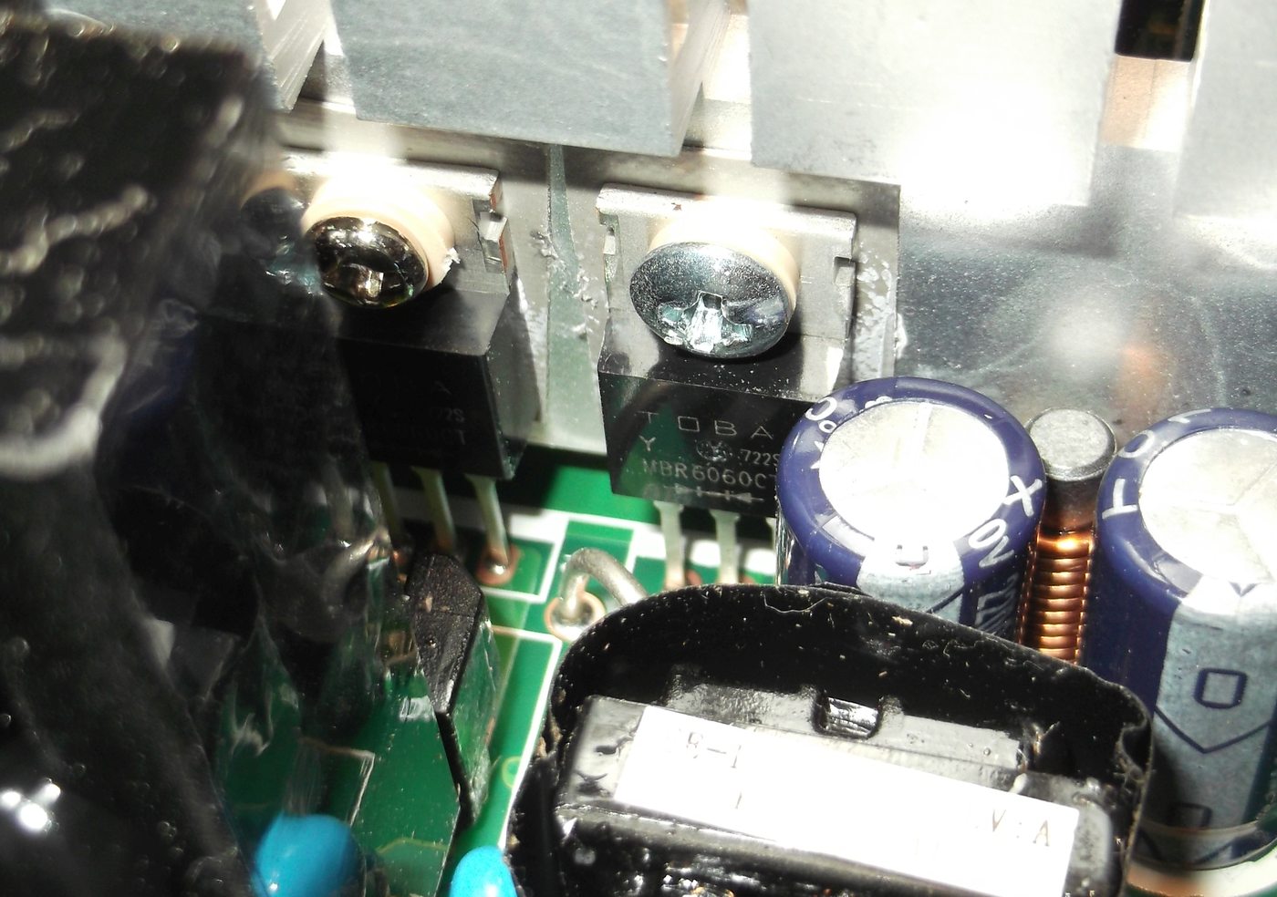

            #2785

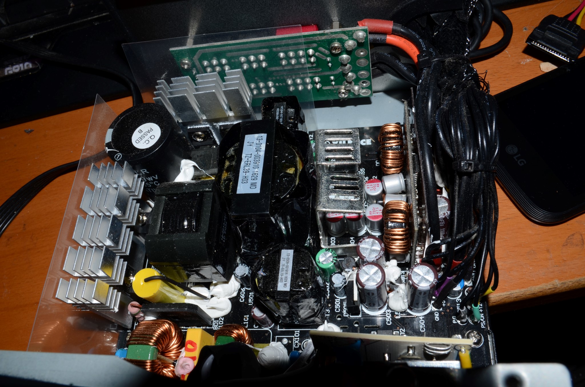

            PC POWER Phantom RAIDERS MP1800X..
            This is fully modular pure chineseum "mining" psu. A colegue decided to use one of these. "How bad can it be.. sitting in the basement 24/24 with four R9 295X2".
            For a few weeks it worked. And then it stopped working.
            There is standby, but unit doesn't turn on.
            I did some autopsy. It turns out two of the 12V double diodes were shorted.
            EMI filtering is ok.
            16A glass-body fuse without any shielding right on the AC connector PCB.
            Genuine CAP200DG discharge ic
            2xGBU1006 bridge rectifier (Diodes Incorporated), no heatsink.
            Primary:
            Forward topology.
            PFC switchers: 2x GP47S60X (Hong Guan).
            2x PFCD86G knockoff diode.
            Big coil.
            Primary switcher: Single GP47S60X.
            2x Asia'x LPX 330uF 420V primary capacitors.
            Genuine CM6800G pwm/pfc controller.

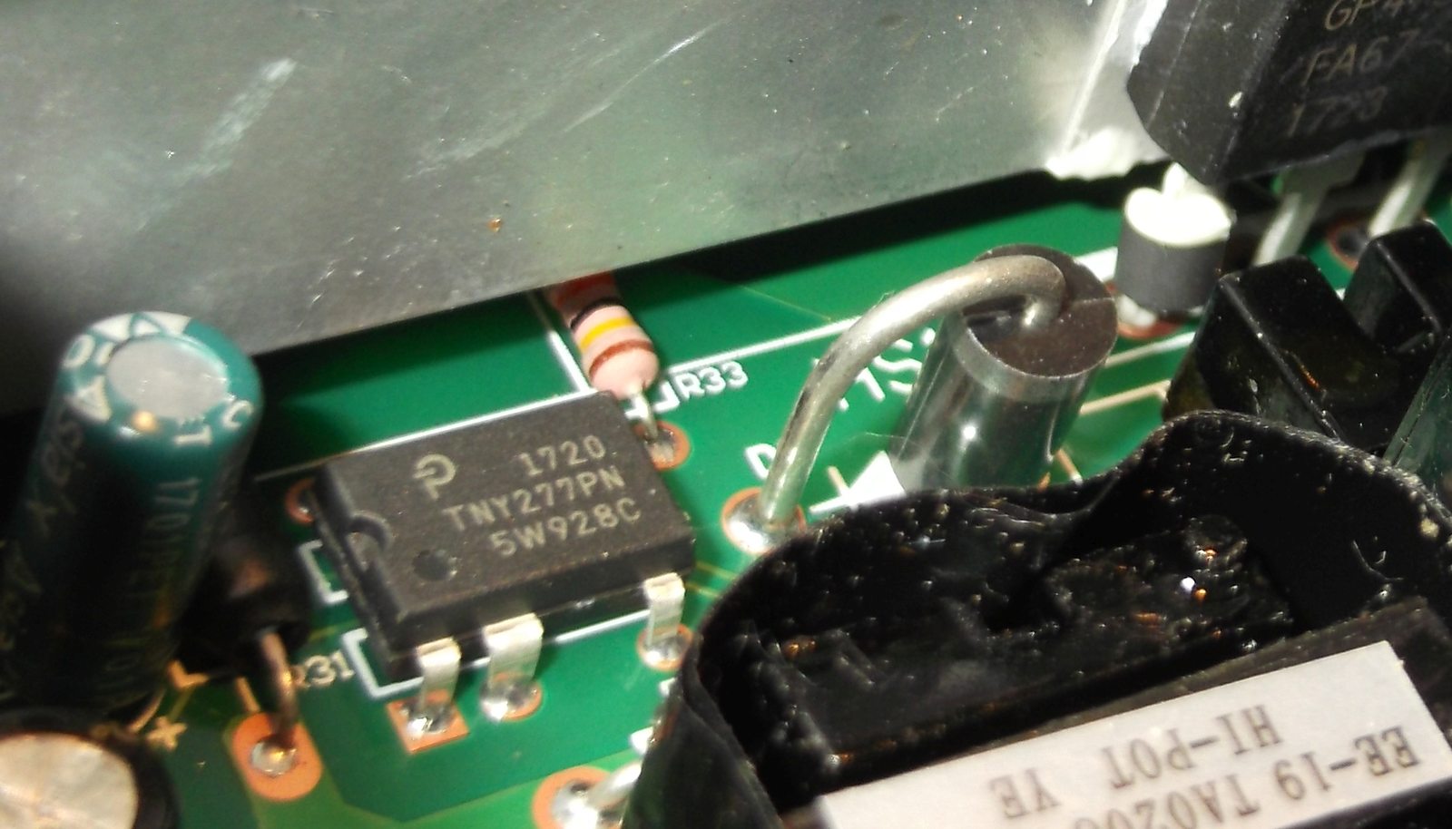

            Standby:
            TNY277PN knockoff power ic.
            EE-19 trafo.
            SB360 diode.
            Output Pi-filter: 2x Asia'x TMX 2200uF 10V capacitors, radial inductor.
            ETD44 main transformer.
            Secondary:
            12V rail: 7x MBR6060CT (TOBA), big current regulator coil, 6x Asia'x TMX 2200uF 16V electrolitic capacitors.
            5V rail: DC-DC; 4x SG40N01D, unknown controller ic, 3x uknown brand 470uF 16V polimer capacitor, Asia'x 1500uF TMX 10V electrolitic capacitor.
            3.3V railC-DC; 4x SG40N01D, unknown controler ic, 3x uknown brand 470uF 16V polimer capacitor, Asia'x TMX 1500uF 10Velectrolitic capacitor.
            -12V rail: extra winding on 5V regulator coil, SB240 diode, Asia'x TMX 1000uF 16V capacitor.
            EST.7627 secondary supervisor.
            Temperature controlled fan: LM311, some passives, smd NTC on pcb.
            Some 14mm sleeve bearing fan.
            Cables are ribbon type, 18awg thick, connectors from WYM manufacturer.

              #2786
              Looks like the date code is week 7 of 2017.
              A 1600W power supply forward converter? I could be wrong, but that sounds quite high for that topology.
              60 volt rectifiers for the 12V outputs? The sounds a bit risky. I wonder if they were chosen to boost the efficiency a bit.
              A 3 amp rectifier for the 2.5 amp 5Vsb output? That seems a bit weak. A 4 or 5 amp device would be more robust.
              I know it supposedly is "Gold" rated, but unless the fan is blowing very strongly right on those heatsinks, they seem a bit less beefy than they should be.
              A 16 amp fuse, glass body and not sleeved? If it blows it will probably spray glass shards throughout the power supply.
              I'm pretty sure Asia'x electrolytics are not a respected brand here on Bad Caps.
              PeteS in CA

                #2787
                In reality that will be like 1300 W continuous.
                Also there is no such platform on Ecovas website so the certification is most likely fake.

                    #2789
                    For an unknown manufacturer, it's actually quite decent...
                    Unfortunately, that "porn star" caps ruin it...
                    But 12v rail diodes shorted?
                    For that much capacity available which is almost 300a for 12v rail, why is it failed?
                    Is it blow or not..?

                      #2790
                      Nah, you are absolutely right - it is too high for a STF.
                      Most likely there are two GP47S60X MOSFETs for the main PS (likely double-forward design), and the single GP47S60X is for the PFC.

                        #2791
                        Primary:
                        To be honest, that unit looks quite OKish.
                        Capacitor choice seems somewhat OKish, but cheaply...
                        Soldering is also quite good for the most part but the handsoldered part looks a bit sloppy...
                        Capacitance on +12V seems more than reasonable too.
                        BUT: Never ever it is a 1600 or 1800W PSU. Its more in the ballpark of 700-800W. I'd go by the primary capacitance. The two 330uF/420WV caps ->660uF combined support my suspision.
                        But why the hell would you use it with FOUR 500W Graphics card that cost at least 500 bucks or so on eBay?
                        Makes no sense to save that much on the PSU.
                        But on the other hand a decent quality 1500W PSU or so cost about the same as one Graphics card.
                        Either way that looks nothing like a real 1500W would. Give it half in decent performance, 1000W in really shittty, if at all...
                        In the End it would have been a somewhat decent PSU if labeled correctly.

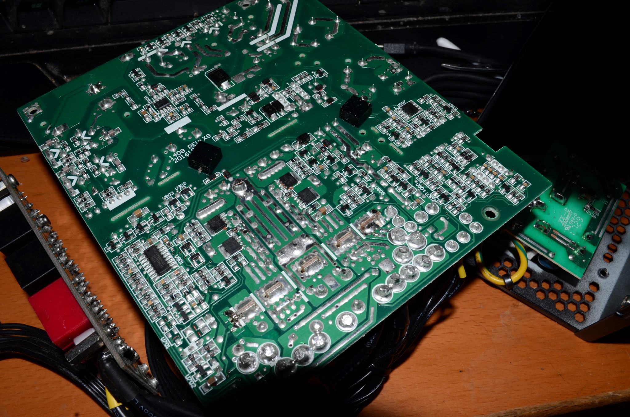

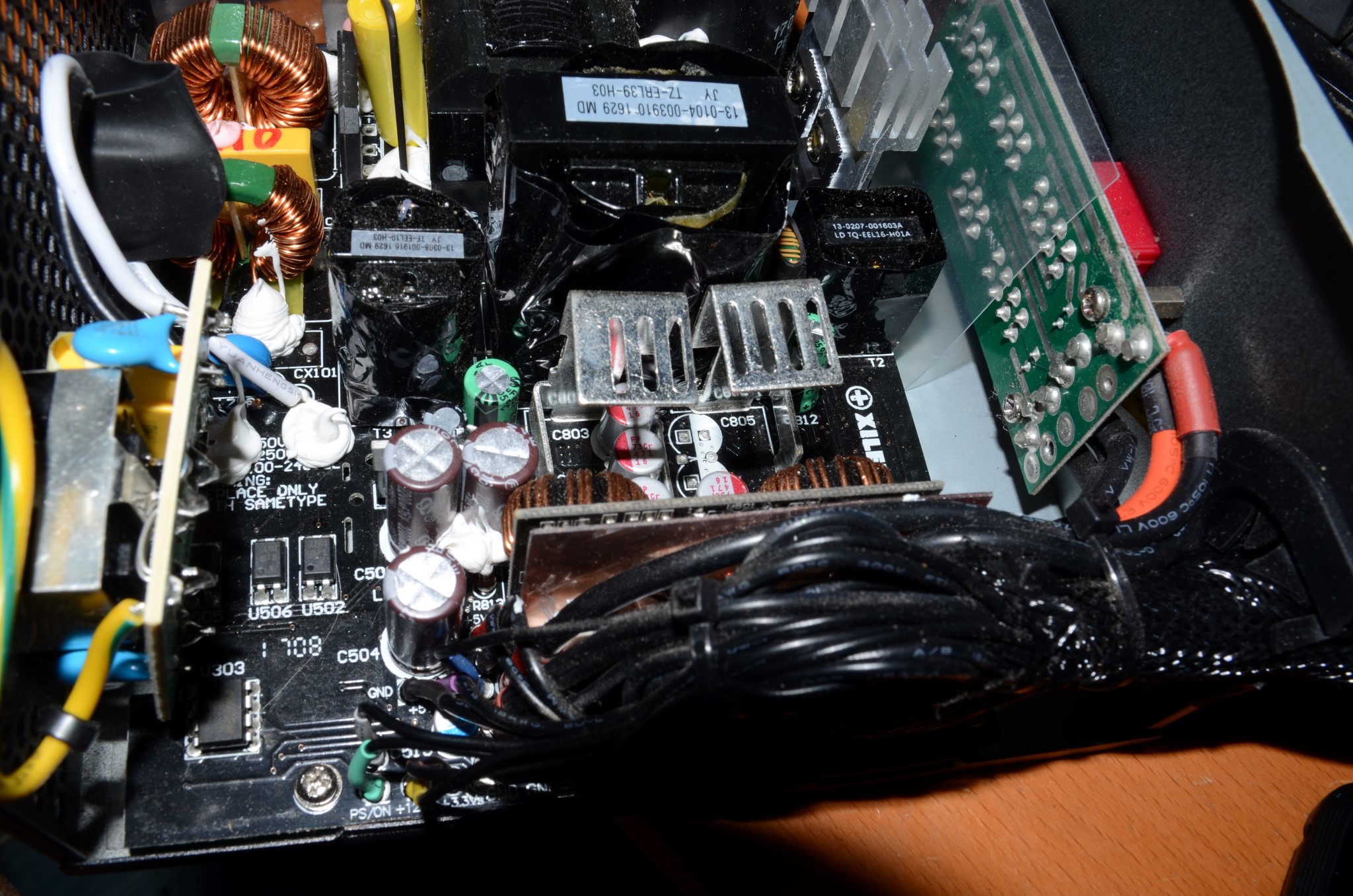

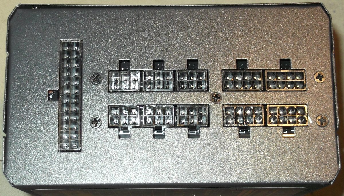

                                  #2796
                                  Something new, 80plus Gold (230VAC) certified, possibly the cheapest one there is:
Name:	DSC_4720 (Andere).JPG
ID:	2009806 Click image for larger version
Name:	DSC_4721 (Andere).JPG
ID:	2009807 Click image for larger version
Name:	DSC_4722 (Andere).JPG
ID:	2009808 Click image for larger version
Name:	DSC_4723 (Andere).JPG
                                  Not bad for the price that is under a Corsair CX750M - almost 10€...
                                  And the fan controller is better, fan rpm at idle way lower.
                                  I've measured something around 400rpm or something like that. And ~1400rpm at ~700W Load.
                                  The cables are really nice and not the usual Viagra Stuff you see on other manufacturers...
                                  The only thing I really hate is that bloody 8pin Protection IC...
