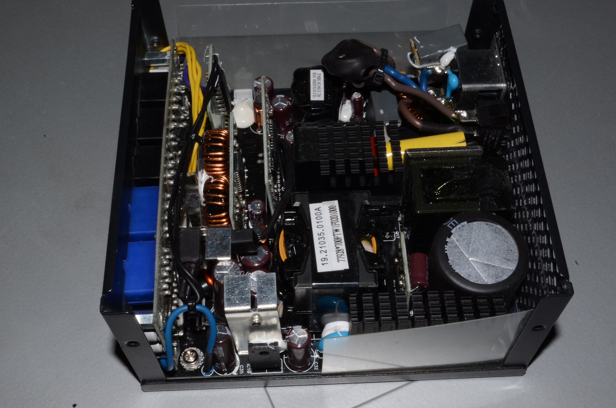

                  Something new from me:
                  Interesting thing:
                  It has TWO OTP circuits...

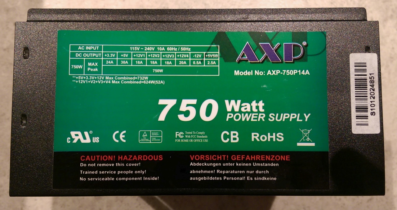

                      Axpertec AXP-750P14A
                      Manufacturers specifications: https://web.archive.org/web/20090302...power_750W.asp
                      Review: http://extreme.pcgameshardware.de/an...-750-watt.html
                      Didn't see this brand of PSU here before.
                      Has been in a pretty highend PC for 5 years.
                      User asked me to upgrade it and first thing out is this PSU, getting replaced by a Corsair HX750i
                      Caps are:
                      2x 3300uF 16v CapXon GF 10x35mm
                      4x 3300uF 10v CapXon GF 10x25mm
                      1x 2200uF 16v CapXon GF 10x25mm (5vsb)
                      I desoldered them and their ESR is not terrible but getting a bit high after these years of use...
                      Curiously absent is U10, we don't need no steenking OPP or OCP on our "750w" PSU!

                        That's pretty normal for cheapest units to have only the basic 8pin supervisor. If the primary is not underrated and has HW limit, under overload the unit usually turns off as soon as the secondary voltages drop low enough. For real PC that usually means it gets unstable long before that and freezes or restarts, effectivelly removing the overload

                                Pretty neat Super Flower made PSU. The U10 could possibly be an LM339.
                                The sad thing is that they advertized the PSU as a quad rail while it's just a Single Rail...
                                By the way: I have a similar thing here, though mine has other caps than yours: JP CE TUL...
                                So I'd say yours has better caps overall than mine does...
                                €dit:
                                Yip, that U10 is absolutely for an LM339, 95% sure it is!!
                                PS: and it's from 30th week 09...
                                  Caps are:
                                  That still looks like a very decent PSU. Definitely worth recapping. Are you going to?
                                  The only thing I am really worried about is the CapXon cap on the primary side, as they are known to go open-circuit or high-ESR a lot more often than other brands and cause the APFC to malfunction rather violently.
                                  It's also nice to see a high power PSU that doesn't use SMD components. Not that I have anything against SMD (in fact, I am so used to SMD/SMT stuff now, that I sometimes prefer reworking it over through-hole), but I still like to see my PSUs SMD-less.

                                      Stefan Payne: Ok interesting, maybe would be a fun project to try and add a LM339 to it then
                                      P.S: I'd take your JPCE caps over my CapXon's anyday!
                                      momaka: Yea I agree on the primary cap, I have seen several dead CapXon primaries!
                                      This one tested ok though, 400uF 0.25ESR and 0.5% leakage.
                                      I added a PCB pic after desoldering the primary, now we see the revision:
                                      Code:
                                       HXW REV:D
                                      SF-08/03/22
                                      SF-APFC2.33PCB-A
                                      Not sure if I'll recap it yet, need to buy some caps from Behemot then, because I don't have any D10mm 3300uF 16v caps...
