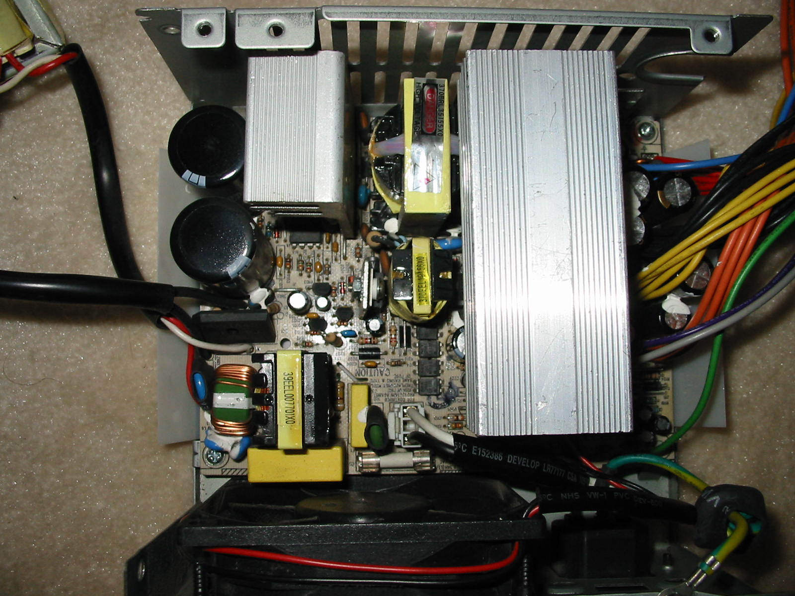

HiPro HP-2507F3P 250 watt PSU - came from a Dell OptiPlex GX260 SFF
DC Output: 5v @ 22A, 3.3v @ 18A, 12v @14A, 5vsb @ 2A, -12v @ 1A
150W combined on 5v and 3.3v rails
Has passive PFC (transformer not visible in the pictures) and uses single-transistor forward design. 5vsb is generated from a TOPSwitch TOP200YA.
Internals...
Schottky Diodes: 1x 40A for 5v rail, 1x 40A for 3.3v rail, 1x 16A for 12v rail, 3A axial diode for 5vsb
3.3v rail is generated from a Mosfet (hence the lack of a seconds coil on the secondary side)
Primary capacitors capacitors: 2x 200v 560uF Panasonic UP?
Secondary capacitors...
3.3v rail: 3x Asiacon LE 10v, 2200uF
5v rail: 1x Asiacon LE 10v, 4700uF and 1x Asiacon LE 10v, 3300uF
12v rail: 2x Asiacon LE 16v, 3300uF
5vsb: 1x Asiacon LE 16v, 1000uF and 1x Asiacon HT 16v, 470uF
-12v rail: 1x Asiacon HT 25v, 470uF and 1x Asiacon HT 16v, 220uF?
Very nice power supply overall, with thick heatsinks and temperature controlled fan.
Got it for free (well, $5 actually - reason in post below) because the 5vsb was not working. D203 (UF202, a 2A diode) was shorted. Replaced temporarily with FR153 (pulled from a gutless PSU long time ago), and PSU is up and running now

Excellent soldering!
The parts the used are overkill for 200 and 200 Watt psus.
Very good work

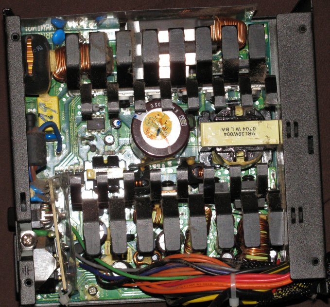

asus s-30fp made by bestec (says so on transformer and you can tell by the design of the case. the secondar caps are jamicon.
sandwiched among the jammies are some big resistors presumaby responsible for the discoloration of the inside of the case there. decent input filter, decent heatsinks...Comment
The designer of this PSU obviously doesn't know ANYTHING about heat dissipation! Get rid of those resistors before they bake everything. Also a good idea to remove the tan/brown glue which goes conductive (usually with added heat).
On the 200W HiPro I posted, there was just one 100 Ohm resistor on the -12v rail which was enough to cause minor discoloration on the PCB. Needless to say, I replaced it on sight. Used a 1000 Ohm resistor.
Actualy, the soldering is about average on those HiPro PSUs. I like it, though, because the solder is not lead-free and there are no SMT components like Delta and Lite-ON usually do.Originally posted by goodpsusearchExcellent soldering!Last edited by momaka; 10-10-2010, 09:55 PM.Comment
