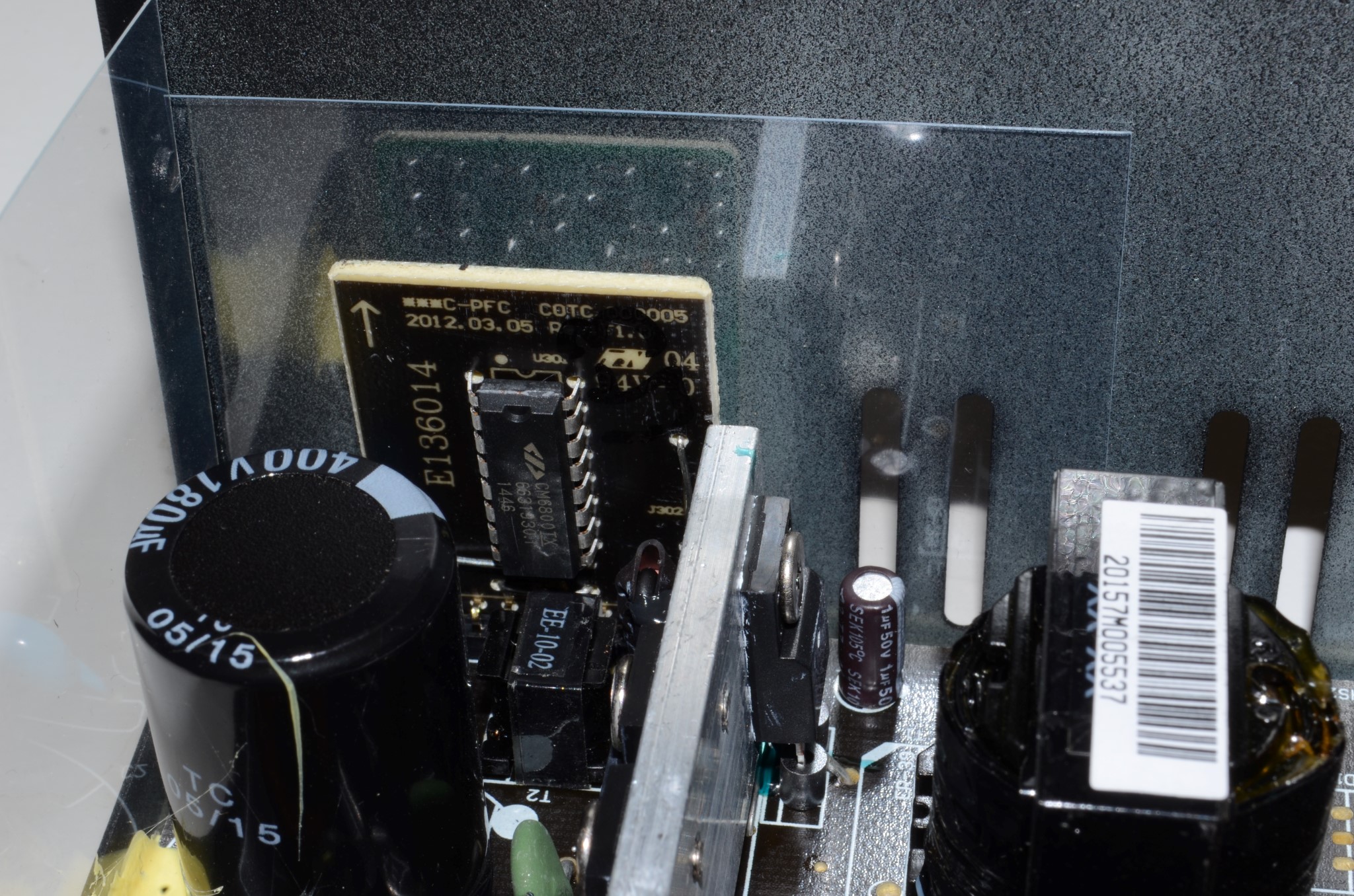

                Something brand new:

                  brand new and i still see the damm brown glue!

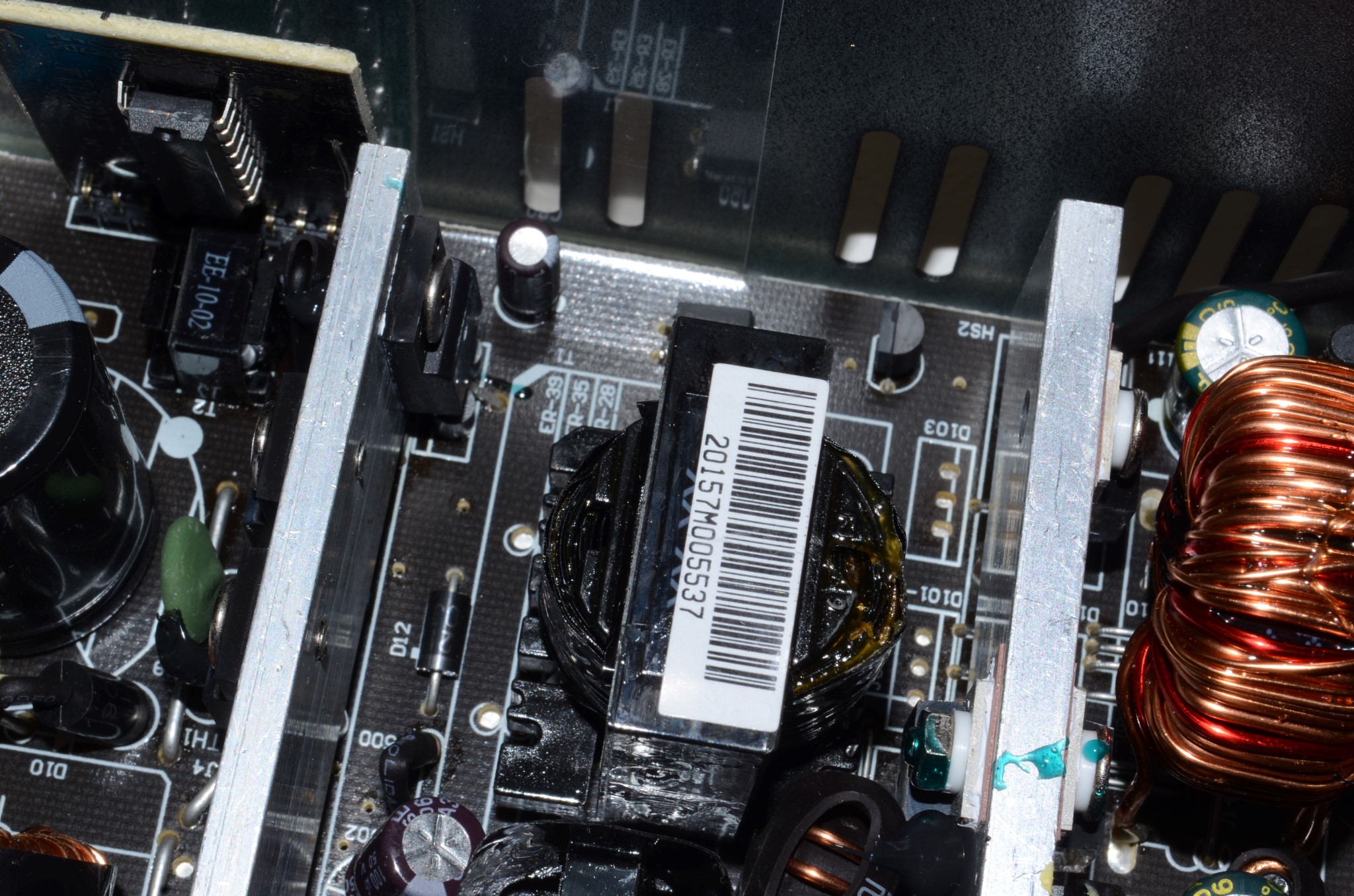

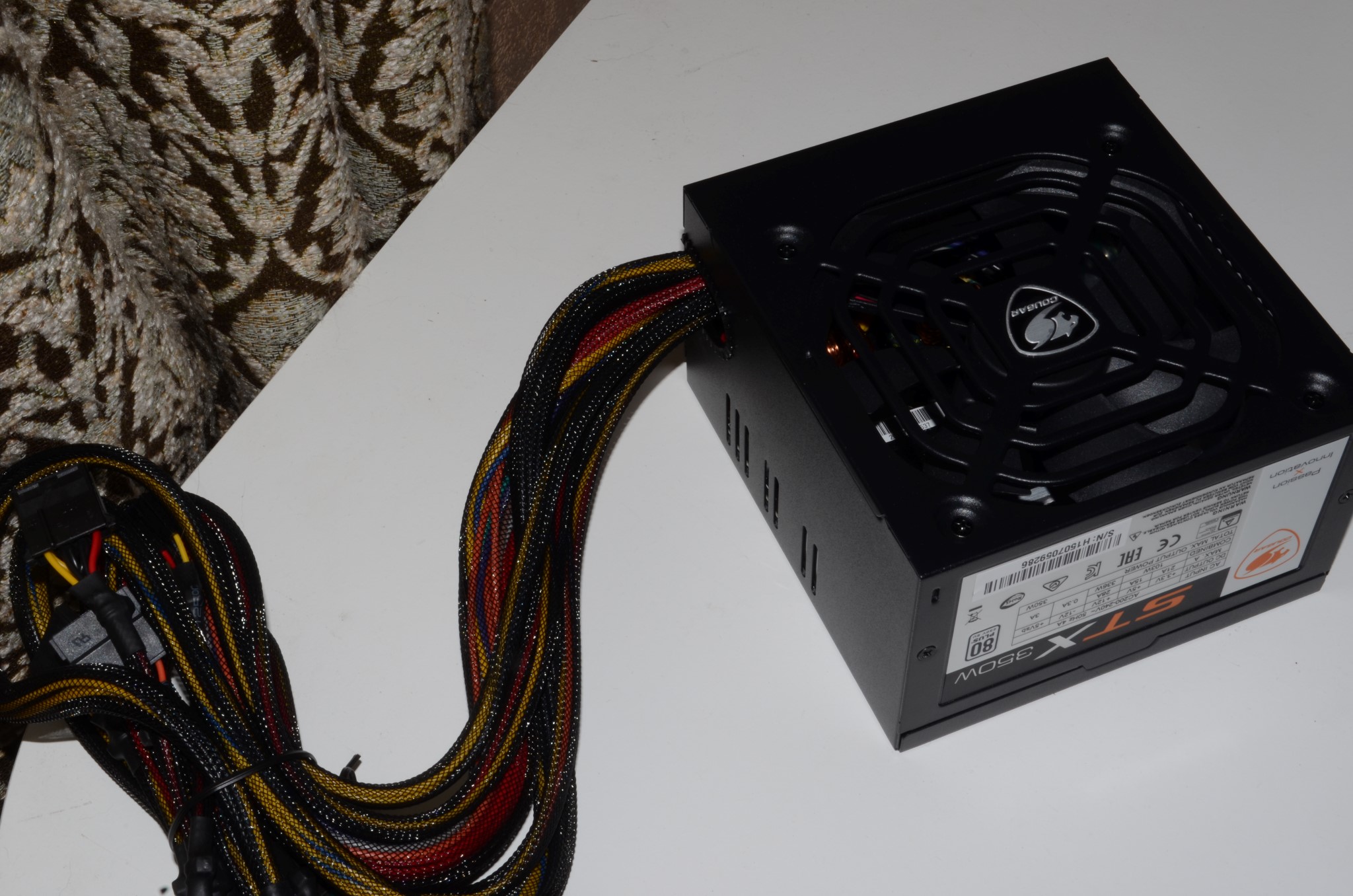

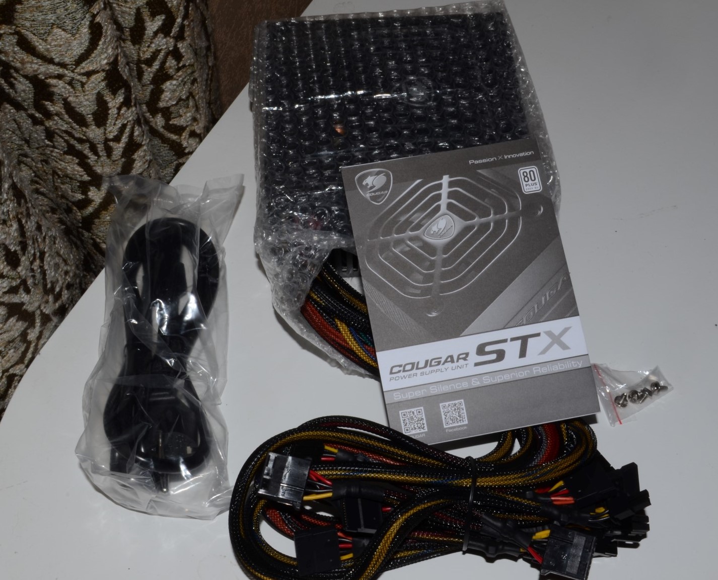

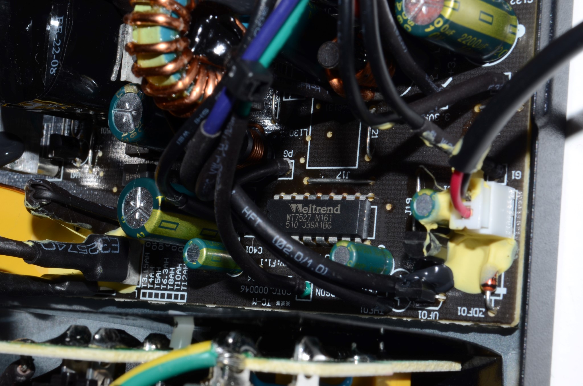

                          Here the rest of that unit I posted yesterday:
                          I think I don't need to say anything, do I?
                          Well, except for:
                          Thanks to Caseking.de for that unit

                            Stefan Payne: HEC? Interesting, I would have guessed some chinese maker…

                              Well, it's the same PCB as be quiets L8 series and some others...
                              EVGA also has some similar designs.
                              Just in a 350W version with tiny heatsinks...
                              Interesting thing by the way: With 360W primary load, that one is more silent than a Seasonic G-Series or Enermax Triathlor unit...

                                That does not mean anything…look at CM G550M, it is so silent…because the fan is hardly spinning and it was the first unit to overheat with sweater.
                                When you put slow fan in there it will be silent, but the consequences…
                                • Stefan Payne
                                  • 1267
                                  #2456
                                  To use a PSU inside a sweater is not specified, so it is not something a PSU has to endure...
                                  Besides: The 0,5A fan inside the Cougar STX350 isn't that slow...
                                  According to my calculation that fan should be something around 3000rpm @ 12V or so (-500rpm)...
