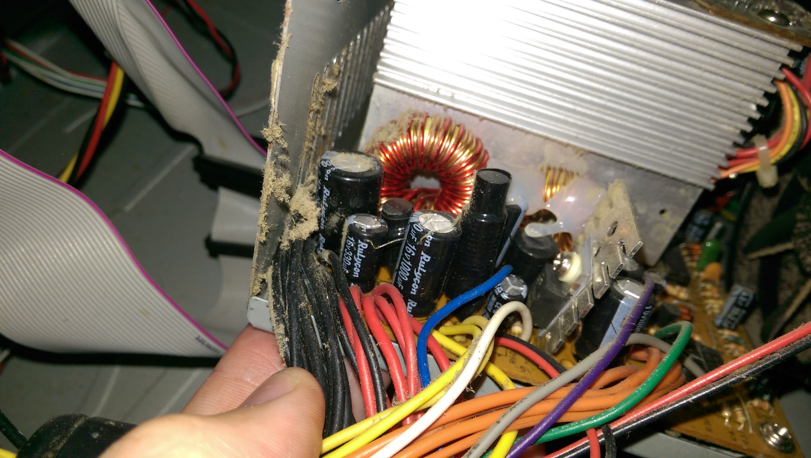

                                    • c_hegge
                                      • Sep 2009
                                      • 5219
                                      #2438
                                      Galaxy Power SPX 250W
                                      https://www.badcaps.net/forum/attach...1&d=1443662650
                                      Internals. Looks like an old AT design with an add-on 5vsb PCB
                                      Primary side. 330uF Jee Primary caps and non-approved input filtering parts.
                                      Secondary side
                                      Caps are all Rulycon, but surprisingly, none are bulged. I can't remember what the silicon was, though.
                                        master hoarder
                                        • May 2008
                                        • 12175
                                        • Bulgaria
                                        #2439
                                        Rulycons that haven't bulged yet?! In 2015????? These must have been the golden engineering samples, or something.
                                        I wonder who made this one. I guess this is from the very early 2000's, as JEE and Rulycon were still quite popular back then.
                                        • Wester547
                                          • Nov 2011
                                          • 1268
                                          • USA.
                                          #2440
                                          They must be fake Rulycons. Or maybe resleeved Rubycons.
                                          Okay, maybe not. I spy a "1M9828" datecode on one of them - yet another way in which Rulycon imitates Rubycon. So they are probably from July of 1998. As far as "bad electrolytics" go, I find that their "failure modes" make manifest in different ways. I think it's a race between poor quality seals (low quality cans and vents, synthetic rubber bungs... they just dry out and won't likely bulge or leak in any manner that's obvious) and poor quality electrolyte and aluminum foil (the most likely scenarios to cause them to vent). Those Rulycons may look good but their actual condition may tell a different story.
