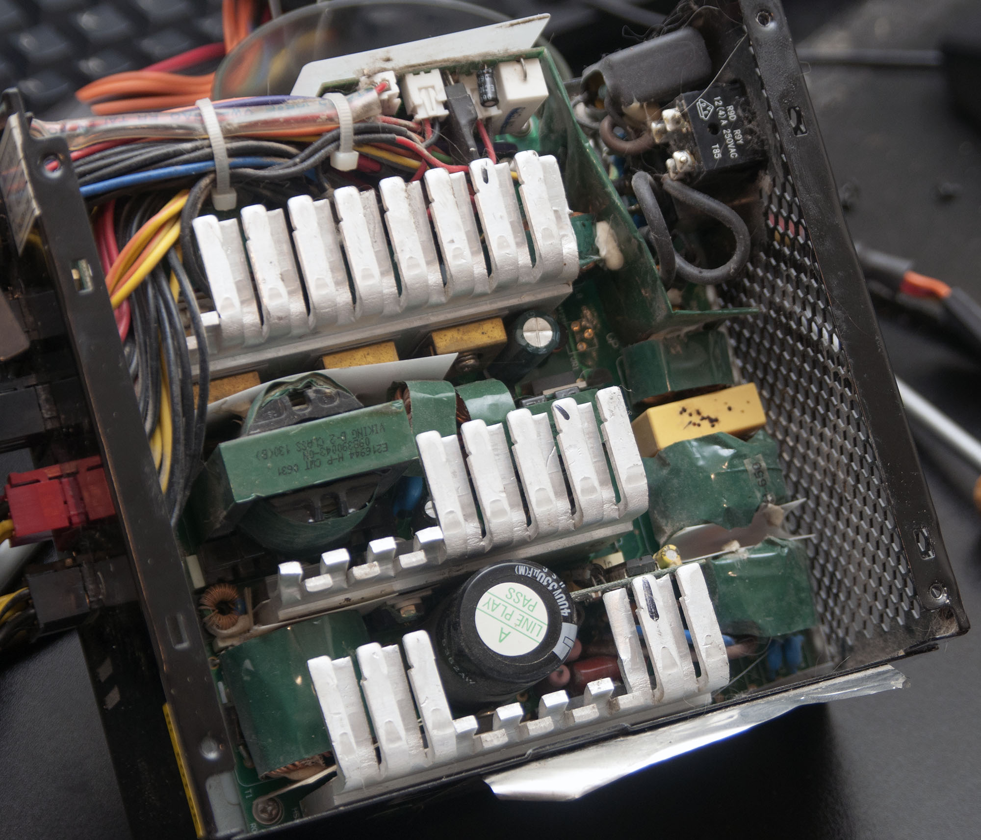

      Something I obtained today: (anyone know who made this one?)
      Solytech indeed, as Dan81 mentioned.
      Originally posted by Stefan Payne
      From afar it doesn't look that bad, does it?
      Well, it's certainly one of Deer's/Solytech's better units, but I still wouldn't put it in a mission-critical computer or something where you keep a lot of important files or have lots of important hardware hooked to. Other than that, it seems a perfectly capable PSU (good heatsinks, good rectifiers, and large primary BJTs).
      Just recap it. And DEFINITELY remove/re-arrange the dummy load resistors on the secondary side. Most likely, the 12V will have a 100 Ohm resistor, the 5V rail will have a 47 Ohm or 27 Ohm resistor, and the 3.3V rail will have a 10 Ohms or less resistor.
      Re-arrange these so that the 100 Ohm resistor is on the 5V rail, the 47 Ohm goes on the 3.3V rail, and the 12V rail is left with nothing (and the 10 Ohm resistor is also not used). You must absolutely do this resistor mod, otherwise those load resistors in their original spots will generate a lot of heat and cook your new caps (or shorten their lives considerably).
        It was in a mission-critical computer with a shops database on it...
        That's what I meant...
        Seen PSUs with worse heatsinks...
        Just recap it.
        I won't
        Have enough decent PSUs lying around here, so there's no need to recap it

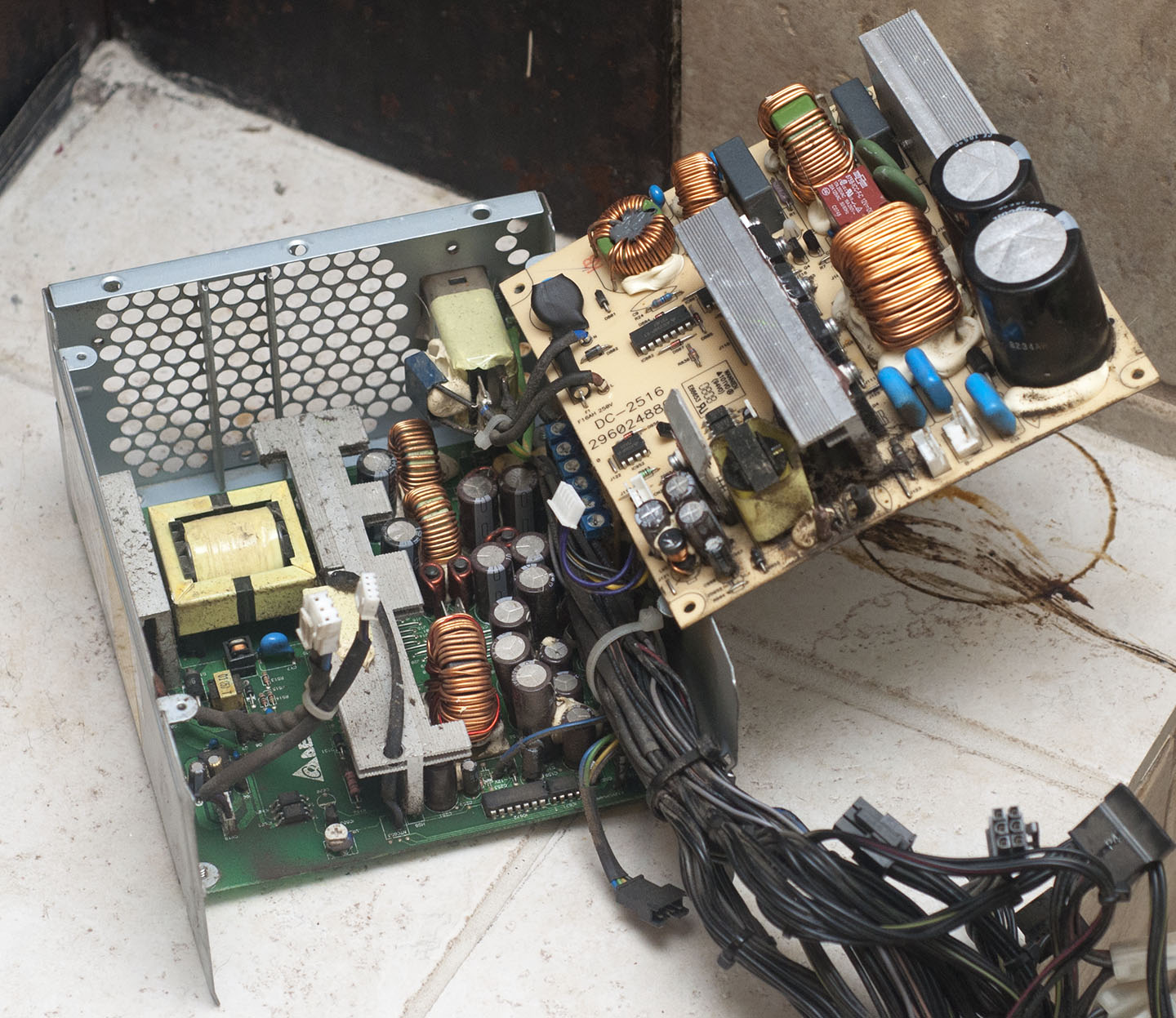

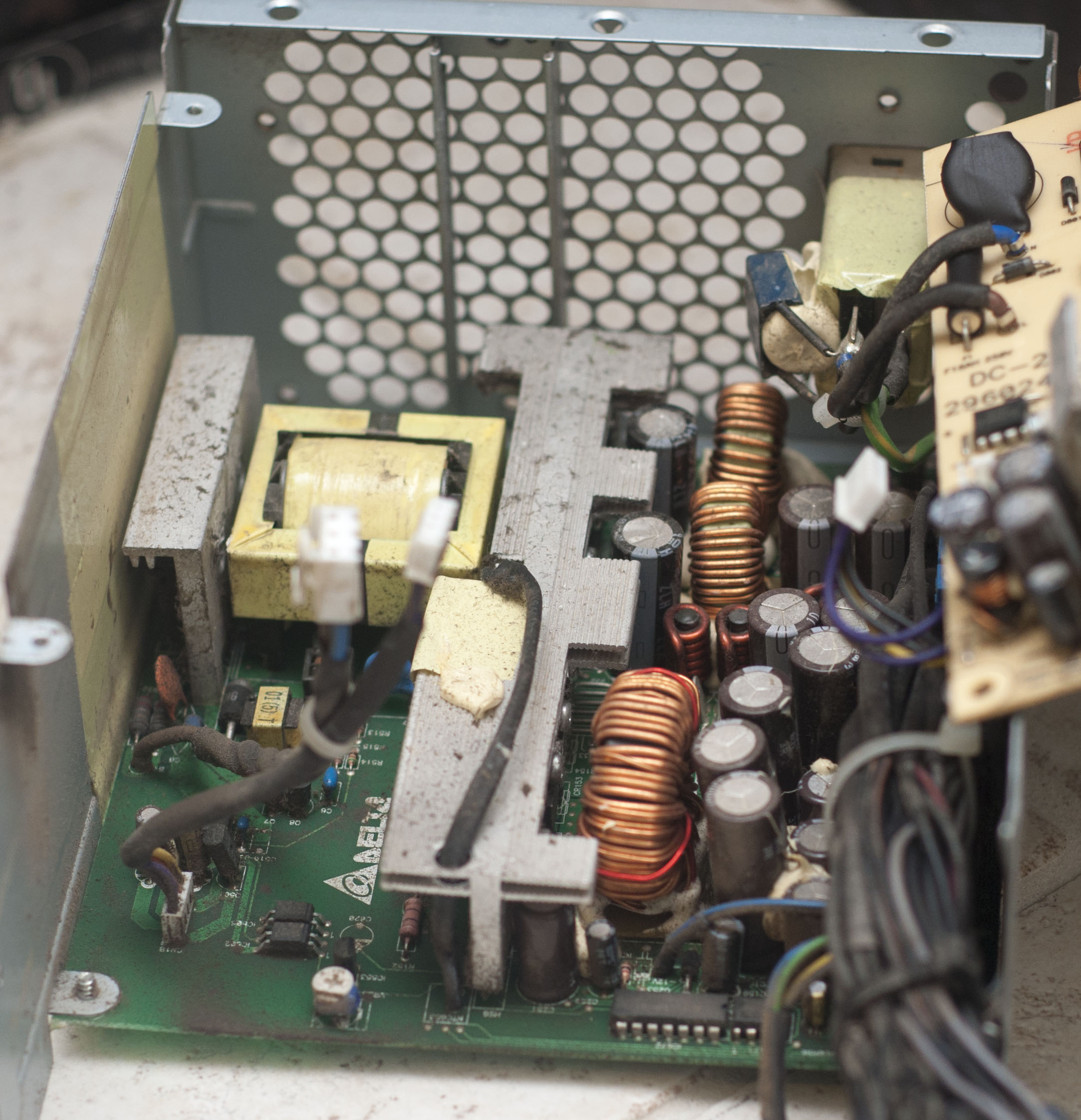

            A (damp) Delta DPS-800LB from an HP XW8600.
            Let's ignore the dirty area surrounding the fireplace.
            As one might have guessed...Delta Fan.
            Not too terrible. Dual PCB design is interesting but it looks fairly decently built (to me anyways).

              #2166
              That thing is more than 'fairly decently built'. It's built like a tank. It should just about last forever.

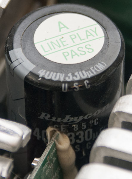

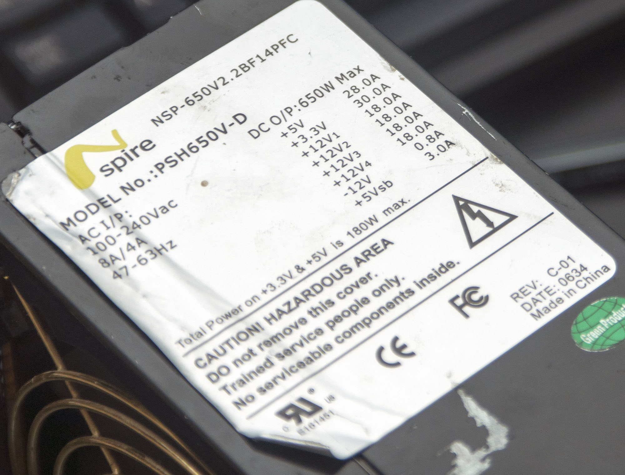

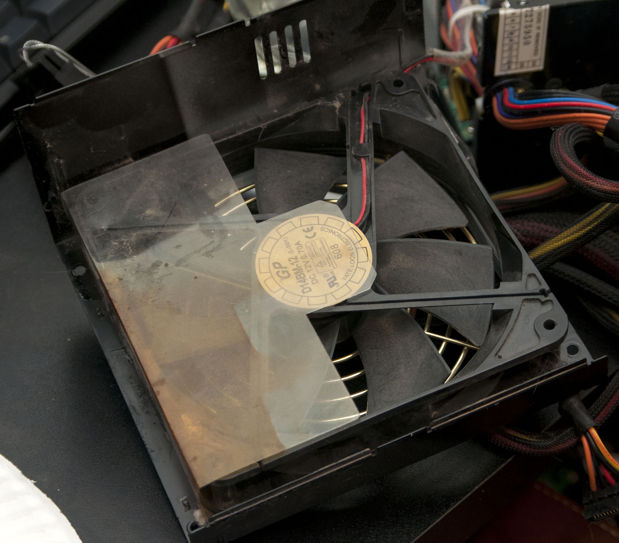

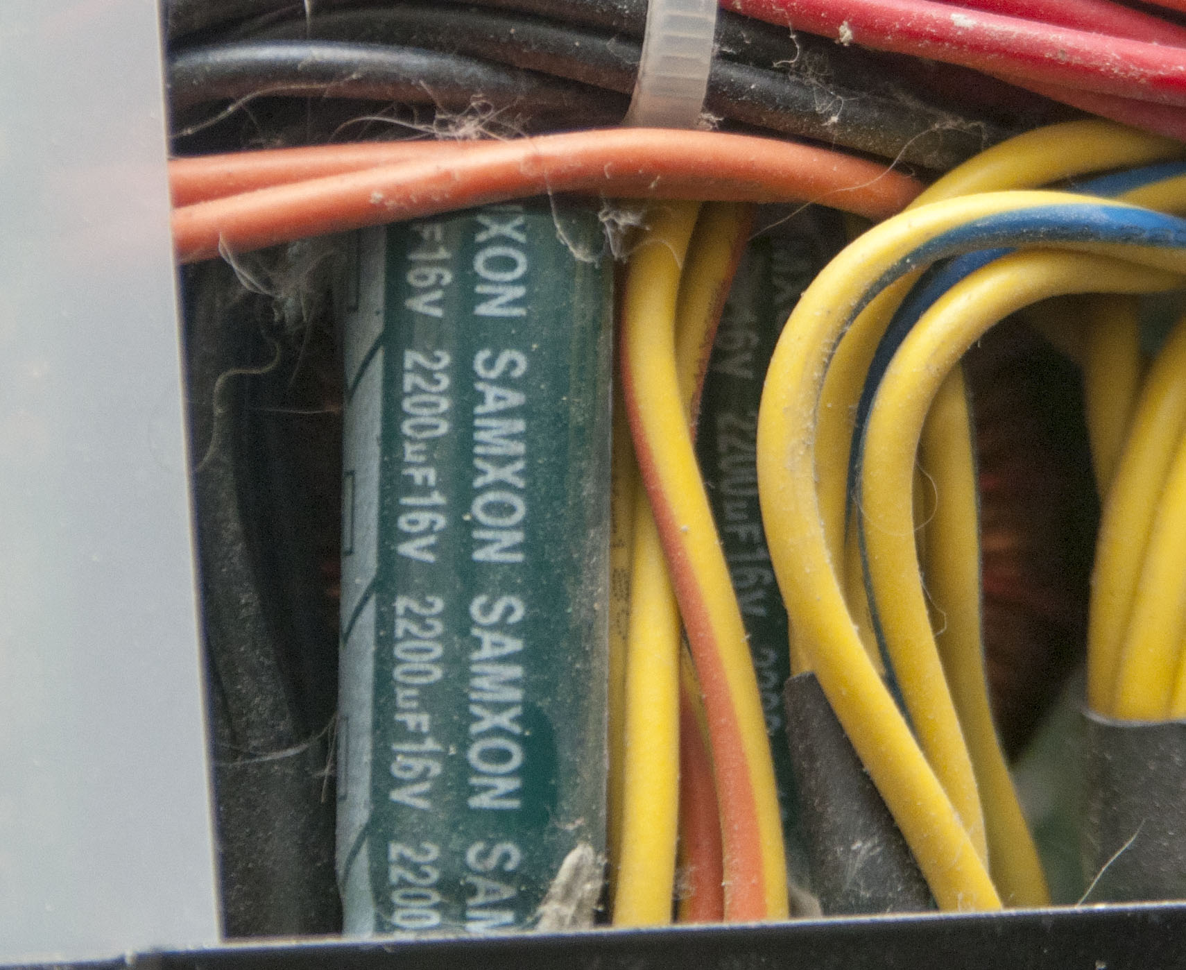

                    Anyways, here's my regular desktop one. We were watching a cat who was waiting to have his balls chopped and he decided to spray my old desktop. Opened this up to check for cat urine inside and thankfully it's safe.
                    nSpire PSH650V-D. It's a Channel Well design, shared with a Thermaltake PSU. I assume it has PFC based on the marking on the label.
                    Fairly well built, especially for an nSpire which is basically a no-name.
                    The caps are a mix of Rubycon USC and Samxon. No bulging or leaking at all and this PSU has been in constant use since 2008.

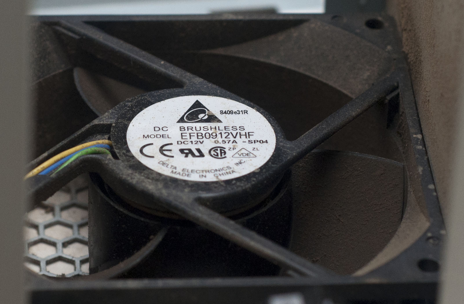

                    The fan is a Yate Loon fan. You can see the yellow where the cat urine got stopped - I guess that air deflector shield came in handy for saving this.

                      I've had a nearly identical power supply get bad samxon GF caps on the 5vsb output and cook the motherboard as a result.

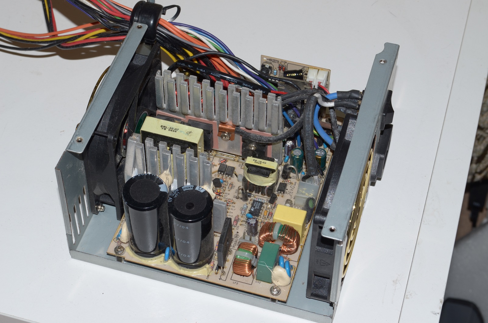

                          Here the Pics of a HEC 350MR-PTD, Dual fan (80x15mm), 18A on +5V, 33A +5V and 28A 3,3V. Combined 220W. With pPFC...
                          And there's something about this unit that's rather uncommon nowadays for HEC. You may guess what ;-)

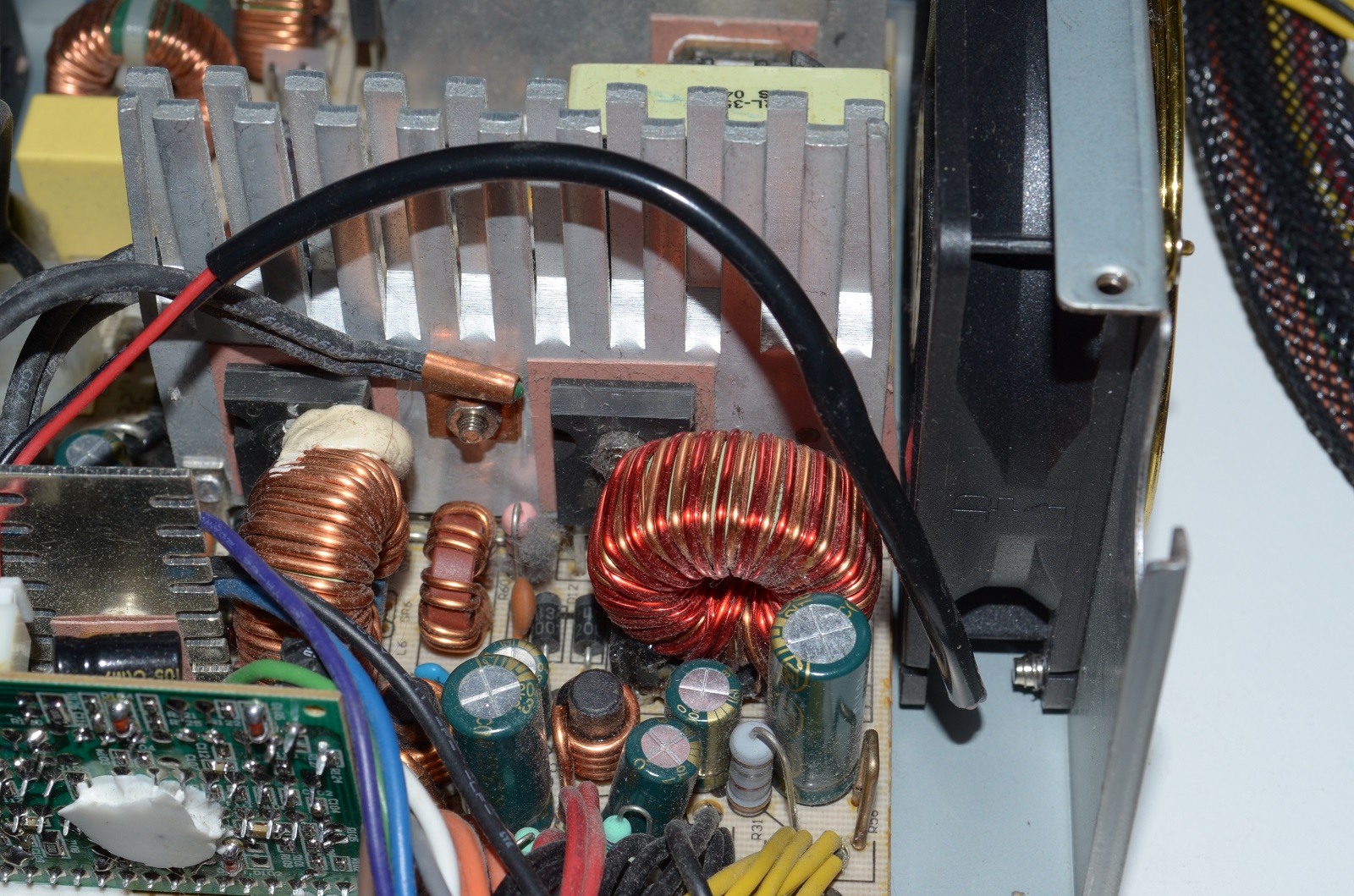

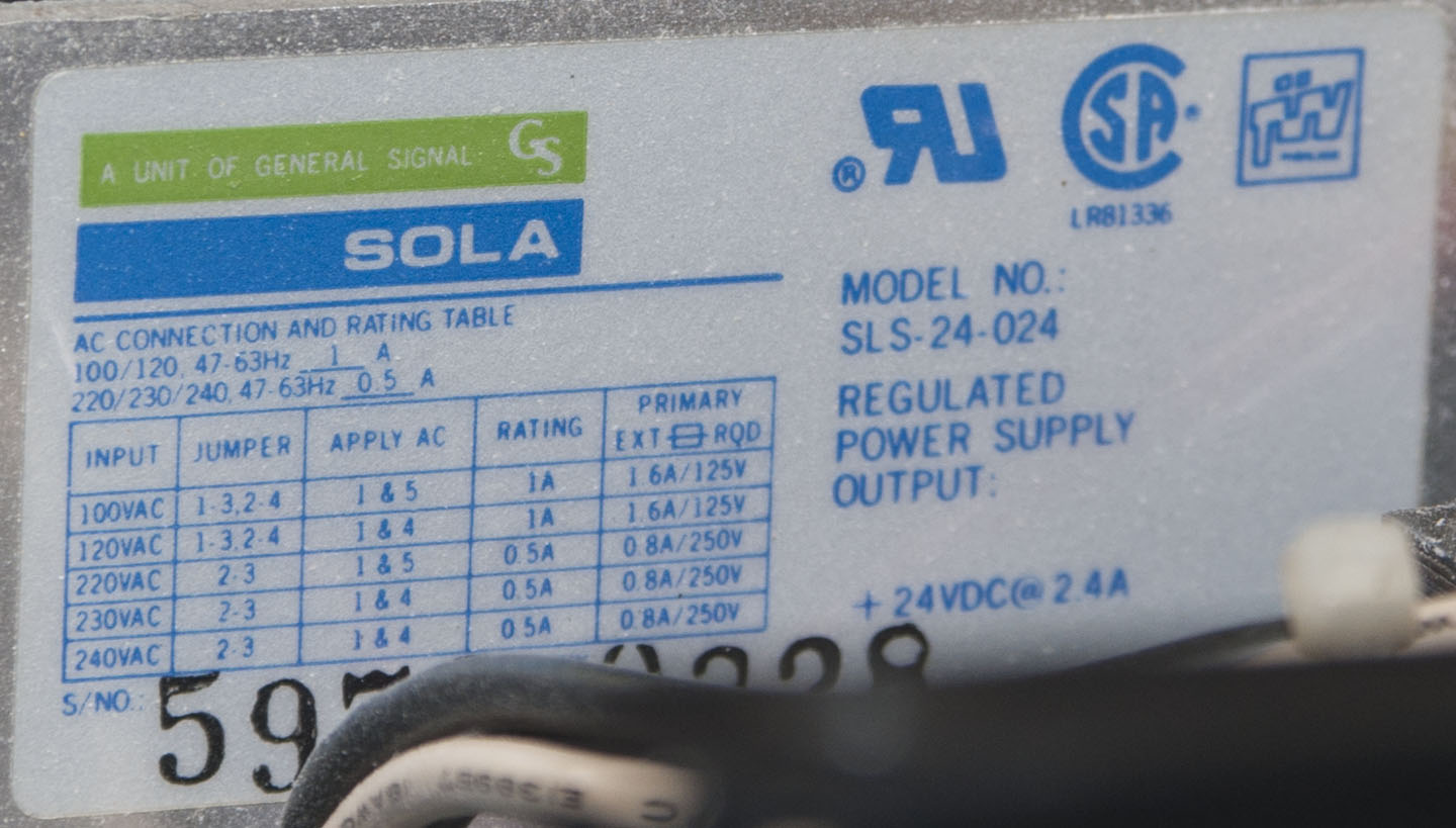

                            Got a couple headphone amps as a present in the mail and was quite surprised at the weight of it, I mean they're two single 12AU7\6DJ8 amps.
                            This was also in there, a General Signal Sola SLS-24-024 in an ATX PSU case.
                            It's a 24V, 2.4A linear PSU with a fairly beefy transformer and a fairly large cap (50V, 10,000uf) compared to what the stock wall wart would be with the outputs connected to a barrel plug.
                            Large cap is marked "105C TAIWAN RICHEY" and the small cap is a United Chemicon KME 35V 1000uf and the smallest cap is a Chemicon KME 50V 47uf.

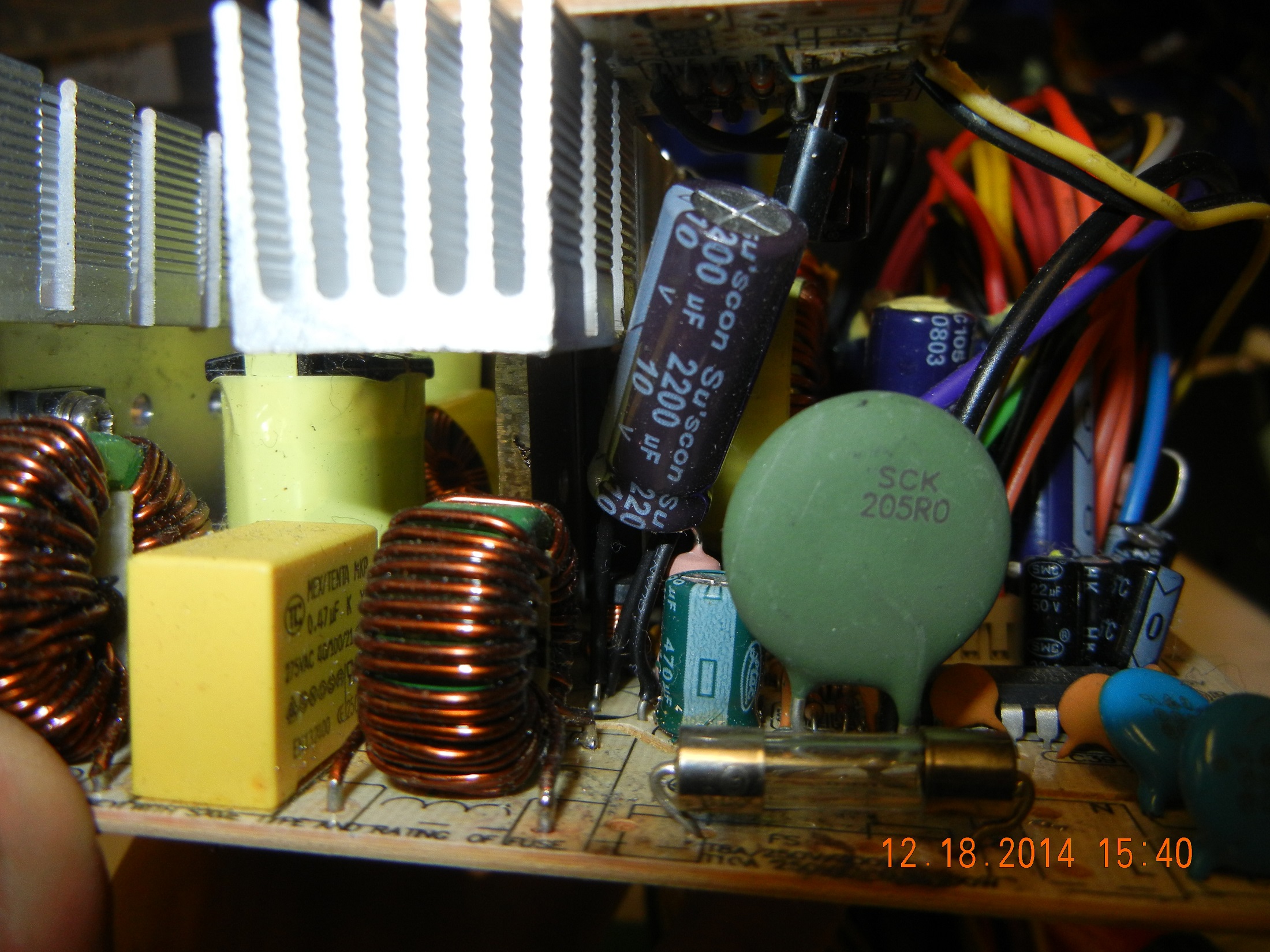

                              Not bad, seen better for the rating though. I have a 2001 built HEC unit that's much more beefy than that.
                              Ltec caps?

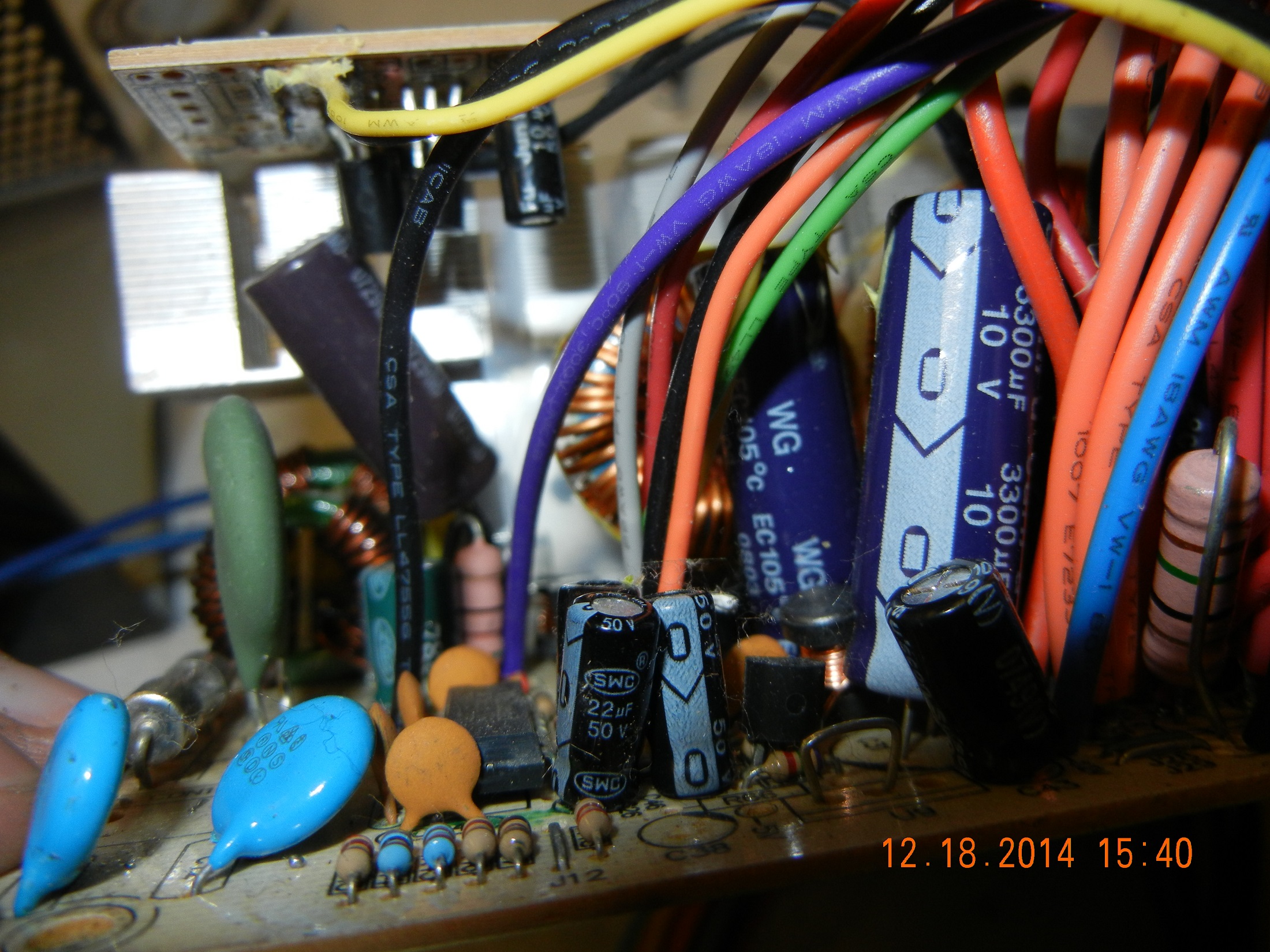

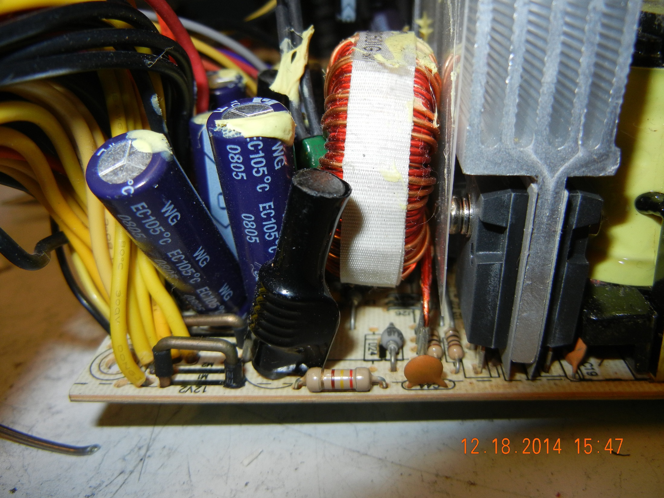

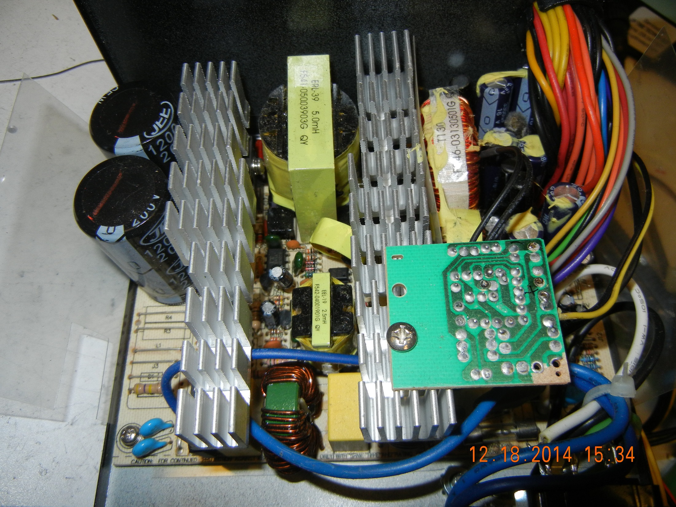

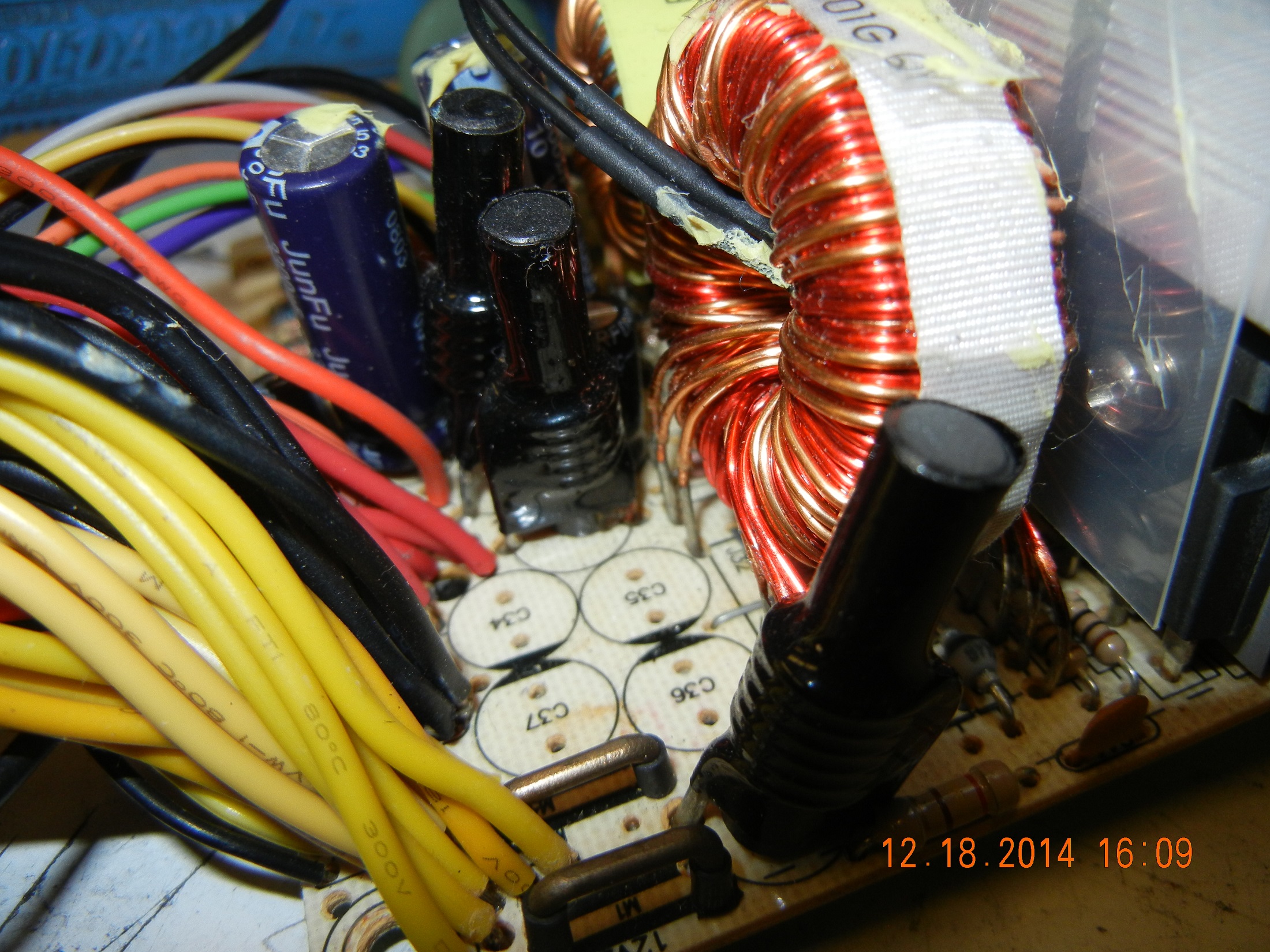

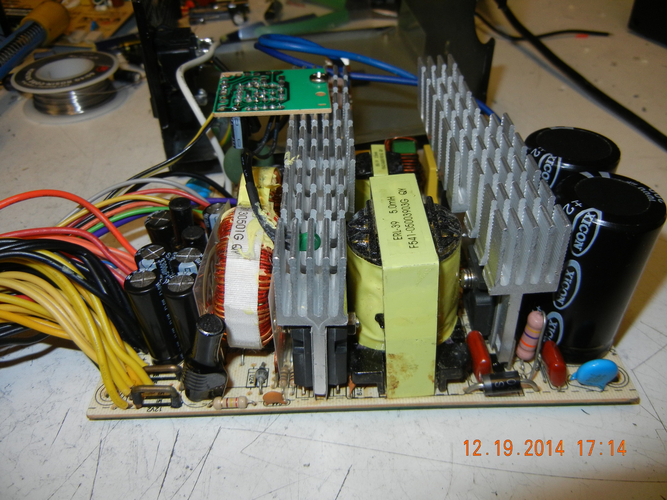

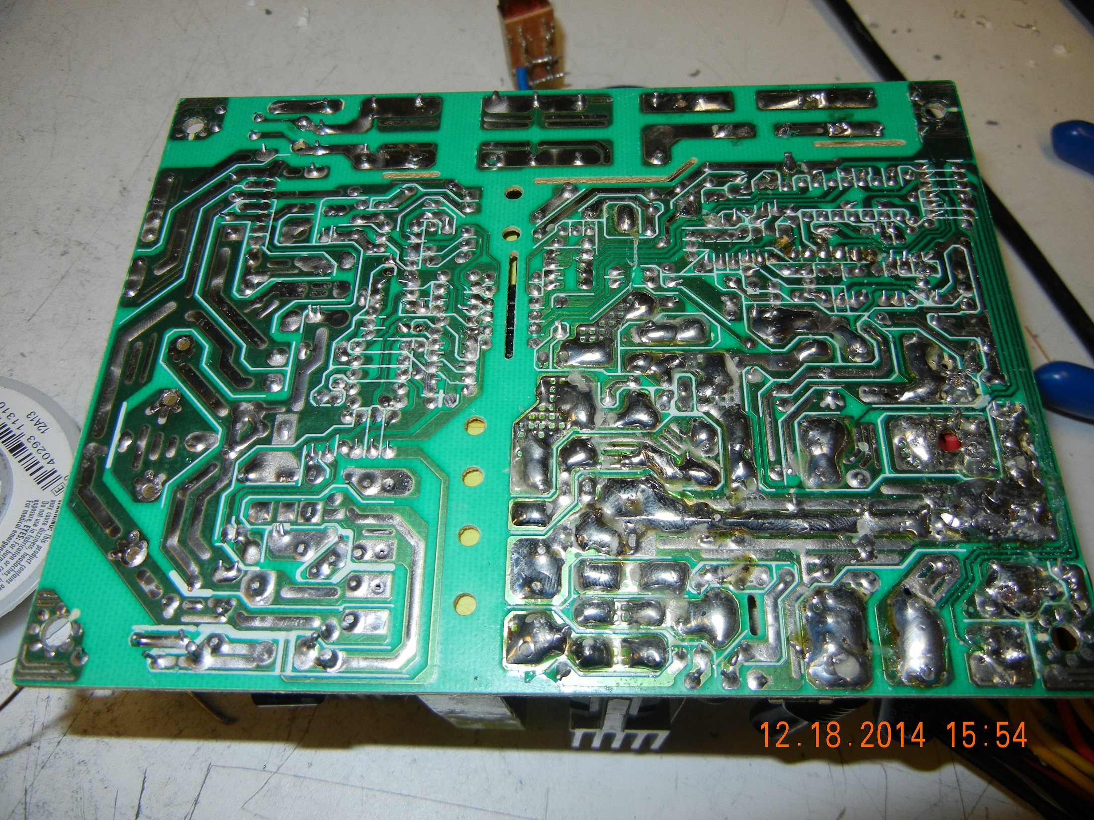

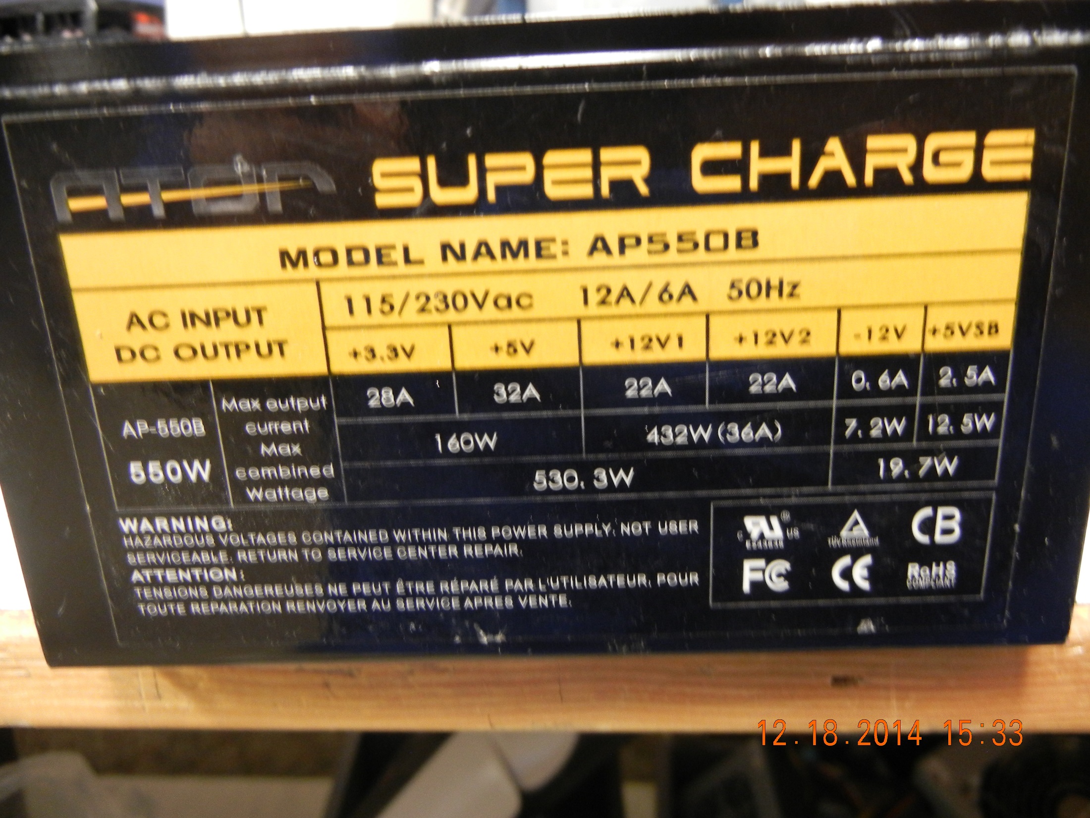

                                This was a fun PSU to work on...One of those generic "could be PFC" units, it's a solid design but the build quality on this one was terrible. UL number leads to Raidmax, and the fan gives it away as well. They did a "grab bag" when it came to caps: JEE, Ltec, SWC, Su'scon, JunFu. And the date codes ranged from early 2006 to early 2008 They all tested good, to my amazement. Even those high voltage 1200uF JEE caps read 1182uF and 1176uF. It's single forward, but it uses a 17A FET. With that heatsink it should be able to pump out a lot of wattage. The 5V uses two 30A schottkys in parallel (TO-247), 3.3V uses a 30A schottky. 12V actually has two rails, and each one gets 30A. Toroid coils are good sized.
                                Sooooo, the build quality....Look at that soldering. It's terrible! And look at how suspended some of the caps are, especially that Su'scon on the 5VSB. And get this....one of the caps on the 12V filtering (C37) was installed at the factory with pressure pulling on the negative lead. When I went to desolder it, I desoldered the positive lead first, and the thing fell out! I could tell that only the positive lead was soldered in for quite some time, judging by the dust and color of the negative lead. I've never thought about this: How would this affect the filtering on the 12V rail if the ground wasn't connected on that cap?
                                I recapped it, oiled the fan, moved the fan thermistor to the secondary heatsink, and cleaned up some of the soldering. How much wattage do you think this thing could pump out? I'm thinking it could at least do 425W continuous no problem, although the primary FET might limit it to less than that. The fan controller is fairly aggressive.
                                  At least there was insulation on the legs. I've seen Andyson suspend them before (although not quite like that 5vsb cap, maybe more like 1cm) and not insulate the legs. That soldering is prettu ugly, though. It looks like a lot of the joints were done by hand.
                                  Ouch. That cap may as well not have been installed. If one leg is not connected, it will have no effect. At least with 1 cap and 1 coil, it might just have done a good enough job at keeping the ripple under 120mv.
                                  I'm kind of thinking 350 or so, simply because that about all that power supplies based on the STF topology are capable of. It might do a bit more, though, as it has a fairly beefy primary heatsink.

                                    Originally posted by c_hegge
                                    At least there was insulation on the legs. I've seen Andyson suspend them before (although not quite like that 5vsb cap, maybe more like 1cm) and not insulate the legs. That soldering is pretty ugly, though. It looks like a lot of the joints were done by hand.
                                    Oh yeah, I've seen that too. Typically on their lower end units. Yeah, it is pretty ugly. Not bad enough to justify redoing all the secondary though, that'd take a lot of heat and time.
                                    Not just that, but block airflow as well. Interestingly, it read the worst out of all the Jun Fool caps. The capacitance had risen to 3697, where all the others read very close to 3375uF
                                    It is a 17A though, that's bigger than most STF FET's I see, such as 9A in a 300W Enermax that can do its rating no problem, or a 12A FET in a 350W Hipro/Bestec
                                      Do you mean the good old HEC-300LR-PT? Or do you mean it's predecessor the 300GR?
                                      But that only has one fan and is awfully loud.
                                      Ltec caps?
                                      Yeah, they don't use them anymore. They rather use Su'scon....
                                      That was also the funny thing about the 700W Cougar unit.
                                      NCC Primary and Su'scon secondarys...
                                          What's the RDS-on? That matters just as much as the rating. There's a reason why I had one Hipro D3057F3H which managed 450W for a few minutes (before the secondary side overheated and the OTP kicked in) with a 7A FET, while another one blew a 9A FET under the same conditions. The 9A FET had a 32% higher RDS-on than the 7A in the other unit. (0.91ohm vs 1.2ohm)
