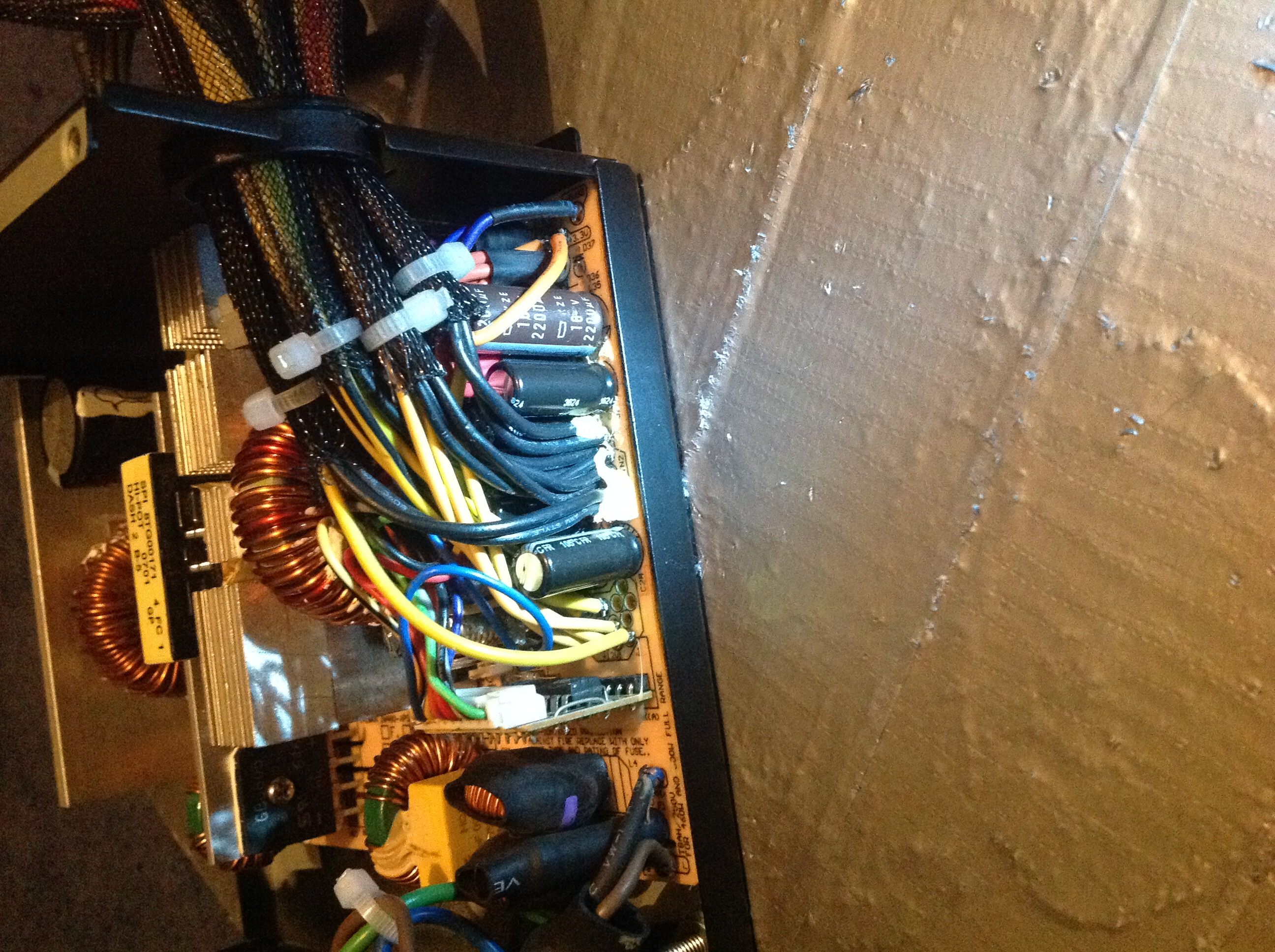

              #2026
              Well this is my first post in this awesome thread, I have many atx power supply's that I will take pictures of and share them to see what you guys think.
              Here is the first psu that I have recently recapped as it was full of fuhjyyus, its a hiper hpu 4s525 rated to output 525w max its manufactured by andyson and seems good enough for 450w. It has 3 powerlogic sleeve bearing fans that are controlled by a fan controller on the back where the ICE connector is.
              Specifications listed:
              Active pfc forward design with a pfc booster that takes the rectified dc and boosts to 385-395 vdc then its divided and forwarded.
              I couldn't see what the primary transistors are.
              5vsb is controlled by an Ic.
              Transformers are decently sized (height and width)
              Output capacitors were all replaced from fuhjyyus to jamicon for the smaller caps and for the larger samxon, ucc and Panasonic.
              5v 1* 4700uf 10v ucc ky 1* 3300uf 10v samxon rs
              3.3v 1* 4700uf 10v ucc ky 1* 3300uf 10v samxon rs
              12v 2* 3300uf 16v samxon rs
              -12v 1* 1000uf 16v Panasonic Fr
              -5v 1* 1000uf 16v Panasonic Fr
              5vstb 1* 1000uf 16v Panasonic Fr
              Fan controller 1* 2200uf 16v ucc kze
              Primary capacitors 2* 820uf 200v
              Output rectifiers are all double banks of sbl3040pt on all rails.
              Please could you let me know what you think about this psu is it decent it hasn't ever been used so its all brand new?

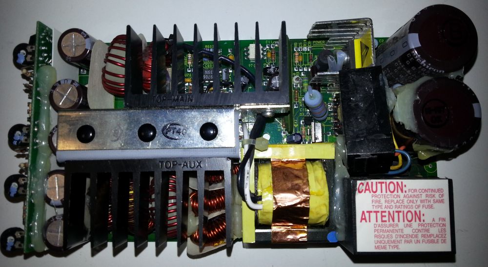

                #2027
                Here is a zalman 460aps psu that is rated for 460w its manufactured by spi seems good but came full of blown capxon capacitors that caused a massive amount of voltage ripple, they were all replaced with good brands and the voltages returned to normal.
                Double ball bearing nmb fan controlled by thermistor mounted on the underside of the secondary heatsink.
                Gbu805 bridge rectifier.
                Active pfc.
                Pair of 10n50 transistors.
                Transformers aren't that big but ok.
                Output rectifiers are all double banks I could read there ratings as its so densely packed.
                This psu has low uf output capacitors but ripple is ok:
                12v 2*1000uf 16v Panasonic Fr
                3.3v 2*1000uf 16v Panasonic Fr
                5v 1*1000uf 16v Panasonic Fr 1* 2200uf ucc kze
                Primary 330uf 450v Panasonic
                Smaller capacitors Jamicon
                Let me know what you think about this psu.

                  #2028
                  It's an FSP! Not bad!

                    #2029
                    Nice job recapping those units, they both look good Love the Power Logic fans in the Andyson unit. Main transformer on that FSP is plenty big. Should be insanely reliable now, especially with that fan!

                      #2030
                      Yah. With a decent 2BB fan like an NMB and entirely Jap Caps, the PSU should never fail

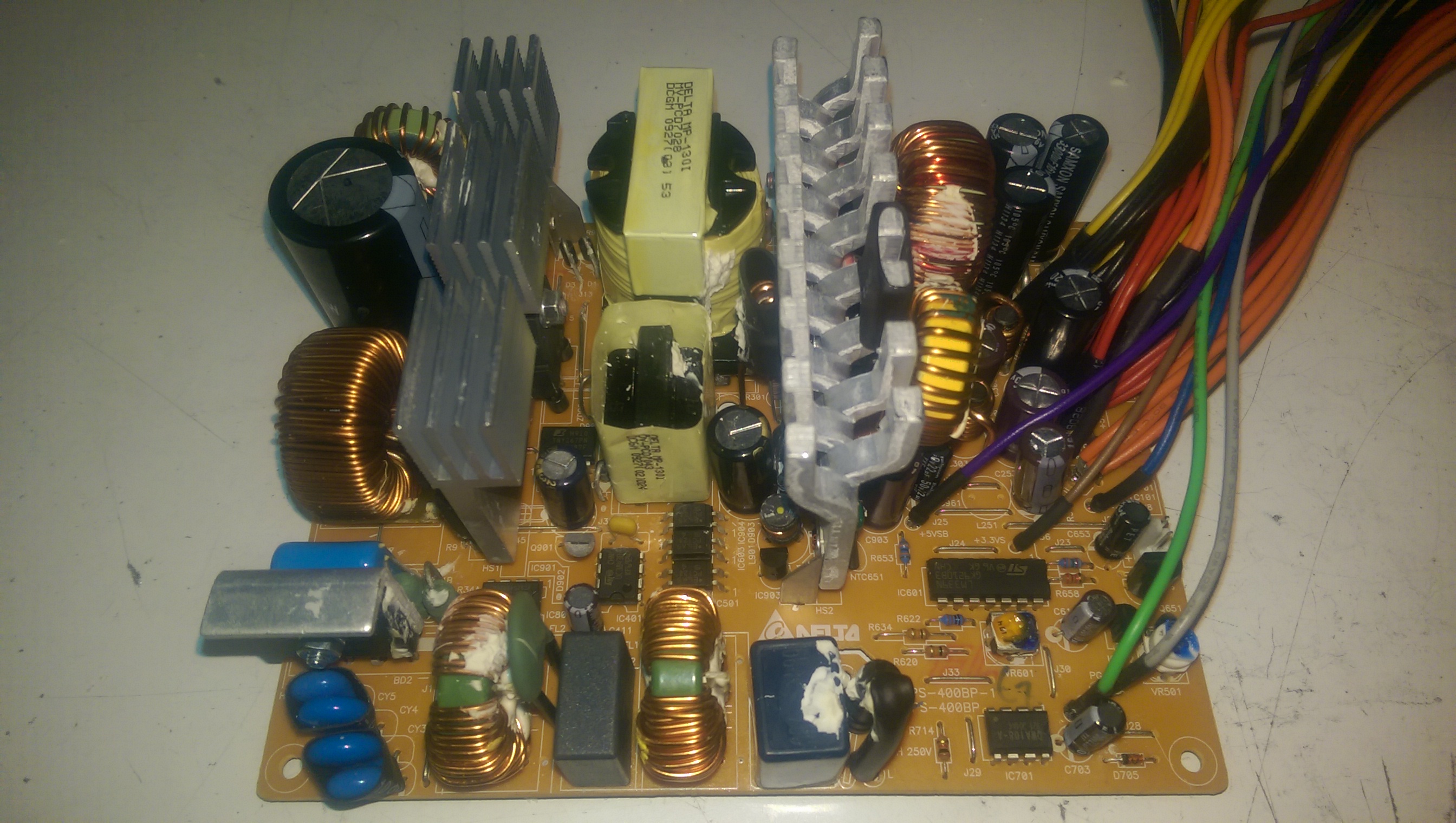

                        #2031
                        A buddy of mine said this Delta was going to be taken to the dump, and he snagged it saying "I know a guy who would love this thing!" So I decided to recap it, and believe it or not, remove most of the glue.
                        Never seen this model before from Delta. It got about 5 years of use. All the caps were in the spec, however the Taicon after the coil on the 5VSB was barely in spec, and so were the Ltec LTG on the 12V rails. Each 12V rail uses a 20A schottky.
                        • c_hegge
                          • Sep 2009
                          • 5219
                          #2032
                          Originally posted by Pentium4
                          [snip]this Delta was going to be taken to the dump[/snip]
                          I hope your friend told the guy in no uncertain terms that Deltas must never be tossed out, especially if they are still working!
                          That looks like a really nice PSU, though. Definitely worth saving.

                              • Stefan Payne
                                • 1267
                                #2035
                                Well it's Delta, they probably have a ton of designs...
                                Anyway:
                                The design reminds me kinda of the GPS-400AA series I once had...
                                • Behemot
                                  • 4845
                                  • CZ
                                  #2036
                                  Yeah it is similar to GPS-x00AA/AB, main differece is this one is upgraded to active PFC and has two driving/protection ICs

                                    #2037
                                    Hey, that looks like an NP160(?) I recapped a few years ago. That one didn't have APFC, but was similar. The heavy, staked secondary heatsink gave it away!
                                    I do remember the glue being easier to remove than in the Bestecs.
                                      my GPS-400AA also had aPFC...
                                      • Behemot
                                        • 4845
                                        • CZ
                                        #2039
                                        The AB I got is passive with voltage doubler and switch selector.
