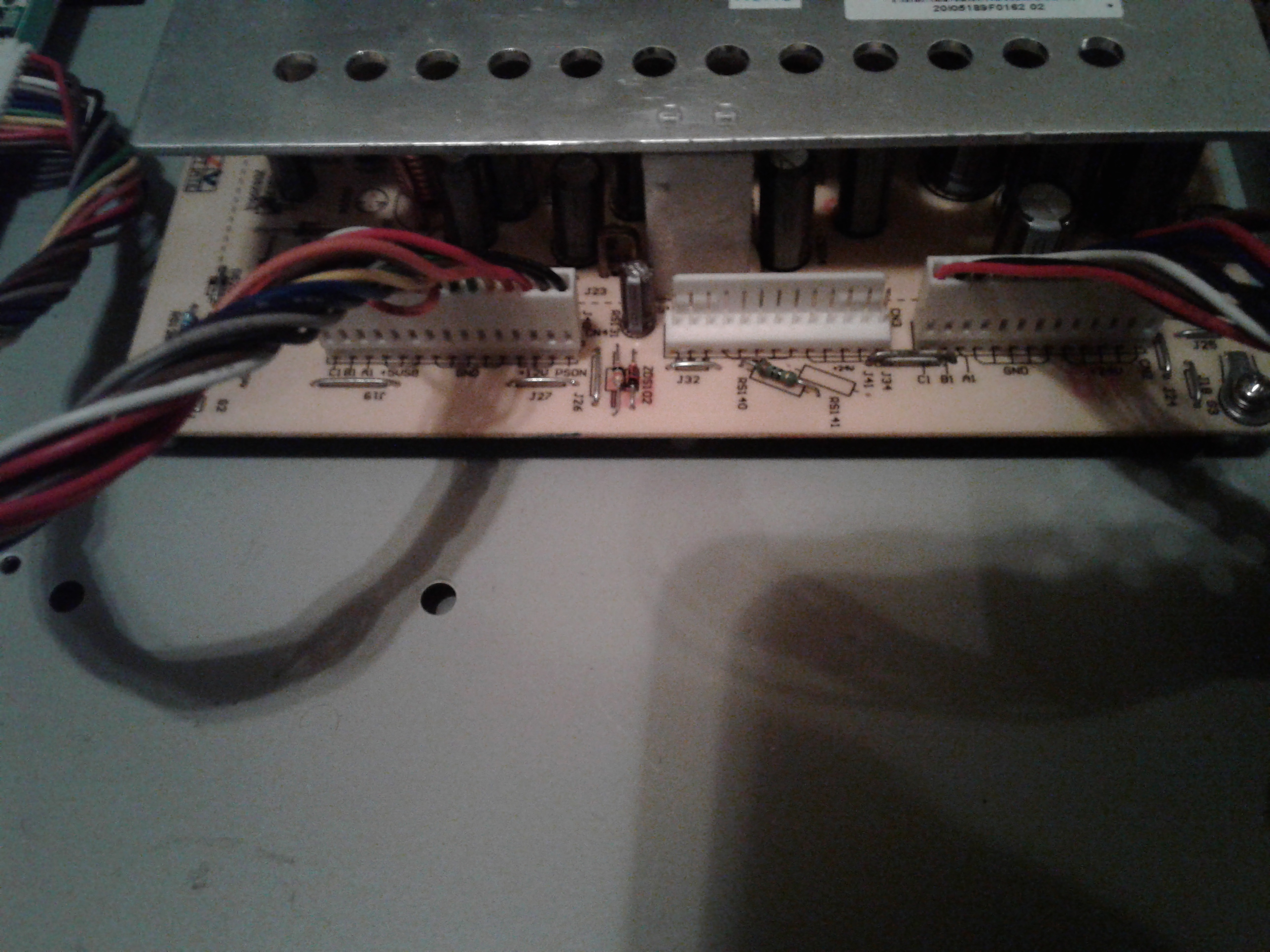

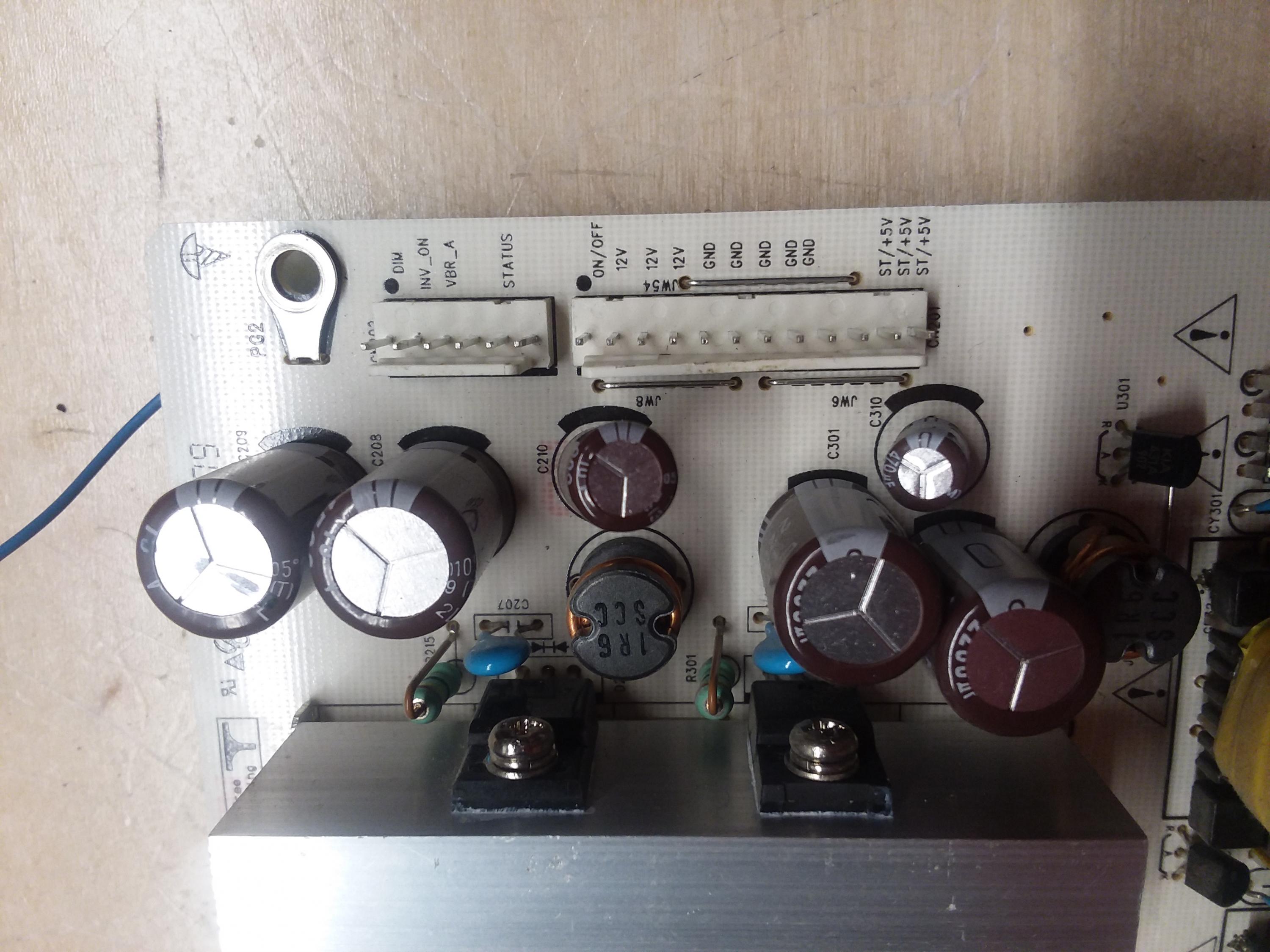

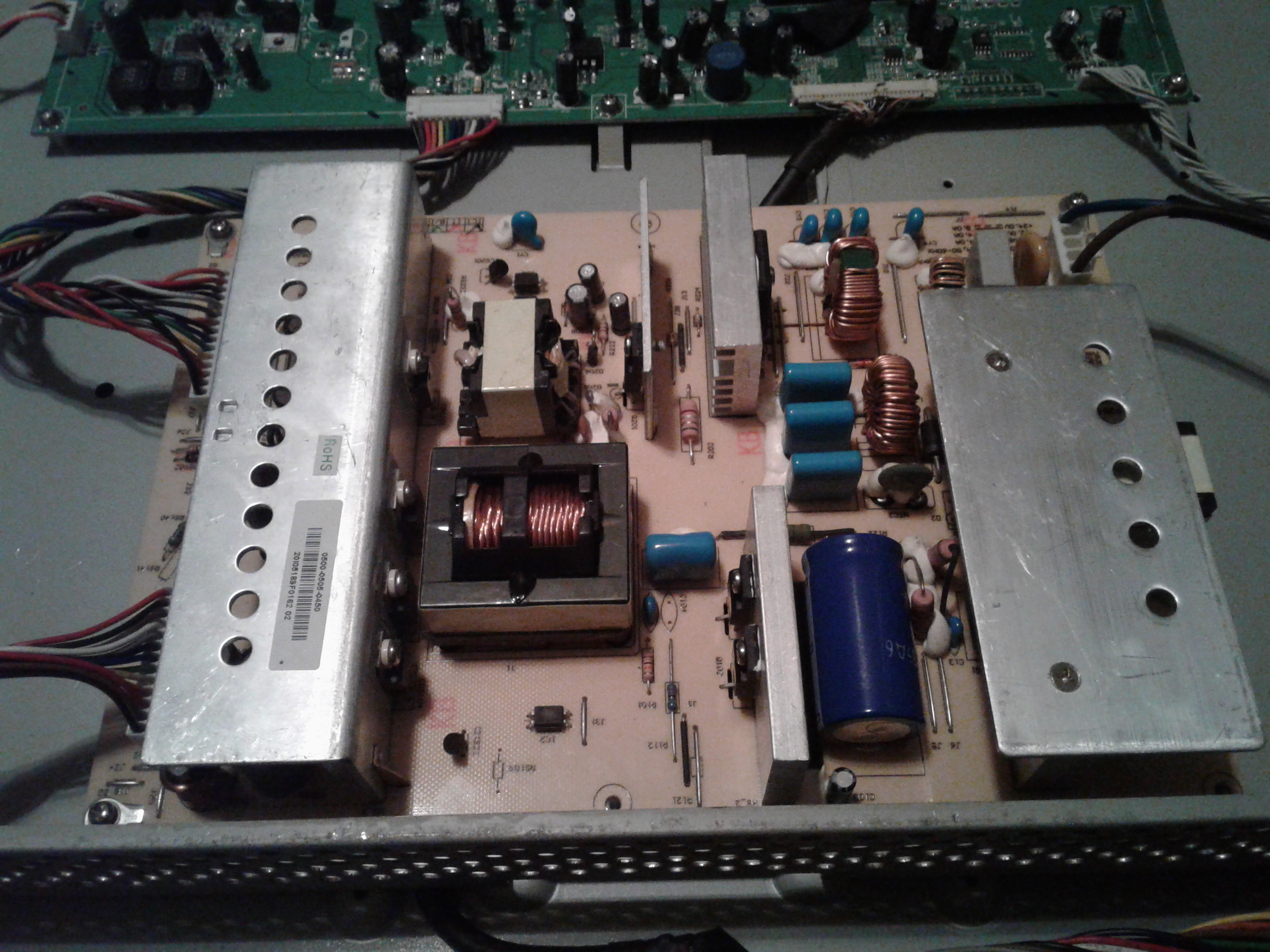

I'm working on the power supply out of my 40" Vizio and I have a question regarding the voltage outputs. At this point with the board removed from the TV and on my bench I have my 5v standby (actually this board has 3). As I understand I need the "power on" feed from the logic board to turn on all the other power outputs on the power supply. Is it possible to jump the 5v bypass pin to the "power on" pin to turn on the power supplies other voltage outputs for testing? Thanks!

It will a lot to see what we are dealing with.
You should use 470 ~ 1K for jumping the PS-ON pin and the 5VSTBY pin in case you jump the wire to the wrong pin.Never stop learning

You must remove the cable between the power supply and the main board first.Never stop learning
