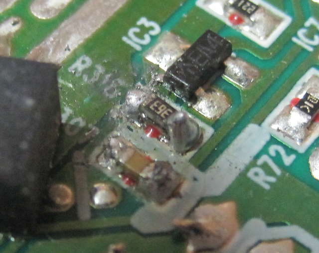

                                  AHA! I think I found the parts that I need to change to adjust the voltage on the xbox PSU... though the %#&*!@$ stupid @*()$#@(% chip manufacturer of the #($(#@%*#^ supervisory chip did not *(#%$@% clearly specify the %*(%# specifications of the OVP input...GRRR... However it minimally won't cut out under 13.4V so I probably can get it to 13V without modifying the OVP, above that might get into the risky zone depending on how lucky I got with the chip.
                                  The other possibility is to remove the chip, but OCP is also handled by this circuit.

                                    Re: Ham/CB/other transmitter radios... linear vs switching PSU?
                                    SUCCESS! With some risk of the OVP failing... at least it worked for me luckily!
                                    I have: Microsoft XBox PSU Model HP-AW175EF3 (HiPro made in China)
                                    Noting that the resistors on the board are all glued and soldered, I figured the best way is to parallel a resistor.
                                    I paralleled a 36K resistor (it's what I had in my junk box...) to the existing R318 on the board. I got a resultant voltage of ...
                                    13.73 volts (unloaded)!
                                    Close enough! This should be excellent for a car battery eliminator. Now I need to have a connector on the output that's actually usable...
                                    I need to work on my SMT rework skills... or actually have some good flux or something.

                                        Could you please post exactly what you changed to make work
                                        Reference number that are on the board
