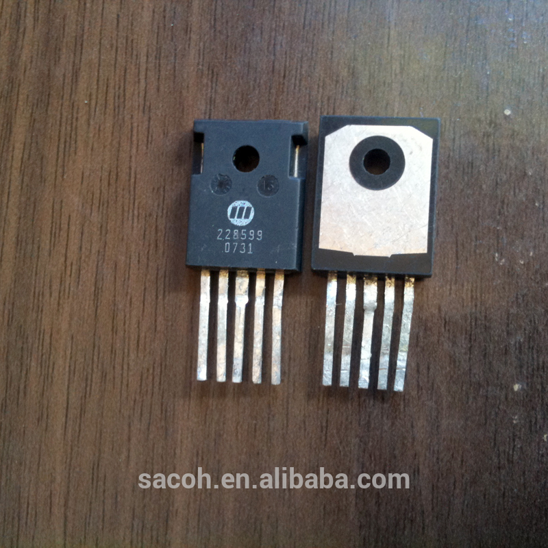

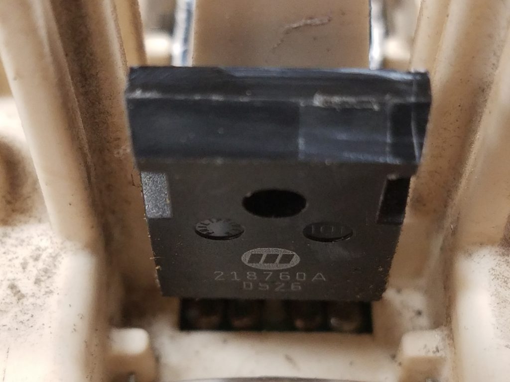

                    I Also Notice that PM1 Has Miller Part # What Could it Be? Seems to be the only proprietary #'d part.
                    My Personal Blog
                    • KG7AMV
                      • Jan 2013
                      • 41
                      #30
                      Re: Miller 375 Plasma Burt Cap..
                      I Also Notice that PM1 Has Miller Part # What Could it Be? Have not seen any Other Proprietary Parts on The Board.

                        #31
                        Does it have 4 legs or 5 ? it could be similar to the ALFET ALF08NP16V5 but this is a fet, the schematic shows similar but with transistors. So it's a TO-247-5 package
                        You could use Go Advanced and attach the documents , that way all the pictures don't have to download each time we go to the thread,

                          #32
                          5 legs..

                            #33
                            I did find a similar item on alibaba

                              #34
                              Originally posted by KG7AMV
                              Yea, I also hate parts labeling like that..
                              That isn't a Miller stamp... Maybe Microchip, Micrel etc?

                                #35
                                The logo appears to match that of in the schematics....
                                This device seems to be some two way insulated gate controllable bidirectional diode... weird.

                                  #36
                                  There is a bit of information here https://www.elektroda.pl/rtvforum/topic3329021.html
                                  Here is a translate of the miller reply to the person
                                  I wrote to Miller and here's the answer:
                                  Miller part number 218760 is a proprietary part not available as a service item. There is no third party source for the part.
                                  The subject is closed. Thanks.

                                    • eccerr0r
                                      Solder Sloth
                                      • Nov 2012
                                      • 8711
                                      #38
                                      The only test I can come up with for the 218760A is to ensure there's no connectivity between pins when it's out of circuit much like a MOSFET. Otherwise probably SOL other than getting another from Miller if it needs to be replaced.
