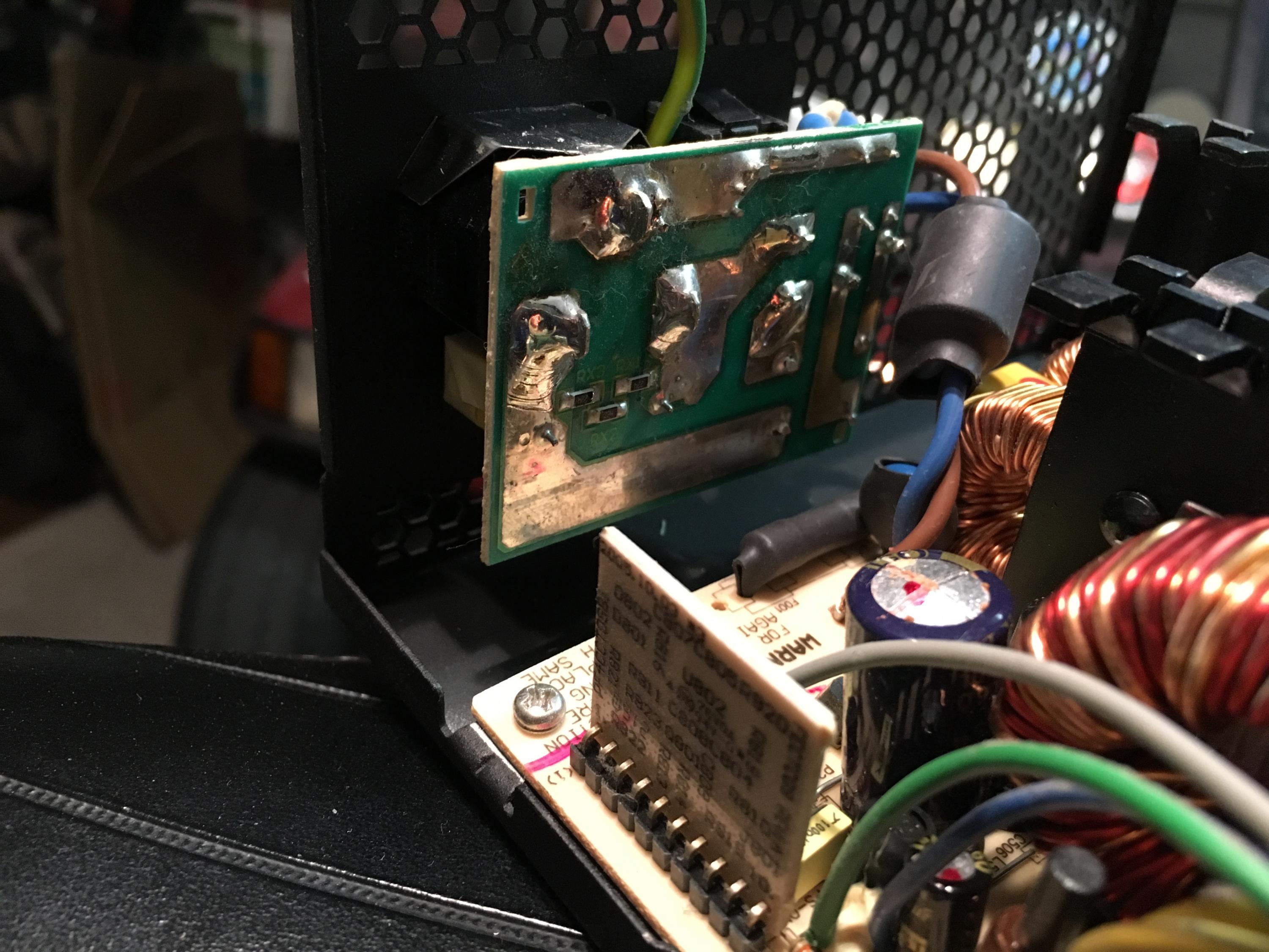

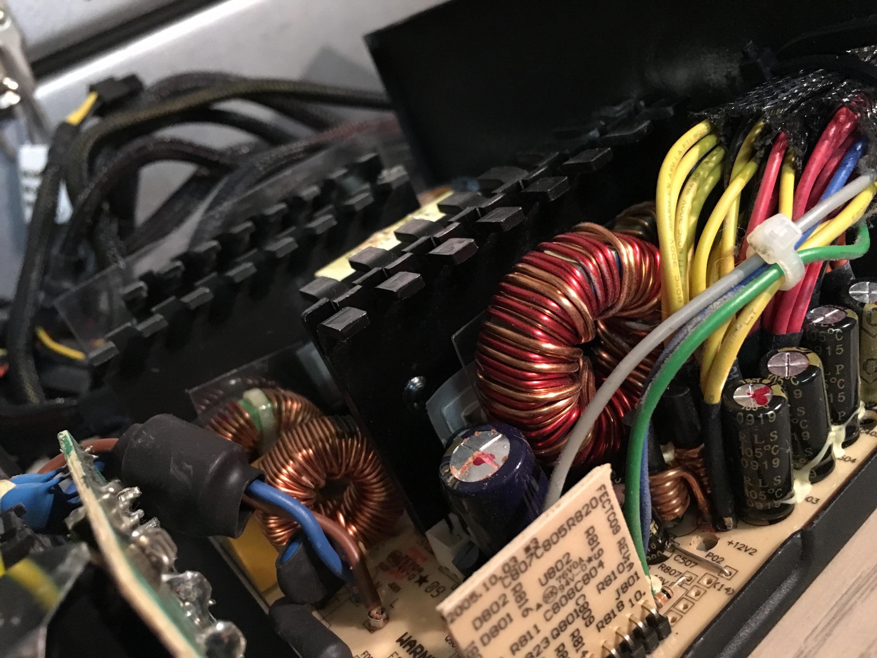

    I've got a 400W Corsair that works fine. But upon blowing out bunnies I see one bad cap, bulged a bit, and I was thinking if I replace it I may save other caps and the unit itself.
    It's had a lot of use, maybe 6 years and been 'on the shelf' for 1.5 years now. All measurements are w/in spec.
    Think it's worth replacing the one cap or just use it again until it fails? As I understand it modern mobos have built in protection from bad PSU's.
    Read thru a third of 500 hits on a search and nothing quite like my situation so far. What do you think?
    Thanks,
    Mac

    replace any bulged caps asap.
    i'v never seen a motherboard that cant be slowly cooked or simply blown to shit by a bad voltage from the psu.
    specially as chances are the bad cap is for the 5v standby line that runs 24/7
    upload some photo's

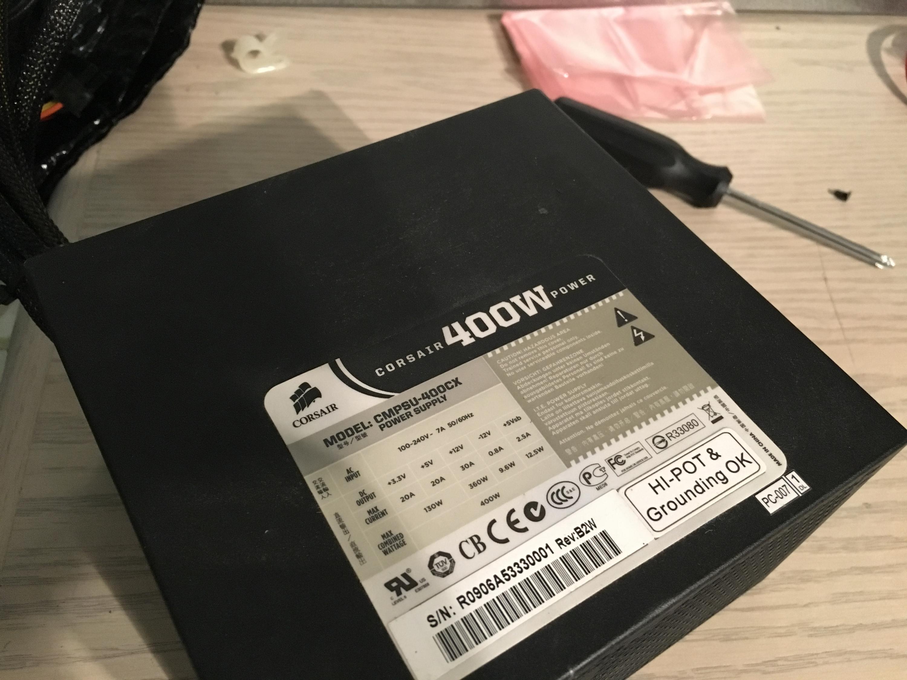

      Here's what that one cap looks like, as well as the unit.

        yep, she's pregnant all right.

          Yep, looks like the caps (at least what can be seen in the pics.) are OSTs (mediocre brand at best) as well, if you don't replace them all now chances are they will fail in the near future (since all the caps are the same age and brand if one failed the others are likely to as well).

              Why was the first thought I had the Original CX400??
              Well, maybe because its around 10 Years Old.
              Anyway, that's an RLX one, right?
              Ultra Low ESR one??
