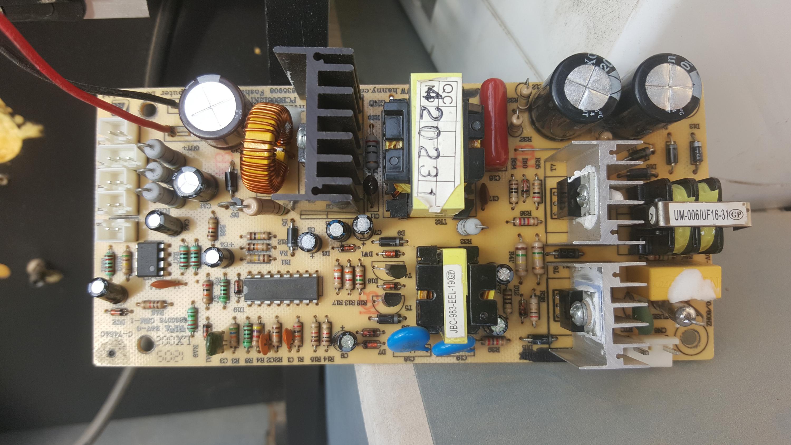

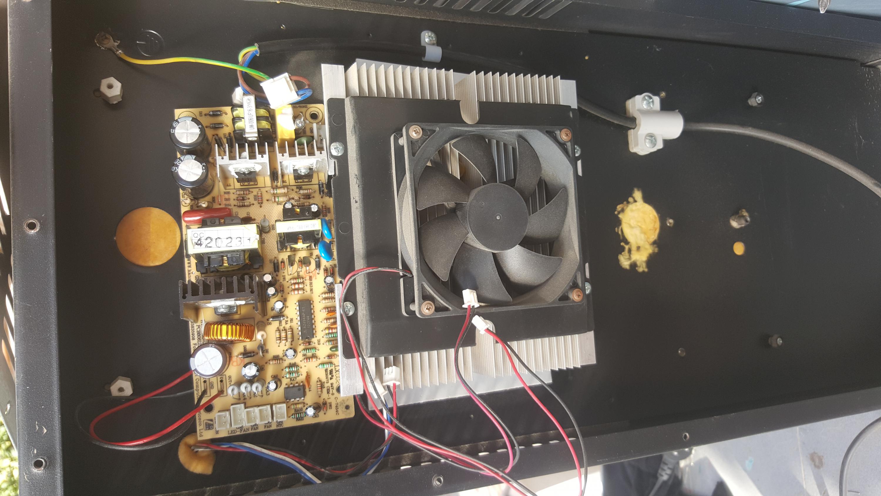

    Hi everyone,
    I have a wine cooler that I suspect the transformer is buzzing.
    How can I test the transformer to be sure that it's the culprit (I have tested it for resistence and it was fine, no shorts).
    Is there another test?
    photos attached.
    Thanks.

    Re: help with wine cooler-something buzzing
    my suspect would be the choke coil next to the heatsink.

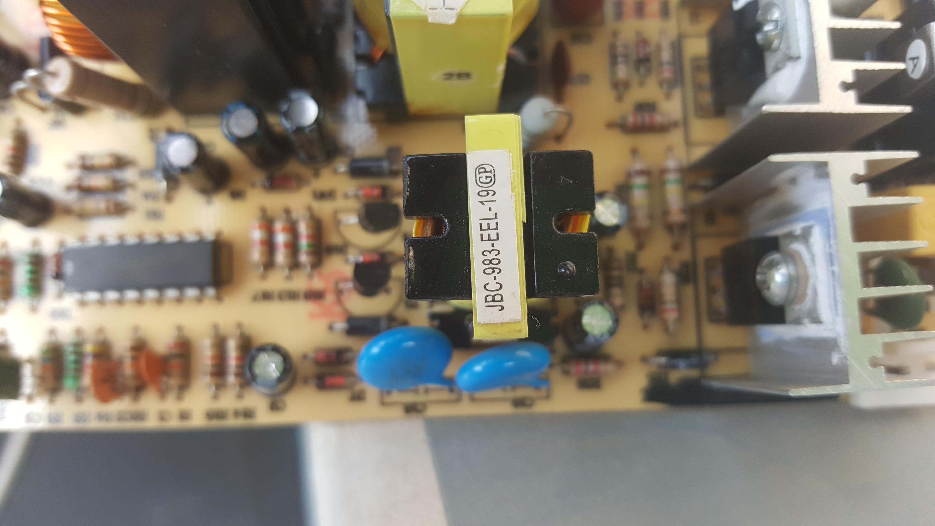

              Can you mark it please?

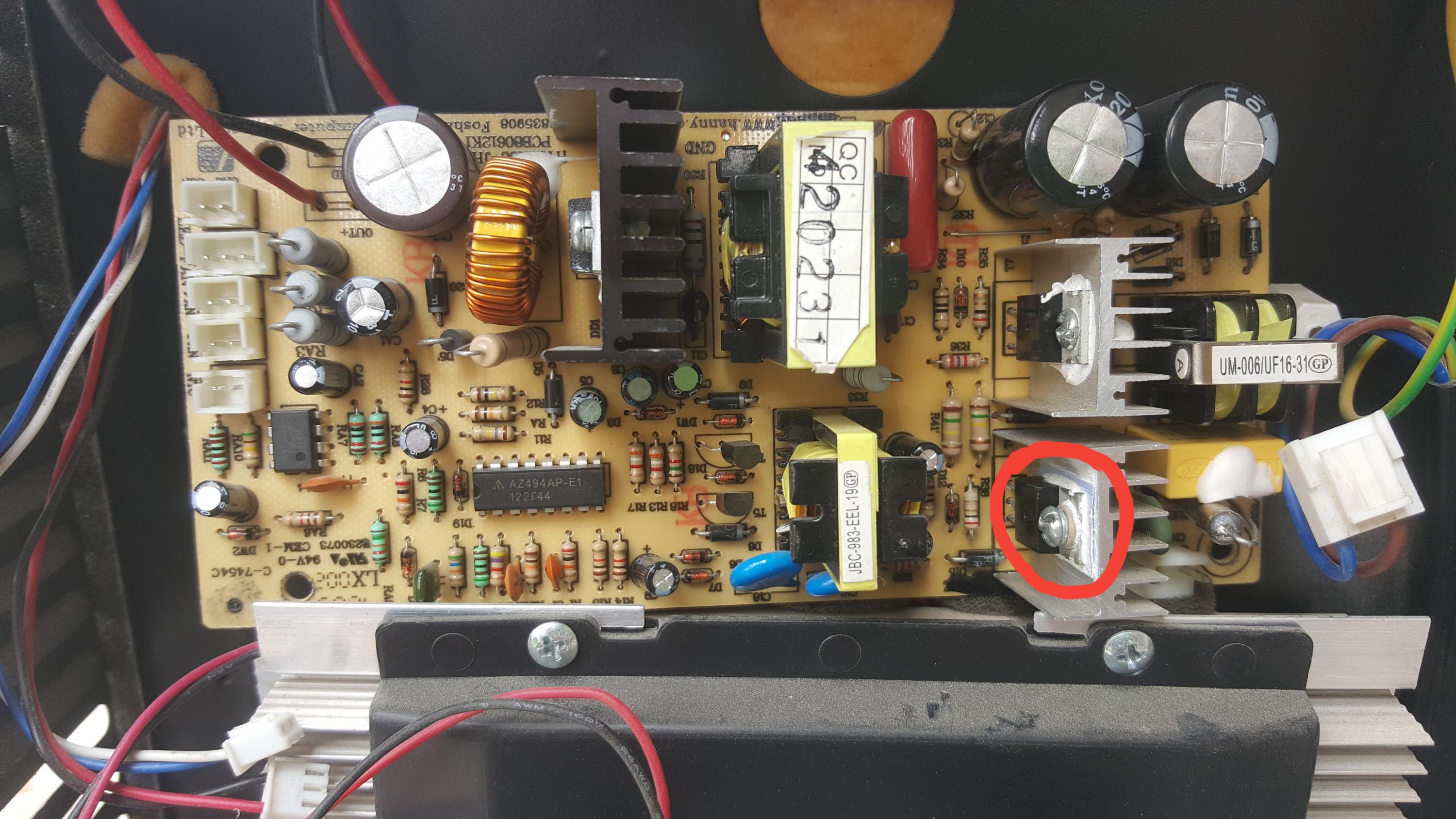

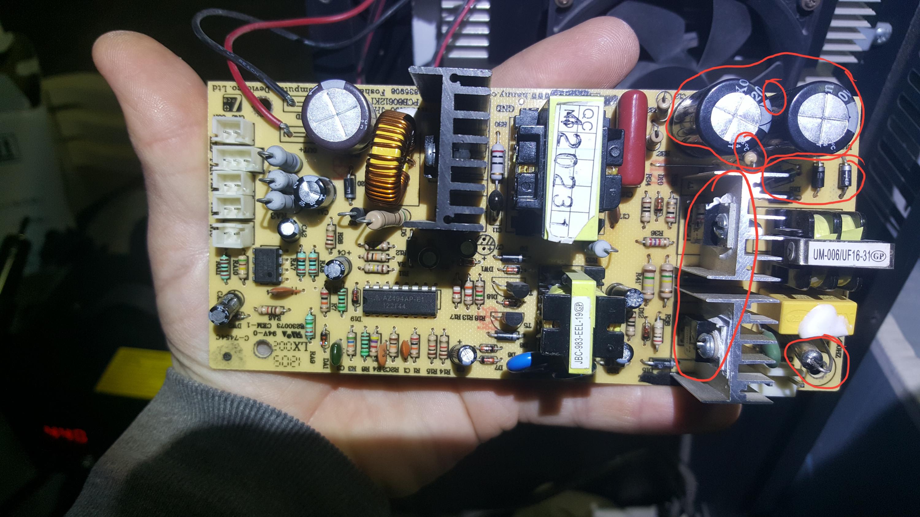

                One more thing I have noticed that, one of the transistors (13009-2) on the heat sink is getting very hot while the other one (which is the same one) isn't getting hot at all.
                Circled in red.
                P.S. I have replaced both of them, replaced a few caps, diodes, resistors and still, the transistor is getting hot and I hear buzzing on the transformer.
                  Does the fridge work? Sounds like there is a high load on that transistor. Maybe DL the datasheet of the AZ494 and probe around it? Can we see the bottom side of the board? Can you circle all the parts you have changed so far on the pic?
                    the fridge work but the display is flickering.
                    parts that I have changed:
                    2 big caps, 5 diodes, 2 resistors, 2 transistors and a fuse.

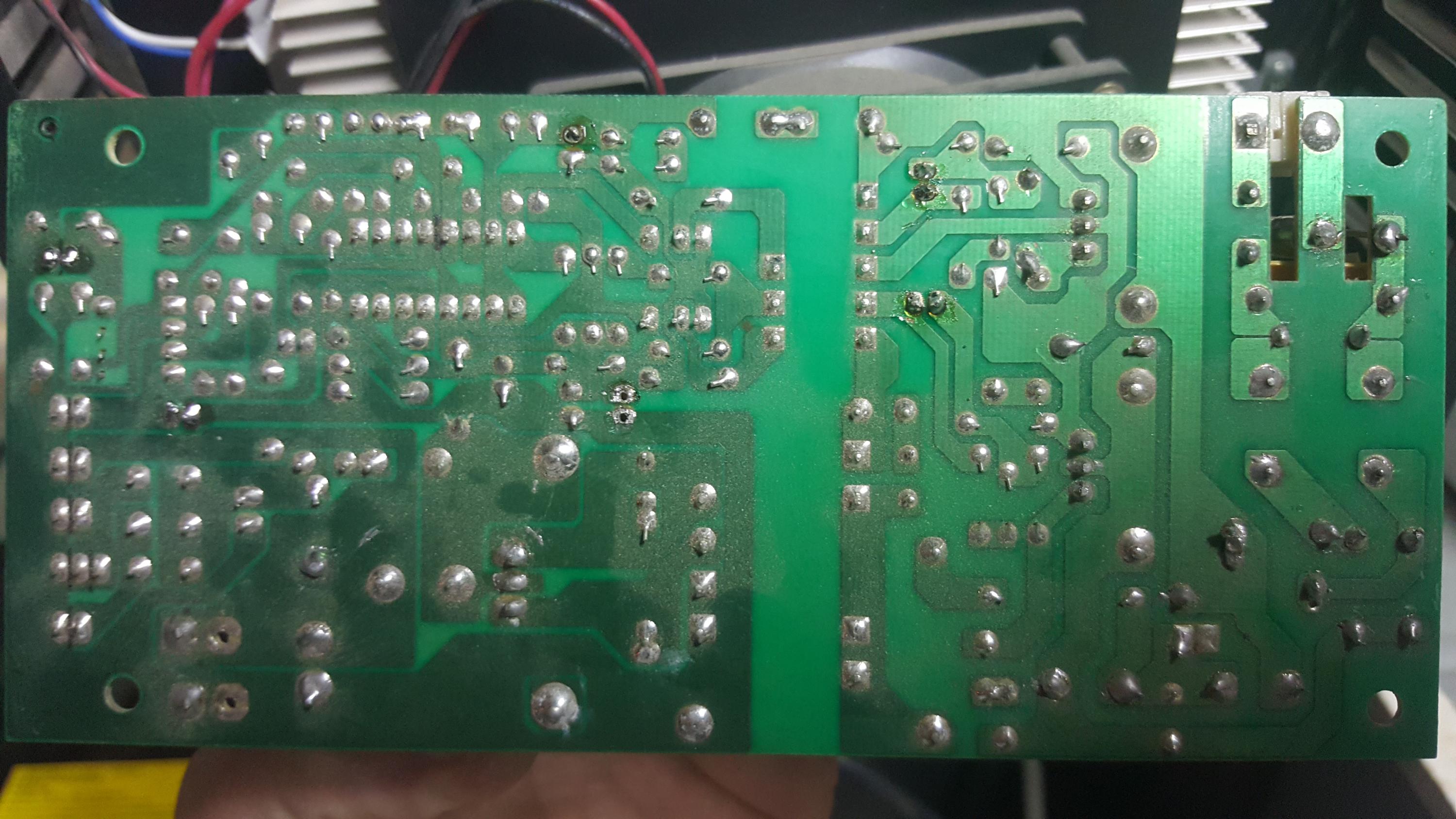

                          I was just going by the bottom of the board and it did'nt look like the caps like C4 and the 2 between the ic and heatsink had been out
                            Then it probably showed a good reading while in circuit.

                                      That's why I bought it in the first place. I love fixing things (at least trying to fix). even if I fail, each and every time I am trying to fix something I feel a spark in my heart and it's exciting me every time.
                                      I fixed 2 wine chillers successfully and even though I am spending lots of money on the components I am thrilled every time I touch electronics.
                                      I can't find a transformer for a descent price over the internet maybe someone can help me, I think that it's the culprit.
                                      The part number is JBC-983-EEL-19
                                      Thanks a lot guys.
