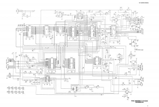

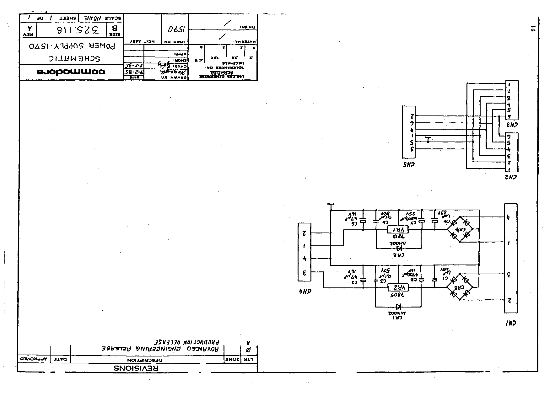

        Thank you for your help. Ive had a good look at it and traced the 12v rail through the PCB and listed all the components it travels to. There is surprisingly few mainly resistors and few ceramic caps and 2 transistors. I hope its one of these because otherwise it would be a faulty IC. I just today found a schematic for the drive. Can someone take a look at it and suggest where its most likely to have happened. The two Transistors I was talking about are Q2 & Q3.
        Schematics attached

          Have you tried a different load on the 12 volt line of the power supply to confirm it is not the problem? IE 25 ohm 5 watt resistor, should draw about 1/2 amp
          with the drive connected did you check the voltage going into the 7812/LM340 regulator?, if it is droping the output to .5 volts the reg. ic would be getting very hot also.
          I cant make out the second schematic
          I found the schematic on line and I doubt q2 OR Q3 could cause the problem, the base's are connected to the 12 volts through 4.7k resistors, a short after the resistors would not kill the 12 volt supply
          You could have a shorted motor, can you disconnect CN7 plug?
          You could have a shorted U7, disconnect one end of L3
