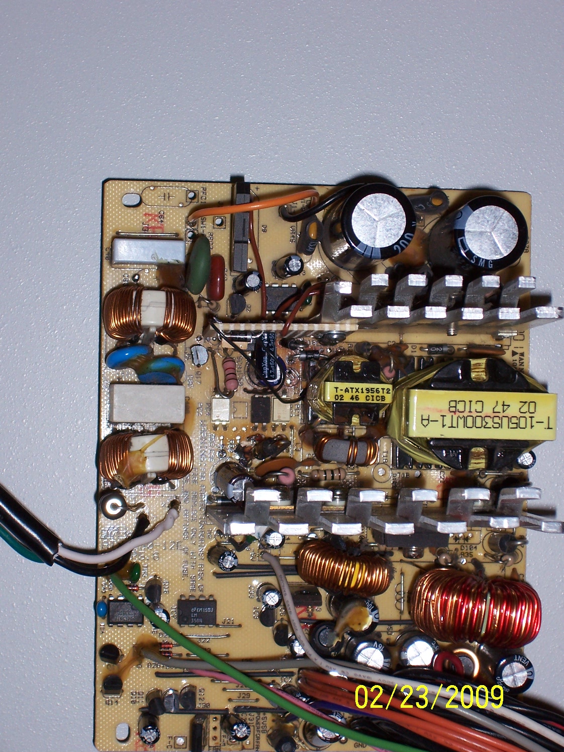

    Bestec ATX250-12E up and running!
    My project was a bad Bestec power supply with blown 5VSB. The buldging 220 Mfd capacitor C50 was starting point. That plus a couple of other parts, and the 5VSB line came back to life at 12 volts. I changed several other parts, but could not get that switcher to slow down. In process, it took out the filter caps, the PWM chip, and damaged the supervisory chip. So I decided that this PS had a poorly designed 5VSB circuit. I removed the parts associated with this 2 transistor switcher and replaced it with a Fairchild DM311 chip. Had to replace the PWM and supervisory chip, along with the newly damaged filter caps. But results were spectacular. The 5VSB is now rock solid at 5 volts. The main switcher works fine. 25 ohm resistor at pin 1 of optocoupler PC2 ran very hot. Now at 240 ohms and running cool. The 620 ohm resistor R23 in the switcher was also running hot - it was eliminated. So the 5VSB is running much cooler, and the DM311 chip gives overvoltage and overcurrent protection which wasn't there before. I will now attempt to show photos and my hand drawn schematics.

          This power supply was purchased CHEAPO as-is and was not working. When I took it apart, there was evidence of burn damage around the 5VSB transformer, a couple of buldging capacitors, and the 5VSB was dead. I tried fixing the 5VSB without success, then re-engineered successfully. The only capacitors replaced (so far) were those in the 5VSB circuit.
          My take on the problem for this power supply - and many of the cheap power supplies like it - is a poorly engineered 5VSB circuit which goes overvoltage, or blows up and burns. Removing the cheap troublesome two transistor circuitry is not that hard, and the little add on board is not that hard to make.

            Reason for this burn up were badcaps. Bad idea to make electrolytic cap part of regulation circuit with certain types of IC or components.
            TEA2261 used two capacitors (2.2uF and oddly used 15uF both electrolytics, and they WERE 105C quality brown plastic sleeves, usually UCC). Both capacitors dry out and outputs gradually rises to the point where PSU shuts down (exceeds 200V on the B+ for flyback and SMPS shuts down when unit plugs in, or components fails or flyback or HV divider eventually fails due to short pulse of overvoltage during turn-on transtition from standby mode using hot side feedback and that two caps to run mode using cold-side feedback when customer turns tv on especially if SMPS didn't shut down on overvoltage (around 150V-170V does not trigger shut down in standby, the RCA CTC169 uses 143V B+ for both standby and run, the standby voltage is set with a pot resistor, the run regulation is on cold side with a pre-set pot via feedback transformer sealed during manufacture). Made lot of money on those.

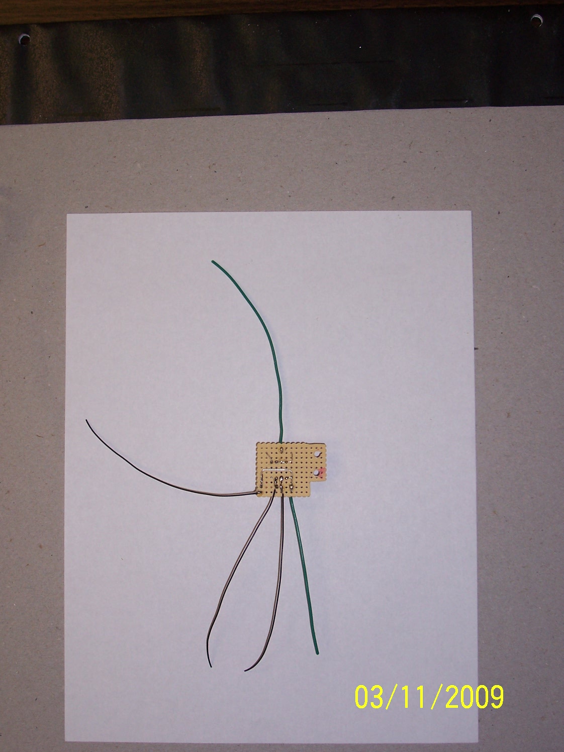

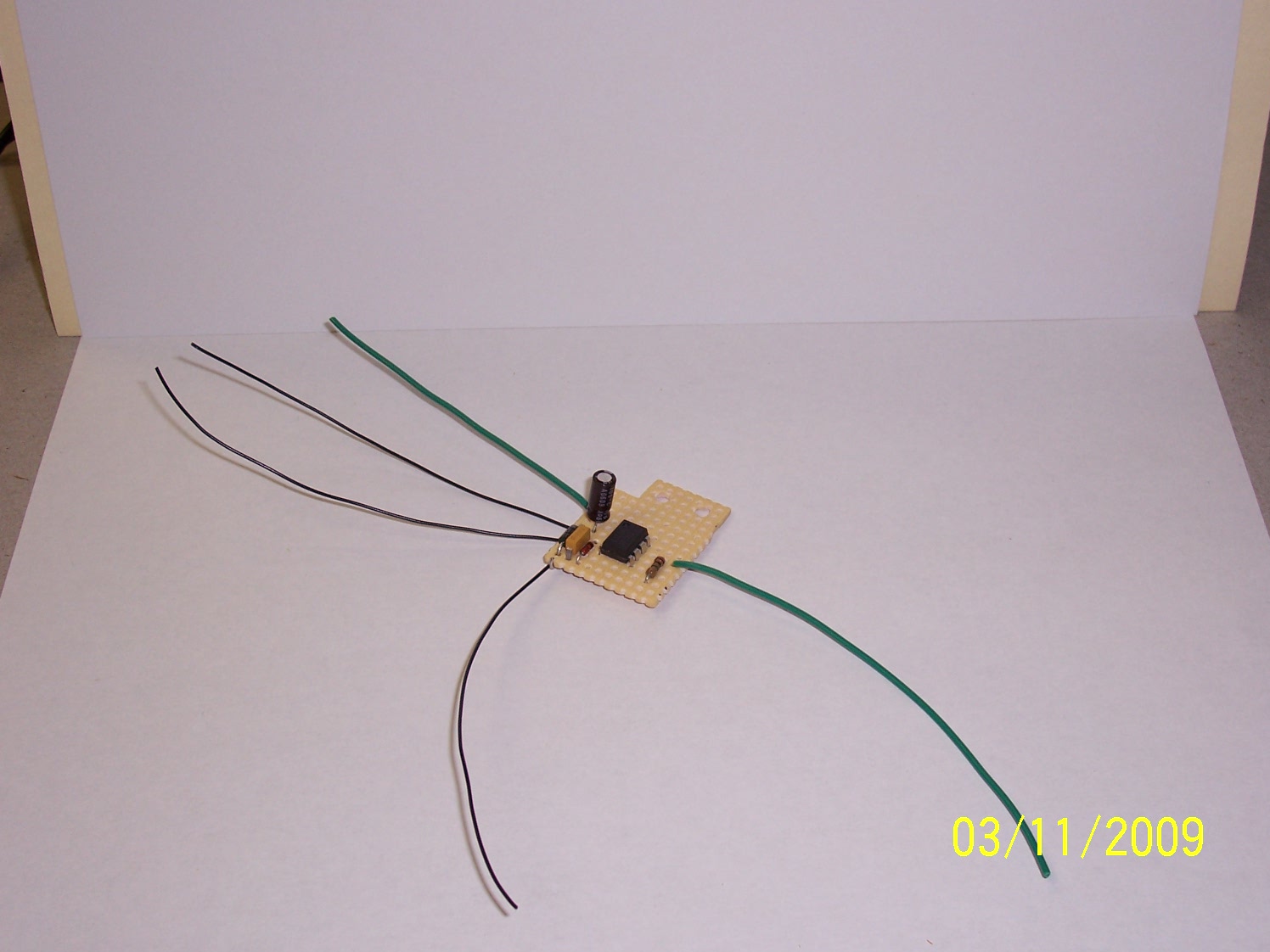

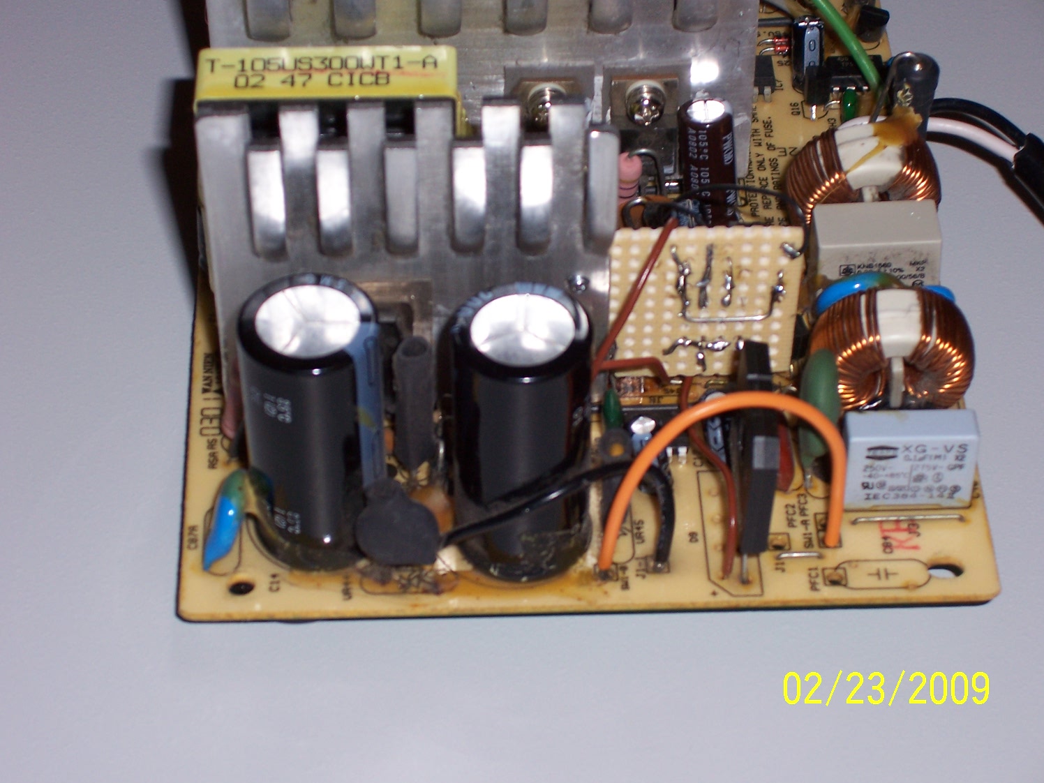

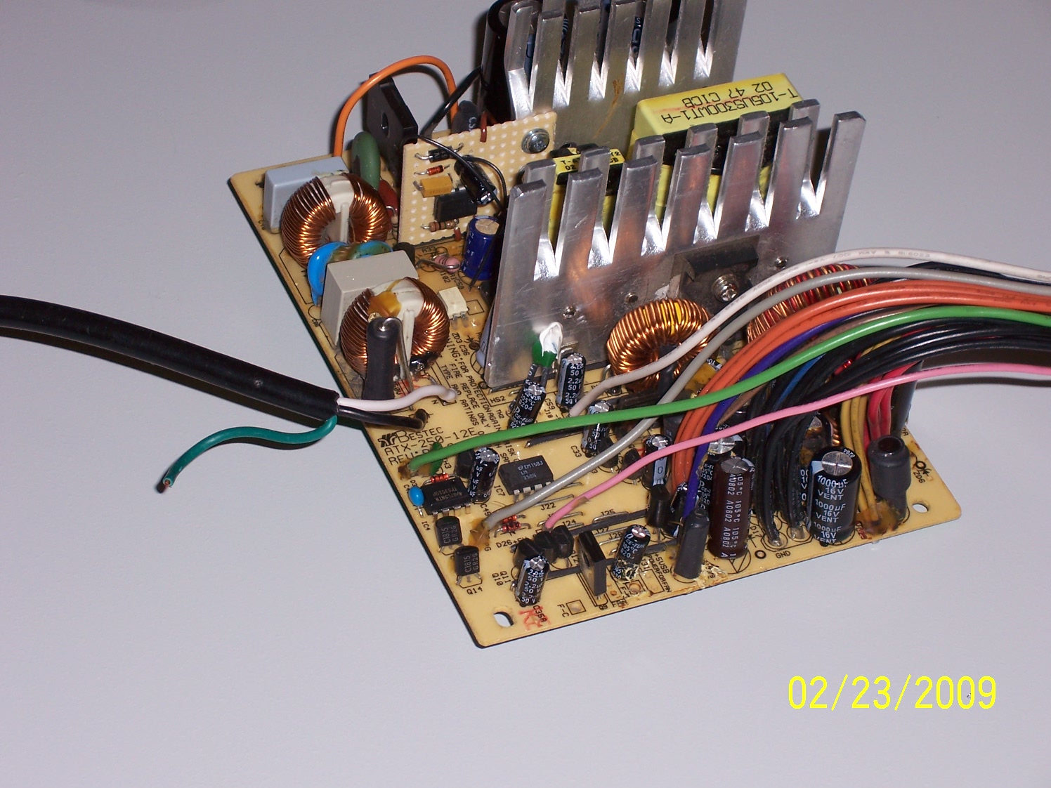

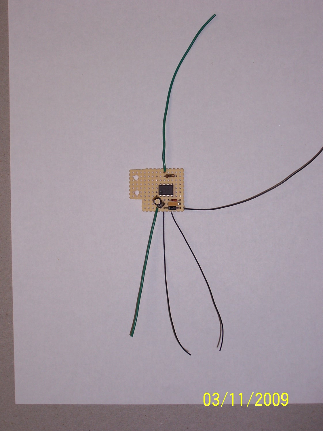

                  My question is - how can you know if the power supply you are purchasing has a decently engineered 5VSB circuit? Like the old saying, a bird in hand is better than two in the bush! I feel much more confident running this power supply with modified 5VSB than purchasing an unknown and hoping for the best.
                  I have put several days running time on it since modification - so far it is doing great.
                  Here is a drawing showing the eleven components which need to be removed. And photos of the added pc board with the new circuit - only six components.

                                  I have really enjoyed the discussion on this one. For anyone else who wants to try this modification I will post the remaining drawings I made. They are specific to the Bestec ATX250-12E but probably a similar pattern for other "cheap" power supplies. This one was cheap enough that I didn't have to worry about failing and losing any money. Best of all, I learned a lot - both from the project and from the discussions on this forum. Thanks guys.
