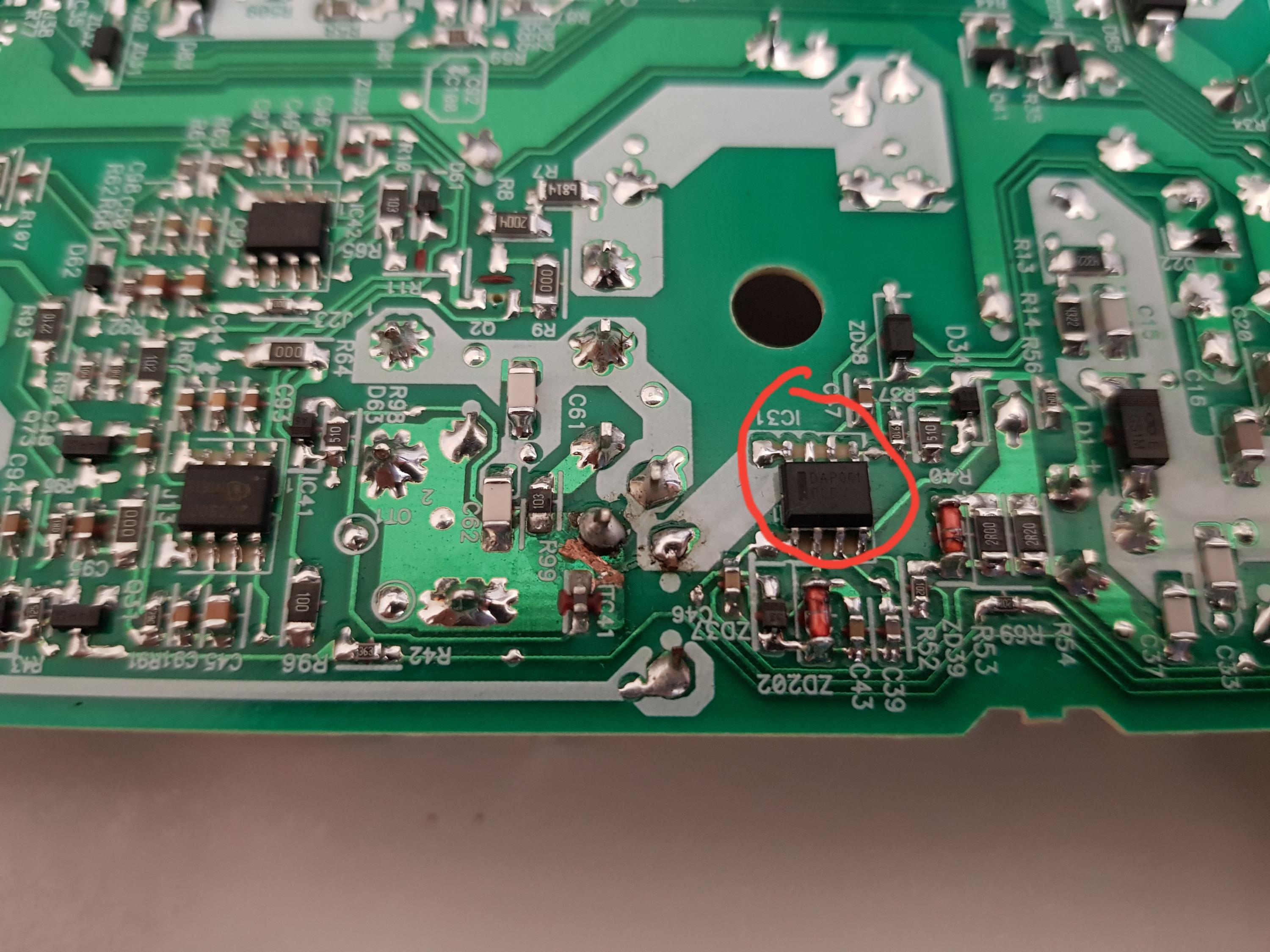

    Originally posted by momaka
    Looks like resistors R99, R98, and diode D63 at the very least.
    R99 should read 10 KOhms or less in circuit (or not more than 5% over 10k).
    R98 looks like a 51 Ohm resistor. Again, it should read 51 Ohms or less.
    D63 may or may not show a diode reading both ways, depending on what's in parallel with it. But it looks like there isn't anything, so if you get a good diode reading one way and nothing (infinite/open) the other way, then it's probably fine.
    R99 reads 9.86k ohms
    R98 reads 51.0 ohms
    D63 shows 0.024V in circuit with the leads on either way
    I have a broken ADP-240CR PSU that looks like it has a good 24N60M2 in it for a replacement, it has around 0.9 ohms between the left and centre pin and left and right pins, the centre and right pin have 0.2 ohms, is that ok?
    Edit: with the possible replacement 24N60M2 out of circuit, the readings are lower, from what was said in post #16, that is good?

          Re: PlayStation 4 ADP-200ER PSU repair
          That is what I expected, the Gate discharge D63 is connected in parallel with R98 (51 Ohms), it is typical set up for Gate discharge circuit.
            Do I put on the other MOSFET I have and test with the light bulb again?
                  Originally posted by budm
                  At this point it can be that the SMPS IC that drives the MOSFET has the output stuck high all the time instead of switching on and off.
                  Can you read the P/N of the SMPS IC?
                  Is that component IC31?
                    #29

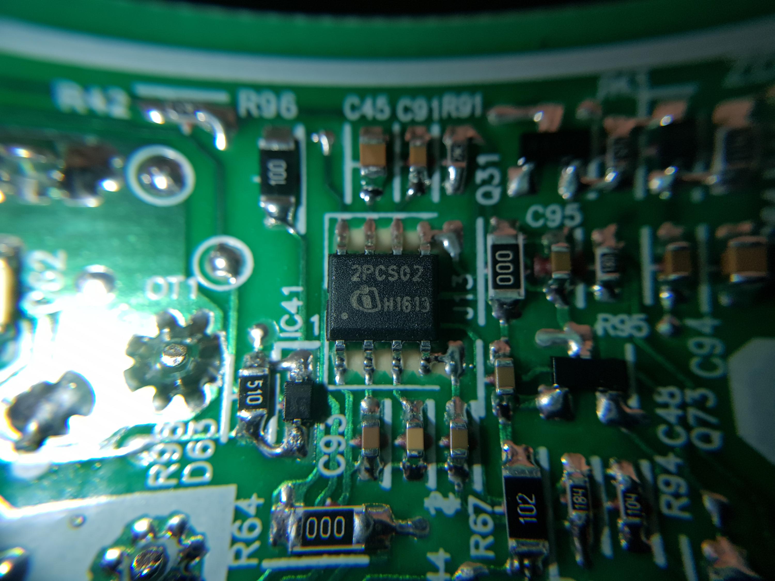

                    IC41, as you can see, the Gate pin of the MOSFET is routed to that IC via resistors and diode D63, R98.

                      #30
                      How do I test it?

                        #31
                        Do not worry about testing if you suspect that this part might be the problem I would highly recommend replacing it unless it is hard to find but I would looking for one
                              Check the resistance between the Pin 8 (GATE) and Pin 7 VCC just to see what you get, make sure to count the pins correctly.

                                #35
                                Pin 7 and 8 read 8.70k ohms

                                  #36
                                  Looking more closely at the pics you provided, it appears that MOSFET Q6 (the 24N60M2) is for the PSU's APFC circuit, along with diode D11 next to it.
                                  Try this: remove Q6 completely and apply power to the PSU through the incandescent light bulb. Does the bulb still stay lit all the time, or does it go bright for a second and then go off/very dim? If it stays bright, you probably have a short-circuit somewhere else on the primary side (i.e. not the APFC circuit). If not, then see if you get any voltage from the PSU's 4.8V standby rail. I believe you can find that on the white connector on the output side of the PSU. If not, it appears that C123 and the coil/inductor next to it should be connected to the 4.8V standby rail as well.

                                    #37
                                    That seems low to me and probably enough to bias on the MOSFET.
                                    You can check the Voltage between GND pin and Gate to see if you see steady DC of >2~3V or not, use the lamp in place still in this test.
                                    Or you can also GND the Gate of the MOSFET with 100 Ohms resistor and see if the lamp will not light up.
