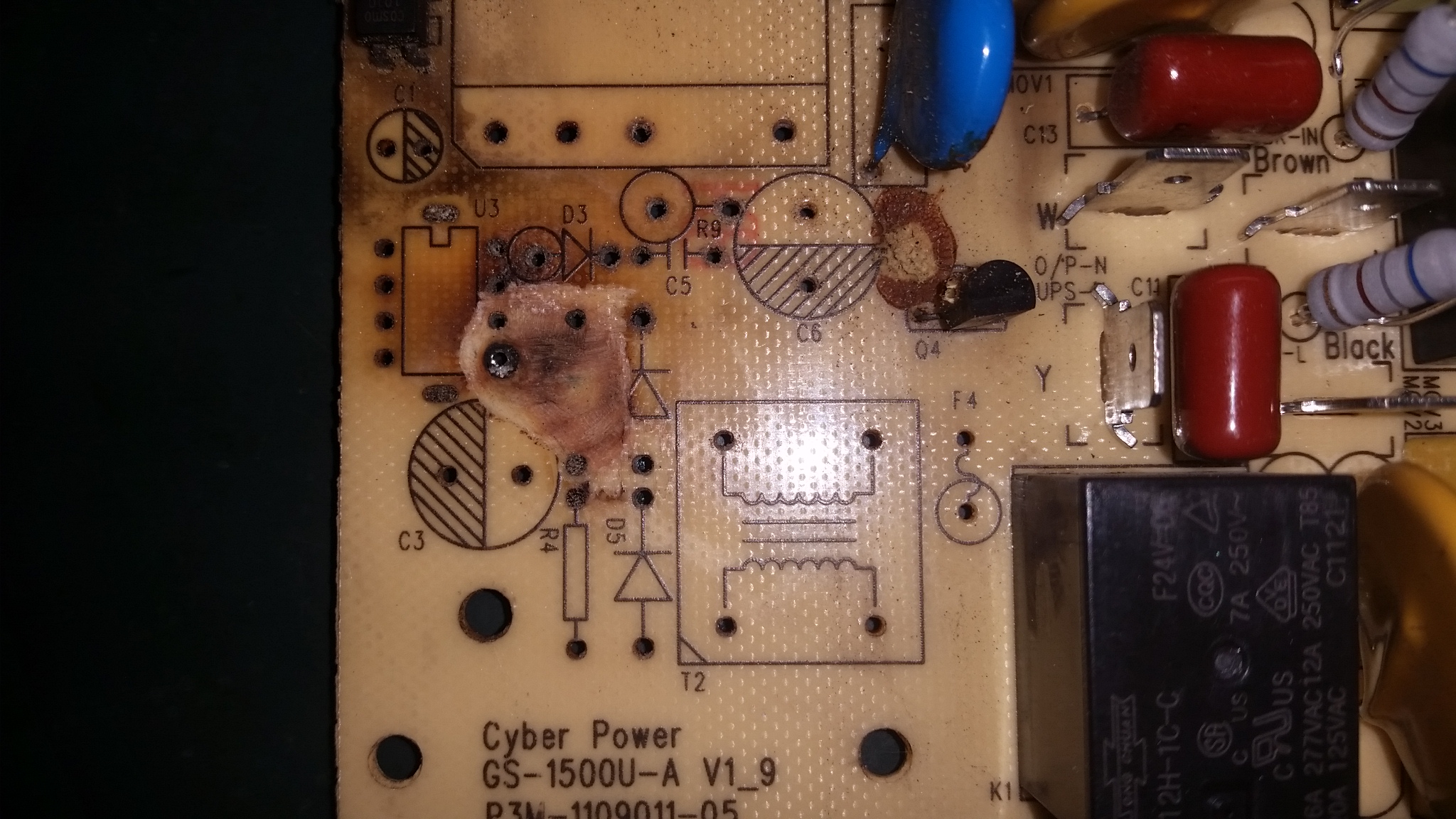

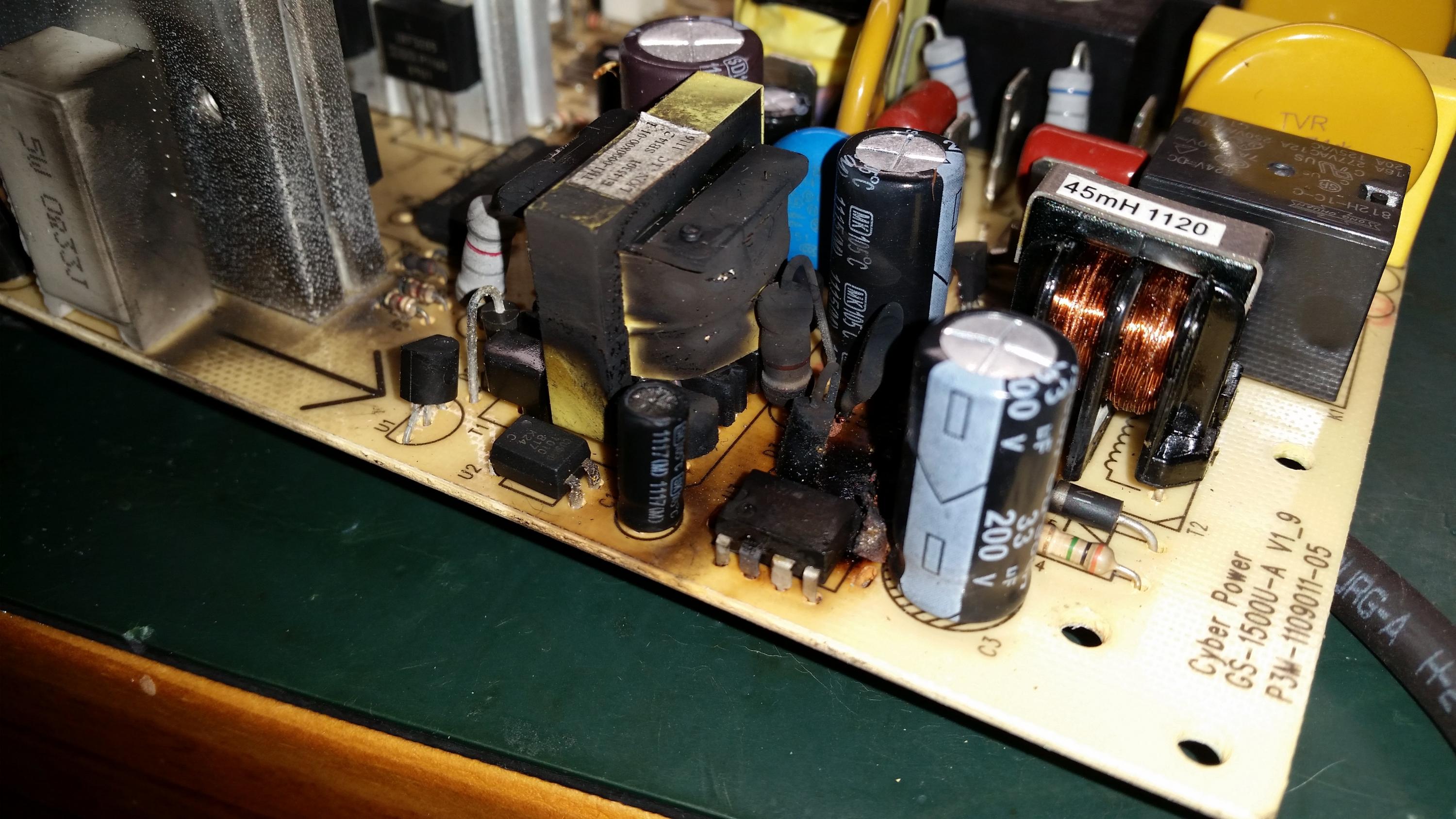

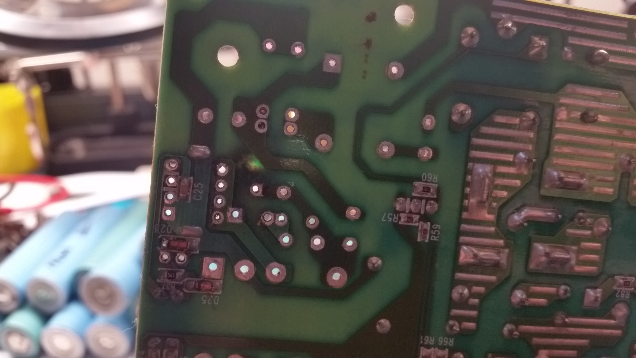

    My CyberPower 1500AVR endured after a long power instability in the past weeks, must have been on the way out. (about 7-9 years)The batteries no longer held a charge nor the UPS were charging them. Batteries are about a year old, but they are good and holding charge from an external SLA charger.
    I found thread 785895 and it helped determining what components were damaged.
    On this unit the charger circuit just got overheated to and extent I could not see was components where what.
    Like I wrote in that thread the traces are in good condition and the UPS was powering up and providing protection until the batteries no longer held a charge. Because this board is hard to get a replacement, I was thinking of repairing the section that got damaged by removing the components and filling with epoxy resin and re-drilling the holes. Also I have a stock of capacitors that if all works the ones on the board will be replaced.
    I like this unit better than the new model. I think it can be accomplished. Opinions Welcome.
    A Picture of subject is always Welcome

    Yeah try cleaning it with what's in english called a "white spirit" and see how it looks like beneath the condensed plastic

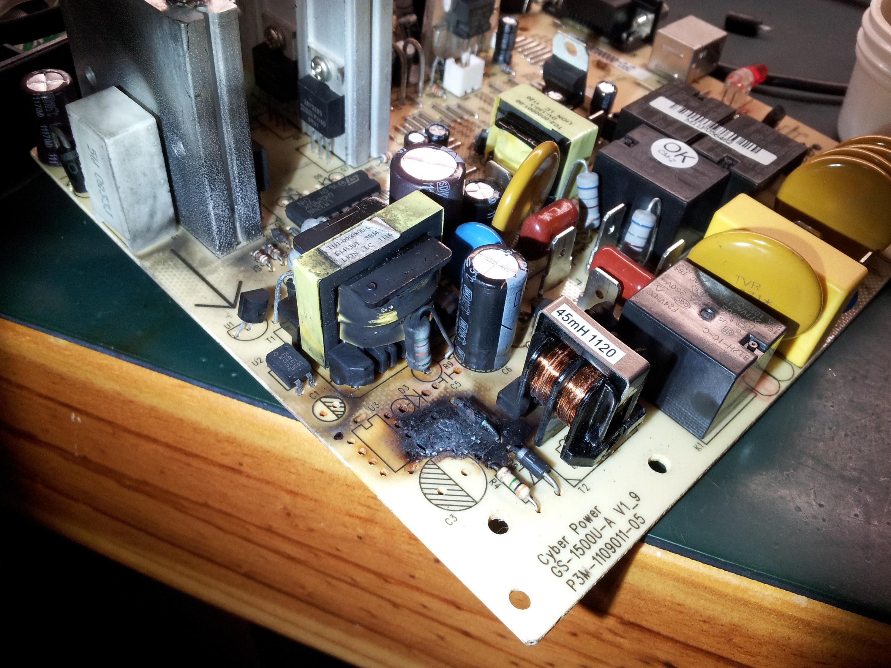

      Hello crash-cyberdrive,
      I have to say that you are brave in regards to taking this on.
      I would check the transformer to make sure that it hasn't gone open circuit before you start.
      You'll have to test quite a few components, both on the primary and secondary of the transformer.
      You MUST ensure that you remove ALL the carbon off the PCB, especially where the carbon is extending between two or more components.

          Re: CyberPower 1350AVR - Repair
          By looking at this PCB material, I don't think would be too good to use "white spirit" (aka Mineral Spirits"). I could try in a piece I have very similar to the one I working on.

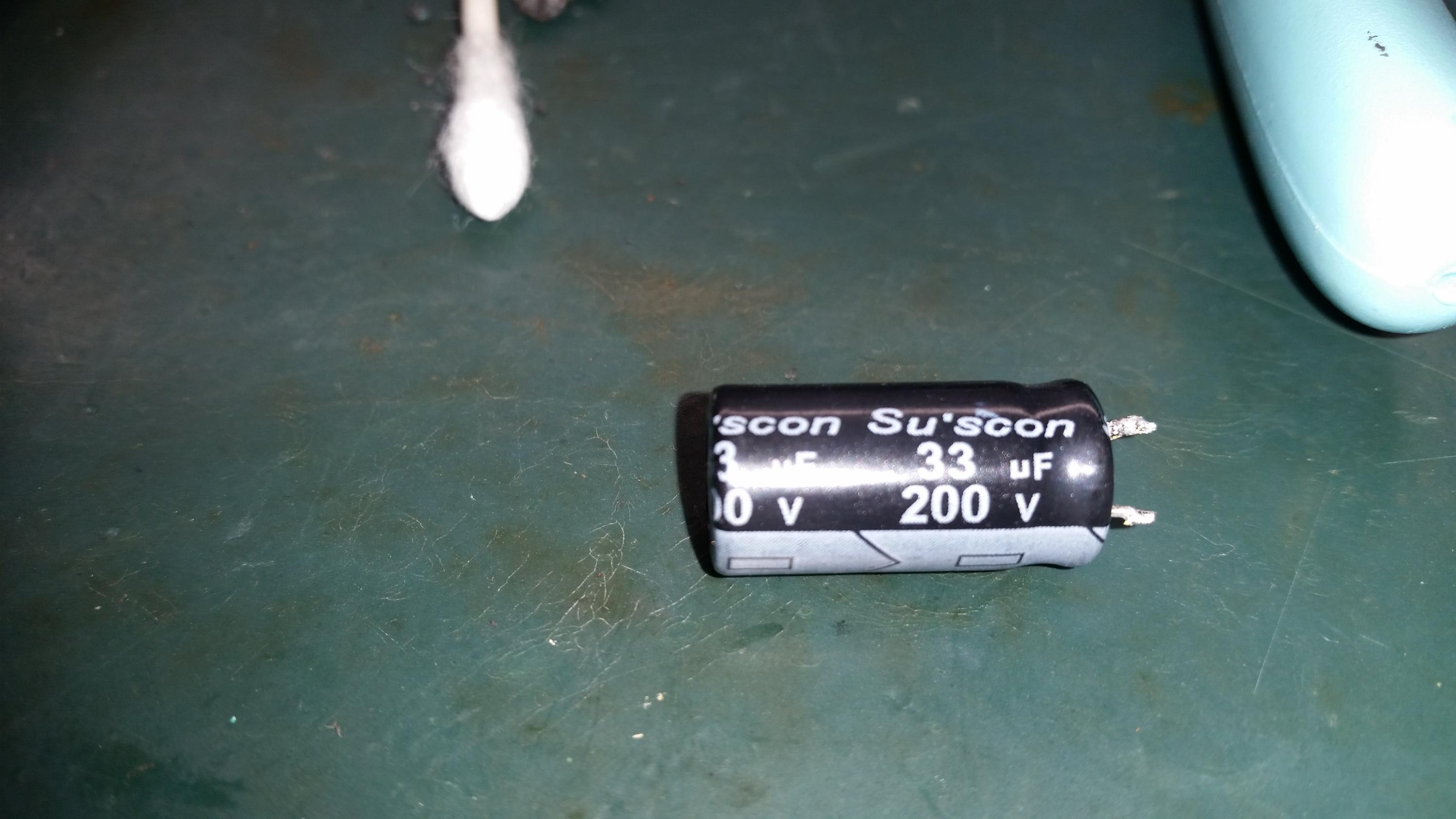

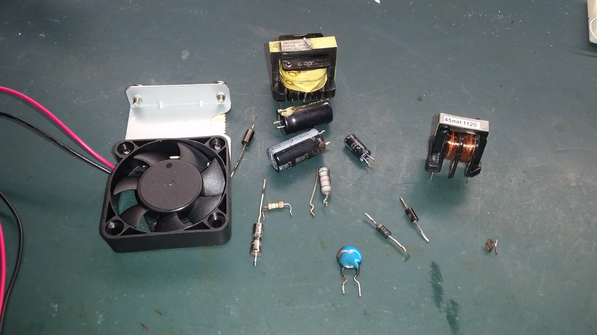

          All related components where removed and tested a F4 fuse found blown, C1 a 22uF 50v capacitor is way out of specs it gave a reading of 2.5uF@120hz the cause of damage.
          The rest was reading good but the surrounding components will be replaced as they where too close to the damaged area and are inexpensive.
          There is one diode D3 that I cannot make the number it is because it was on top of the heat source partially charring it. the only digits I could make out is 24

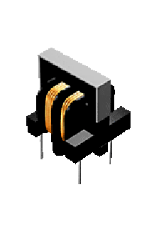

          Any tips on testing the transformers?
          T2 has continuity and read 1.2ohms on legs 3-4 and .5 ohms on legs 1-2, to me something is off; could be a choke and not a transformer? Could be me During the writing of this post I found T2 is a common filter choke and .45uH @ 100kHz on 3-4 and .55uH @ 100kHz on 1-2 not far off.
          I will be testing more of the critical components.

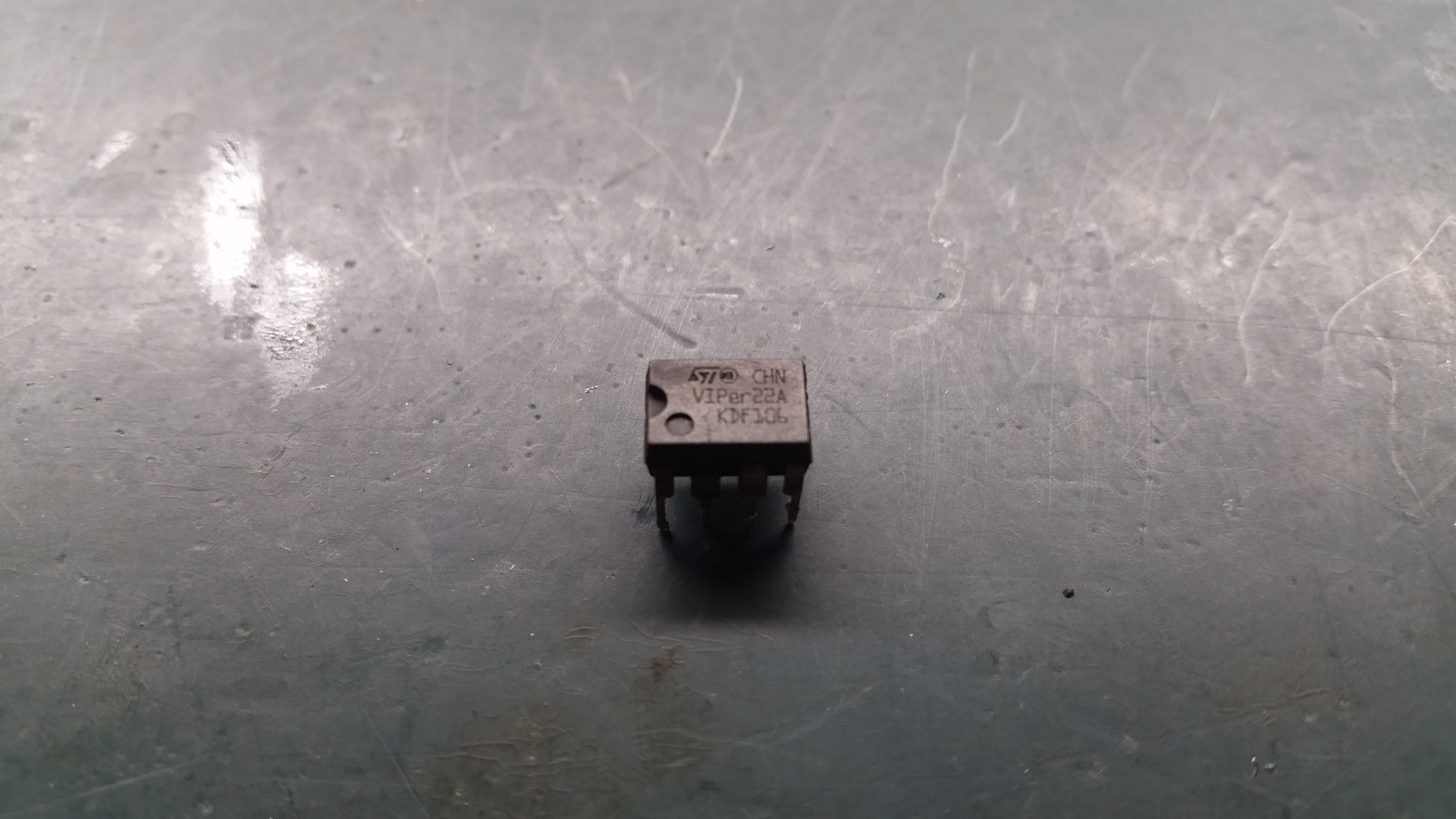

            Are you able to read the P/N of that SMPS IC at all? Viper22?
              Yes, luckily I was able to read "Viper22A". STMicro discontinued the one that has been removed but the substitute for is "Viper22A-E". I have been reading datasheets to try to determine what has been enhanced. But I think overall it will work with the circuit.

                Re: CyberPower 1500AVR - Repair

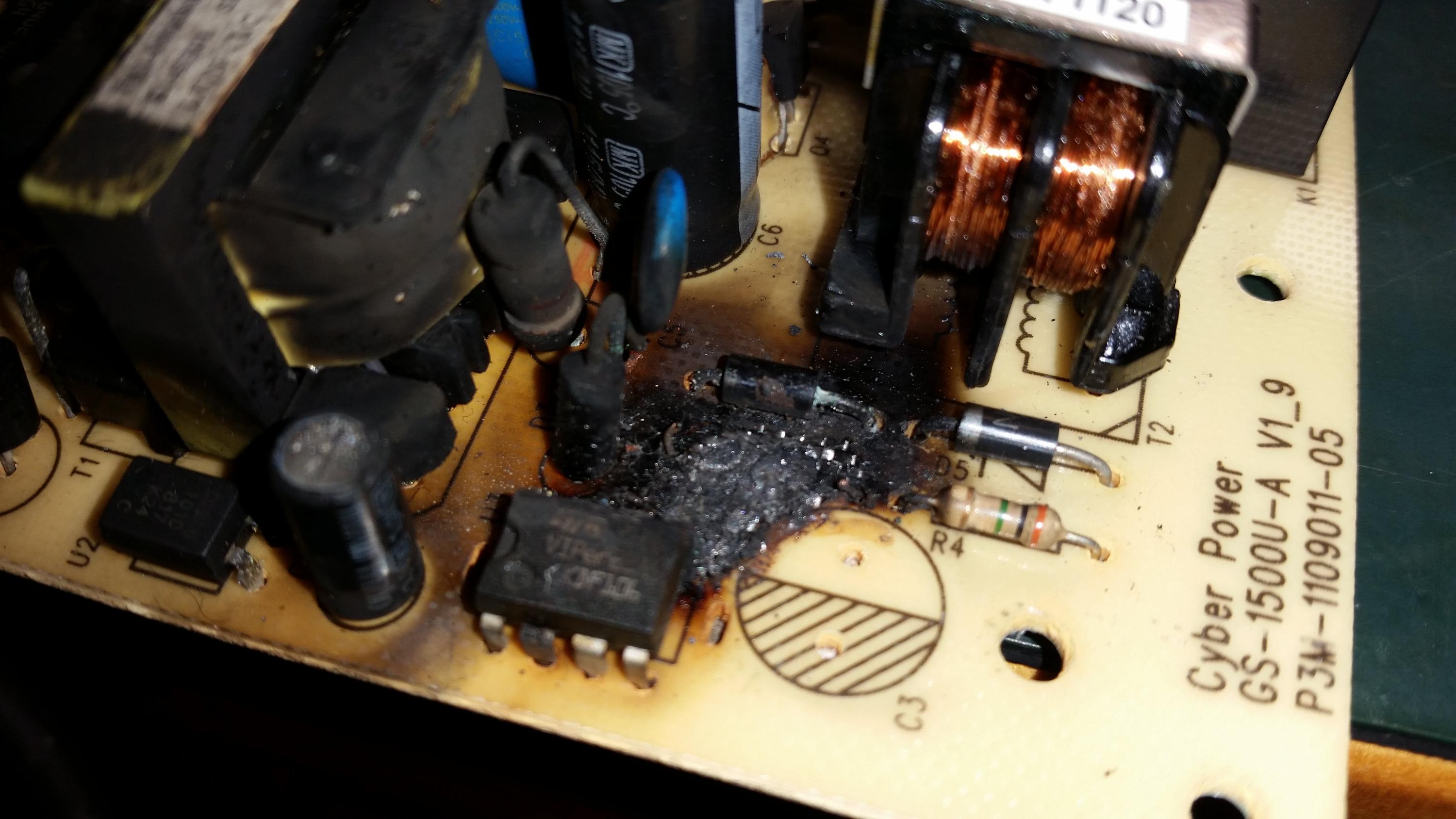

                Today's update
                Started the PCB cleanup process with a small dremel drum sand paper to remove most of the carbon. Later finished using a very small tipped dremel tool to clean most of the carbon on one of the ic leg hole. It did exposed a little bit of the trace underneath but was not torn.
                Also was able to identify the diode that was "charred" it turn out to be a rl207 diode.
                About to make a digikey order for some parts finally.
                  Could you please see your modified picture below:
                  You need to remove the glue that's shown by the red circles. Search the rest of the PCB, top and bottom for this glue and remove it ALL.
                  That garbage has been known to become conductive.
                  Companies that used that glue during assembly didn't do their research in regards to the long term effects it may cause over the years due to heat and age. They apparently couldn't care less.
                  By the way, did you check Q4 as shown by the green arrow?
                  You need to perform a thorough check for shorts, OC's and leakage.
                  I ask this due to the fact it doesn't seem that it's ever been removed from circuit.
                  Could you please look at the next picture:
                  Can you remove the burned glue shown in the red circle.
                  Also, it is vitally important that you remove ALL carbonization between component holes, as show by the green rectangle.
                  I have to admit you've done a great job so far.

                    the damage was caused by arcing under that dammed brown glue.
                    remove it ALL!

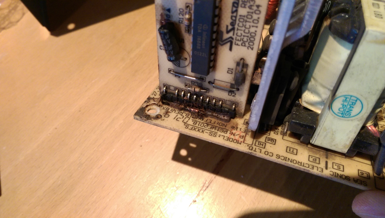

                      Not sure about arcing, it usuelly is not so conductive to transfer some signifficant amounts of power to blast anything directly.
                      I however thought about how it used to kill FETs especially in Enermax Liberty units and I think it acts as resistor divider, in time able to transfer voltage enough (with 380V input) onto the gate to keep the FET(s) open the whole time. Sometimes the controller manages to shut the unit down when it only takes longer to turn the FETs off but it is still not able to keep them on the whole time. After some time it will happen and the transistors explode as being both on at once, it is basically a short between primary high side and return.
                        Btw, those two rectifier diodes and the two filter caps is setup as Voltage doubler circuit to to run that SMPS IC. The diode right next to the transformer is part of RCD snubber network.

                                When it's already degraded to almost plain carbon (never seen it so black myself though), than I guess yes, it conducts pretty much everything.
                                Otherwise it seems it always has resistance of at least few kiloohms, don't think it can arc with normal operating voltage (about 380 V DC with active PFC). Probably when there is some overvoltage spike which the varistor does not fully catch, than maybe a kilovolt could appear for an instance and than it could arc?
                                  It never turns to carbon by itslef. It turned to carbon after the arc and burnt occurs.
                                  Using Ohm meter to test the conductivity is not going to give you the real conduction test.
                                  Try 400V or more in real world where those glue are being used in.
                                  It is like testing 1000V rating diode with your meter that only puts out 3~6V (depend on batteries), it may show good but it fails when exposed to working Voltage.
                                  Been there done that many many many times before. I have dealt with these glue since the 70's, long enough to know better and see what it can destroy, I still get the request the Chinese OEM asking to use them in place of the more expensive Electronics grade Silicone RTV, I show them the pictures.
                                  • Per Hansson
                                    • Jul 2005
                                    • 5895
                                    • Sweden
                                    You can use a Megger to test the glue.
                                    Not a multimeter as budm stated...
                                    In my picture below a multimeter shows no conductivity in the glue.
                                    But a Megger set to 1kV does, along with some buzzing.
                                    In this case it might not be a problem, as this is the PWM/PFC controller and thus sees low voltage.
                                    However the same glue is all over the PSU, this was just the area that was most blackened.
                                    And worse: if it where to become conductive even at low voltage here, due to for example increased moisture level.
                                    Then the whole PFC stage will go kaboom!
                                        it develops a carbon track that rapidly grows and gets exponentially worse.
                                        pretty soon you have a big hole in the board or worse a fire.
                                        i bet if a major mfr gets sued and a huge judgement this shit will go away overnight.
                                        unfortunately that means folks die over this.
