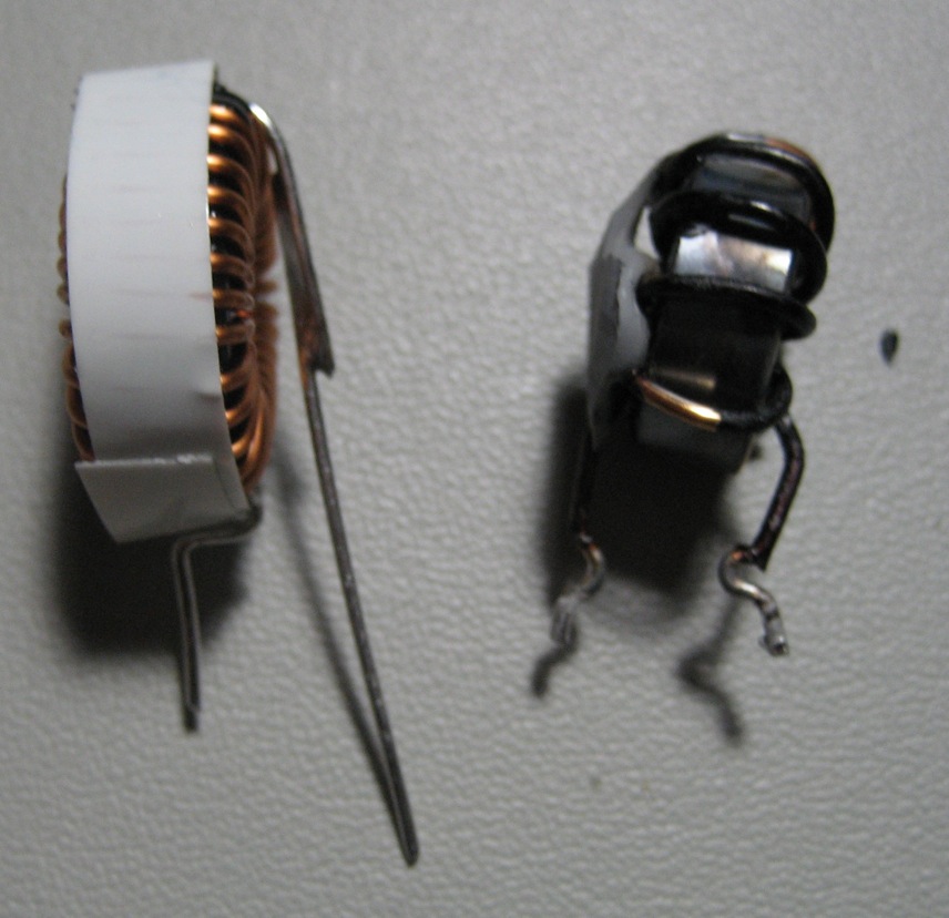

              Sensitive readers may wish to avert their eyes from the carnage that follows (doubly so as we completely hijack NWD's thread):
              You will note the capacitor lead, still in its through-hole, still attached to its trace. To the bitter end for that cap.
              The trace measures about 90 mils wide. I don't know how to judge if it is single or double ounce copper. This is on the 5V rail I believe, so worst case 10 amps?
              Given the through-hole is gone, I'm thinking a bottom jumper wire from there to the big C6 cap where it normally connects. 18 AWG or bigger. Cut off the delaminated trace and pretend it never happened. Delaminated traces only happen to other people.

                  First, let me say
                  Now, the first part of this is to get that thru-hole piece back into the board. Carefully get it realigned and back in. Don't flatten the trace or do anything else, yet.
                  You'll need -
                  a pin, the longer the better. (a hat pin would be great)
                  soldering iron on, cleaned and retinned ready to go
                  Once the piece is back in the board, hold it down in the center of the hole where the cap lead is stuck with the tip of a pin. Apply the soldering iron next to the pin and apply gentle pressure to the pin. You should be able to push the cap lead out and the hole should now be clear. The solder won't stick to the pin.
                  LMK when done and I'll get to next part.
                  Carefully get as much of the gunk off the other half of that caps area. Try not to chop the other traces.

                    The one that nwd did not replace originally because of it's difficult access is a TEAPO SC series, 330uF @ 35v, 10 x 20mm. According to the SC datasheet it should have an ESR of 0.044.
                    Out of circuit it reads 0.47 ohms on the ESR meter @ 320uF. Capacitance is okay (although I like them a little high 5-15%), but ESR is nearly 12x over spec.
                    That should say it all.
                    no, if you replace it and the coil and everthing is fine, it says it all.
                    esr of 0.47ohm in psu doesn't tell me much at all....could be a problem if it's on very sensitive place, but if it's just filtering, no, i wouldn't expect it to make problems...
                    that's why i said to change coil first(and monitor it's temp when loaded): if you change both coil and cap you won't know what was it...

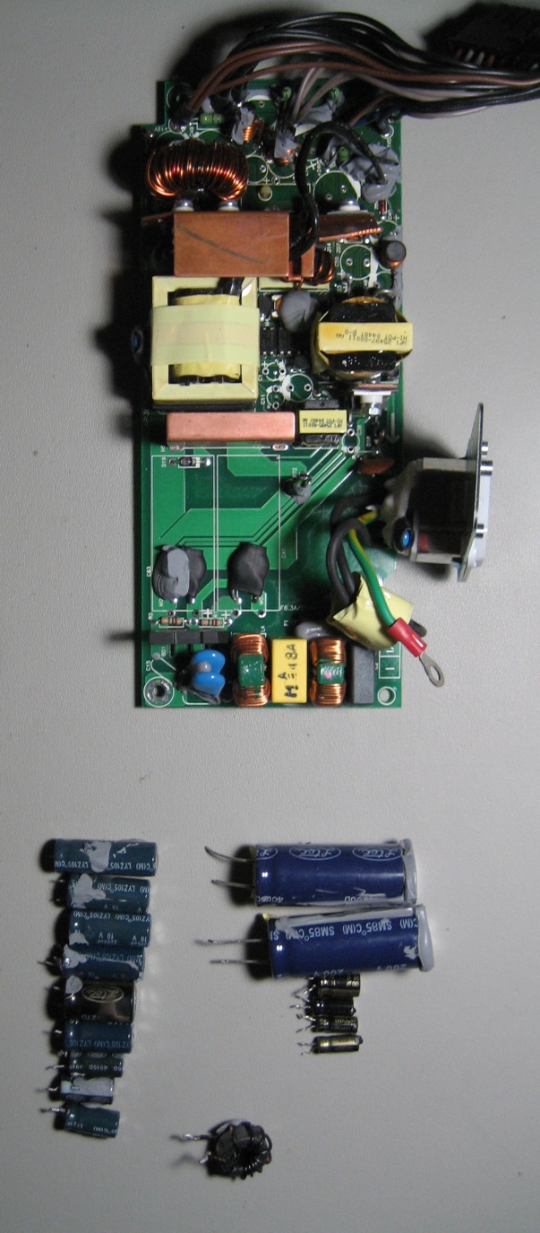

                        Alright, here is my final update.
                        Here is a complete table of the caps in this PSU, any notes I have about them, and replacements (with more notes) that I used:
                        Code:
                        Primary Caps:
                          560 uf  /  200V  /  18mmx45mm, 8mm   /  2x /  ECO-S2DP561BA (22x40mm, 10mm, Snap-In)
                            ^ Radial
                          47 uF  /  50V   /  6.3x11mm, 2.5mm   /    /  UPW1H470MED (PW)
                          10 uF  /  50V   /  5x11mm, 2mm     /    /  UPW1H100MDD (PW)
                          2 uF   /  50V   /  5x11mm, 2mm     /    /  UPW1H2R2MDD (2.2 uF, PW)
                          100 uF  /  35V   /  8x11.5mm, 3.5mm   /    /  UPW1V101MPD (PW)
                        Secondary Caps:
                          1000 uF /  35V   /  12.5x20mm, 5mm   /    /  UPW1V102MHD (12.5x25mm, PW)
                          330 uf  /  35V   /  10x16mm, 5mm    /    /  EEU-FM1V331 (FM)
                            ^ 0.044 ESR, 1050 ripple
                          1200 uF /  16V   /  10x25mm, 5mm    /    /  UPW1C122MPD (PW)
                          2200 uF /  10V   /  10x25mm, 5mm    /  2x  /  EEU-FC1A222L (10x30mm, FC)
                          4700 uF /  6.3V   /  10x30mm, 5mm    /    /  EEU-FM0J472L (12.5x30mm, FM)
                          1000 uF /  6.3V   /  8x15mm, 3.5mm    /  3x  /  ELXZ6R3ELL102MH15D (LXZ)
                        Secondary Inductors:
                          6.5 uH  /  2100LL-820-H-RC
                        All of the above fit in the PSU, although some things are tighter then the originals, or need extras leads soldered on them. The inductor needed some amount of cleverness to get it to fit (see attachment).
                        In the end, the I got them all soldered in, got my previous mistakes fixed, and got the lid back on and closed. Plugged it in and verfiyed that all the pins were putting out their advertised voltages. Thus I declared the PSU fixed!
                        Sadly the iMac it goes in still will not fully boot up, maybe the rails are sagging under load, maybe something got nuked when the PSU had bad output, don't know. Cutting my loses at $20 worth of caps.
                        Anyhow, thanks for everyones help.

                                      Eyeballing the layout, it looks like the TOP244Y is used for +5.1VSB - this is a different circuit from L8's, so I'm not concerned about that.
                                      The main rails are run off the UC3845 switcher. I haven't traced out how the primary side works. On the secondary side, L1 is the coupled inductor used for +5V and +12V. It looks like they're taking the +5V winding off T1, running it through a series inductor (L6) to drop the voltage (I've seen this trick in Antec PSU's), rectifying that (D33) and L8 is the +3.3V output inductor.
                                      I'm still scratching my head how a failure can occur which causes *one* coil to pop. If the switching frequency goes off, I'd expect different carnage - too high a switching frequency and I'd expect snubbers to catch fire, main FETs/output schottkys to blow, etc... and they're fine. Too low a frequency shouldn't matter since this is a current mode supply, it'll most likely cut its switching cycles short, working fine under light load and dropping dead under heavy load. Regardless, switching frequency is set by a RC circuit on the '3845, this can be measured and checked easily.
                                      Since the varnish is fairly badly burnt off L8's wire, I'm thinking it was overcurrented. I'm wondering if the G5 itself has a crowbar circuit built in, which shorts +3.3V if it goes too high. With this happening, the supply may put out a high fault current through L6/D33/L8/L10, and perhaps L8 is the first thing to catch fire. Though I'd expect L6 to also get damaged...
                                      Anyway, that's my brain dump. As I dig into this thing over the next couple days, I'll post more.

                                        UC3845 is dumb old SMPS IC and not fast enough to sense trouble. And came from same company who designed original UC3482.
                                        This type of crappy IC will keep trying (ticking) and blow up (not fast enough on some situations especially with bad caps) and do strange things too. There is electrolytic caps that is very important for proper function of the UC3845.
                                        The reason the coil burned is off frequency during Mac is in use due to damage or remaining bad caps not replaced. Low frequency will do that to a coil.
                                        For this reason I particularly prefer good SMPS that *do* not have electrolytic to filter DC just for the IC itself. Poly film or ceramic and cycle to cycle protection and cut out in a cycle and stay shut down and have to cut power to reset. ST and other good IC smps designs are available.
                                        Also WHY did apple use this particularly awful SMPS that won't let you fix without more troubles? This is seems to be one of those all or none PS that need fixed all the way to prevent repeats.
                                        Cheers, Wizard
