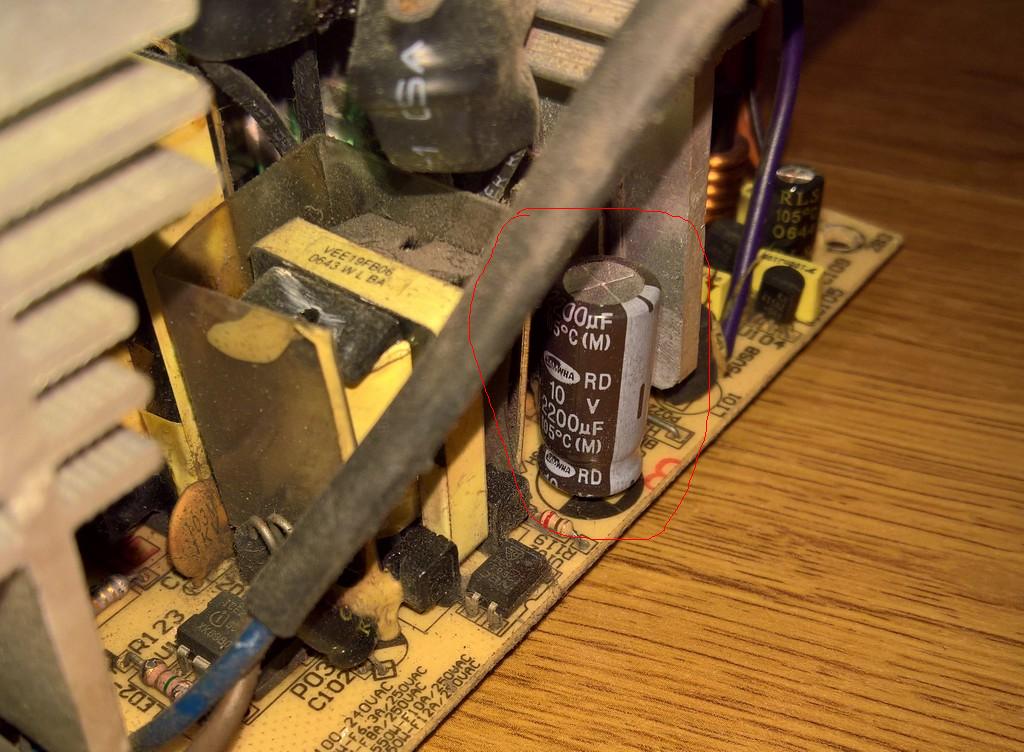

          Raising this topic from the dead for a good cause
          I'm currently scratching my head trying to figure out the original size/specs of the capacitors on the secondary side (doing some voluntary work for a social project which basically involves fixing old hardware then donating it to orphanages and so on).
          Apparently the fellow who donated us this computer had the PSU "fixed" at some point by a so-called professional who replaced 3300uF caps with 2200uF and so on, therefore rendering the whole thing unusable in a rather short time.
          I know it's a long shot, but does anyone remember/has relevant schematics/pictures that would allow to identify the specs for the caps on the secondary side of this PSU?
          Thanks a lot for any help.

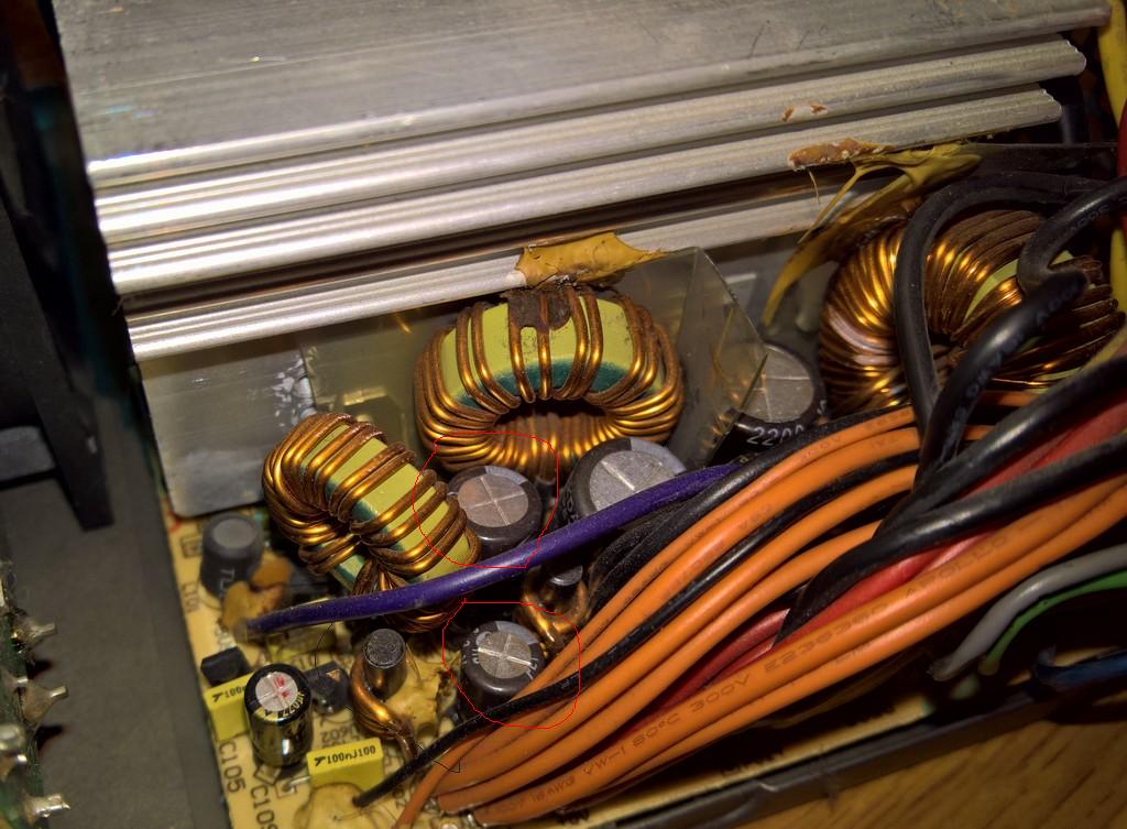

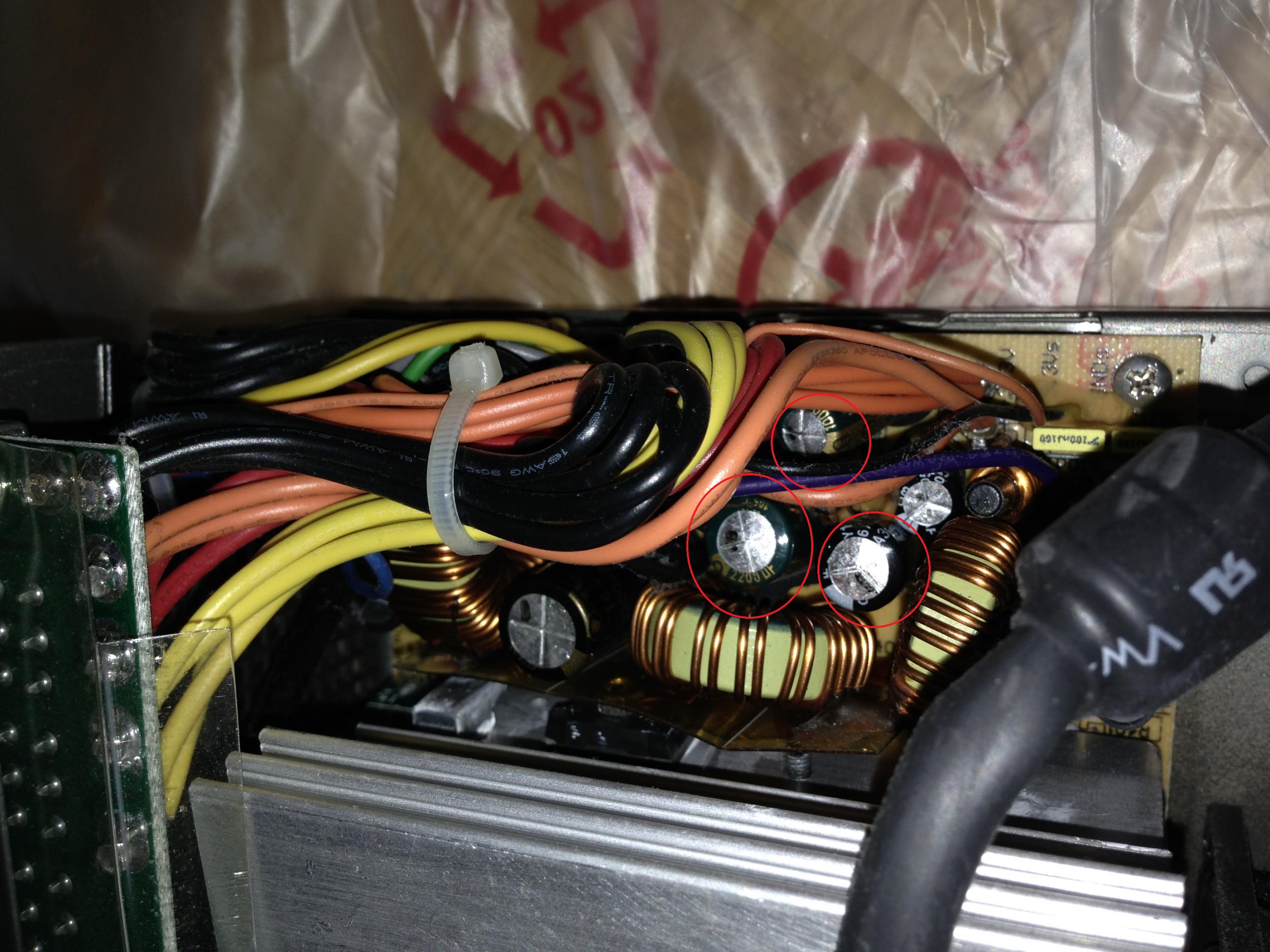

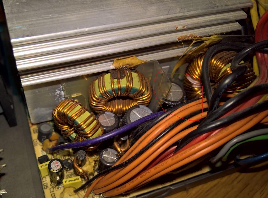

              Sure, let me share what I've been able to find so far and what still remains to guess:
              1. This cap here is a 2200uF 16v but according to my findings should be a 3300uF 16v
                Re: Antec NeoHE430 worth buying/recapping?

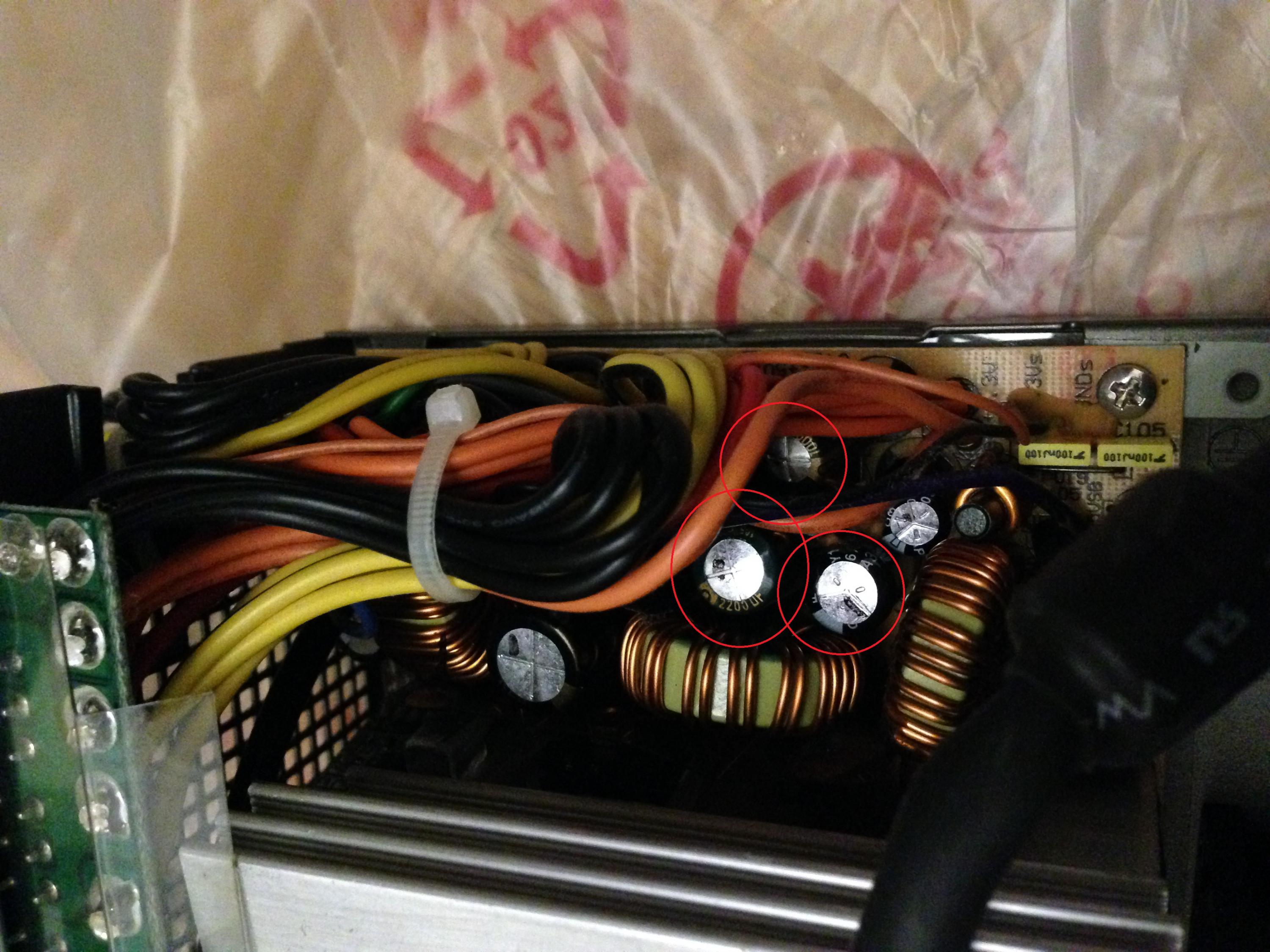

                The caps circled red by me in first and second attachments in this post have been switched between them (the one in pic 1 should be 2200uF 10V and the one in pic 2 should be 3300uF 10V, probably whoever worked on this PSU didn't made notes and removed multiple components before replacing them).
                The 3300uF one is Samsung but the 2200uF one (placed where the 3300uF should have been) appears to be Russian made (??) - perhaps salvaged from some old device and probably not HF.

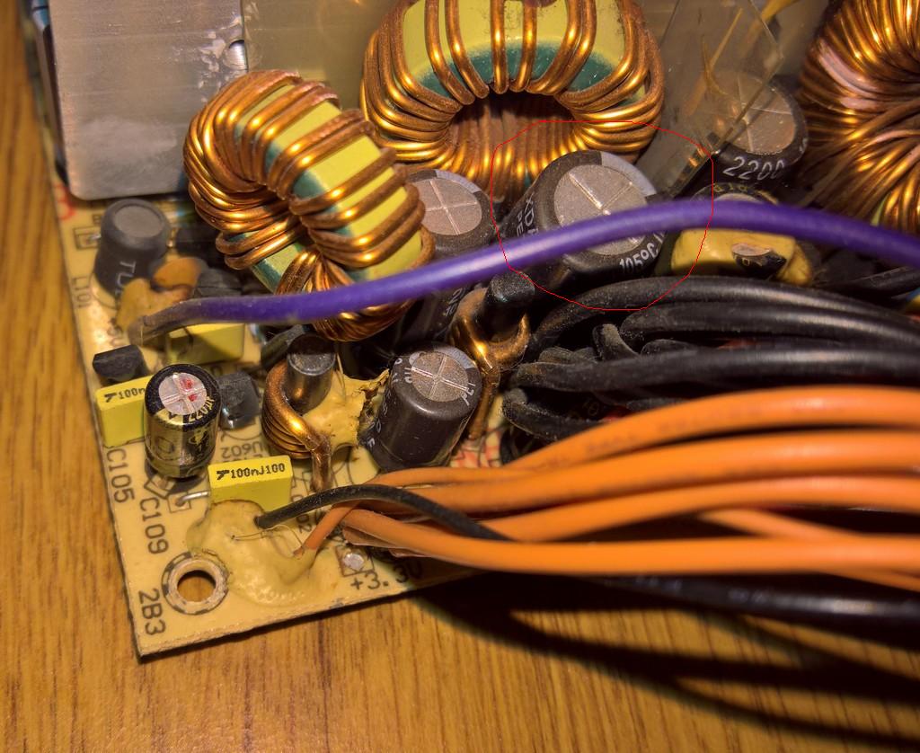

                  I was unable to find any reference about the capacity and voltage that the two caps circled red in this pic should have. Maybe they ware replaced correctly but i'd rather make sure if possible.
                  No other caps appear to have been replaced. All those present appear physically OK but I suspect at least some of those replaced were not HF and of course those that are way below capacity are probably dead by now).
                  The PSU tests OK on voltages when powered on with a tester but cannot power up a working motherboard.
                  Thanks in advance for any help (both in validating or not my current findings and in helping me with the missing info)
                    Samwha RD series? SRYSLY?!
                    They aren't really suitable for PSU filtering as they are General Purpose caps.
                    That is the problem!
                    Some idiot recapped the PSU who didn't know anything about caps and that there are some different types of caps...
                    And due to that fact the caps might already be dead because they aren't designed to take the ripple...
                    The capacitance of the caps isn't as relevant as most people say they are, other factors are more important...
                    Like Ripple Curent, ESR, especially for SMPS...
                    Though that doesn't matter if you use a totally wrong type of capacitors!!
                    And you have to put your head into Datasheets and compare the electrical values, size and so on.

                                Just a quick follow up after the package from Behemot arrived (turned out that shipping from the Czech republic to my own country wasn't really expensive):
                                I removed all the caps that were replaced during the previous recap job done by some idiot. Found the following:
                                1x Samwa RD 3300uf 10v
                                2x Samwa RD 2200 uF 10v
                                1x Daewoo RUS 2200uF 16v
                                1x Samwa RD 1000uF 6.3v (tiny bugger placed on a huge 10mm cap post)
                                I went overboard and used 4x 3300uF 16v plus a 3300uF 6.3v instead of the tiny 1000uF 6.3v. PSU Started just fine on the tester and is currently idling on some P4 in Win 7.
                                Except for the +5vsb which seems to run low according to AIDA (4.5v) everything else is solid. No other cap appears to be bulged or leaked so I'm not going to replace anything else unless I have to.
