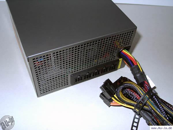

    i could get an Antec NeoHE 430 including all cables (has cable management) for 17EUR (12EUR + 5EUR shipping ... about 22USD)
    seller says that he has trouble booting the PC this unit was in..
    bad caps? worth buying/recapping?
    and who's the OEM of this thing...?!
    some pics..
    those pics are from the 500W version...
    edit: side-pic of the 430W version (looks the same)

    Antec Neo (not ‘HE' and maybe early “HE”) -> built by CWT -> FUHJYUU caps.
    Antec Neo HE -> Seasonic built -> OST caps.
    (Early 'HE' builds may have still been CWT->Fuhjyyu. I dunno for sure.)

      Re: Antec NeoHE430 worth buying/recapping?
      Hello.
      I would say go ahead and buy it.
      If it was made by CWT, it probably has those really awful Fuhjyyu caps that are easily replaced, though many are of non-standard size.
      Once recapped, it'll probably be fine.
      If it was made by Seasonic, it probably has the OST caps which aren't as bad. It's still an easy recap, and from looking at some of the Seasonics I have had around here, there is often proper space for standard sized caps even if a custom size was used at the factory.
      This also would have a high probability of success.
      OH! I remember! Certain Seasonc PSUs and the Antec Neo430 that was shipped in certain Antec cases had an unfortunate tendency to NOT BOOT at zero load or at very low load. This would only occur with specific motherboards that had a power up strategy that didn't load the PSU quickly enough. The worst offender was boards based on the NF4 chipset. I got a few Neo430s really cheap that way!
      Personally, I've never seen a Seasonic or even a Seasonic Antec with the cheap OST caps fail. And I've been using Seasonic in systems around here for a while now. (since the Super Silencer series)
      Have Fun!

              All the Neo HE models were Seasonic. The only CWT model was the original Neopower 480W and the "blue" version, even though at the time one could go to CWT's UL database page and find a half dozen models of different wattages. I never saw them for sale under CWT's own name, but they were also known as the CWT EX series.
              The no boot issue with these was caused by too sensitive protection circuitry IIRC - recapping it wouldn't fix that, if indeed there's a problem with that on this one. A lot of other Seasonic units had that trouble back then.
