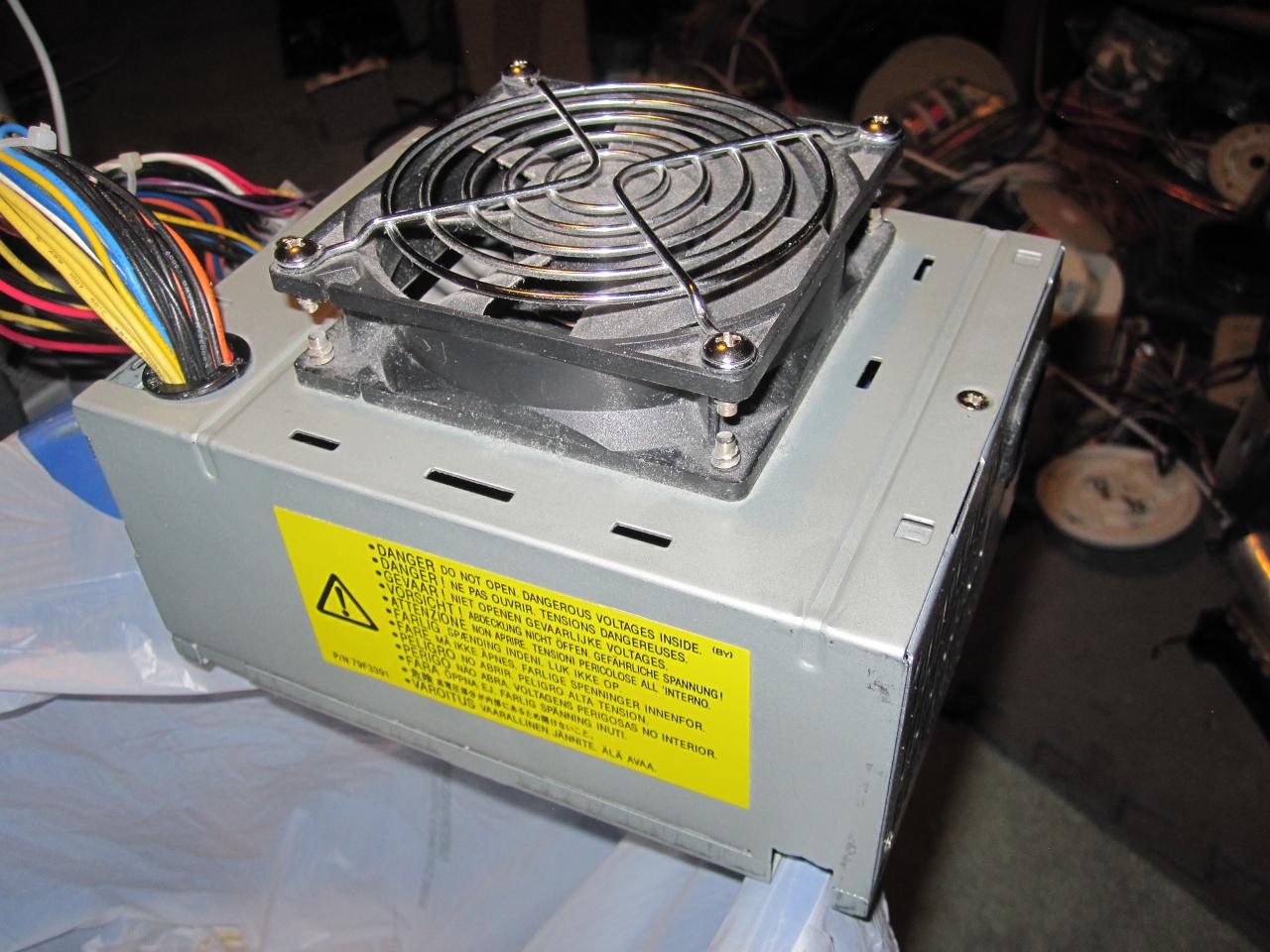

    I have a *working* NPS-200PB-56D ... alas I have no computers that this fits in. I wonder if I should scrap this otherwise good PSU.
    Not sure what form factor this is. I'm guessing microatx but I don't have any standard microatx cases (I have a nonstandard full size ATX PSU microatx case and a nonstandard microatx case) and the board is too long to fit in a standard atx PSU case...
    Scrapping = parts, or perhaps this still has residual value as a complete PSU somewhere...

    I'm going to guess it's late 90s or early 00s vintage. Newton was part of Delta Products (may still be, I don't know) and had solid designs. They probably used good parts for that era. Probably the big limitations on usefulness would be the +5VSB current rating and the +12V current rating. I suspect the +5VSB current rating is less than 1A, and may be .1A. In that era the high current outputs were the +5V and +3.3V, so the +12V current will probably be pretty low (in the ballpark of 6A, maybe?).

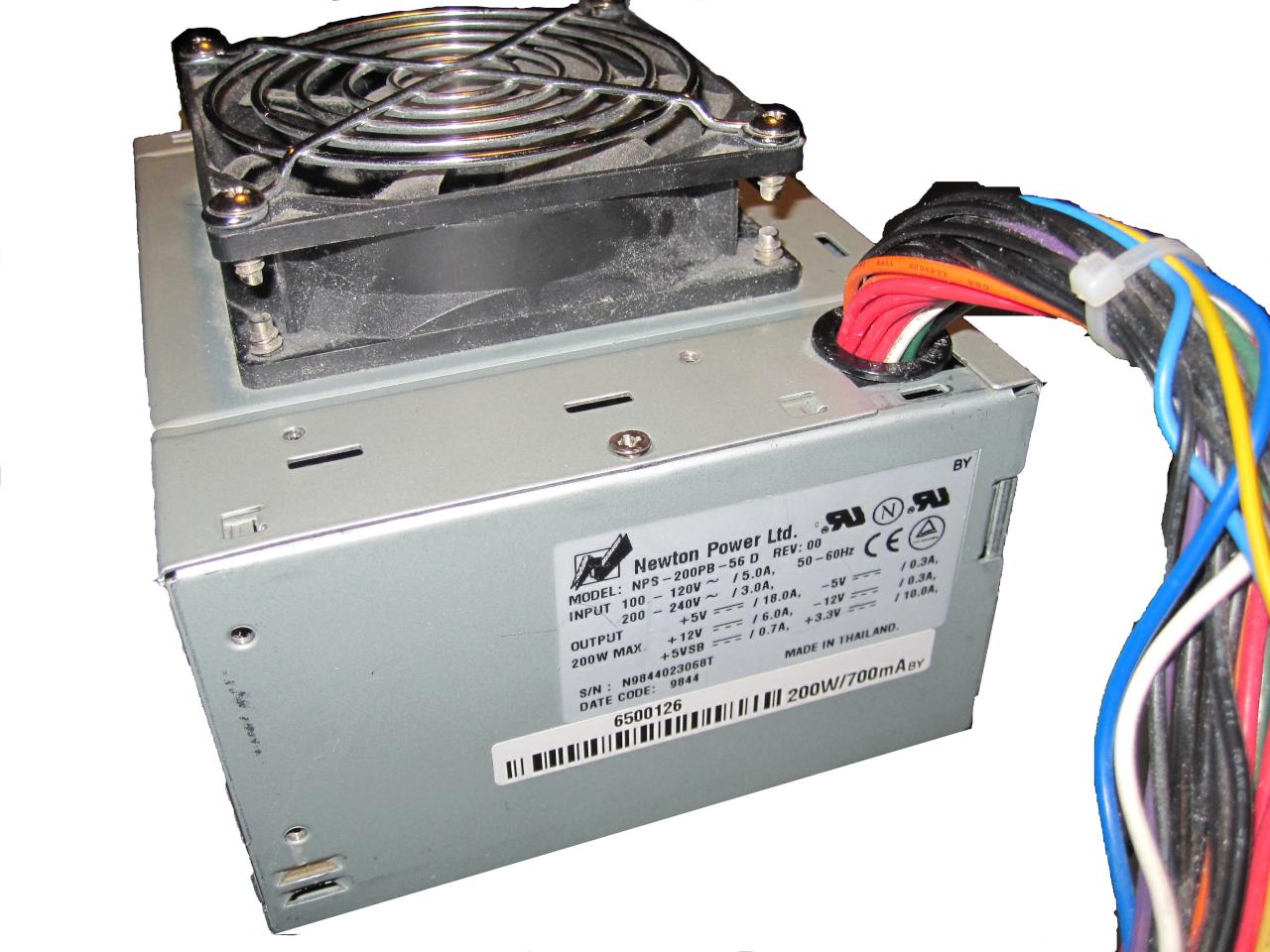

      Indeed is is. At best I could use it as a bench supply but I'd have to hack in some current limiting or foldback. Again yeah it's a pity to trash it, but I can't find an ATX PC use for it as it's not standard ATX.
      +5SB 0.7A
      +5 18A
      +12 6A
      +3.3 10A
      -12, -5: 0.3A

        I used to have one of those. I've only seen that form factor in old Gateway (or Gateway 2000) computers. That one was made in late 1998, and the one I had was about a year older.

          So this is really nonstandard and not worth keeping? This is odd that it's very close to standard atx size, and even has a standard atx connector... just that it doesn't physically fit in a standard atx case.
            • 31214
            Re: Newton Power NPS-200PB-56D - scrap or save?
            sell it on ebay in the arcade section, i think they are used in some megatouch terminals.

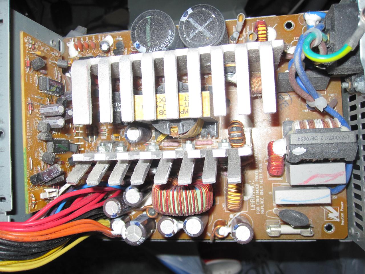

              470uF input lytics for 200W? I'll bet it has great hold-up time. -52 material output inductor, so the switch frequency is probably above 50KHz. Looks like NCC LXJ series output capacitors.
              PeteS in CA
              • eccerr0r
                Solder Sloth
                • Nov 2012
                • 8701
                It's a UC3482 switcher, which would be the second over-100W PSU I've seen with the Unitrode IC (most of the SMPS I've seen with the UC384x are less than 50W).
                • Wester547
                  • Nov 2011
                  • 1268
                  • USA.
                  Yup, Chemi-con LXJ on the output, a mingling of Taicon VT and Chemi-con KME for the tiny decoupling capacitors, and Rubycon USP in the voltage doubler (it appears). I hope that's not a death ADDA sleeve bearing fan, as it might need lubrication and maintenance.
                  Amazing, it has a standard ATX connector. Many Newtons of that time period (IE, those built for Dell) had the dreaded proprietary connector. I guess you could keep it as a spare supply with which to test IDE HDDs, floppy drives, and IDE optical drives, et al. Although it may come in handy if you were to discard it for parts too.
                      A lot of Delta Products P/S models of that era used 384x series PWMs, including PC PSUs in the 200W-250W range, which were the most common late 90s and early 00s models that I saw.

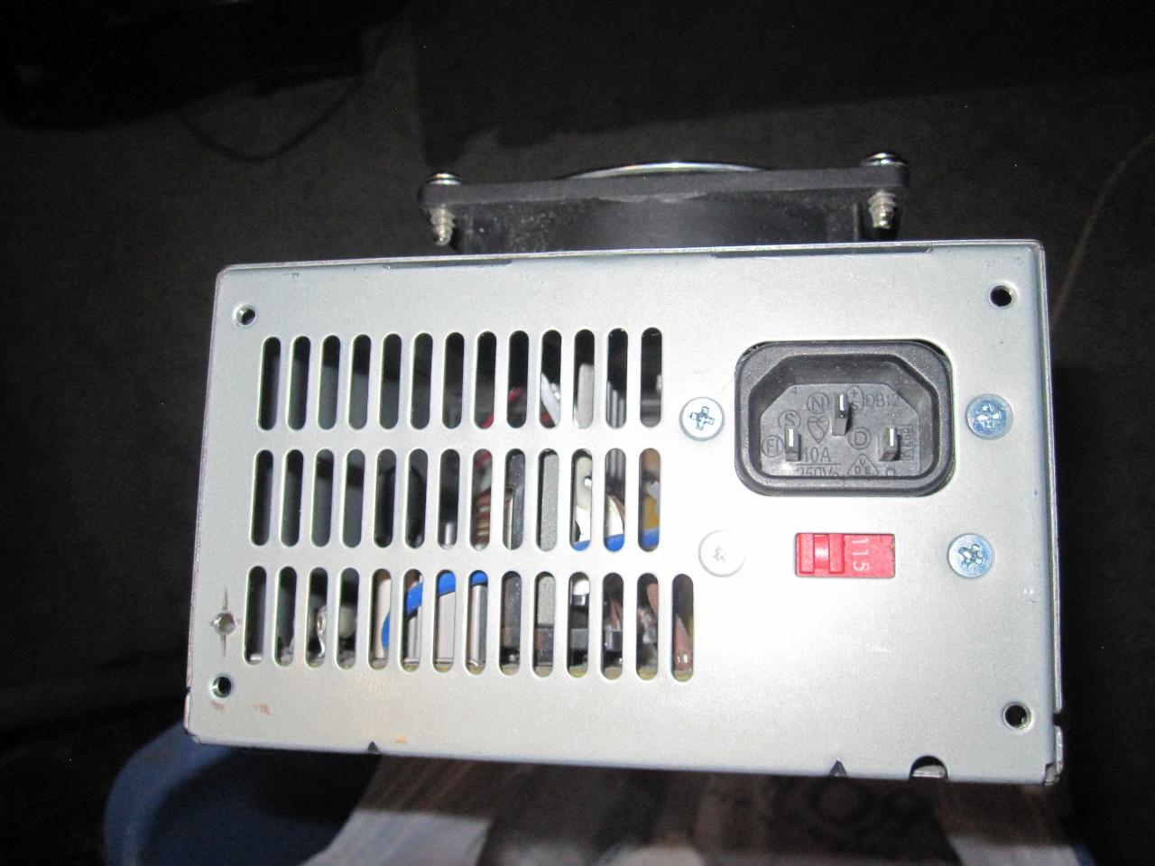

                                    I saw a Gateway that had a standard ATX power supply opening and an adapter to hold this weird form factor.
                                    Along with the normal rear mounting holes, there was an L-shaped bracket that screwed into the two holes next to the label.
                                        Another reason to not keep this silly PSU
