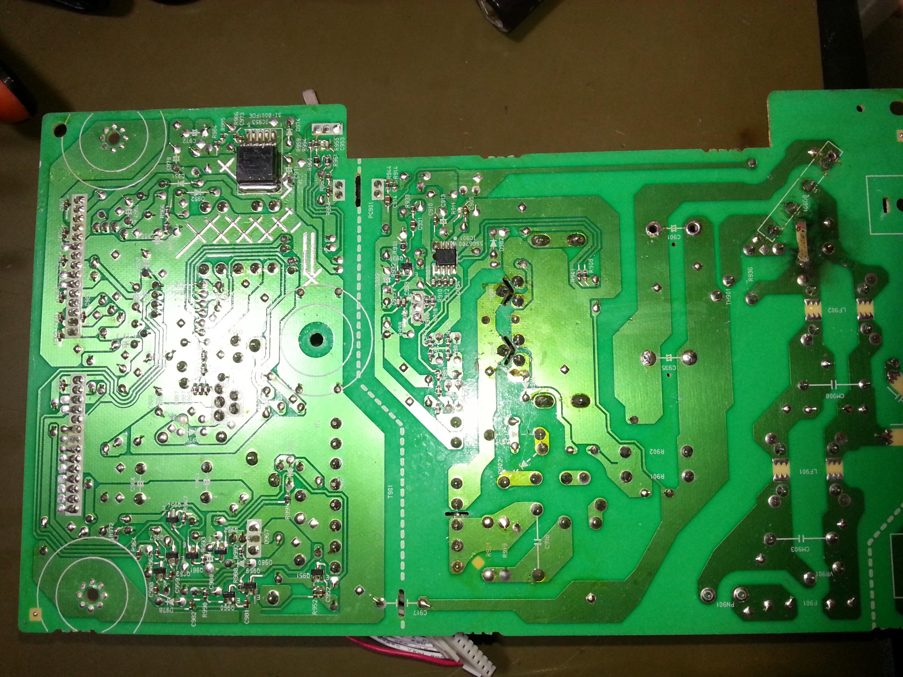

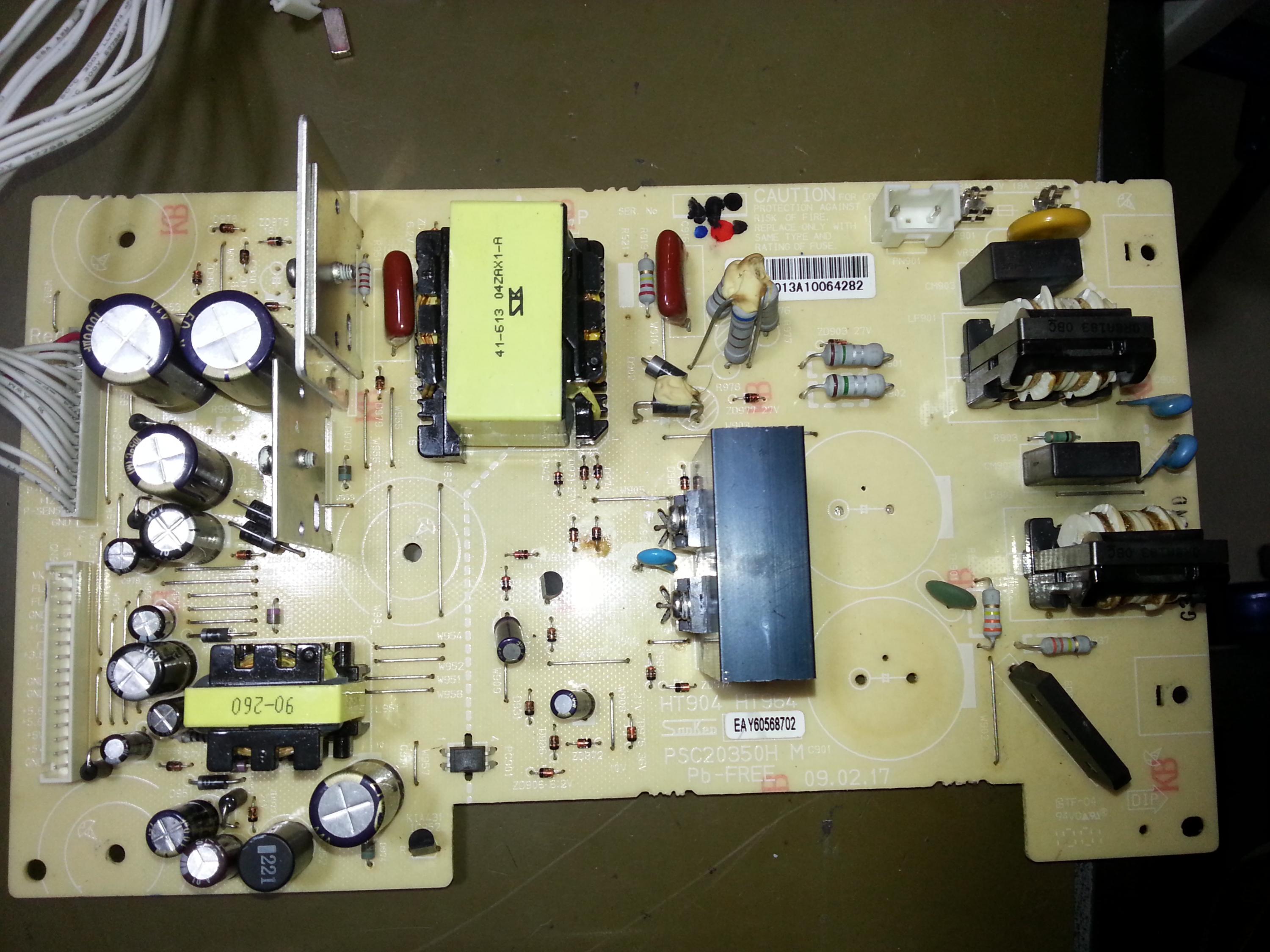

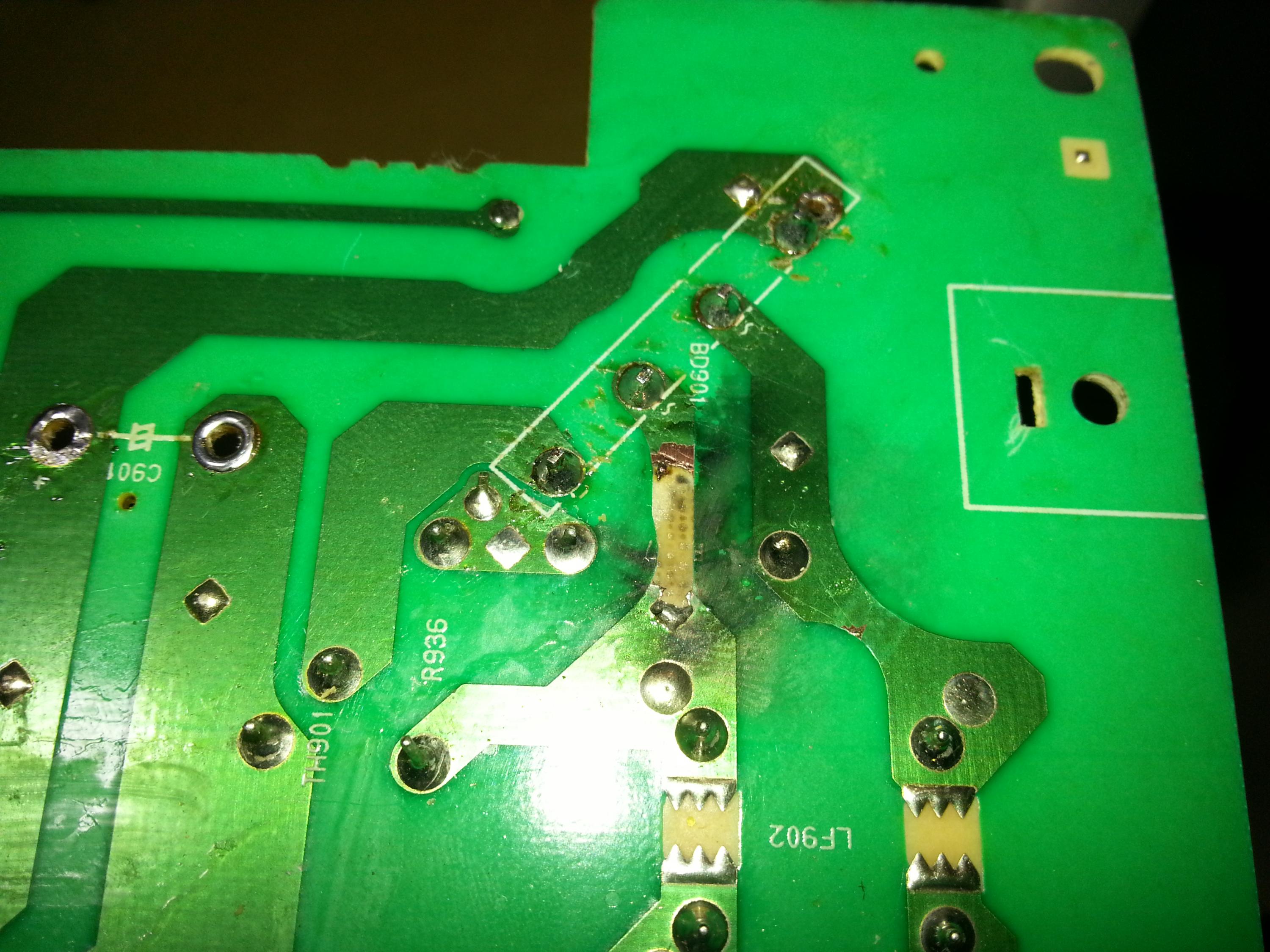

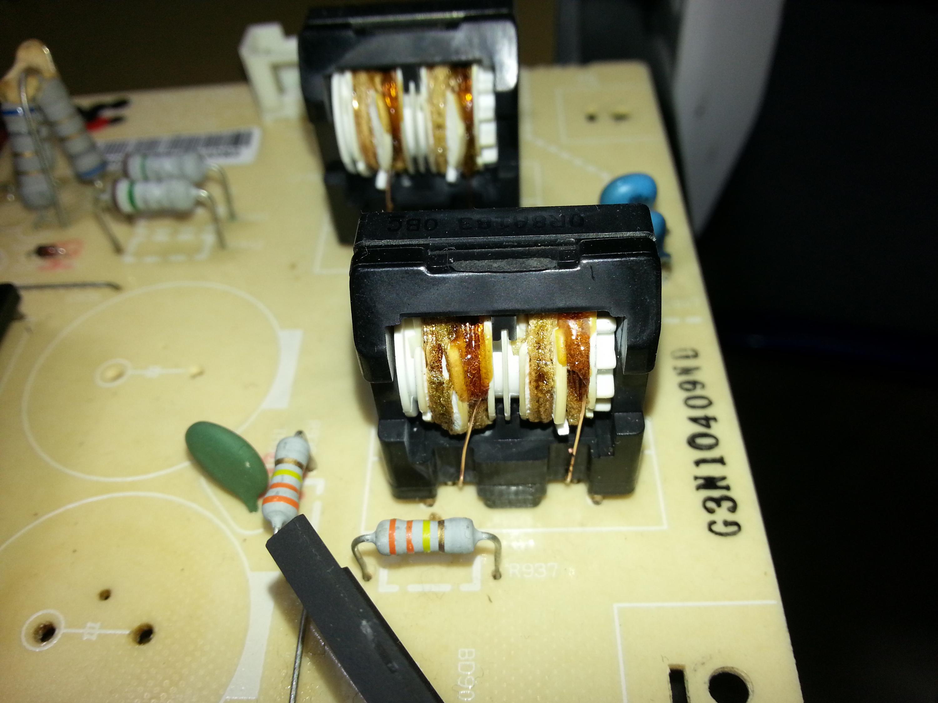

                            Ok, here's some much needed info: model plus some pictures...they're pretty sh!t now that I look at them up close, so hopefully the schematics come in handy to clear things up.
                            The model of the power supply is PSC20350 and after a lot of searching, I managed to find its schematic in the service manual for a JVC unit strangely enough, so LG weren't the only ones to use this board. Schematic is on page 40.
                            You can now see the damage I was talking about (photos are after the fire incident so the mains cap is missing): you can see part of the trace came off there and also those fried chokes I was mentioning.
                            Wattevah...

                                Well the PSU is not made by LG - it's made by Sanken as far as the board tells us (forgot to upload a picture of the models and stuff up close).
                                Yes, the damage is pretty significant given the chokes caught fire. I was just about ready to have another go at repairing this thing, but I believe those chokes are tough to find and possibly expensive. I'd need a new set of FETs too, this time preferably higher spec'd ones.....

                                  The damage there looks to be from the bridge rectifier shorting. The thermistor/inrush current limiter TH901 didn't blow, nor did the 2 - 0.15Ω source resistors which effectively present 0.075Ω.
                                  ZD903 may have shorted, which would explain why the resistors didn't fail, but it still doesn't explain why the thermistor didn't torch.
                                  The FET probably died because of the wrong values.
                                  You can bypass the chokes for testing purposes.

                                    The rectifier was shorted the first time as well. The flat one you see in the top-down picture is the original one, since the photos were taken while I was putting the dead parts back on so I could return it as it came (might give it one more shot nevertheless).
                                    I looked up the model on that rectifier and it's a 4a one, so I replaced it with a similar one, although with a different package (it had longer leads and had to space them out a bit using some pliers to get it to fit the holes), but that one's long gone now so it went straight in the trash....anyway, irrelevant. I must question why there's such a big "gap" between the rectifier rating 4a and the fuse rating 8a ? Probably headroom for inrush currents.
