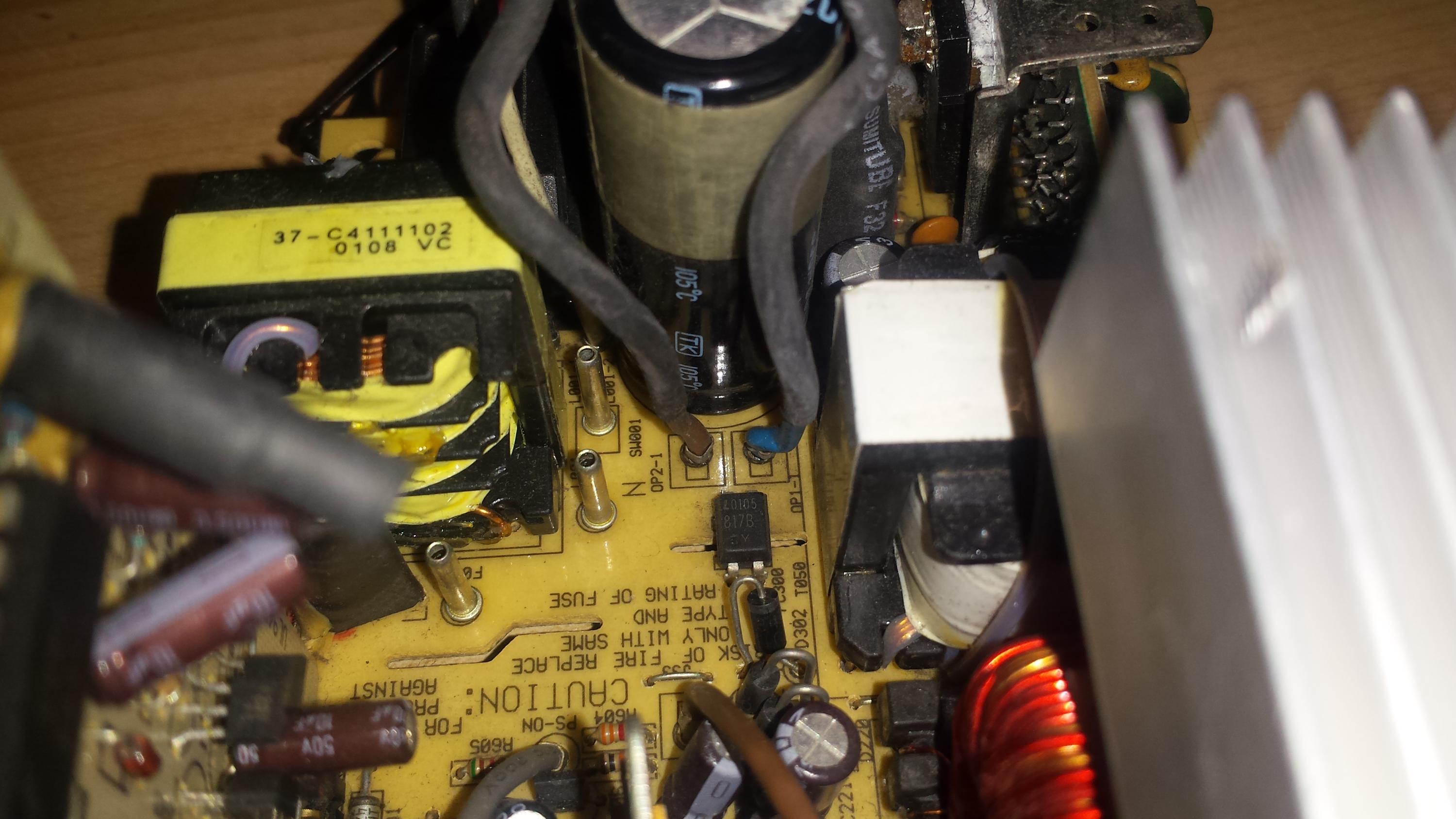

        Re: Help identifying blown component in Dell PSU.
        Have a look at the TOP227 datasheet and see if the 5VSB circuit in your PSU resembles that of the sample circuit on page 7 of the datasheet. In particular, see if the circuit connecting to the Control pin of the TOP227 IC is similar, as that's the easiest way to tell. Here is the datasheet, by the way:
        https://cdn.badcaps-static.com/pdfs/...e54311a3df.pdf
        I also noted your PSU has some tan/brown conductive glue. Make sure to remove as much of it as you can, especially any on the primary side and any that has turned brown/black. I find the easiest way to do that is to take a small flat head screw driver with a long handle and poke the glue to bits. Then I use tweezers to remove what I can.
        Originally posted by stj
        when the cap dries up they sit and pulse for a while creating a ticking sound - then BANG, your TOPswitch is toast!
        Could also have been bad solder joints that cause the failure. Look at the joints of IC600 in this picutre:
        https://www.badcaps.net/forum/attach...8&d=1503224078
        You can see some clear ring cracks on the legs as well as the heatsink.
        While discussing the above picture... O/P, please also remove the tan/brown glue on the bottom of that PCB.
        As for recapping the PSU - I wouldn't worry about any of the output caps as they seem to be Panasonic HFQ. Those are more or less equivalent to Panasonic FC and are just as reliable. I wouldn't touch them at all. But the small L-tec and Jamicon caps, feel free to pull them and check them.

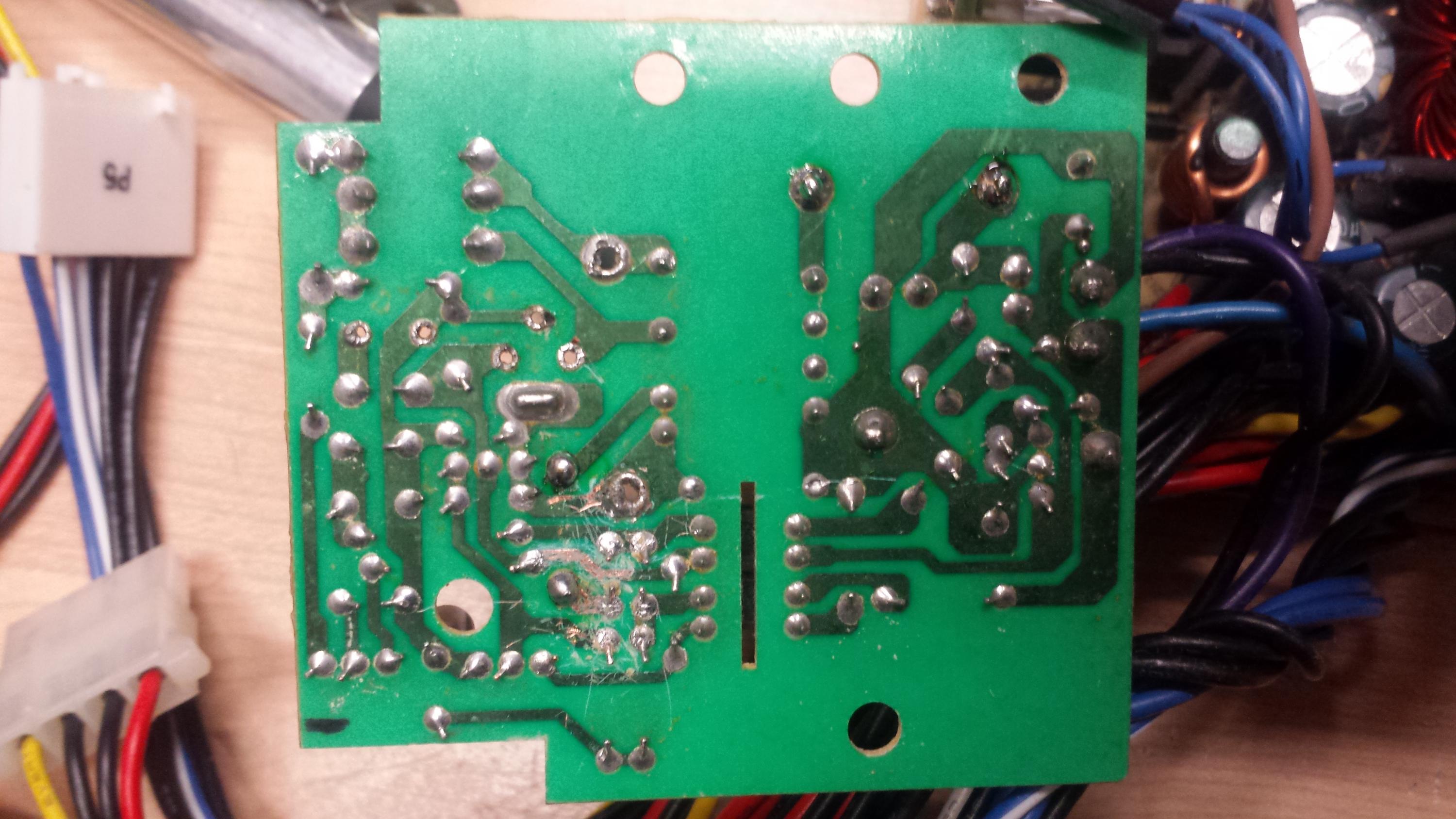

          Thanks Momaka thats very informative but sorry I'm no electronics genius like yourself and STJ and that a lot of that goes right over my head. I have taken some more pictures here of the little daughterboard where the IC blew and the main PCB below where its attached to.
          There are 4 wires that connect this daughterboard to the main PCB and I have been able to find out what they are for.
          Purple= goes to +5VSB on computer ATX motherboard connector
          Black= Com on ATX motherboard connector???)
          Blue= (op3) goes to block of 14 black wires on main PCB (Com maybe???)
          Brown (op4) goes to main PCB (op4) seen in centre bottom of Main PCB photo
          Two other wires disconnected (op1) & (op2), Brown & blue come from corresponding wires you can see on on main PCB
          You can see where the IC600 (subject IC) & capacitor C600 (small Taicon) cap were removed and not replaced yet
          I can see now that Per Hanson was right in it being a 5VSB board as that is the main output to the ATX connector.
          Per hanson
          If my eagle eyes are right this is a Lite-On PS-5141-2D2 Rev
          The board looks like a 5VSB board.
          I would hazard a guess that the small Taicon cap is bad and has caused this failure.
          But it could also have been a large power surge.
          No idea what the original component (IC600) was.
          But it looks easy enough to just wire in any 5VSB supply in it's place.
          Is it wired up directly to the main rectified DC voltage in the main PSU?
          And do you have that up? (Should be 155VDC with 110VAC)
          Does any of this help with a suggestion of what IC to try?
            Thanks, those are quite helpful now.
            Looks like the Blue (op3) and Black wires are connected to the same trace, so they are both ground. The blue wire is probably signal ground for the supervisory circuits on the secondary side of the main supply.
            Likewise, looks like Purple (5VSB output) and brown (op4) are connected together as well, so brown has 5V on it too. Most likely that brown wire carries 5V for power to the supervisory circuits on the secondary side for the main PS.
            Those are your 320-340V bus input/supply to the 5VSB primary side.
            Well, I tried tracing the gate/control pin of IC600, and it indeed looks like a TOP222 through TOP227 IC is what you had there originally. Thus, pick one and try it out. TOP222 were quite popular back in the day, so no harm in trying it.
            Again, just make sure to use the bulb trick I posted about above to prevent the circuit from blowing parts again, should something still be wrong.
