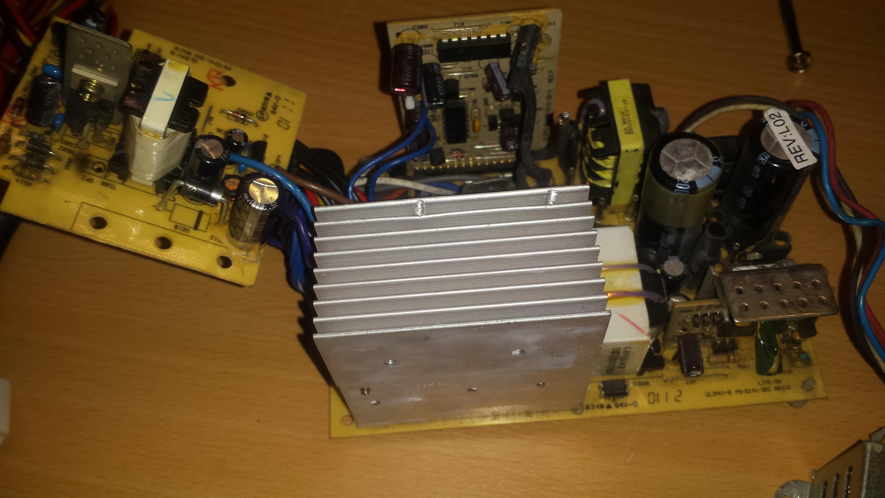

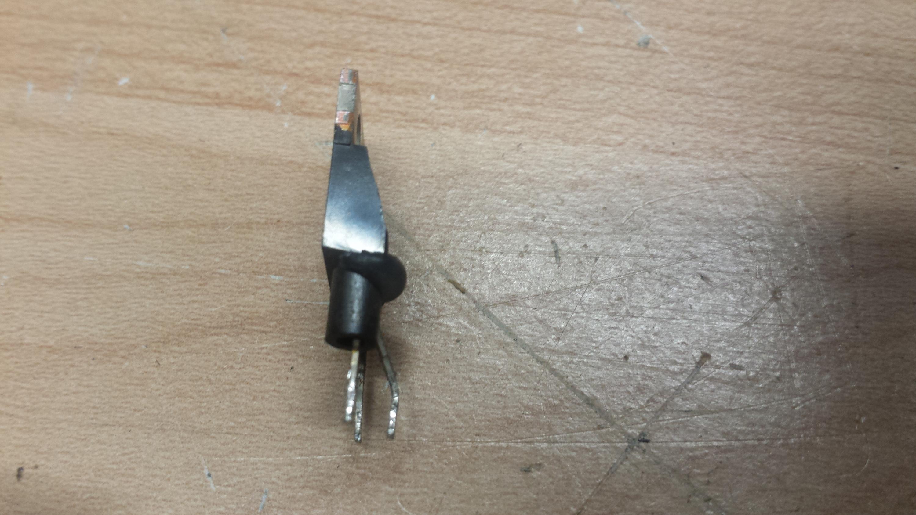

    I have just stripped down a PSU in a dead Dell Optiplex 200 and I found a component that has is front blown right off so I cant see what it is. It is mounted on a little piggyback board on top of the main PSU. No luck finding a Schematic either. Can someone recognise what this component is?
  • Per Hansson
    • Jul 2005
    • 5895
    • Sweden
    Re: Help identifying blown component in Dell PSU.

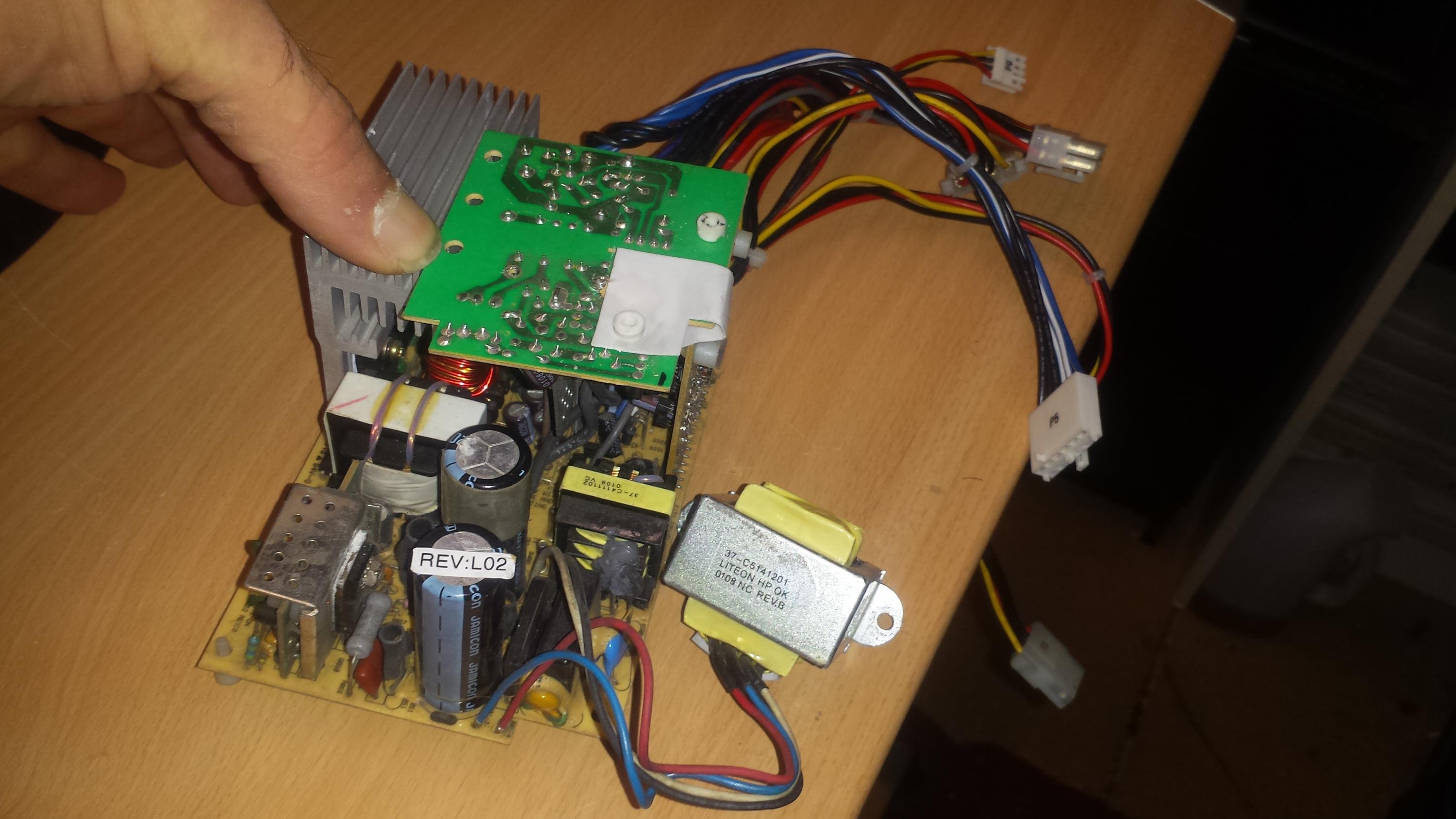

    Show the whole board, top and bottom, how is it connected to the PSU main PCB?
    • roadrash
      • Oct 2015
      • 490
      • U.K.

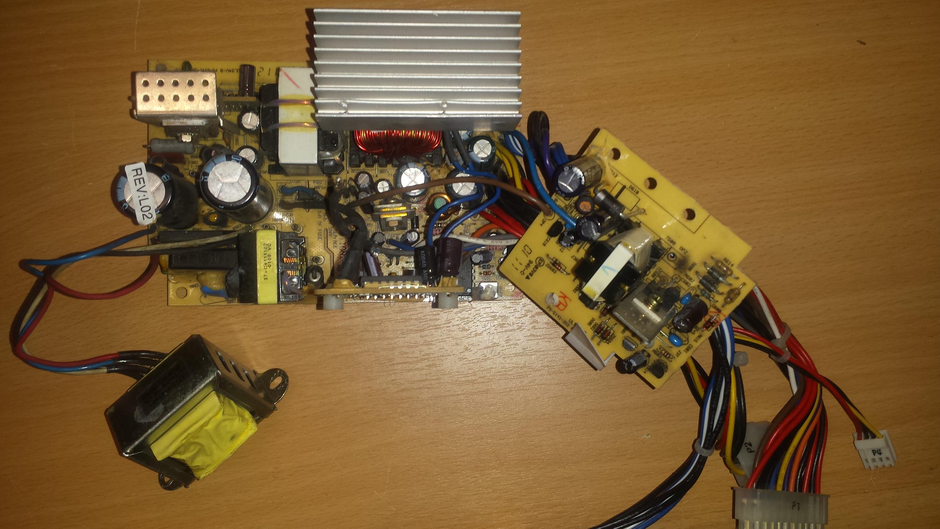

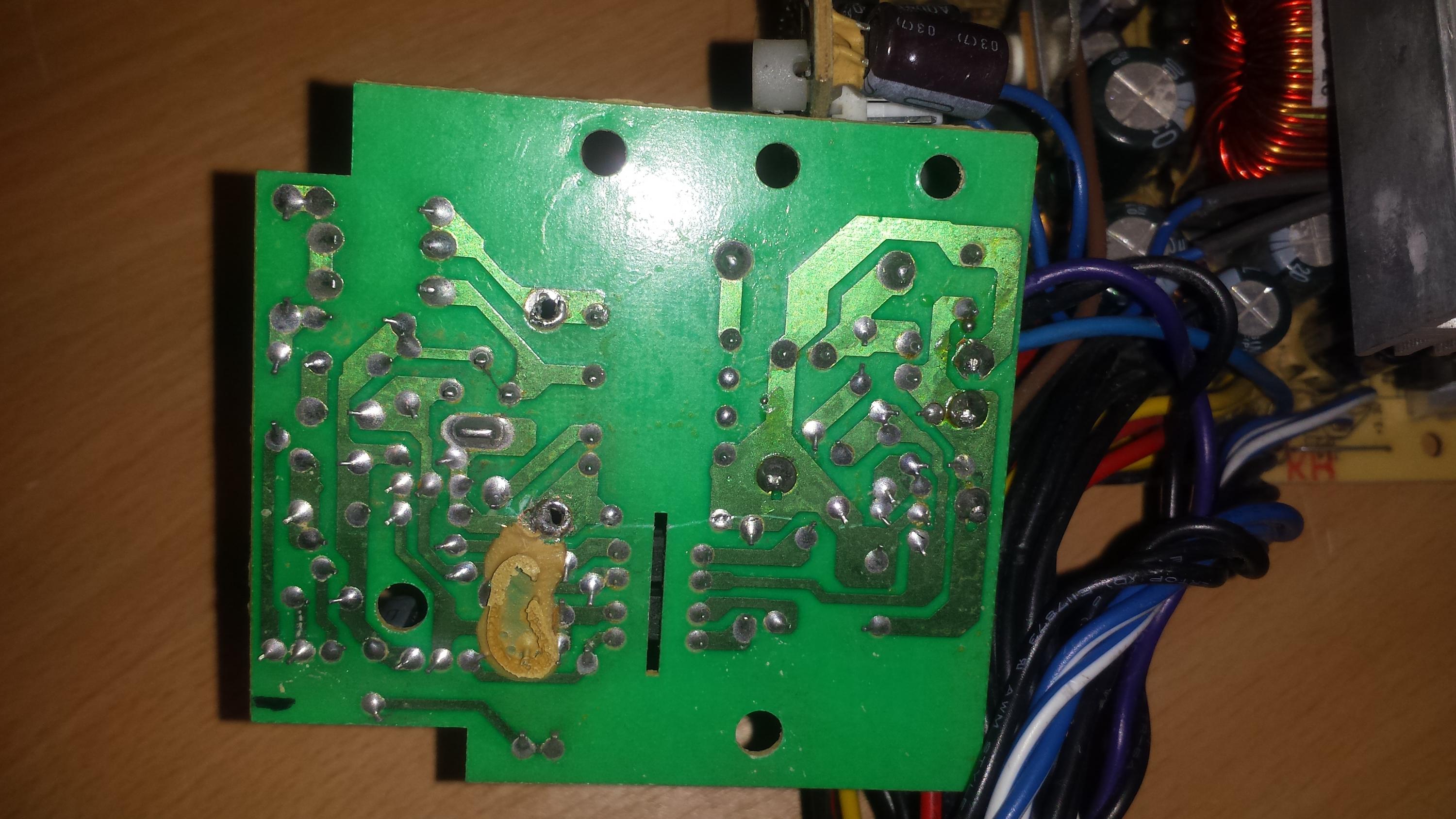

      Thanks and here are some more pics of the supply
      • Per Hansson
        • Jul 2005
        • 5895
        • Sweden

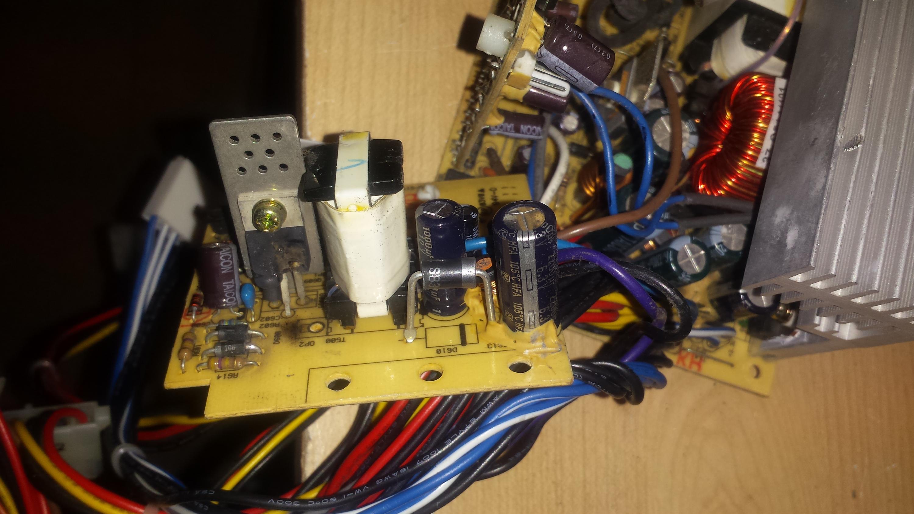

        If my eagle eyes are right this is a Lite-On PS-5141-2D2 Rev
        The board looks like a 5VSB board.
        I would hazard a guess that the small Taicon cap is bad and has caused this failure.
        But it could also have been a large power surge.
        No idea what the original component (IC600) was.
        But it looks easy enough to just wire in any 5VSB supply in it's place.
        Is it wired up directly to the main rectified DC voltage in the main PSU?
        And do you have that up? (Should be 155VDC with 110VAC)
          roadrash is in the UK, so his line voltage is something like 240VAC. It has a 50/60 Hz passive PFC inductor.
          The date codes on the PCB and magnetics indicate that this PSU was manufactured around early April, 2001. It's old enough that replacing it entirely - or re-capping it - should be considered, but looking at that Mini-Fit Jr. type connector, I think that might be a custom pin-out rather than standard ATX.
          The Standby circuit is of the flyback topology, and the switch device is IC600. That means IC600 may have been a Power Integrations TOPSwitch, perhaps a TOP200. But, IIRC, STMicro had a competitive product. Fairchild Semiconductor may also have developed a competitive product.

                You did'nt see the blown off part in the supply somewhere? It might still have part of the number on it
                • roadrash
                  • Oct 2015
                  • 490
                  • U.K.
                  I did have a good look round for it but didn't find anything maybe it was in lots of small fragments.
                        it's a switching regulator,
                        looks like it probably was a topswitch.
                        they do blow when the startup cap fails.

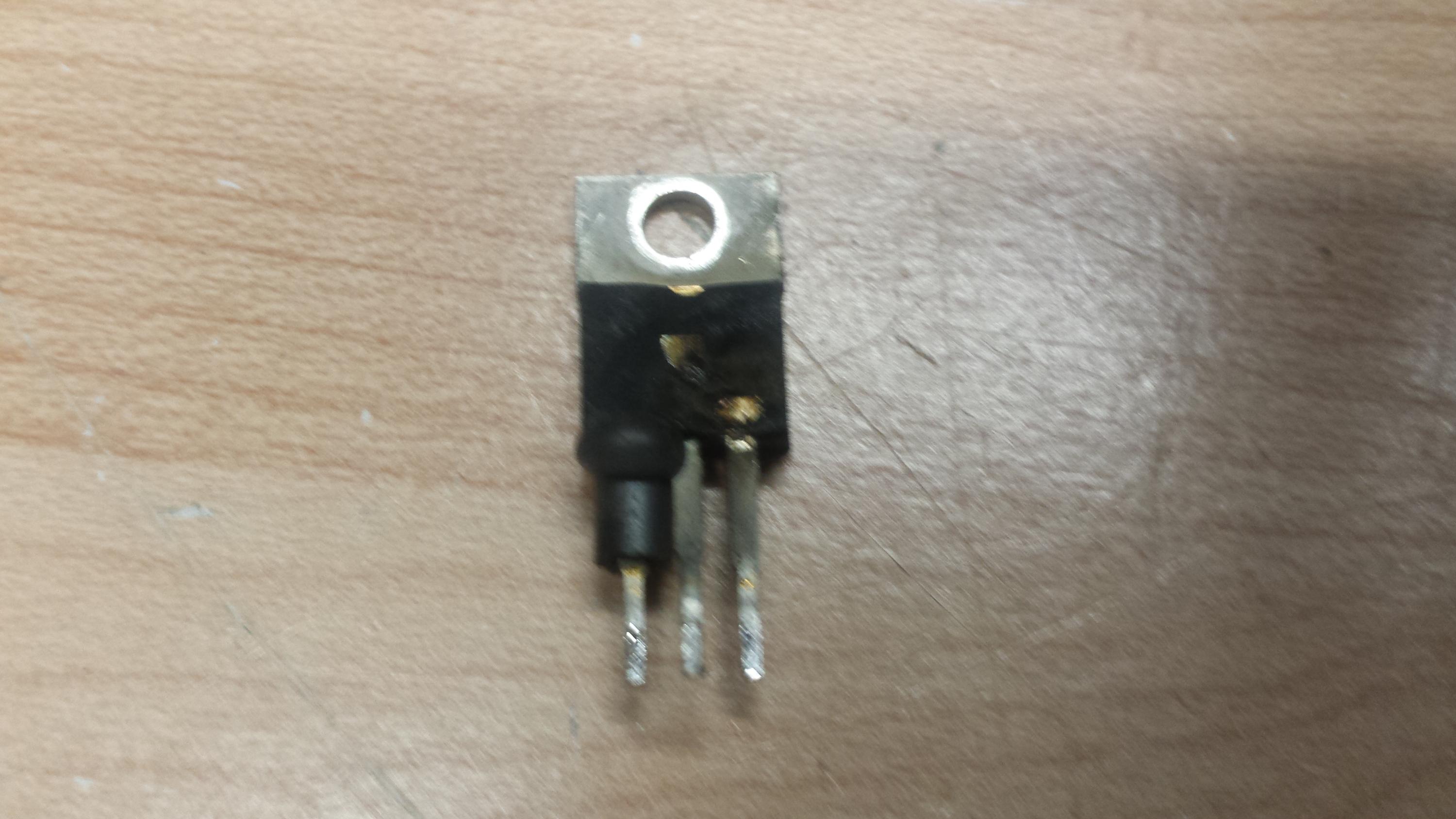

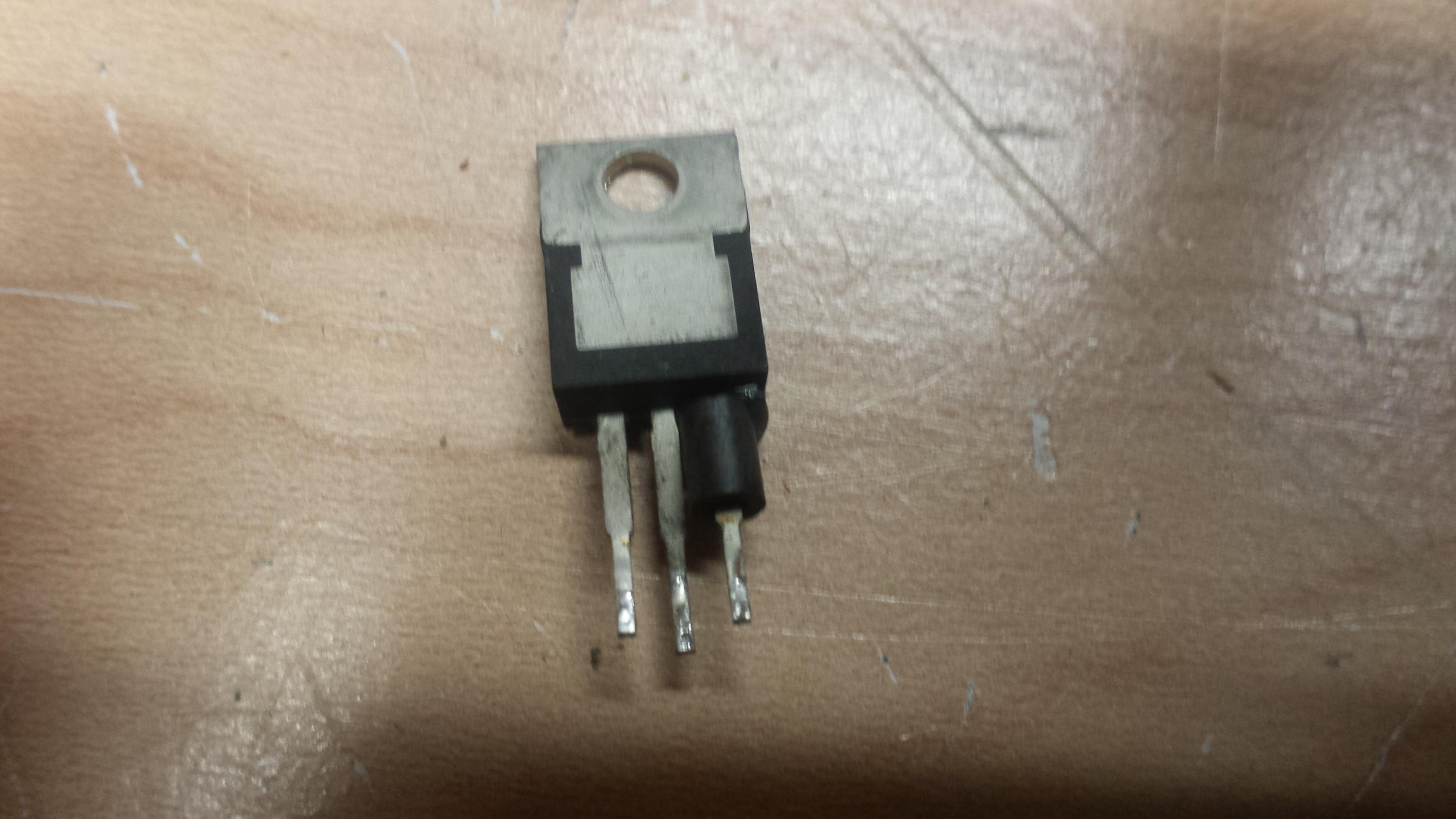

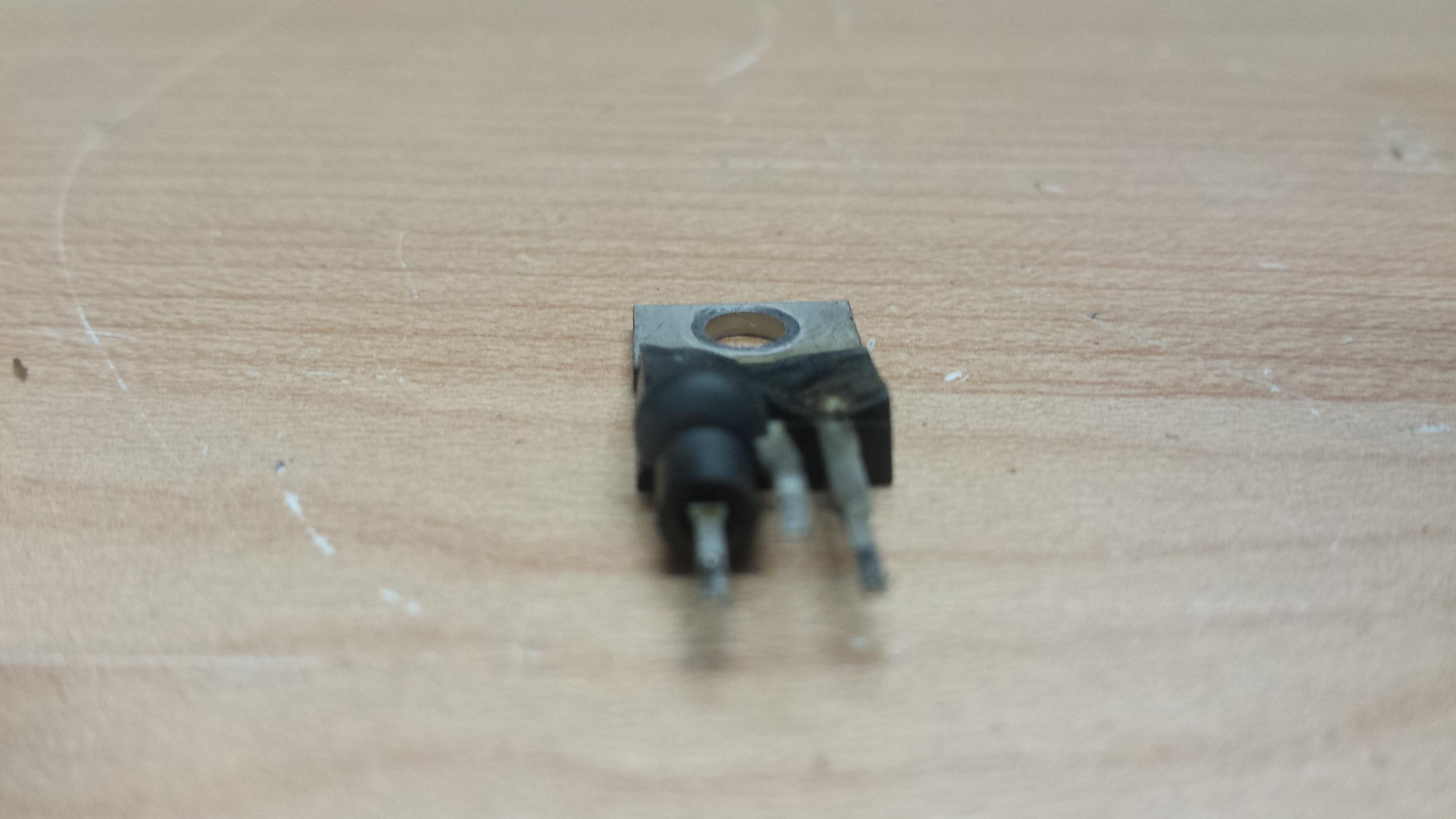

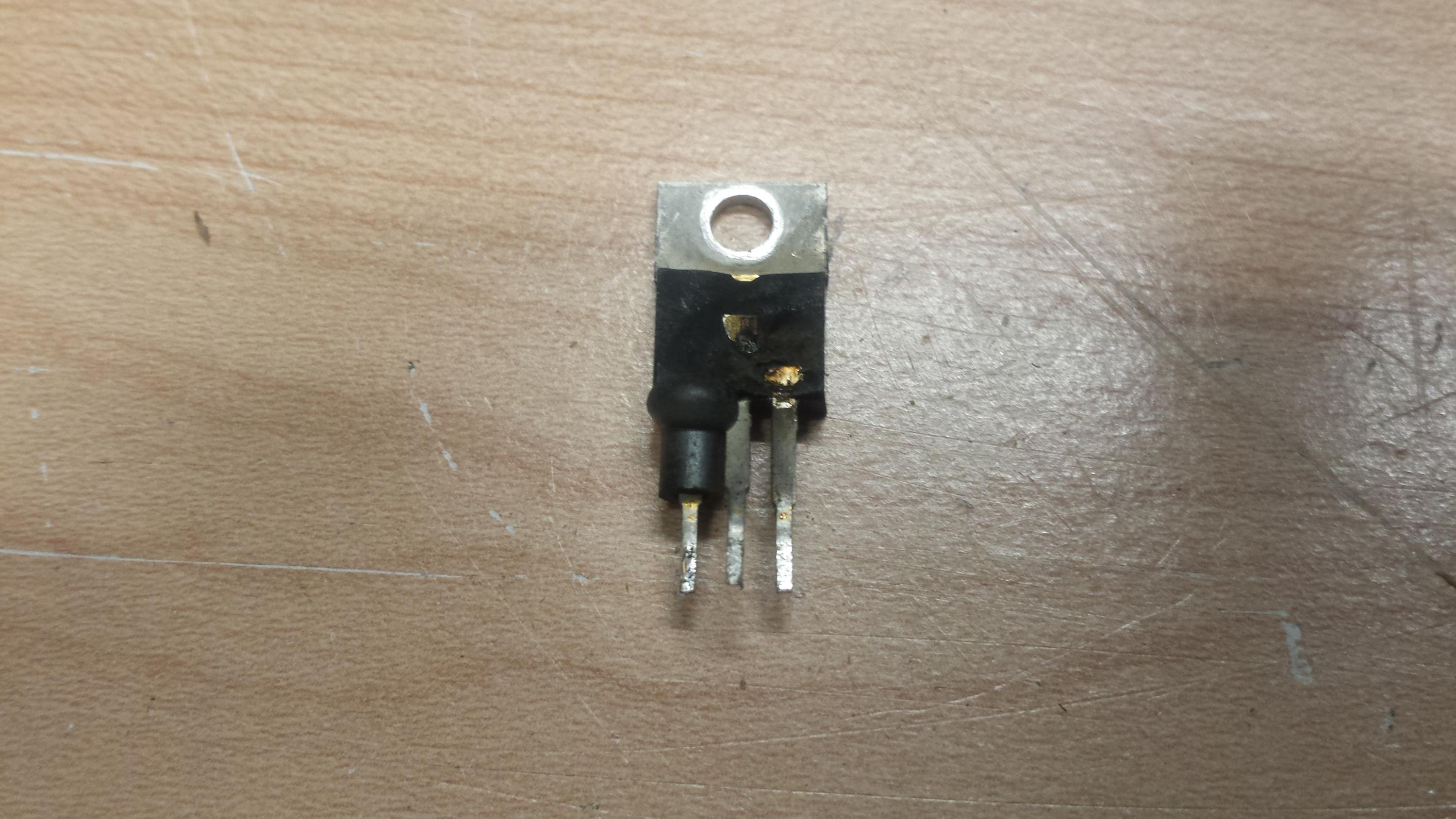

                            I have removed the blown component (IC600) and taken some pictures of it in case it gives any more info.
                            • jiroy
                              • Jun 2016
                              • 2416
                              • Lebanon
                              If this is a one of TOP221 to 227 series , its control pin ( c ) should be driven by the output transistor of a optocoupler . I don't see an optocoupler on the board , can you affirm ?
                                • 31161
                                that's just an example schematic, i'v seen loads of them just use an extra winding on the transformer.
                                i used to repair sattelite receivers full of them.
                                when the cap dries up they sit and pulse for a while creating a ticking sound - then BANG, your TOPswitch is toast!
                                RoadRash, check the brown Taicon to the left of it.
                                (and dont lose the ferrite bead on pin1)

                                    • 31161
                                    well it could have just been age.
                                    specially if the heatsink isnt all it could be.
                                    • roadrash
                                      • Oct 2015
                                      • 490
                                      • U.K.
                                      So what component do you recommend I use to replace this blown one and what is the ferrite bead for?
                                        • 31161
                                        ferrite bead is for stability.
                                        no idea on the part number, but it's logical to take the one with the highest capability.
                                        you may be able to salvage one from an old cable or sat box.
